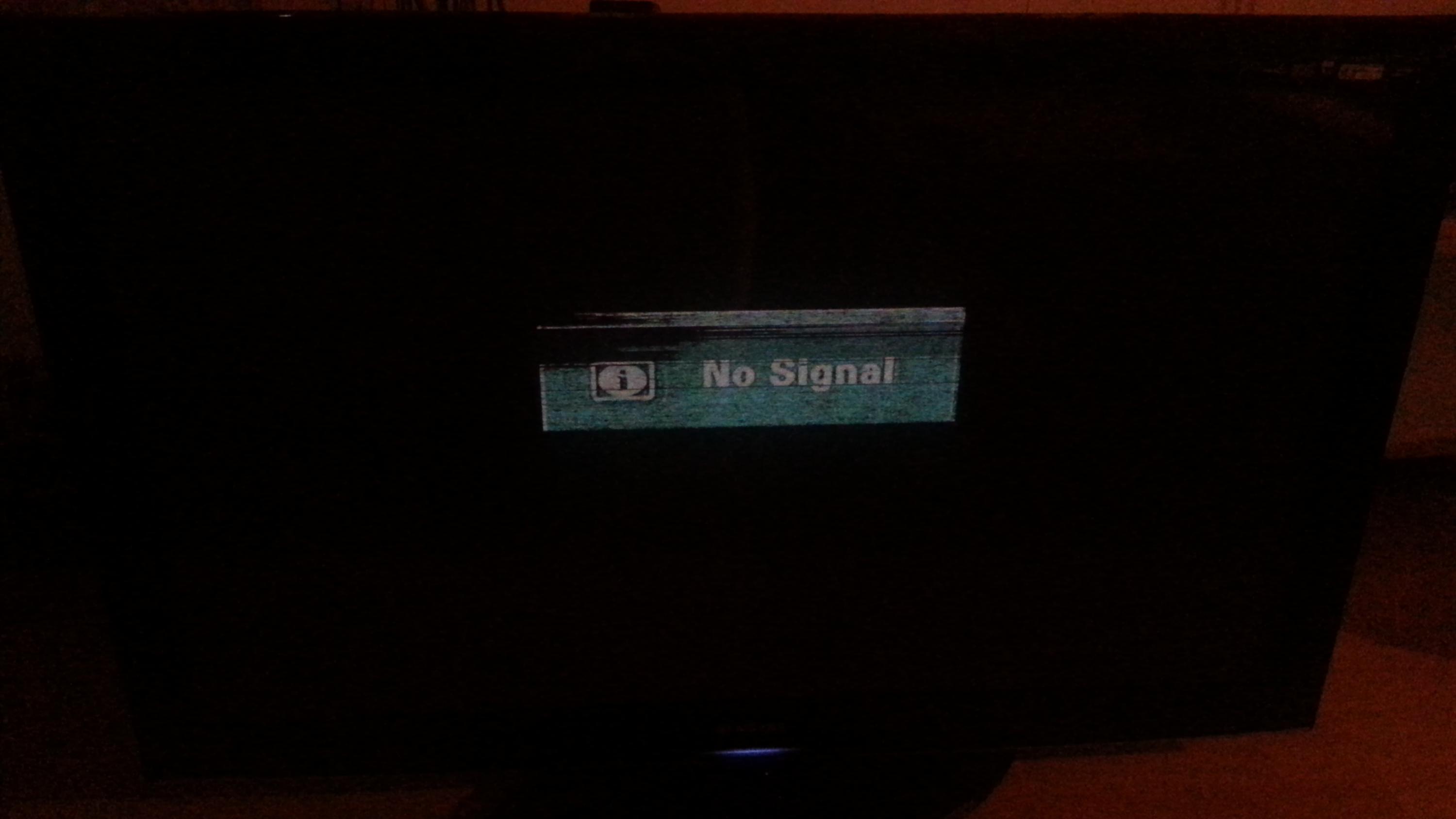

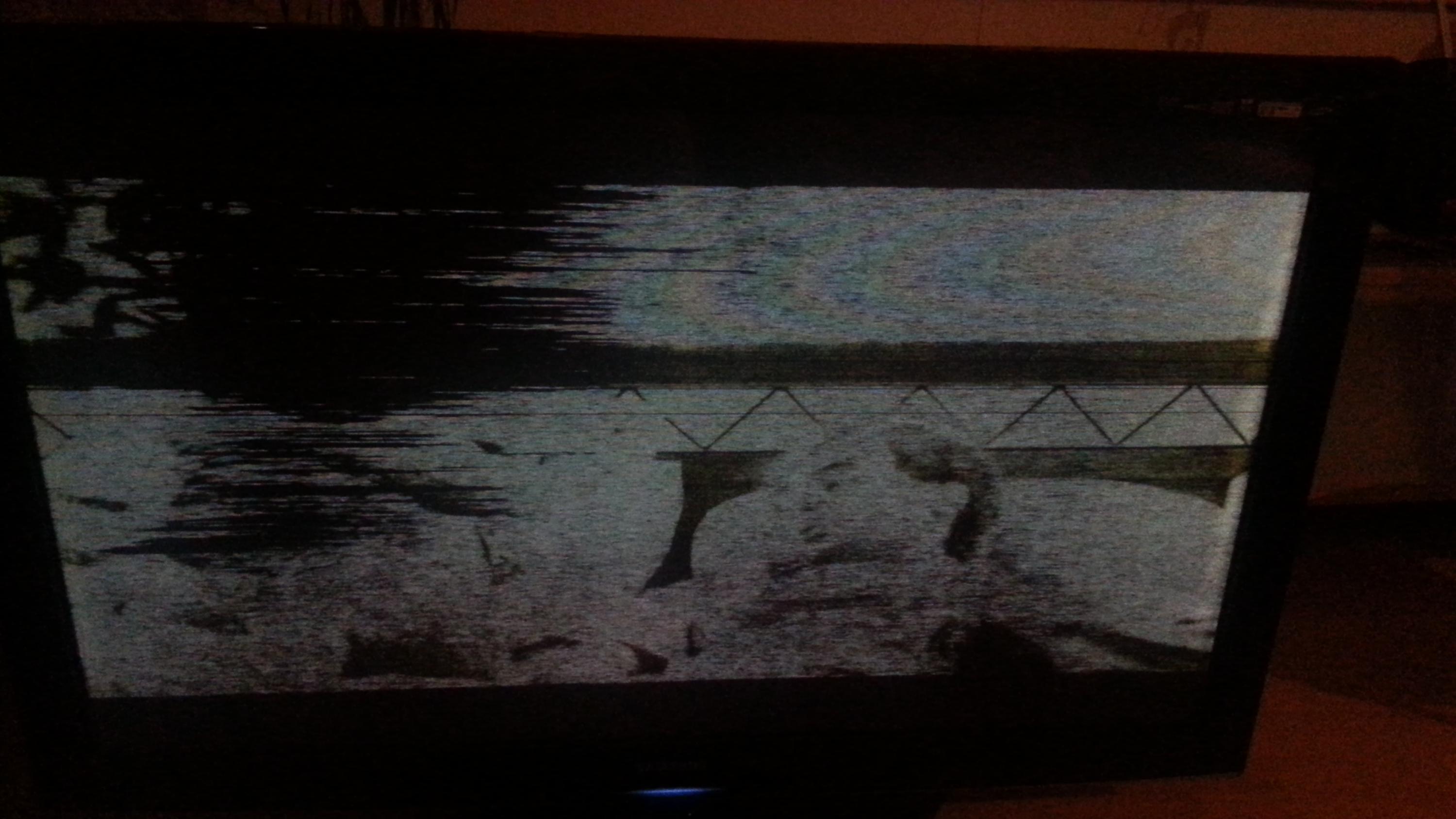

    I'm hoping to get some of your insights with regards to a strange screen issue I'm seeing on my Samsung PS50A plasma screen. It worked fine when I last turned it off, but yesterday when I turned it on, it went straight to a weird screen, which I would describe as "black and white only, with random horizontal black lines across the screen, in more or less fixed positions". I still have sound, and the TV is still responding well to the remote. You'll find attached some pictures for your reference... Note that I do have some color when I switch to a channel without signal (see attached picture).
    Maybe good to know is that we just had a few hot days outside (30+ degrees) where I live, and the TV is standing directly in front of a window. It's the only external influence I can identify at the moment, that could've caused something.

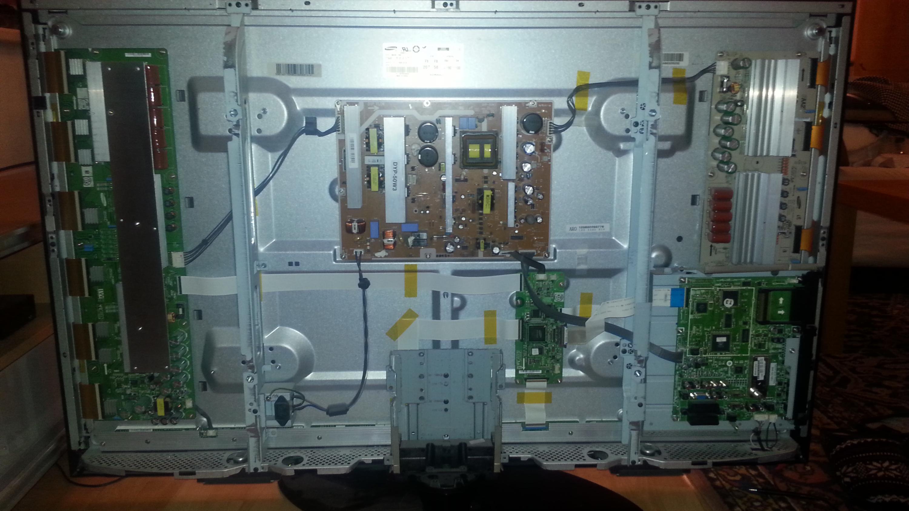

    - Reseated the main connectors between the different boards

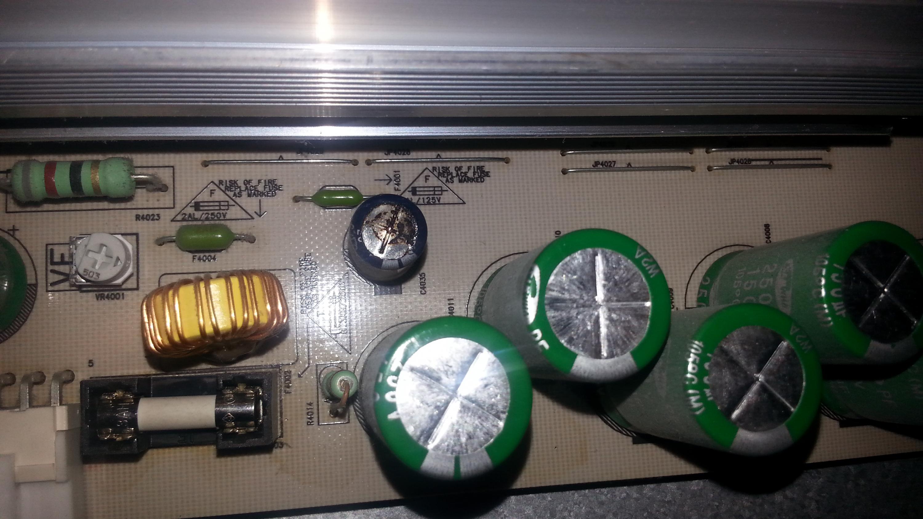

    - Visual inspection with back panel removed - I found one slightly bulged cap on the X/Z sus board, but I'm not sure it might be causing the issue?

    This fault is likely X-main. That cap is very bad. Have you checked if the fuse near the cap (green thing) is OK?

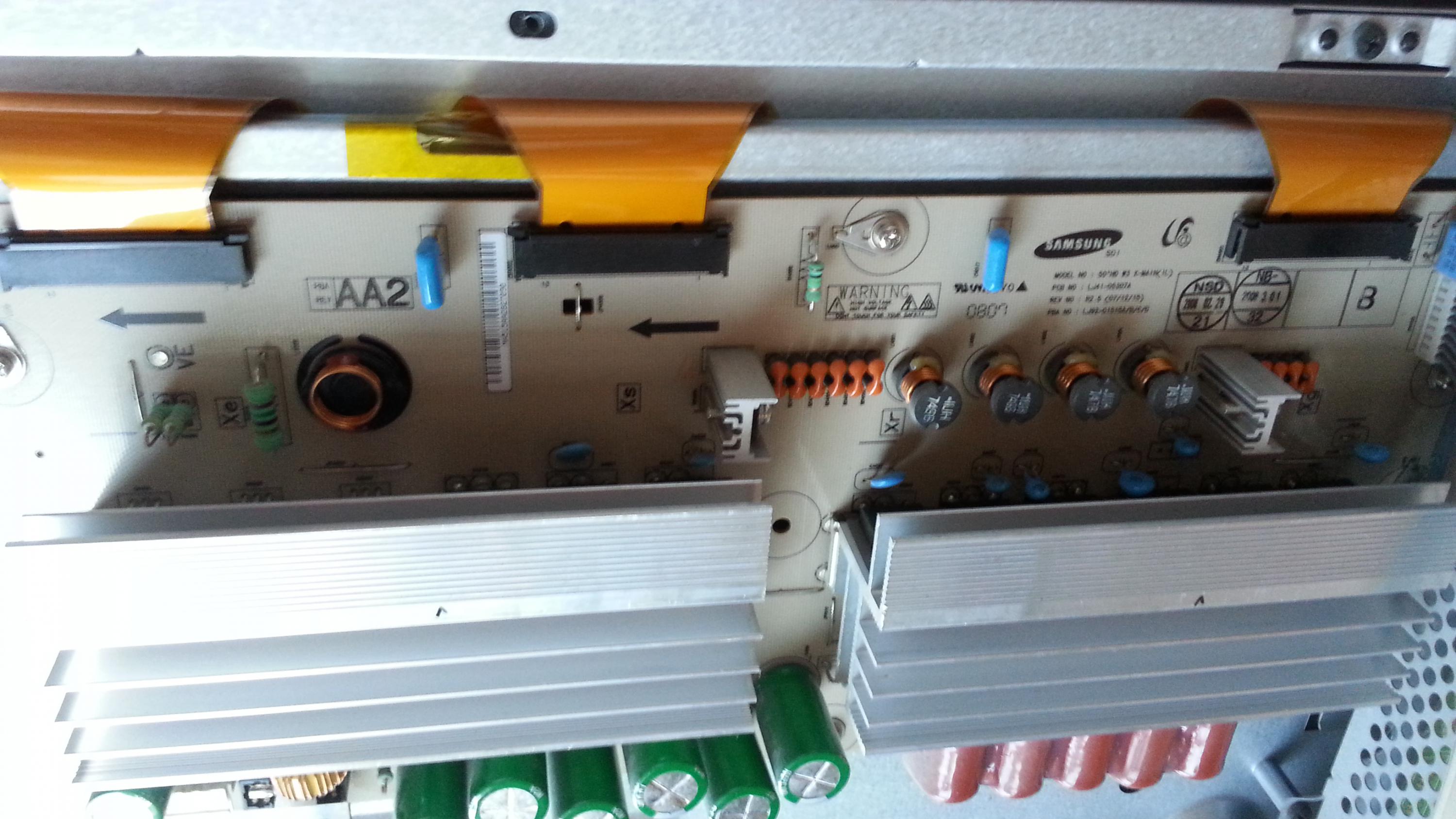

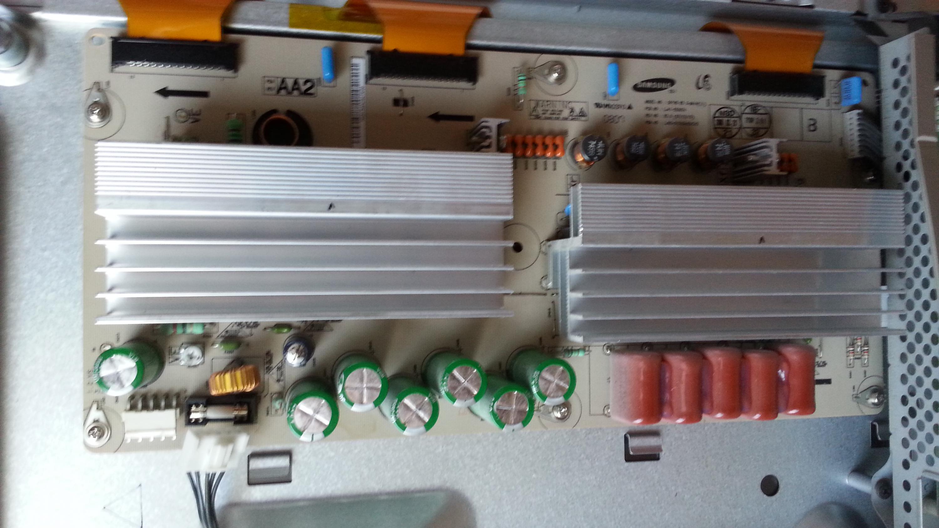

      I did not check the fuse before, but I just grabbed my multimeter and the fuse seems blown. Do you reckon I can buy a replacement fuse + cap in my local hardware store, and it will solve the issue? Or do you think the board in its entirety is busted? I've attached a closer picture of the X main board, in case it helps. It all looks quite good to me, except for the buldging cap...
        Re: Samsung PS50A plasma screen issue
        I think it's worth a shot to replace the fuse and cap. If it does blow the fuse again you will probably have to do a more in depth repair or replace the whole board.

          I replaced the cap and fuse, but the issue persists unfortunately. No improvement noticed... One thing I noted is that the fuse is fine now, i.e. it didn't blow again immediately after switching on the system again.
          Do you have any more suggestions about what I could try more? I'm ready to try a more in depth investigation in case you do. I have access to probably whatever tools I'd need. Are there any volt measurements on the X-main board that could help pinpoint the faulty part of the board?
