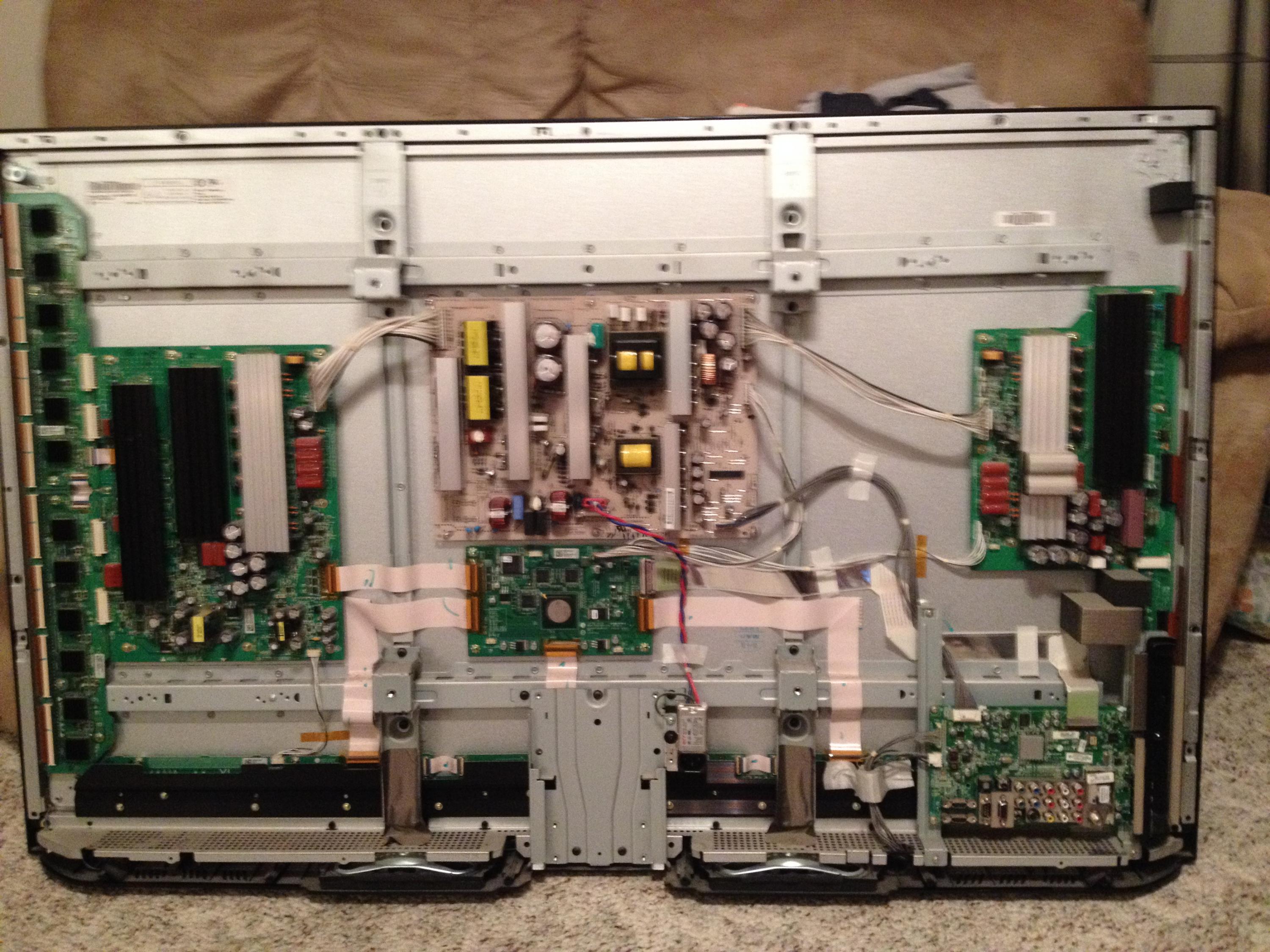

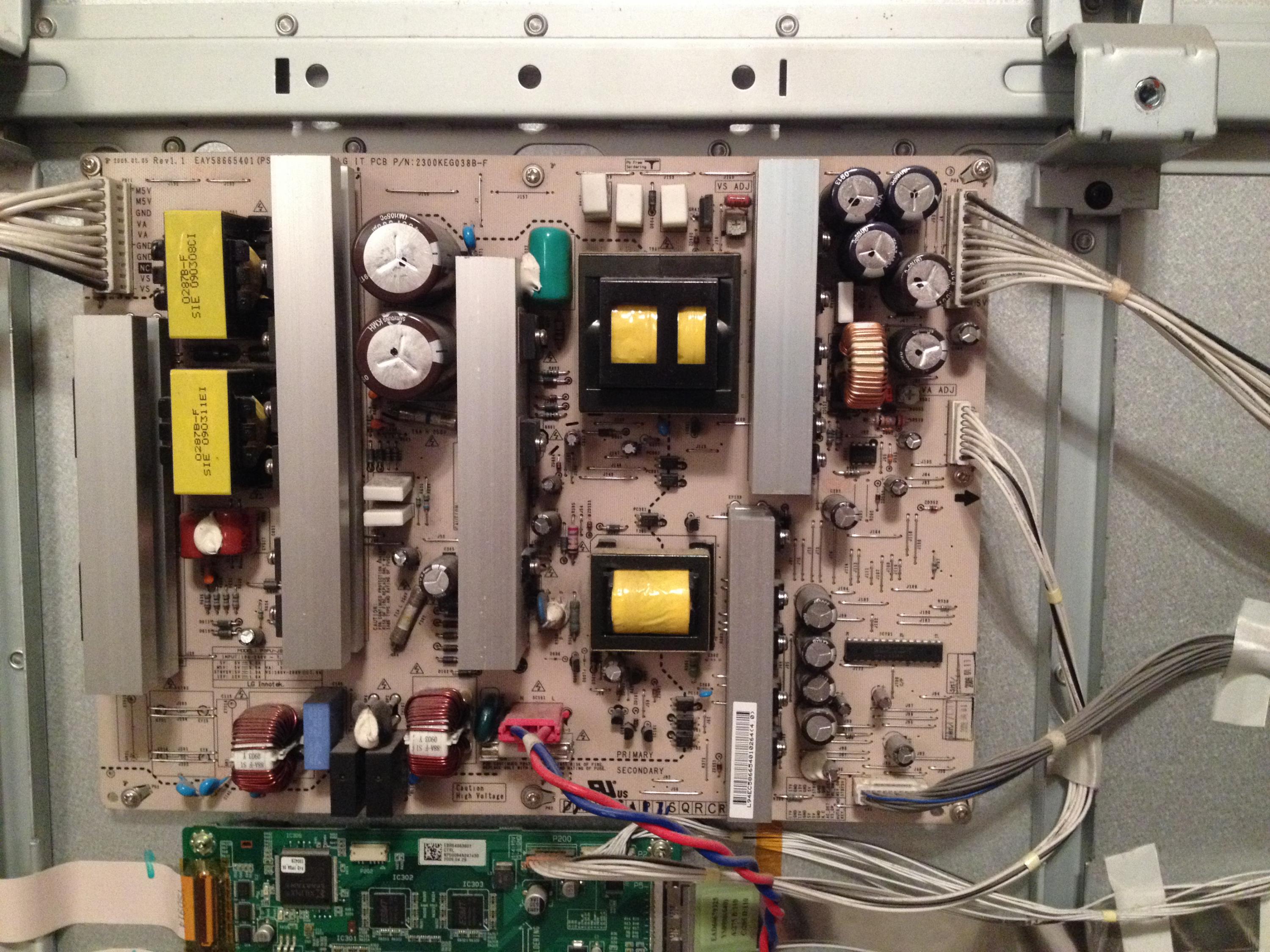

    My 50" plasma LG TV's color goes out after having it on for a few minutes. It turns to light color with pink or purple hew. I know from reading other threads that I need to test the voltage on the different boards but I need help knowing where to test it and how much it should read.

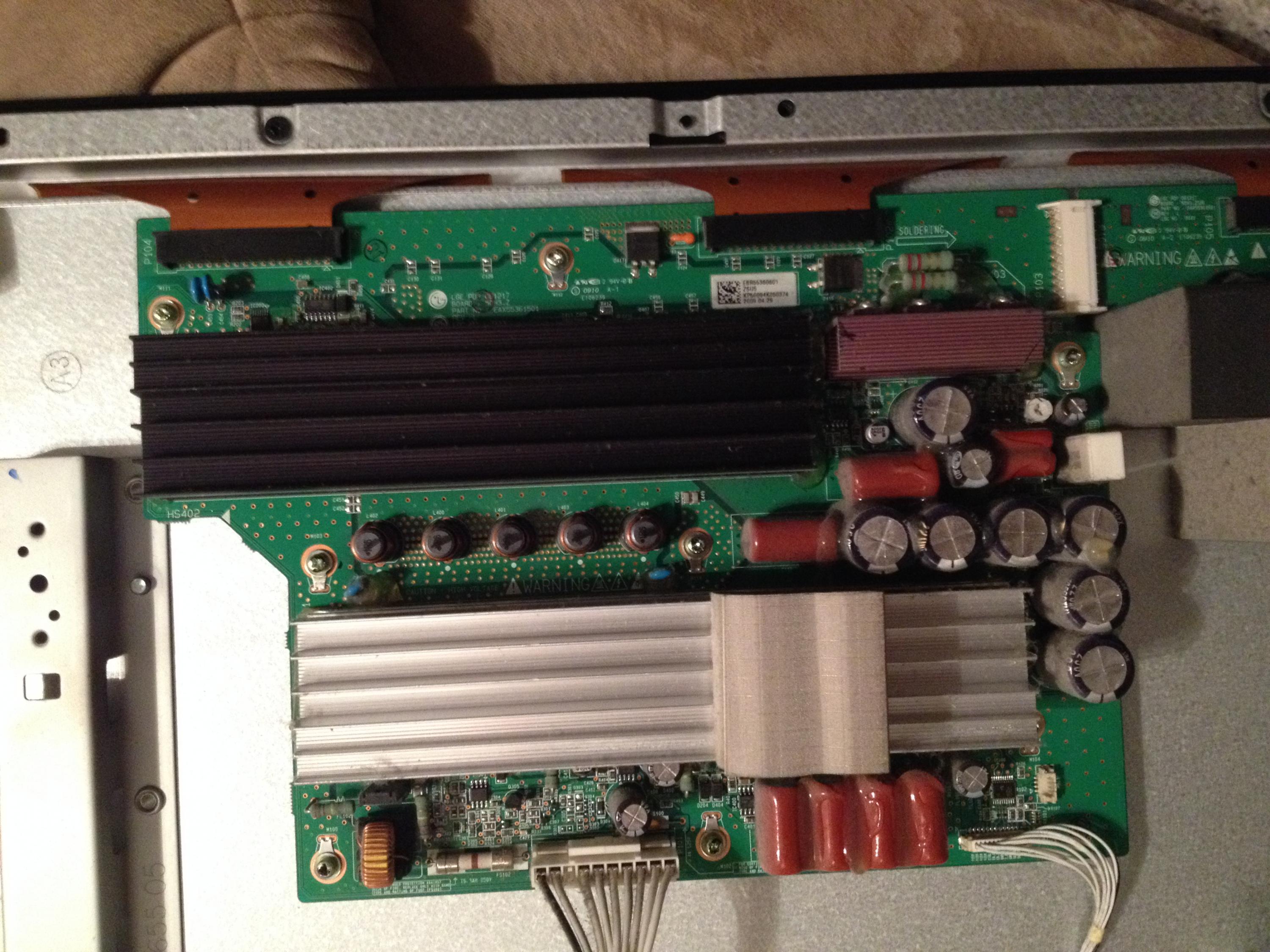

    Concentrate on that board on the far right side. Known as the xsustain, failure will often appear as pink hue across screen.

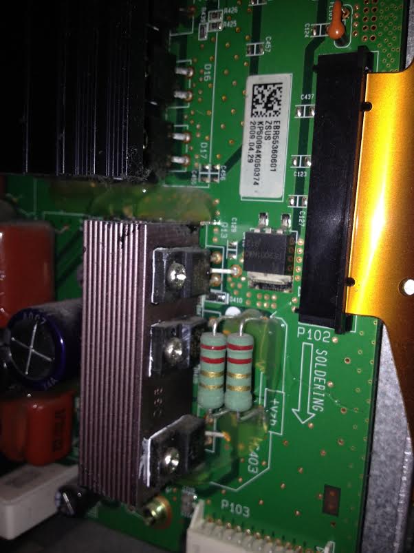

        you might check the inductors down the center for poor soldering (on the bottom of the board), I recall lg had a problem with this previously.

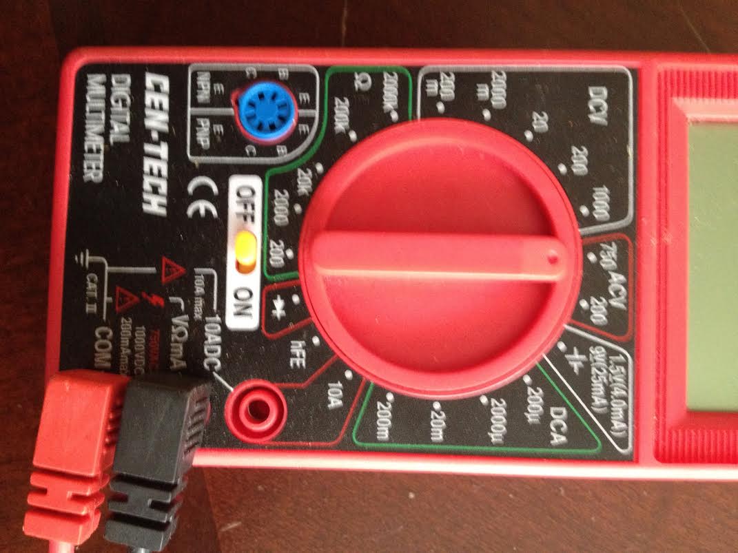

                    Can you post a picture of your multimeter?
                    I just fixed a 50PS3000 with this fault. Same panel design as yours, minus a few features. It was a bad Vzbias circuit on the Z-sustain.

                      Here you go. Thank you!
                        Re: Plasma LG 50PS60 Screen Problem
                        OK, you want to turn your multimeter to the 200 DCV range.
                        Then on the Z-sustain board, on the right hand side you will see a resistor marked VZBIAS
                        For guidance, see page 128 of this document
                        http://www.toms-service-manuals.com/...&Search=Submit

                              Both rear 97.1 on the top and 97.2 on the bottom of them when it is plugged in but not turned on.
                                Sorry, meant plug it in and turn it on. See that it remains 97V. Then run it for some time, and when the tint occurs, see if the voltage drops.
                                Also check the Vs on the power supply.
                                • Brutis4555
                                  • Jun 2014
                                  • 20
                                  It went up to 180.
                                  • Brutis4555
                                    • Jun 2014
                                    • 20
                                    The reading on the meter was 181.5 after the screen tint happened.
                                      Wow, yes, that is definitely bad! Interesting, that the voltage increased on yours, but either way is bad. I had essentially the same problem on my set after replacing two transistors though mine only went to 150V, it made all black level a dark-yellow colour. I never saw a pink tint though..
                                      Replace the transistor FQFP51N25 near the Vzbias point. I think it is Q13, but you should check. You need to replace it soon (and don't run the TV for too long), because if it continues for much longer, it will damage the other two transistors, complicating the repair.
