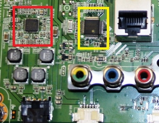

LG 55LF 5800 no video,no sound or backlight

      Okay, warm up the processor.
      • Diah
        • Feb 2013
        • 6500
        NO... don't touch SoC... we have here similar with LF search the forum.... the Micom hat cut off and we did DIY... the owner of threat i remember from sweden... search the forum to learn.

            Post clear closed resolution photo of yours MB... to point you..... if you search the forum you will find it i will not do this job for you..
            • waybel
              • Nov 2014
              • 65
              • canada
              thanks here is pic
              • Diah
                • Feb 2013
                • 6500
                yours photo not the best... tell the label of this 2 chips.. with red i think the converter we are looking for.

                  With red, this is actually an audio frequency power amplifier.

                    yes it could be... but we want to know what he have to say .. after he read and understand the label.

                      the yellow chip says 100GEA 527FZOA
                      the red chip says NTP7513 T5000266-1AF 15285

                        Red is audio amplifier.The yellow i believe is a 16-Bit Single-Chip Microcontroller

                          Renesas R5F100GEAFB

                            When turned on, is 12v supplied to the t-con?

                              yes

                                Micom controls all dc/dc converters and switches for powering cpu, ram,..., do these voltages also appear on the motherboard (1.2V, 1.8V, 2.5V, 3.3V, 5.0V)?

                                  Just looking quickly on various places on main board found 1.2 V 3.3V 3.5v 5v 12v and 24v

                                    very things correct... did you have the Audio Optic port lit red?
                                    you need to remove the Bezel and inspect the glass display if any where on rand broken .. Panel VCC rail goinf over all the screen from rand.the thin film.

                                      The audio optic is not lit red and the screen is fine,I had it all apart to change LED strips

                                        Plug it with LAN to yours router... see if it pick up IP.. no IP mean SW didn't start at all

                                          no nothing working
