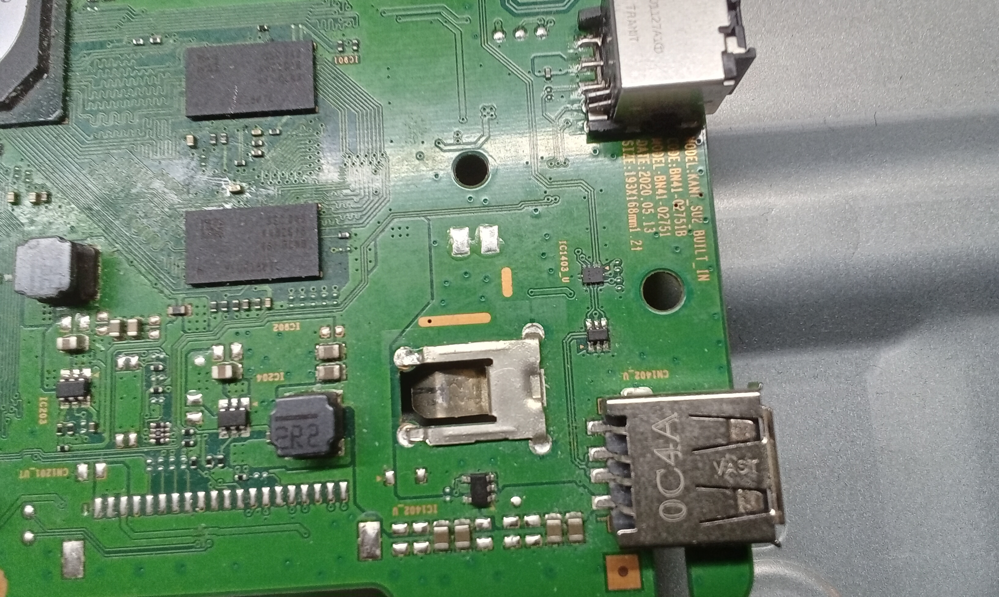

      I made the test with jumper on those point market By Lotas and Pin2 unhooked . what do you think that result i get in my last post ?
      • Diah
        • Feb 2013
        • 6440
        #103
        the part of panel at yours last test which didnt show picture are shorted.... you need to show here the buffer boards of this part if there any esd diode installed on it
        • bohaboha
          • Nov 2012
          • 1017
          • sweden
          #104

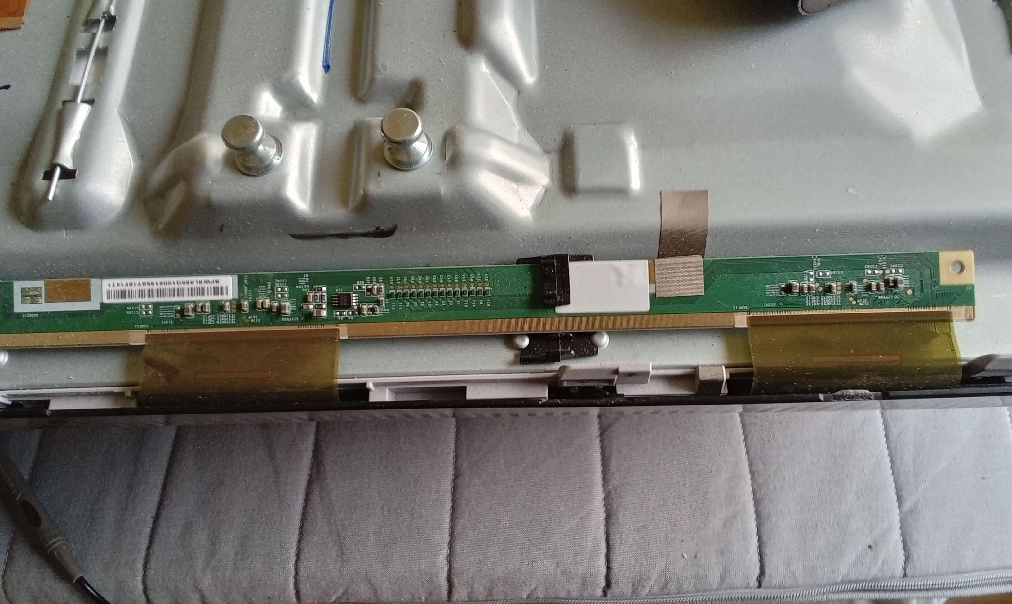

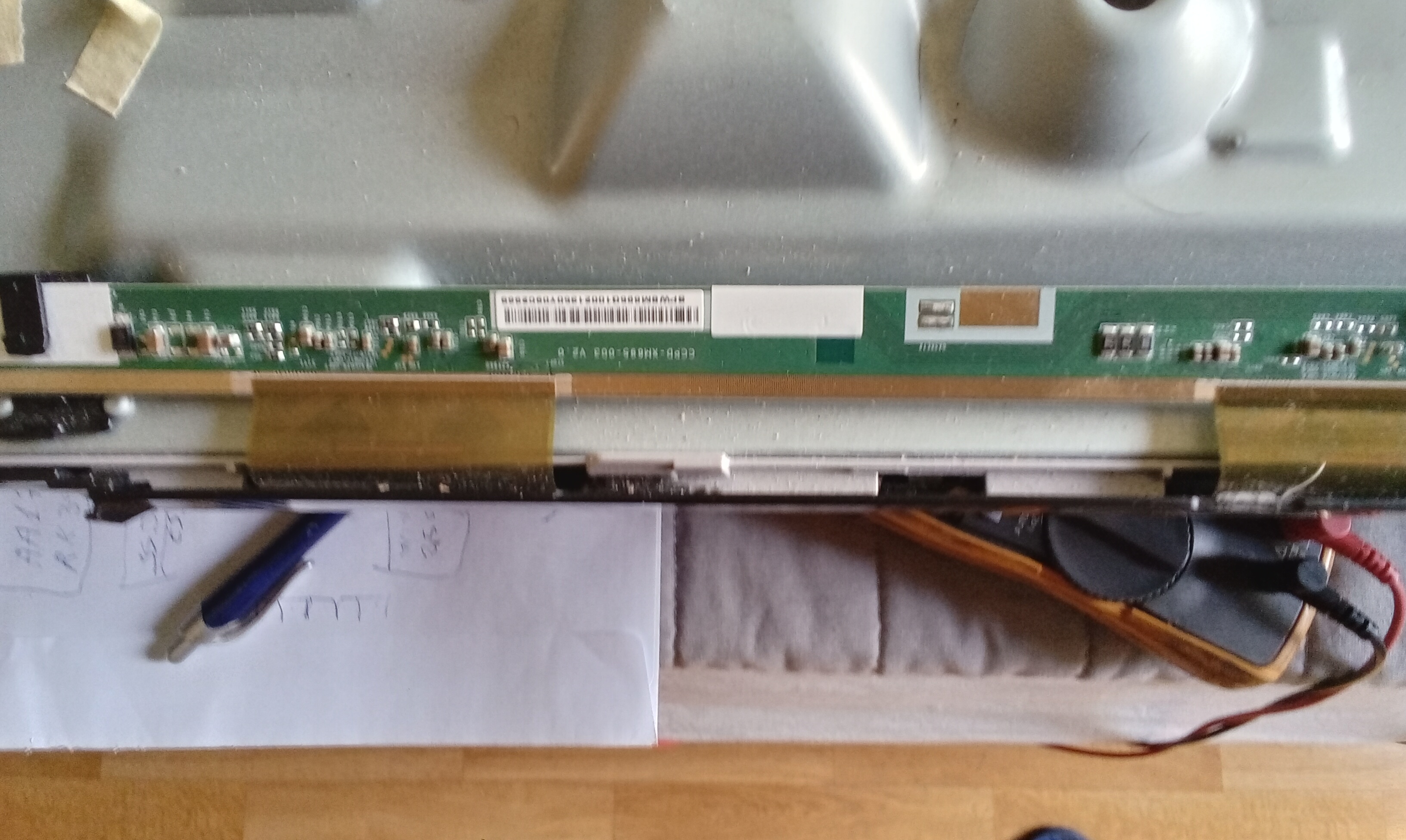

          Hello new day new attempts. I have done new tests with ANA_DIM pin 2 disconnected and with jumper on feed back points.
          looking to the screen
          1) The left buffer board removed = no picture backlight on the TV goes in start loop and STB flash 3 times 3 flash.
          2)the middle and the left buffer board connected start with the logo for two to 3 seconds, then no picture but backlight on, then goes in the start loop with STB flash 3 times 3 flash.
          3)only middle buffer board attached = see attached picture no loop and no STB flash​ .

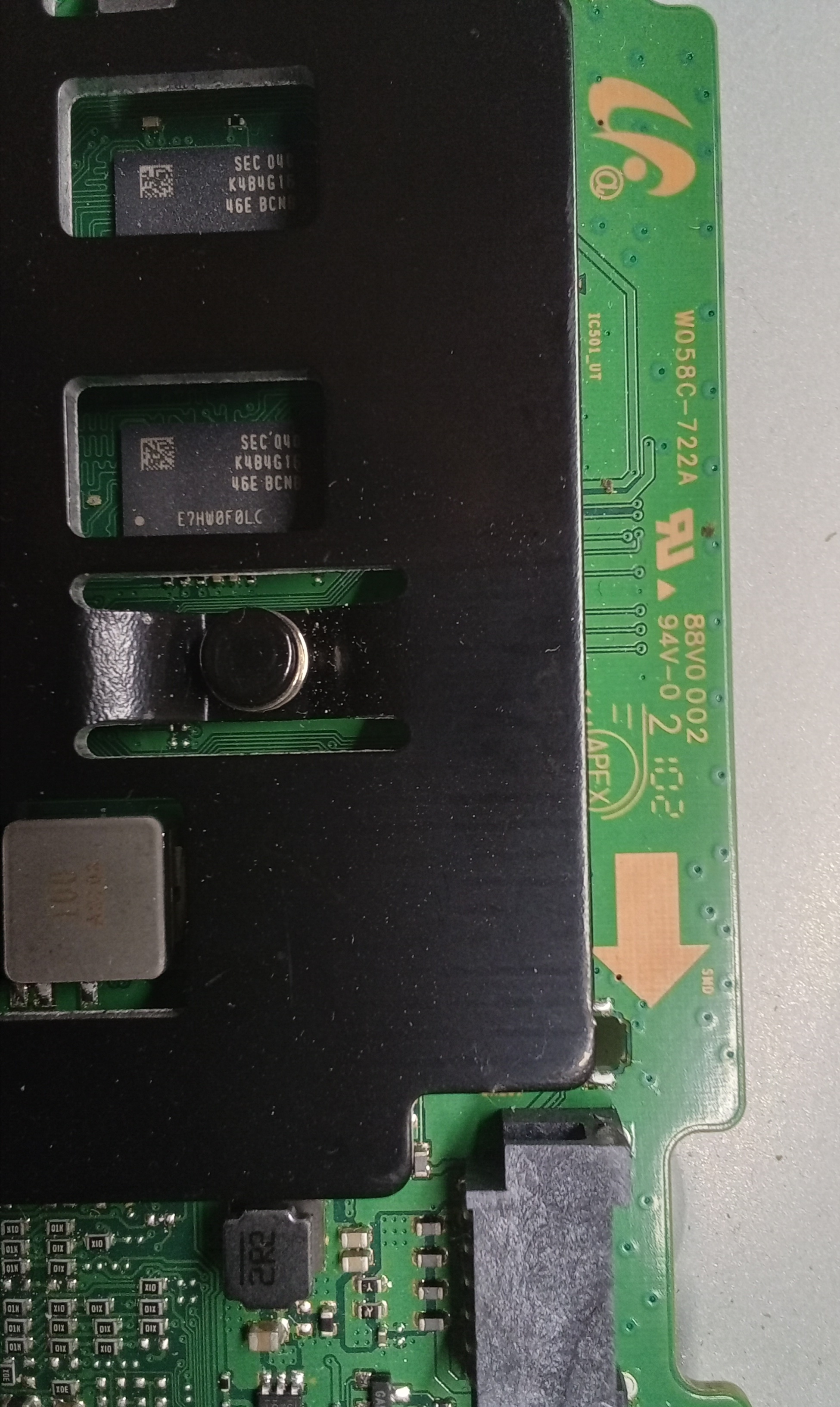

          Diah here some pictures of the buffer board as you asked
          pictures order from left to right 135133,135122,13508,134759,134708,134551 and 134502

            we said put back ANA_DIM. and connect the left and middle side only.. see if there loop or not

                #107
                all work now with jumper.. later after the issue cleared u can remove it
                2 esd

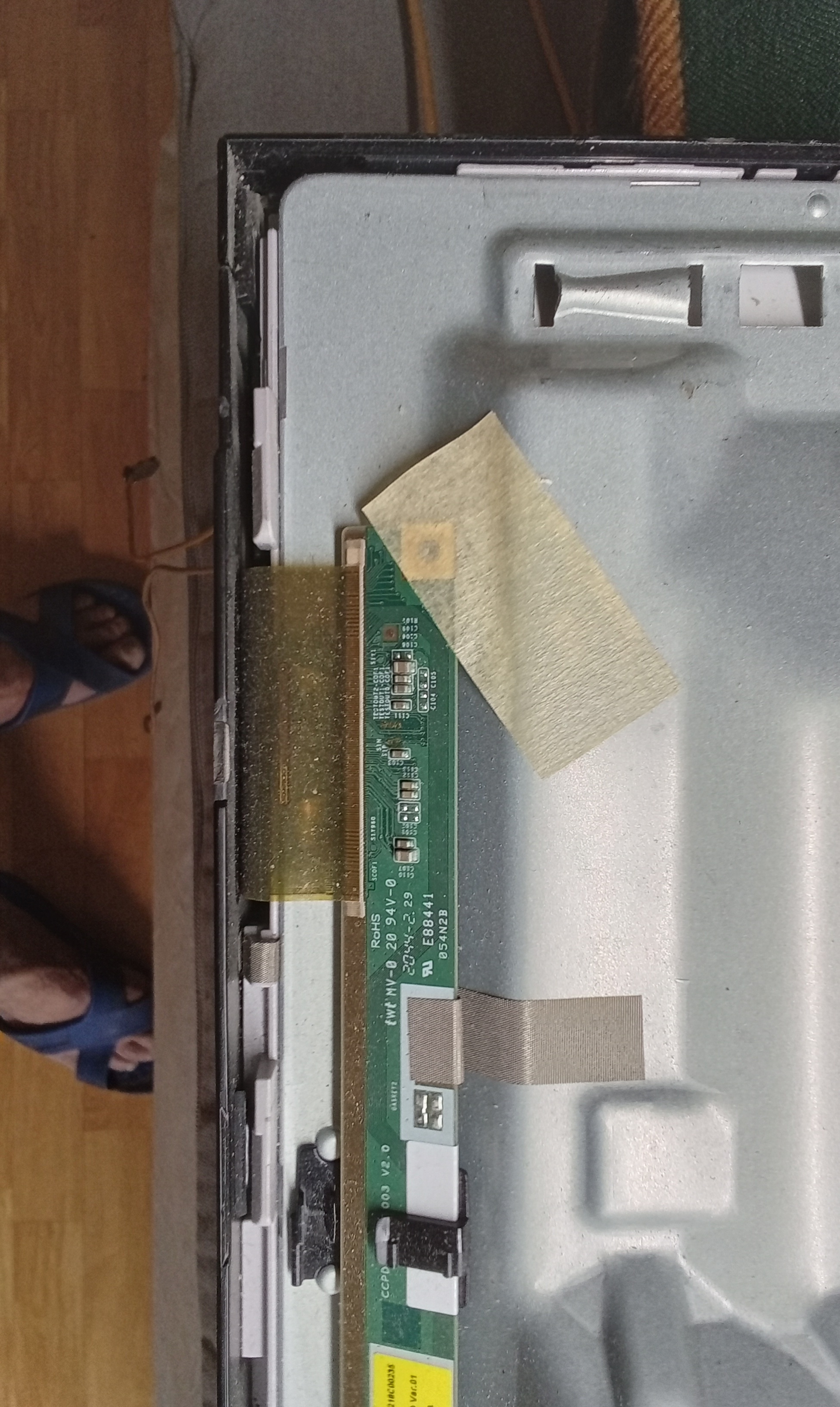

                      with jumper and a smal tape on the left U ribcon it shows a picture on all the Screen for 3 second then loop. the esd diode never get warm in any situation with or with out a Jumper but maybe that IC near it or a capacitor are bad but no heat on them.
                      I am having problem to get into the Forum site from home i am answering from Bibliotek att home i get "connection not private " and not secure site ,
                      hope i will fix it soon.
                      i realy do not know what to do next maybe i ll go on with tape trying .but is ist problem with jumper and tape or i have to remouve the jumper to try the tape ?
                      thank you very much for your help

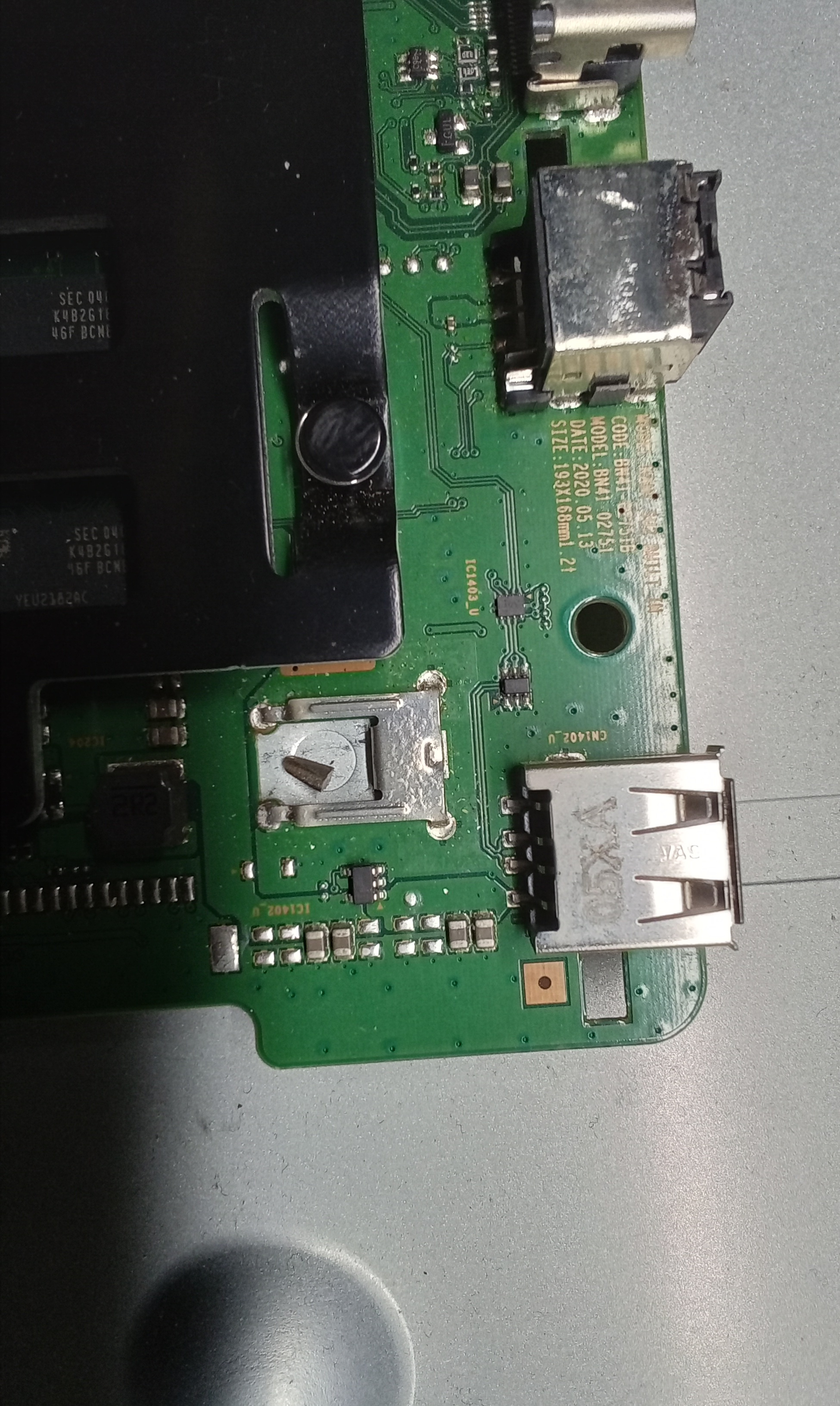

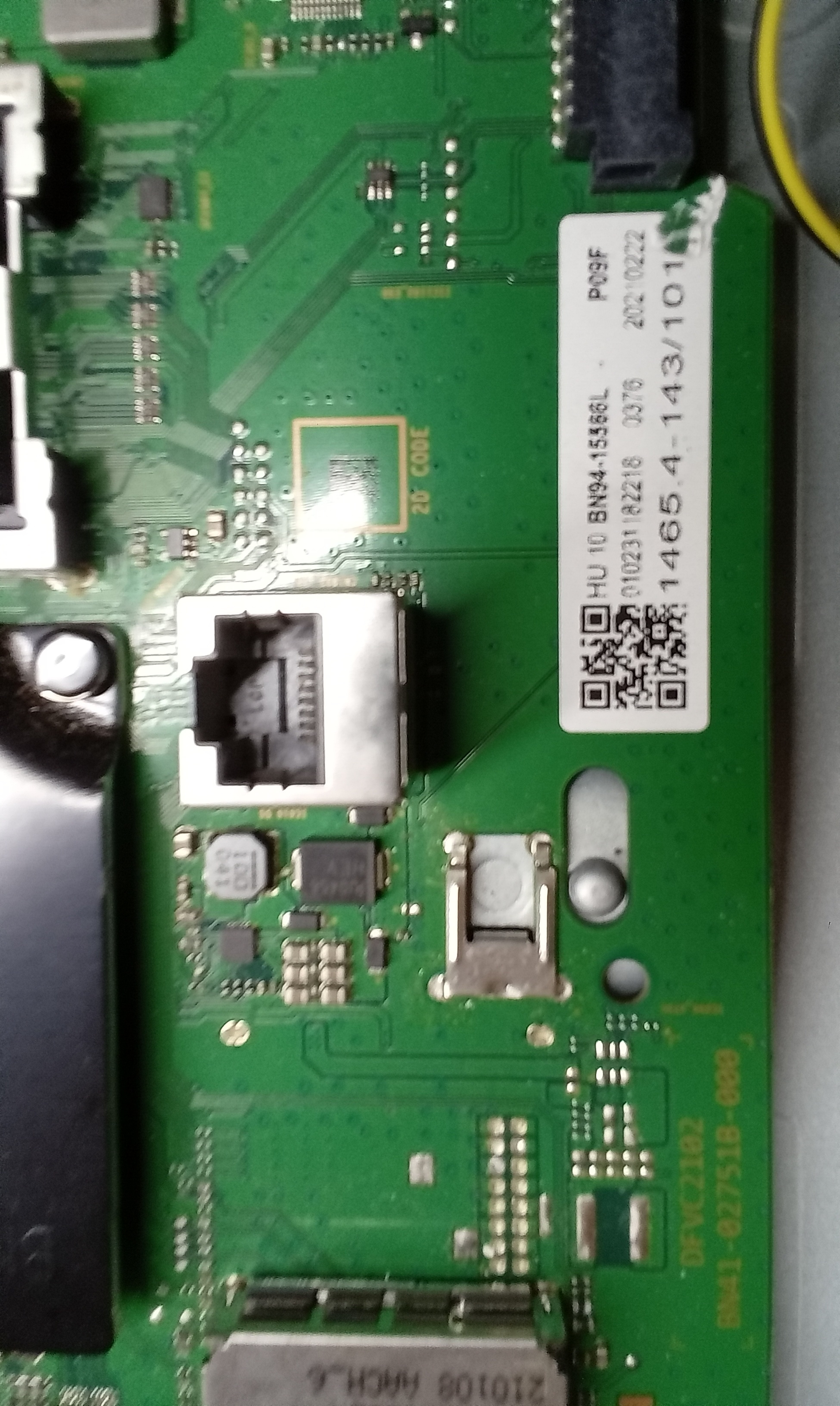

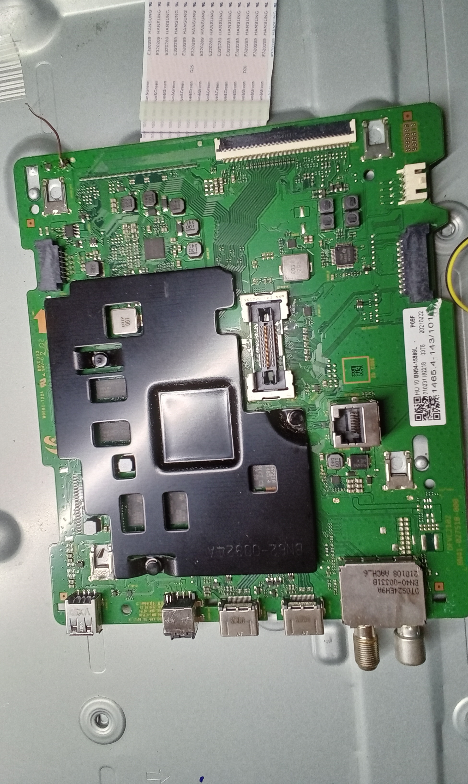

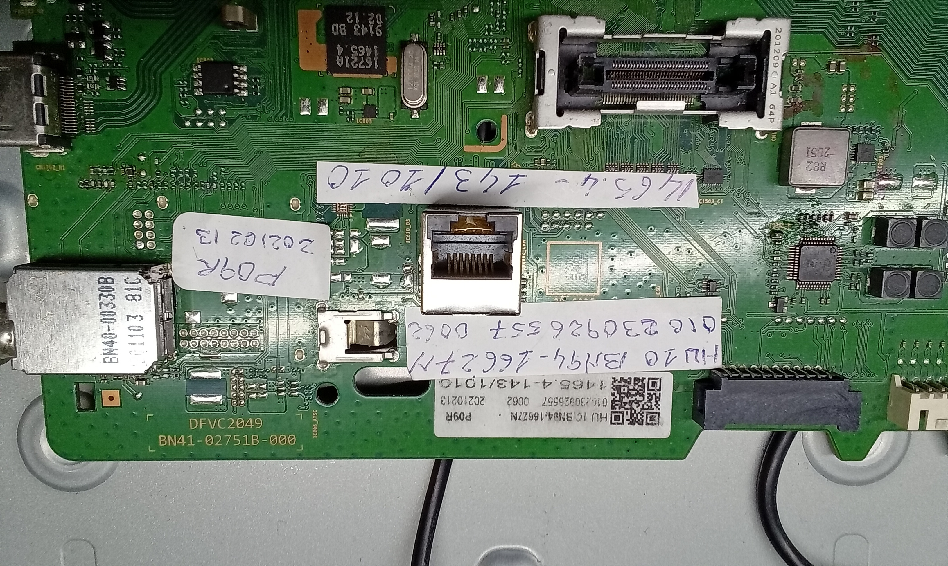

                                  post photos with remark on yours original MB and the replacement only on LVDS socket and front IR-LED indicator socket and WIFI socket
                                  • bohaboha
                                    • Nov 2012
                                    • 1017
                                    • sweden
                                    #117

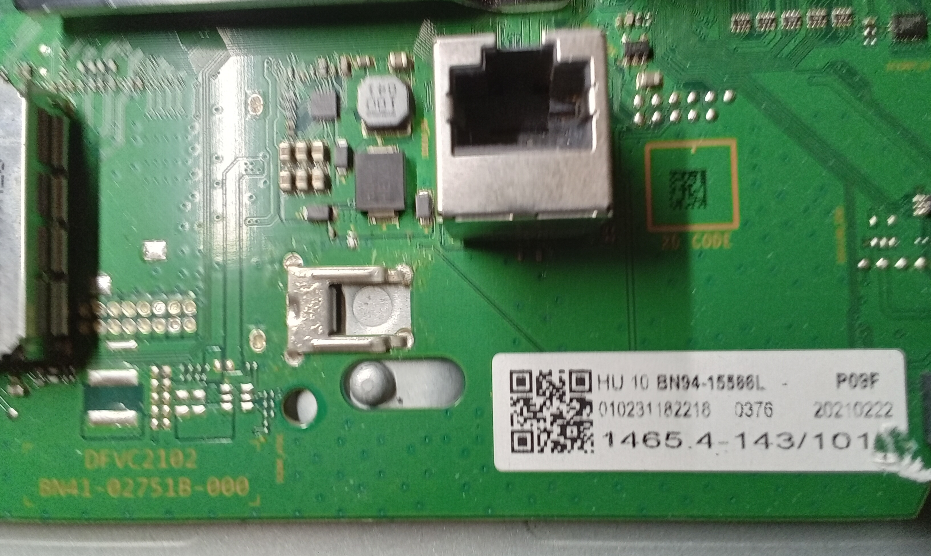

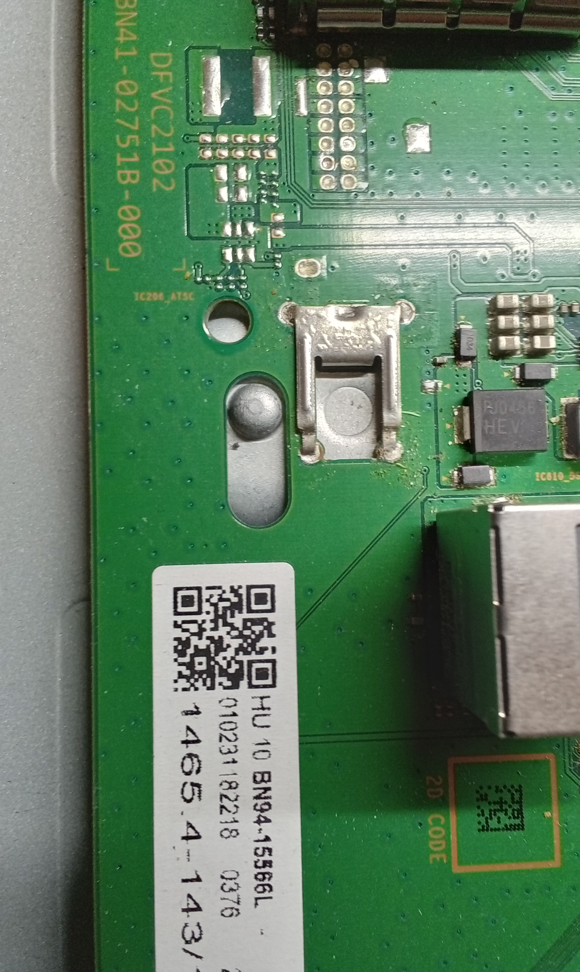

                                    Hi Diah here some pictures of both boards the native one has hand written notes on it
                                    the first row of pictures is the old one
                                    • Diah
                                      • Feb 2013
                                      • 6440
                                      #118
                                      did you soldered out part from the original boards close to the LAN port? its look huge short caused at it which effected the IR boards..
                                      by the way yours jumpers don't let with chassis in contact
                                      • Diah
                                        • Feb 2013
                                        • 6440
                                        #119
                                        Jumpers should solder in 90° of points not from side.
                                        • bohaboha
                                          • Nov 2012
                                          • 1017
                                          • sweden
                                          #120
                                          no i dit not solder anything on the board and the jumper i desoldered one side of it but leave it there for further test if it needs.
                                          is the pictures good for your request?
