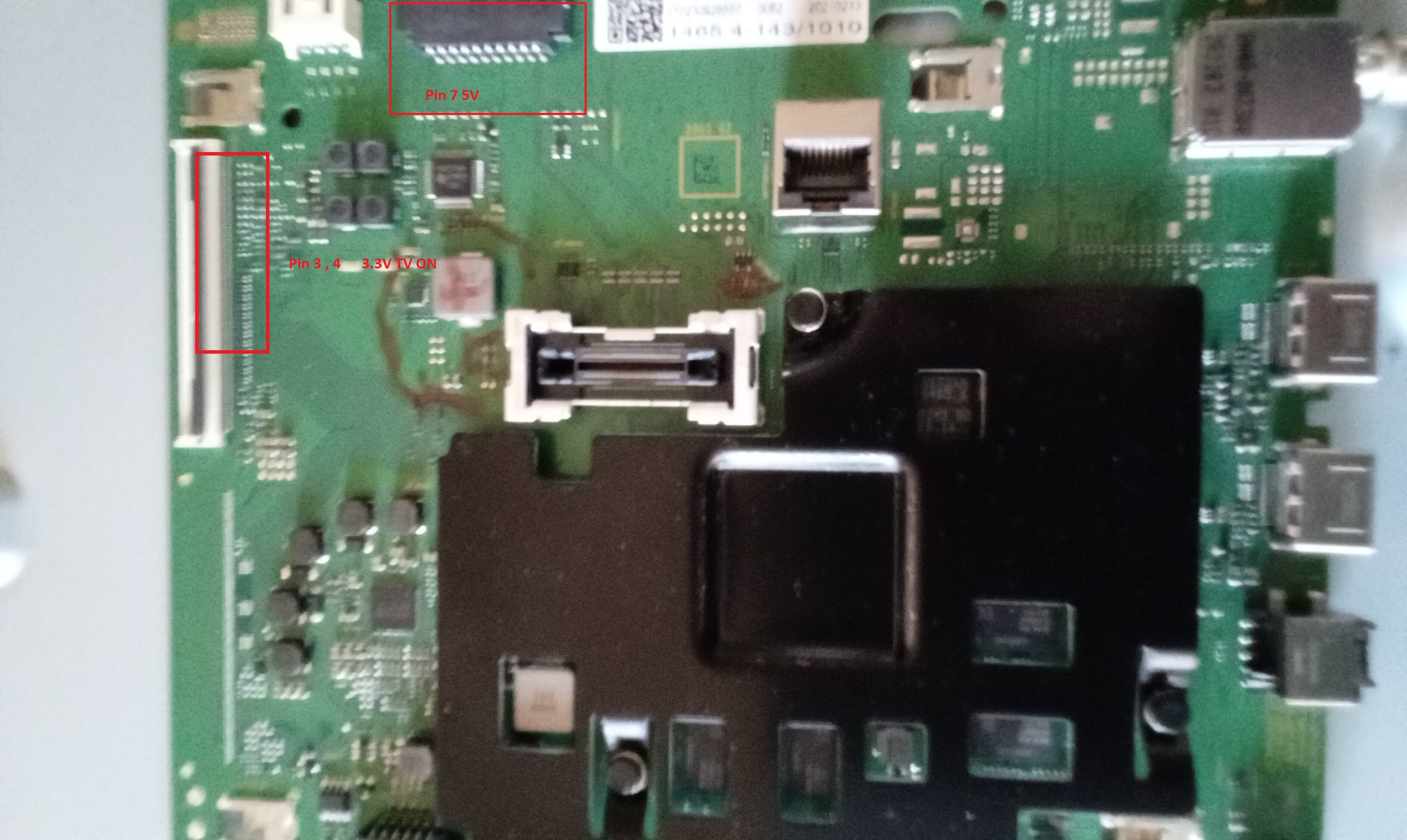

            #65
            Originally posted by bohaboha
            please can you point out the socket CN1101 and can i dot it only on stand by?
            PIn 7 at STB 5V ... LVDS 3 ,4 3.3V when Tv on
            Click image for larger version  Name:	20250105_132135.jpg Views:	0 Size:	1.37 MB ID:	3545110

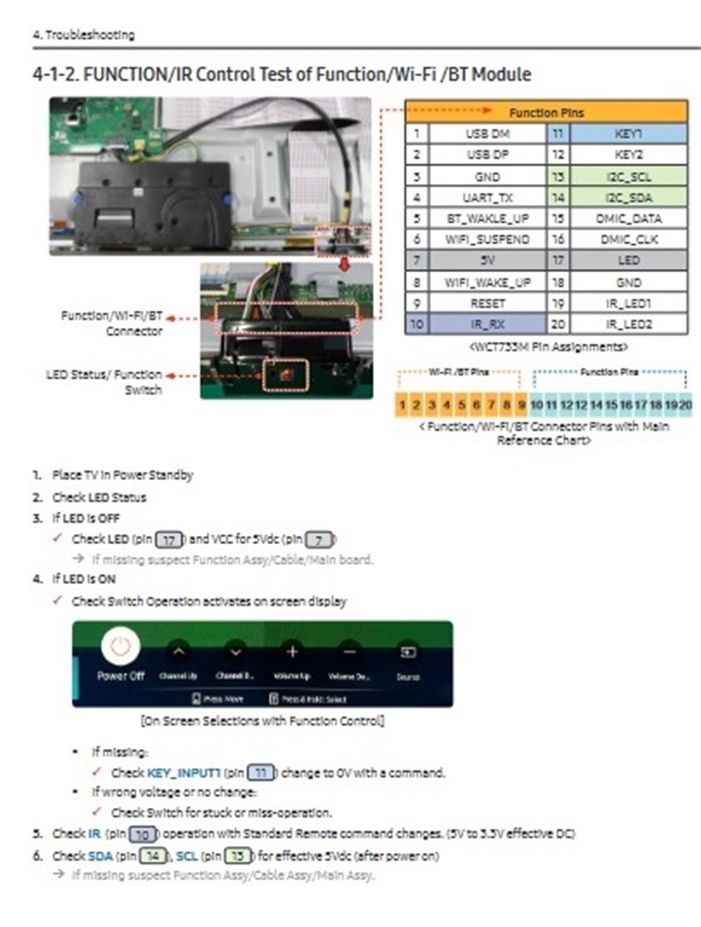

              #66
              check yours RC if it blink with yours mobile camera... easy method.. here are the diagram of the socket
                on lvds 3 and 4 have 0.4v 0.8v
                Pin 7 seems to be short but there is 3.353 on1 and 3.15 on pin 4 then i have 5.191 on pin 12 3.381 on pin 13 then 3..313 on pin15

                  #68
                  3.3V will generate one time only it used also by TV RC of the wifi / BT module... as well the IR so any one have short will kill this rail

                        #71
                        Click image for larger version  Name:	IR-WIFI-BT.jpg Views:	0 Size:	170.7 KB ID:	3545135
                        When I press on on the RC STBY goes out and returns directly in the same position as if it can't start the TV so the RC works.
                        I have managed to get rid of the black heatsink.
                        thanks for the chart but it's not exactly the same because on my kontact pin 6,16,19 and 20 are free(not used) plus I only have a start button
