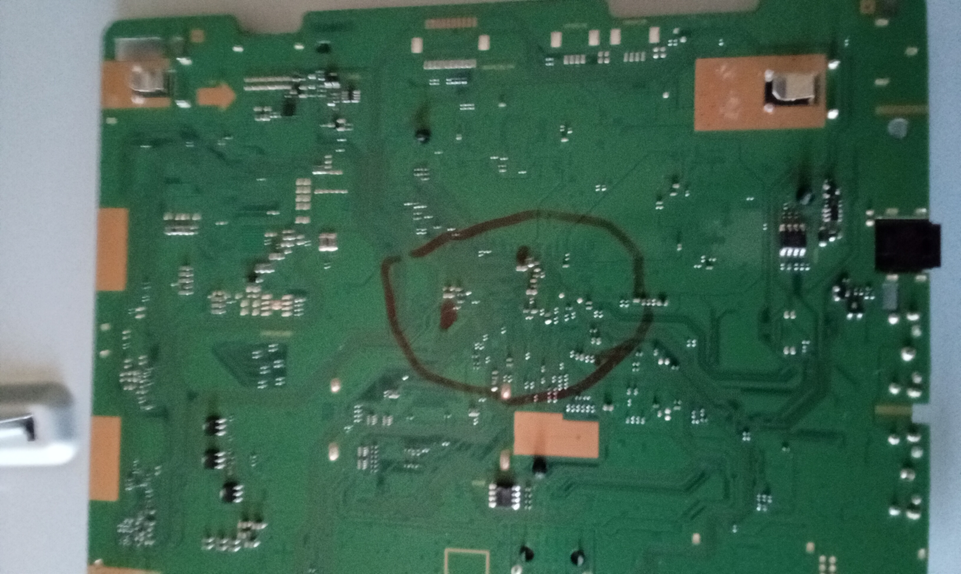

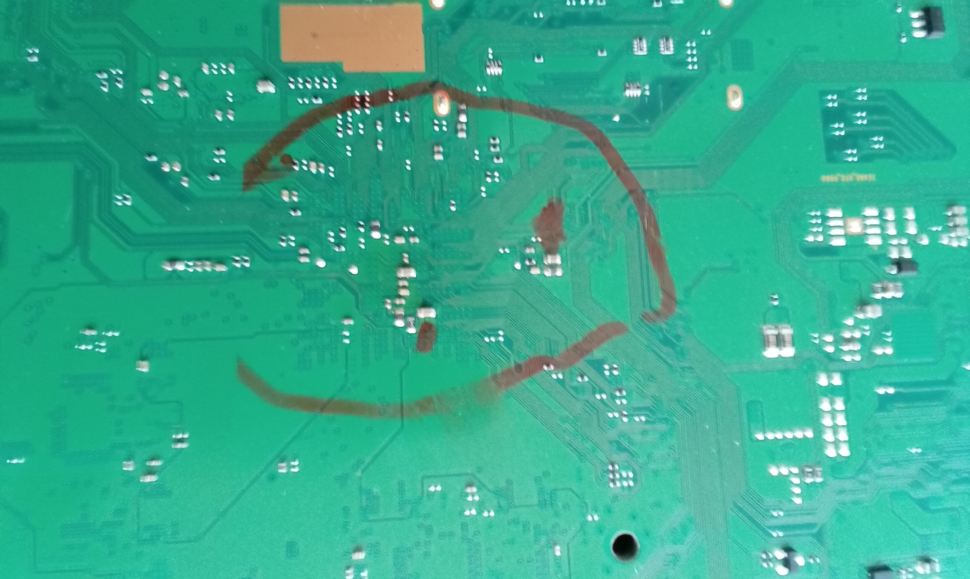

                  now I have tested the main board and found short on R82 2051 and the 4 capacitor around and on the backside a few more

                    #29
                    Can you post a good clear photo of this area?

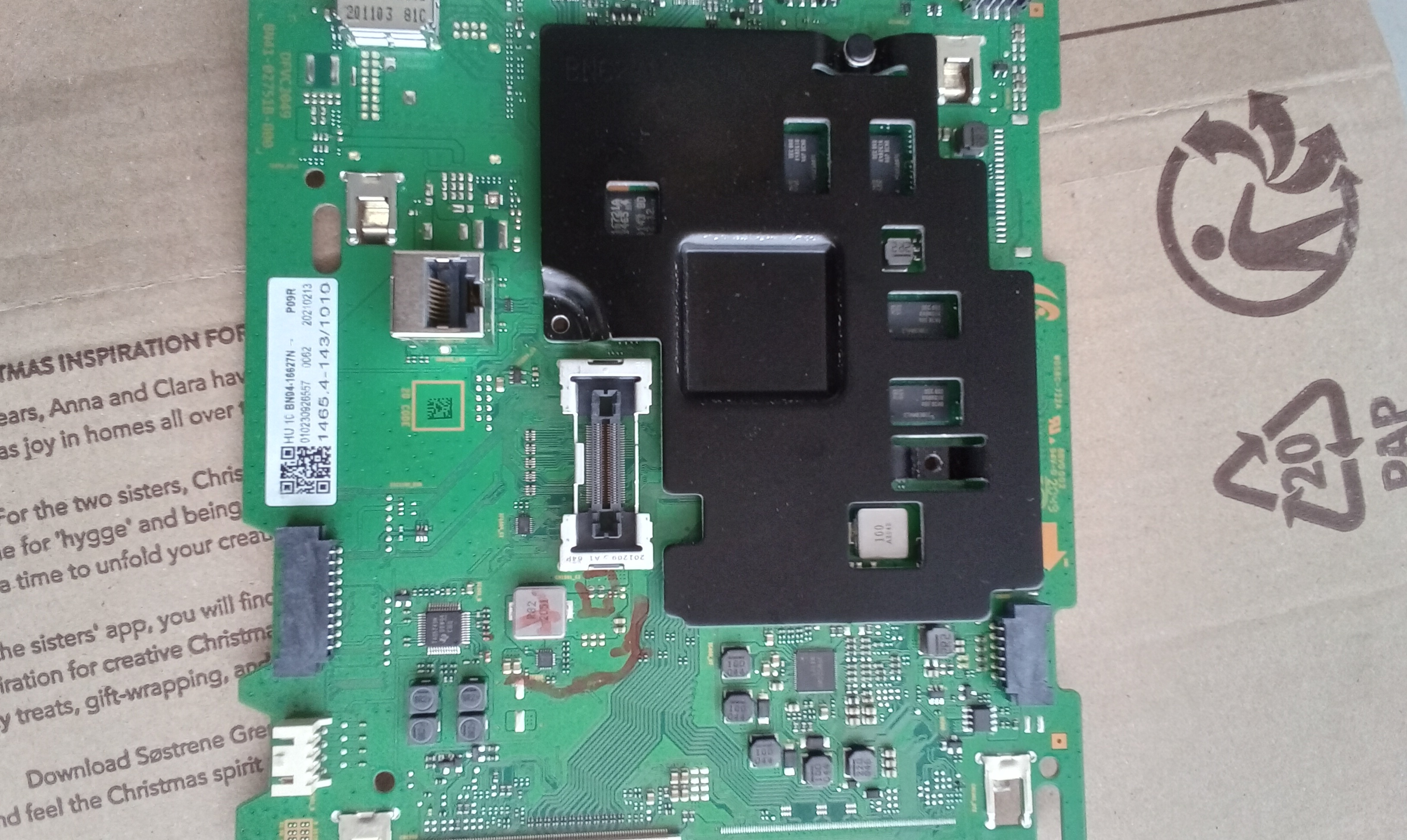

                      #30
                      here 2 pictures with the position of the short the black cover is a bit hard to remove maybe i need to warm it a bit

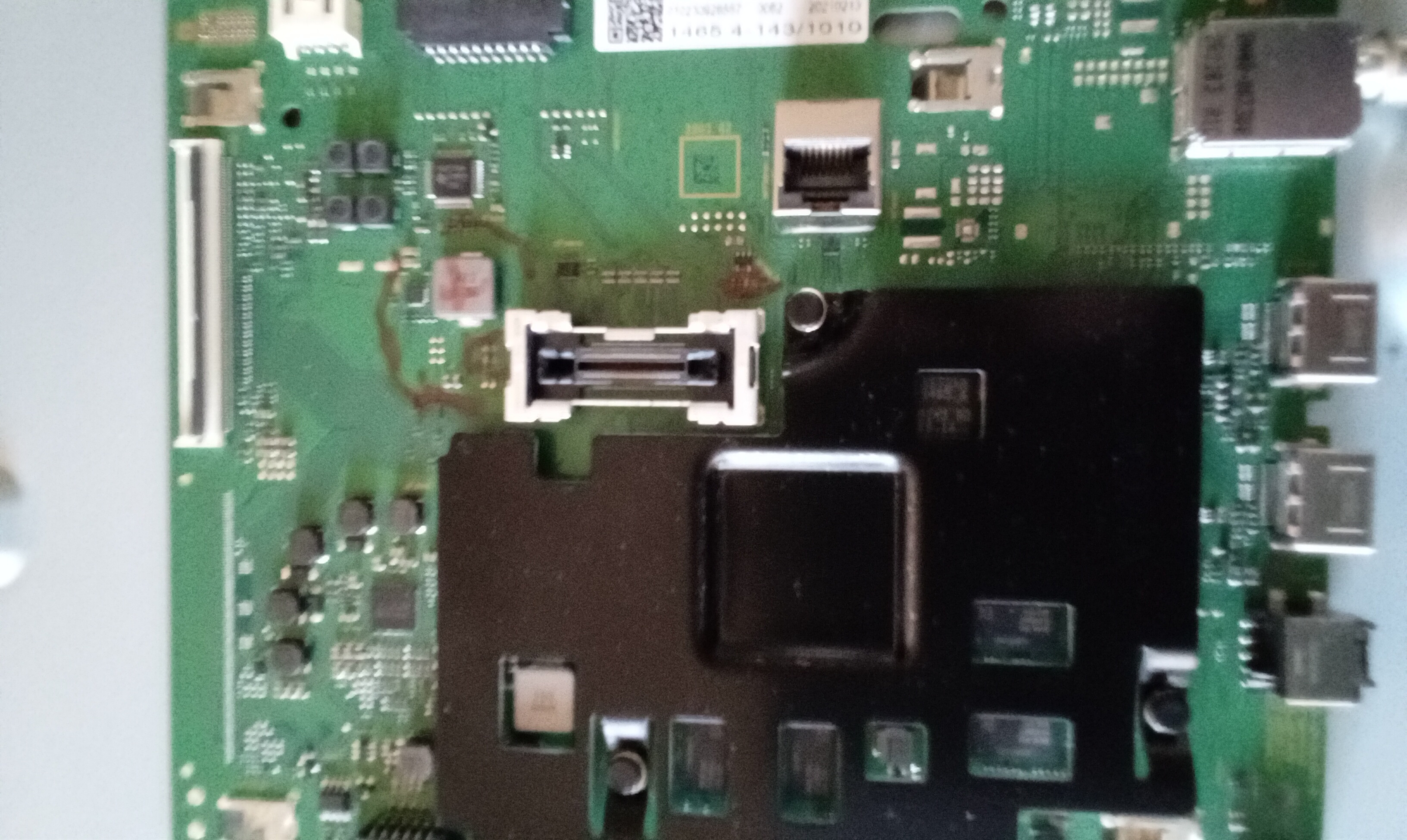

                        #31
                        here some pics do you have any idea how i can remove the black cover it seems to be glued or i do not know because it is a bit hot there

                          #32
                          The picture isn't very clear, is there little plastic bits poking thru the rear of board? If there is you need to squeeze them together a little to let them thru the board.

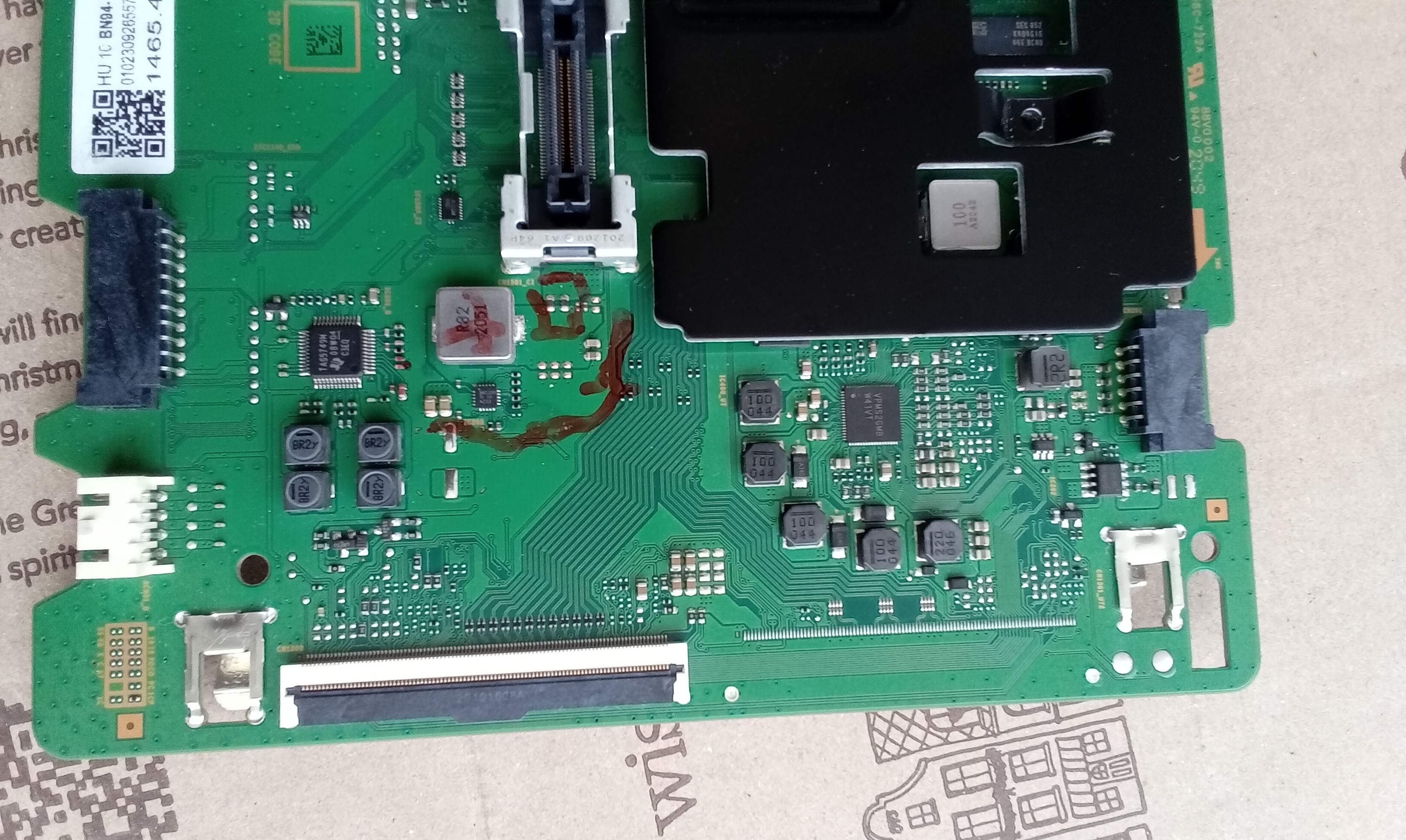

                            #33
                            all of them are loose but the heatsink seems to be glowed in the middle. how shall i proceed with the short to eliminate

                              #34
                              yours photo... the area and parts you marked no short at them... they related to the TV SoC as filter installed outside the SoC.
                              inside the Soc there are Coils and connection need to have filter no place inside the Soc for them.

                                  well for me all Panels with sizes Even Numbers such 50 60, 70 are rubbish,
                                  as i wrote before the one i solved was 75.. and the issue was at the chip DC-DC Converter as you have on boards VPMS2GMB

                                          what kind of guide you are looking for ? i wrote the issue was VPMS2GMB ... if you don't have the ability and instrument to approve yours converter work and provide all V DC to the chips and T-CON On boards and SoC..!!!
                                          what i should write.. search after data sheet to learn where and how it converted V DC to T-con on MB and SoC. are you waiting from me to deep my head and instruments at yours room via web ?? funny.
