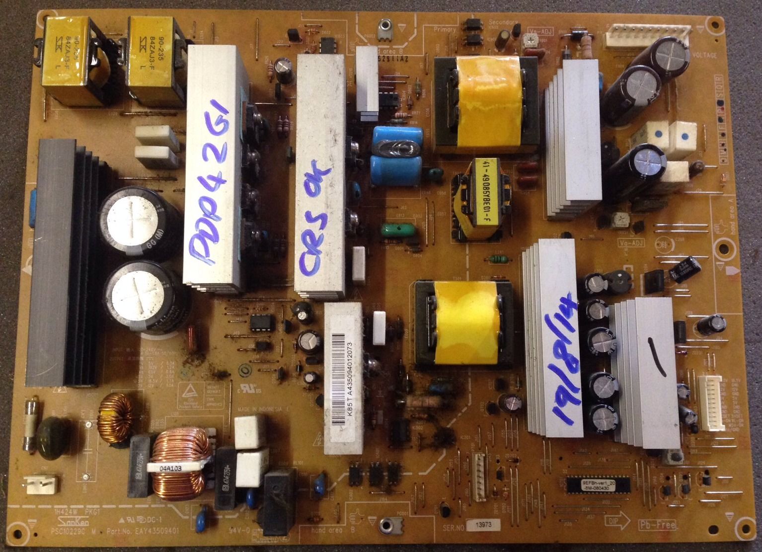

    I have been attempting to repair an LG 42PG6000 series Plasma which so far has me a bit stumped as to what to try next.
    When applying power to the set the standby light blinks green 18 times before returning to a steady green. The screen appears to lighten up but no display only very fine sparkles when viewed up close and occasional pulses of brightness.
    I initially checked the voltages on the PSU which all appeared to be in order disconnecting Y-SUS Z-SUS boards and rechecking but did not appear to affect any readings.
    I replaced the main board with another similar matching board which made a difference to the startup behaviour and this time it would power on / power off 3 times before displaying the blinking green LED before steady green.
    I have also replaced the control board but this has not made any difference.
    My thoughts are now returning to the PSU board and wondering whether a component fault may be affecting the power output in some respect?
    There is one small capacitor that could be bulging ever so slightly but nothing else really that noticeable - all looks to be in order.
    I will run through the voltage checks again to double check but are there any other issues I should look out for on this model?

    I have now completely overhauled the PSU to rule out any issues with power by replacing all caps and Q801 / Q802 / IC801 and related diodes and resistors.
    TV will now power on and blink green 4 times and then shut off and repeats this cycle about 4 times before remaining off with red standby light.
    Tomorrow I will attempt to check voltages once again on PSU with and without X / ZSUS boards connected to try and rule out sus boards / buffer board faults.
    Think this one is going to be a bit of a long haul...

                      I have the same problem as the original poster, (42PG6010) one click from PSU (EAY43509401) on plugging power in, one click when unplugging power. Led on power button flashes 18 times no sound or picture.
                      No obvious signs of bulge or leaks from caps and on reading the above posts I'm guessing it can be a number of things that cause this.
                      1) Is it possible to flash via serial even though ive no picture or sound?
                      2) Would replacing the PSU resolve the problem
                      3) Are their any known issue's with that particular PSU that I could try.
                      4) Any advice to get this working would be great, its my sisters TV just over 2yrs old and a bad time of year for this to happen.
                      Thank you.
                        Re: LG 42PG6010 No Sound - No Picture
                        The click appears to come from the part with the barcode on it.
                        Can that part be replaced.
                        Thank you.
