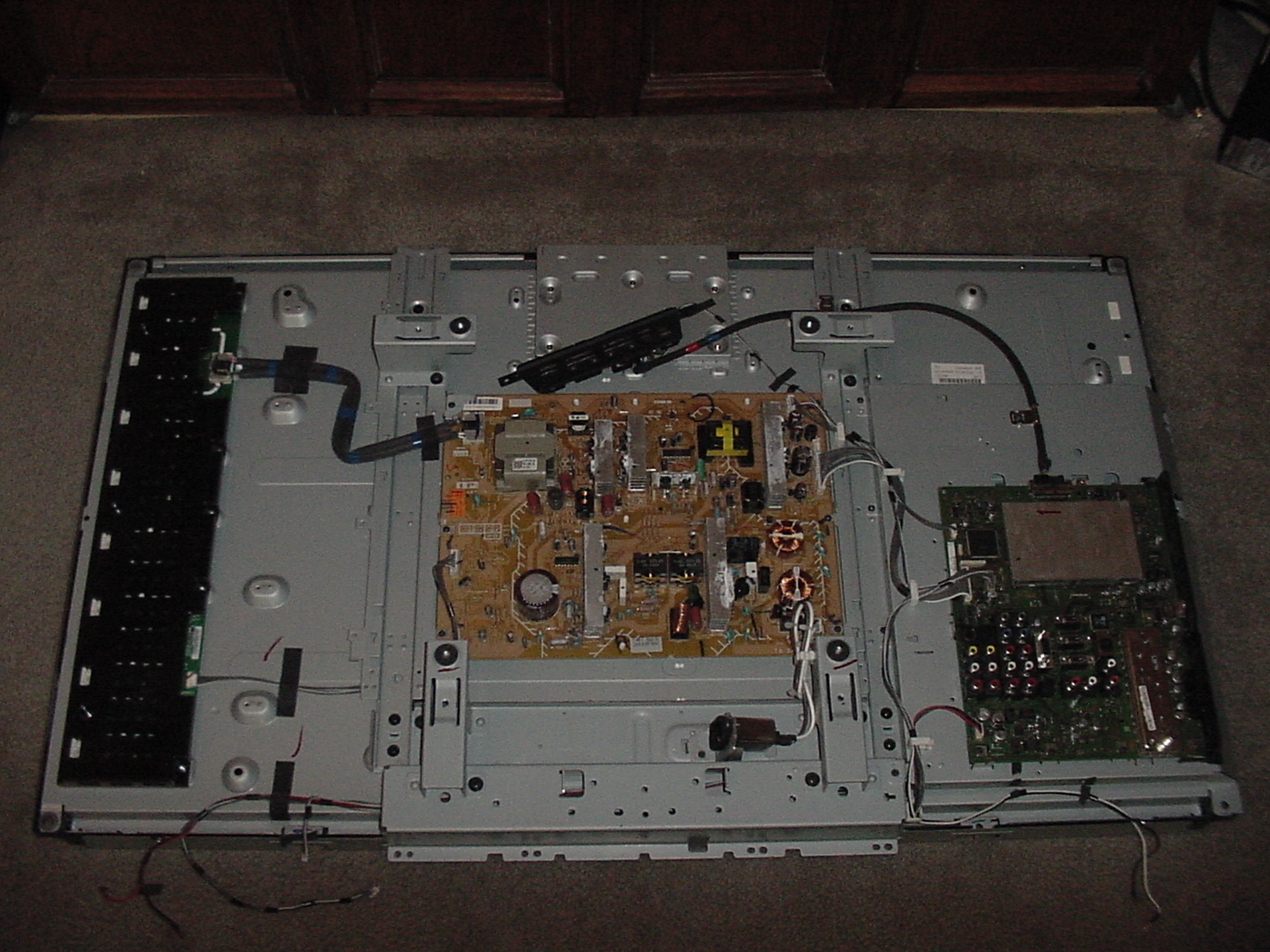

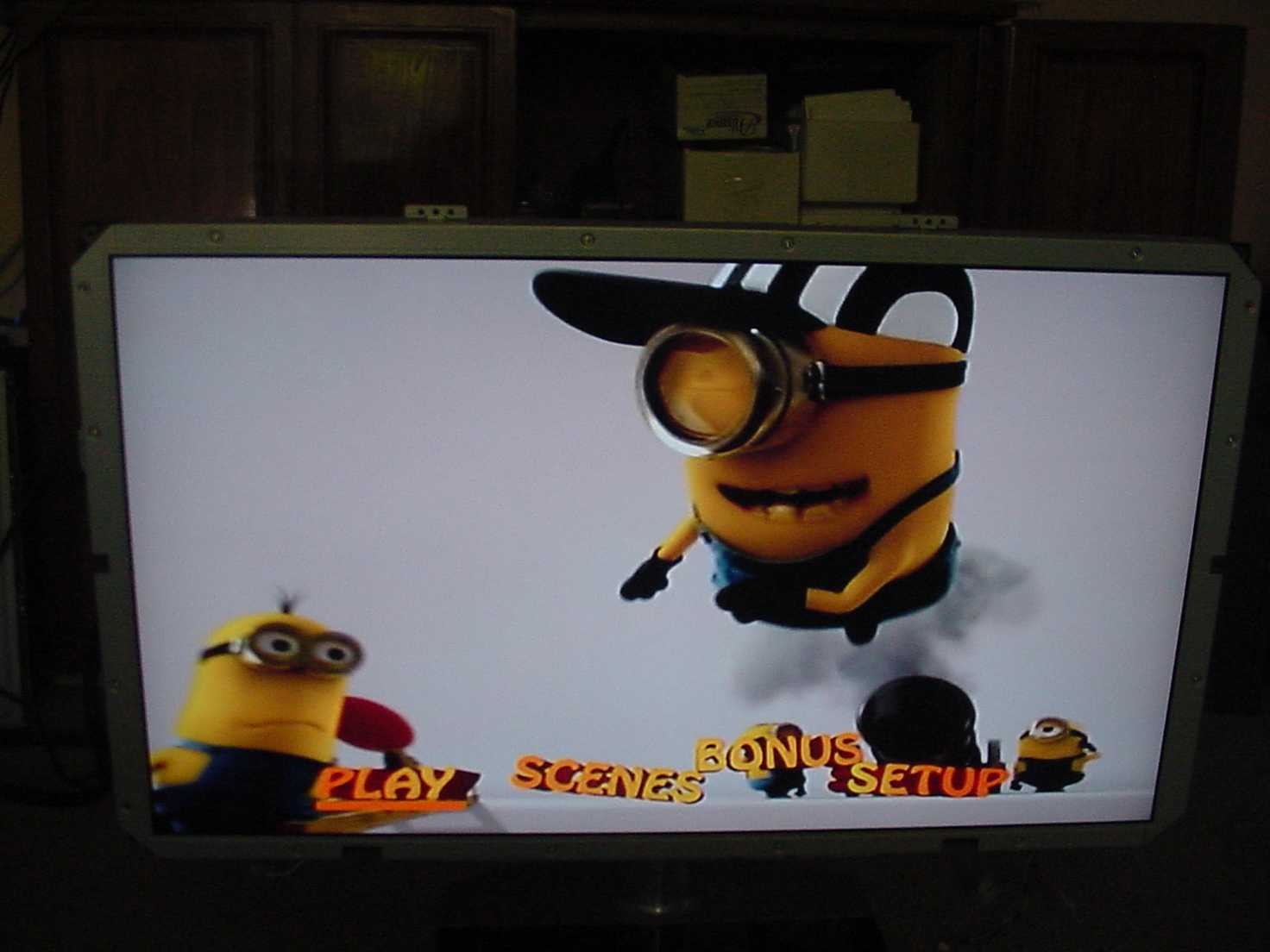

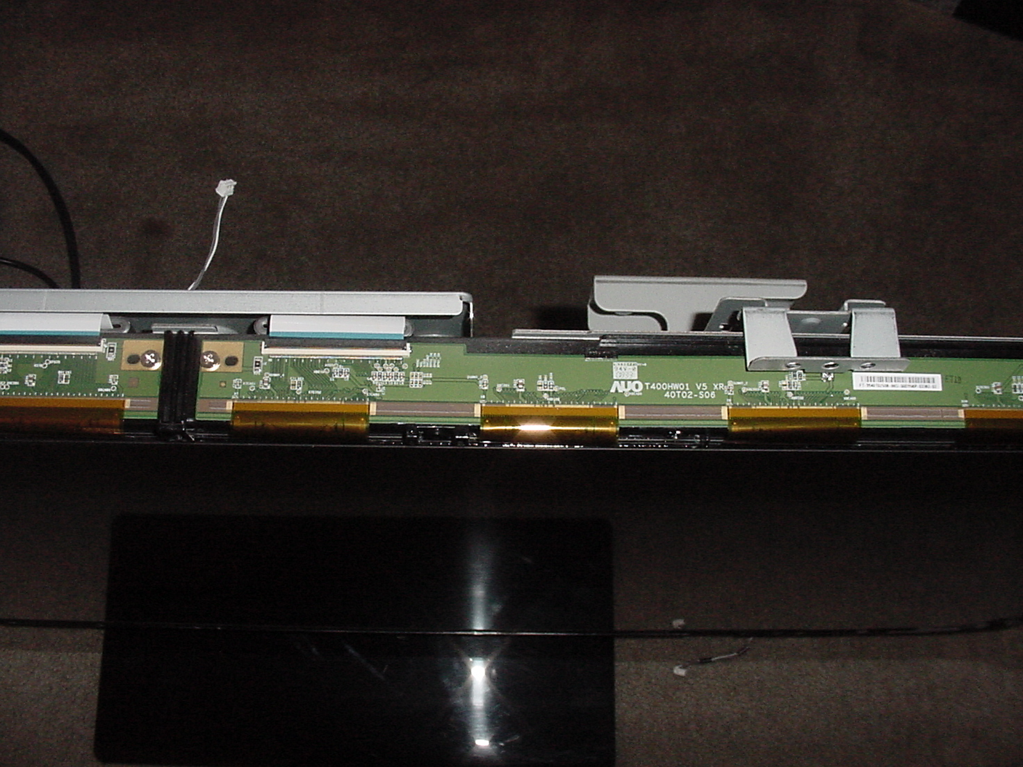

    This TV has horizon black bands (about 0.1") on the 3.00" on the top section of the screen, the bars will come and go when I flex the panel.

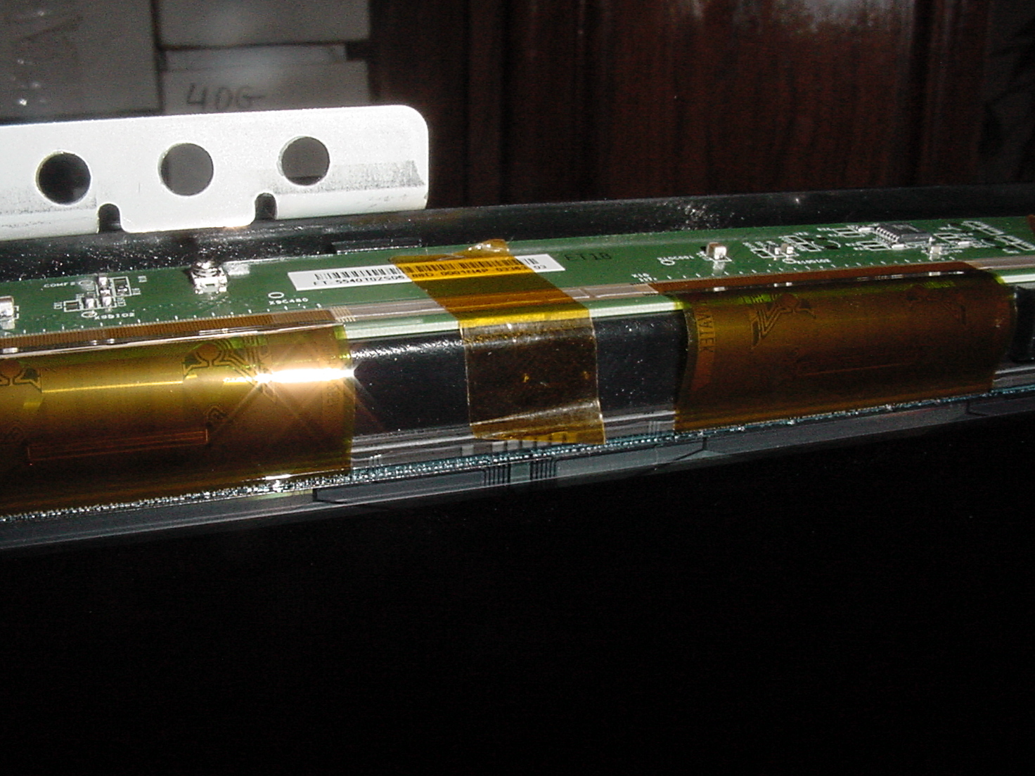

    This time I use silicone thermal pad from Dealextreme # 118741. I fold it into 3 layers and install them on top left (this is the one with bad bonding) and on the top right. I did not do them all just to see how well this fix will hold up.

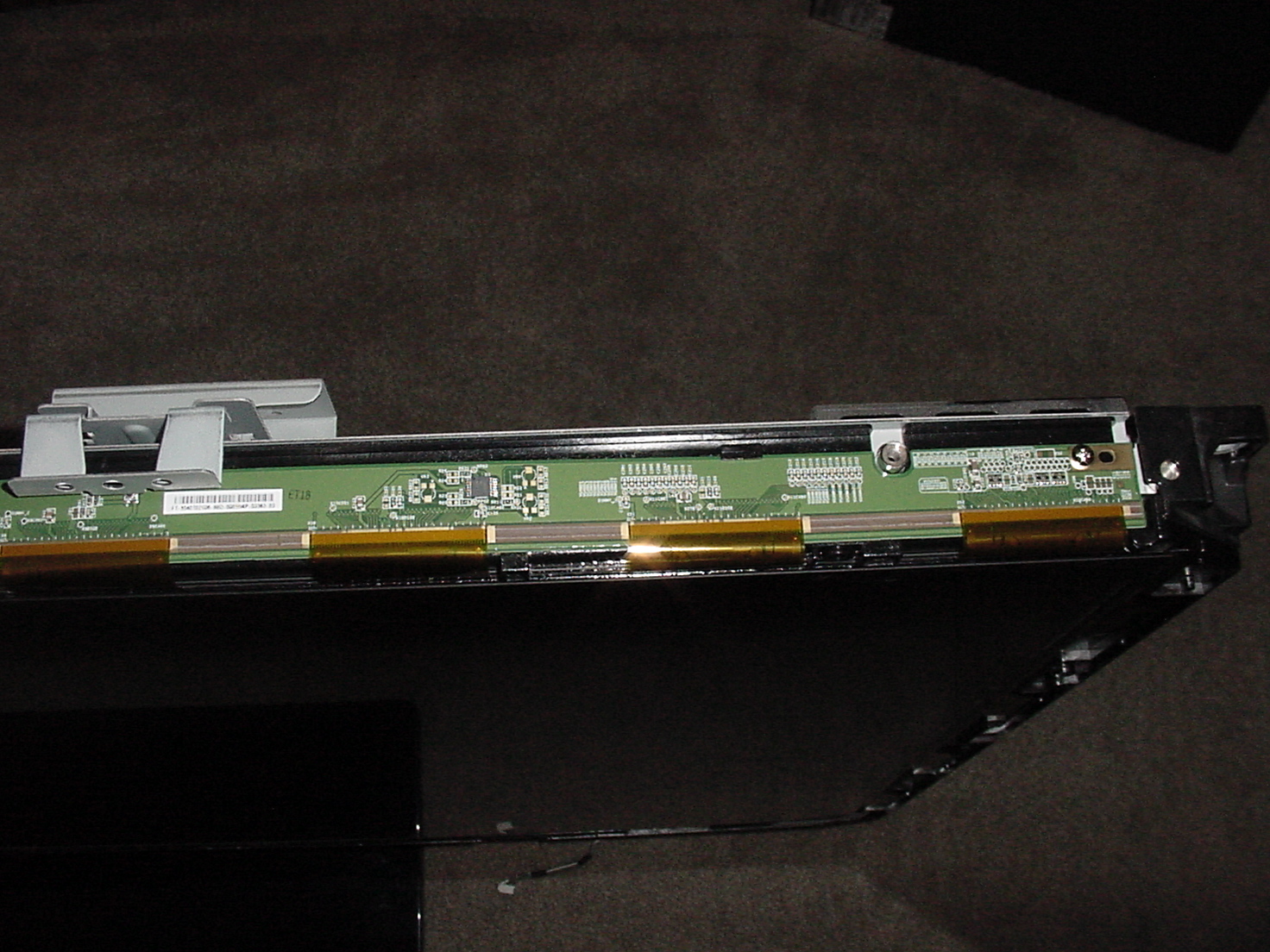

    The PCB on the right was also curving up badly that the trim pot also touch the frame, I use KAPTON tapes to hold down the board flat.

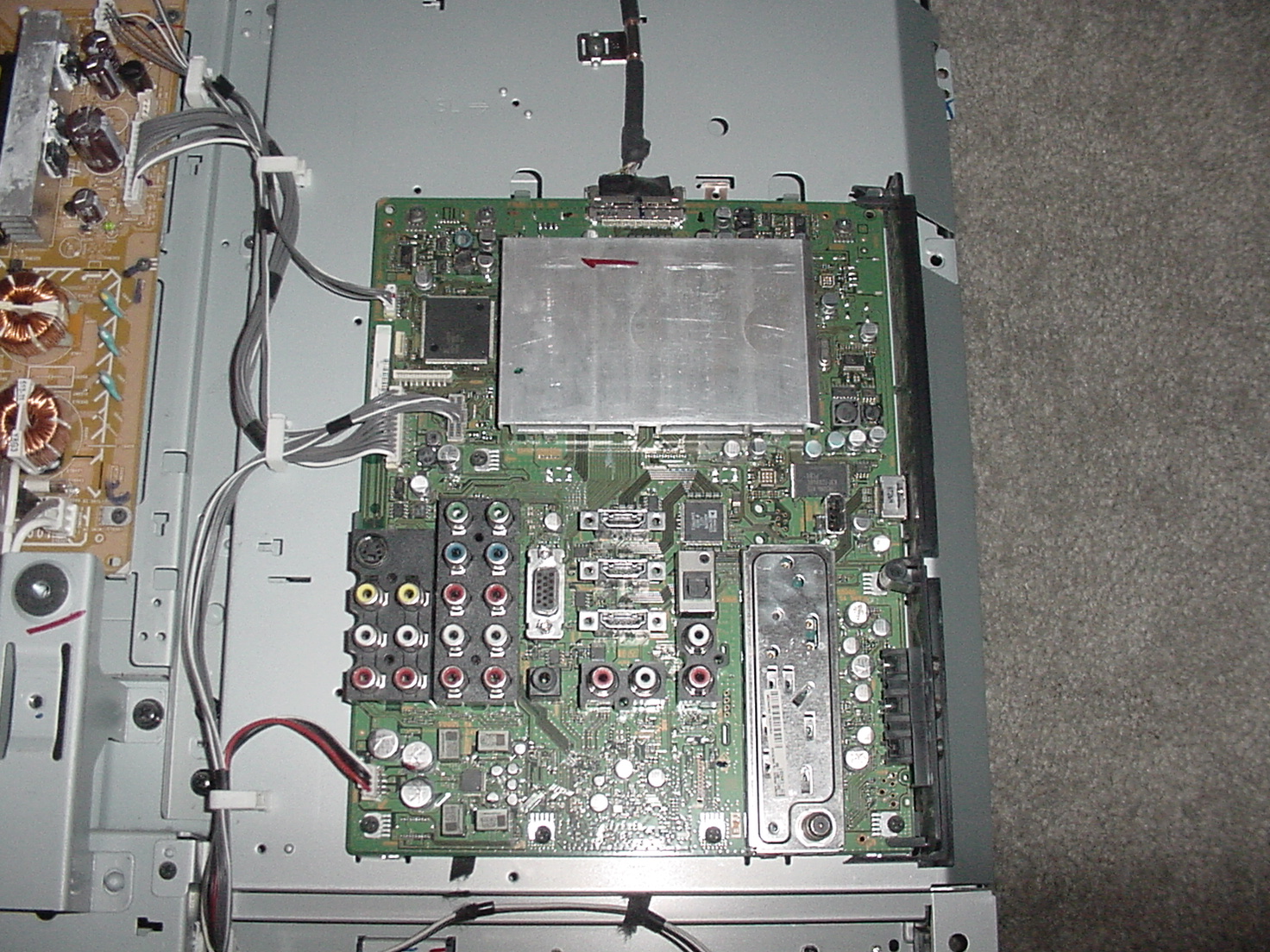

    This chassis i easy to work on, I was able to mount the chassis on its stand to keep it upright.

        Good choice for a demo flick
        So you tripled up on that Dealextreme? How thick do you think that was when you did that?
        I hope the Mitsubishi I am going to attempt to try this on is as easy to get to like this Sony
        thanks for the picture tutorial!
          Re: SONY KDL-40V4100 Tab bonding fix
          It is about 6.2mm not compressed and about 4mm when I squeeze with my fingers. The good thing is that it is sticky so it stays in place real well when I put the frame back in place (you will put the frame in with top section in place first). Time will tell how long it will last.
                      It is the heat transfer pad, from Digikey (see the P/N in the link) or Dealextreme.
                      The top section of the TV gets quite hot.
                          The thin one from dealextreme is folded into 3 layer, the one from digikey is only one layer.
                          Dealextreme is a lot cheaper (you get more) than the one from Digikey.
                          These pads have stickiness to them but I use KAPTON (high temp tape) tape to hold them in place also

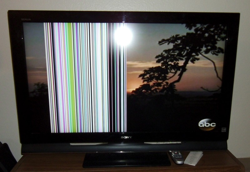

                                  Here is a pic of it right now. I have other stuff to deal with right now.. but I'll get around to trying to fix this eventually.
                                  I factory reset it since it was stuck in Spanish and I couldn't see the menu. My comcast remote set to the TV worked to let me do that. I could see enough of the prompts to get it going in English and program one channel for the SD cable box.
