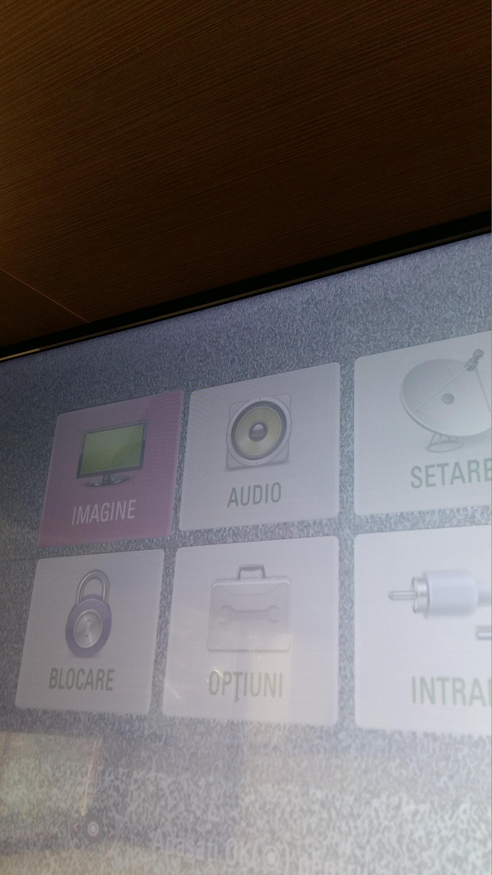

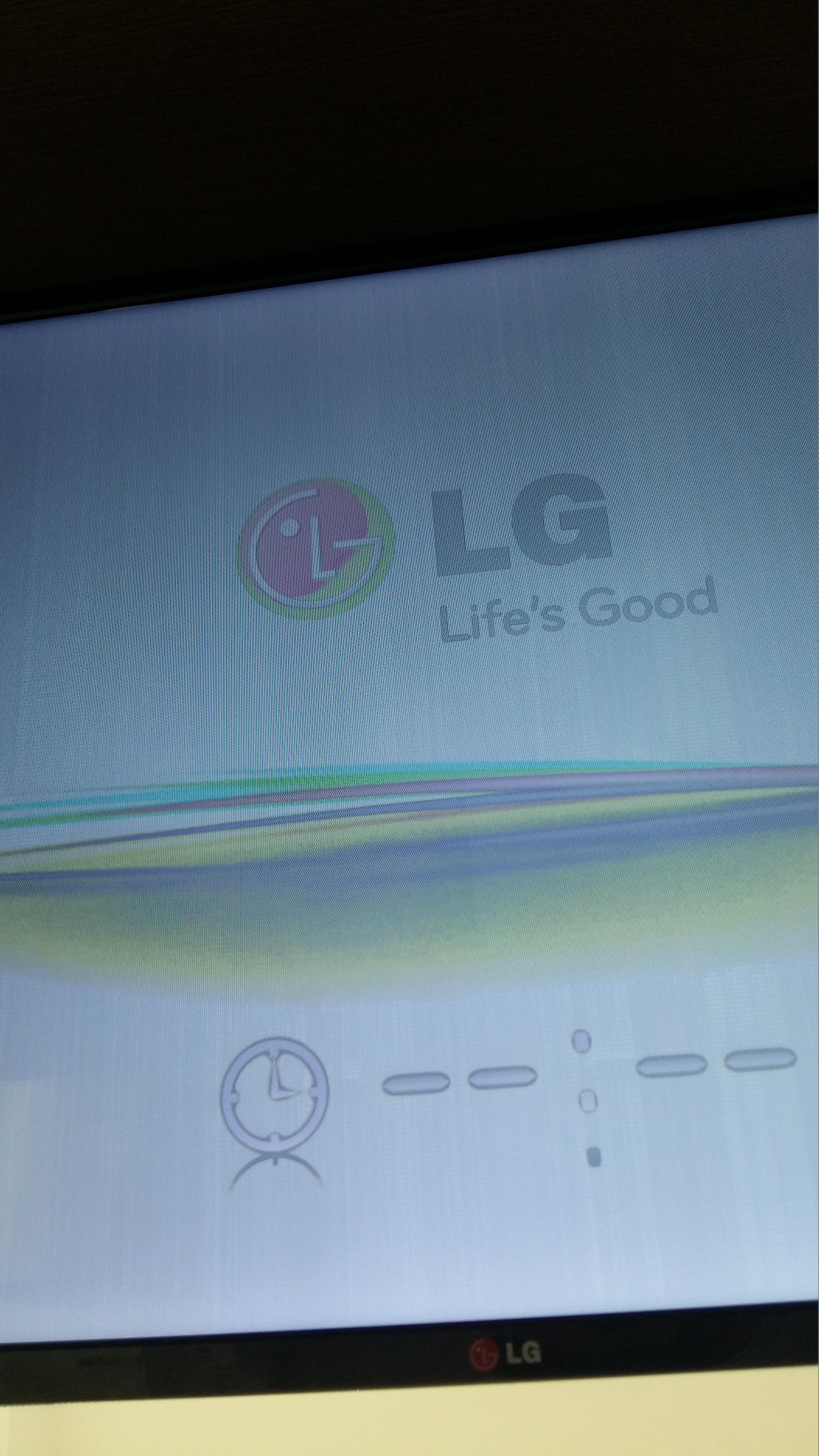

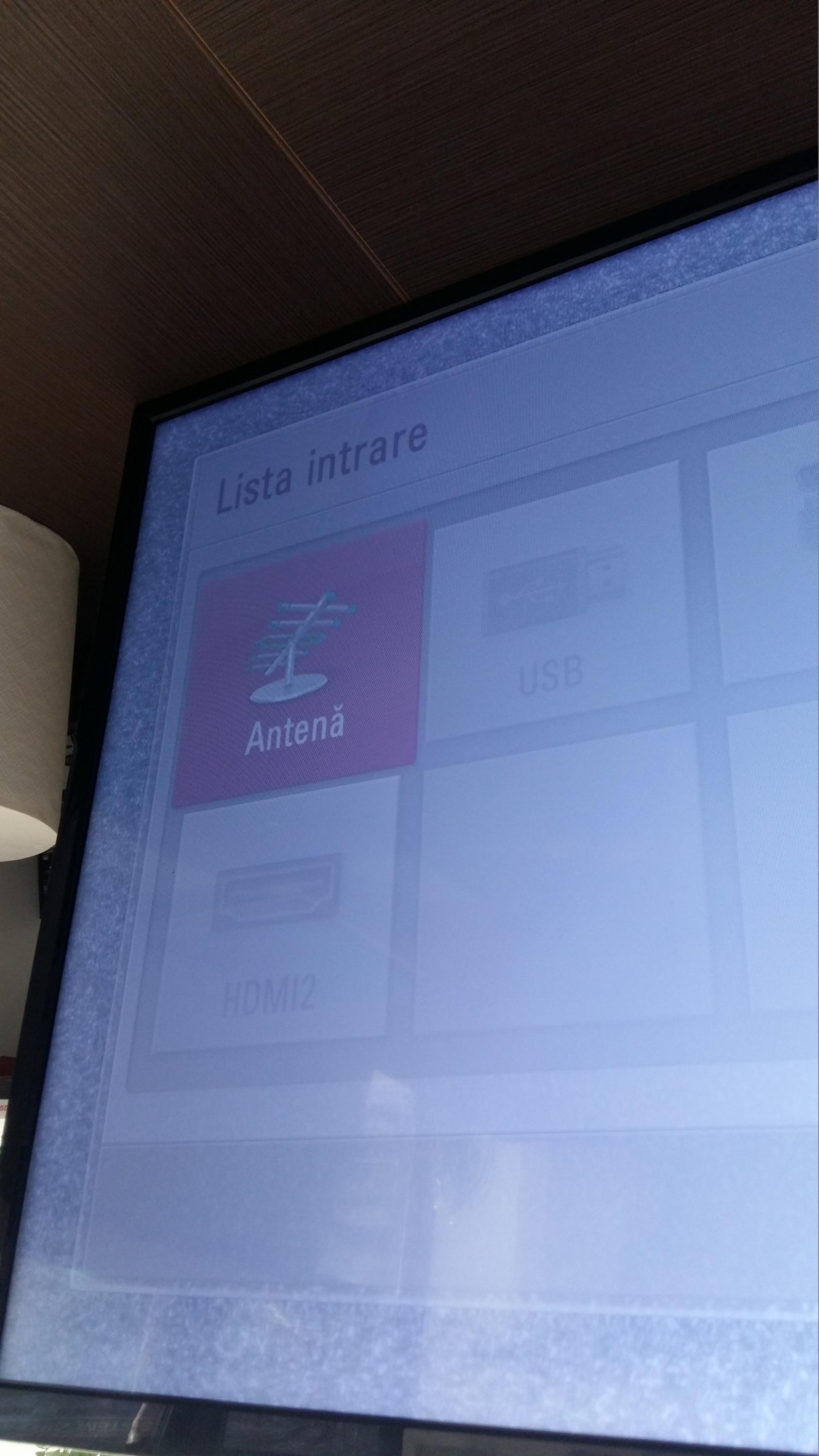

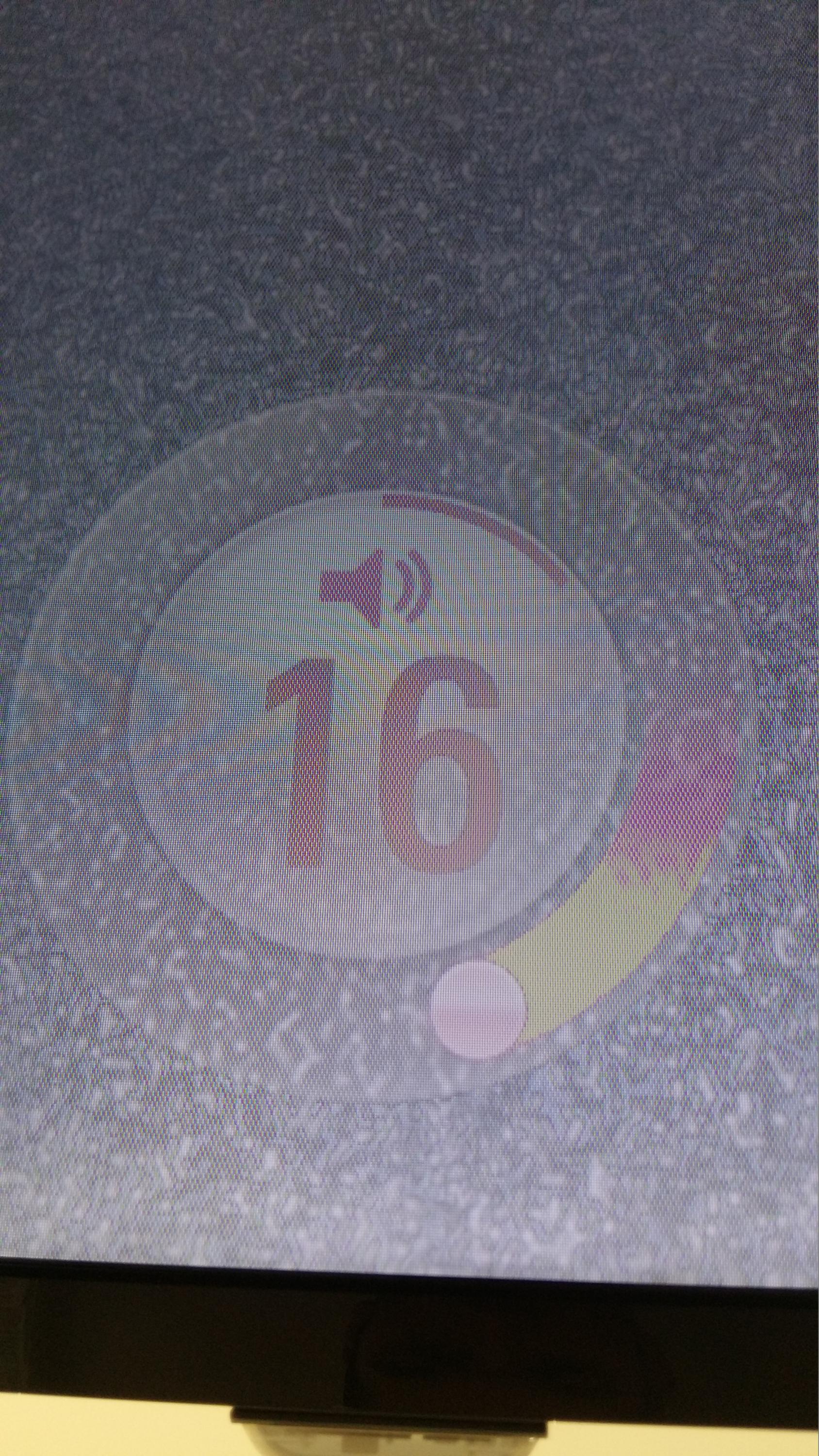

            I ask here , i dont want to open another topic,
            i have a problem with 42ls3450 display panel . see photo ,
            problem with panel or t-con ?

              Re: LG 42LS3450 powers off
              Looks like AS-15,--If it has one....
                have a TPS65178 , and in few seconds is hot
                  Unplug one ribbon at a time from the T-con (on the LCD panel side, not the LVDS cable.) If the TPS chip cools down or half the picture looks normal, it's probably a short on the panel and there's not much you can do about that.
                    i try this, i remove one ribbon ar a time , but no image right or left side, only vertical lines
