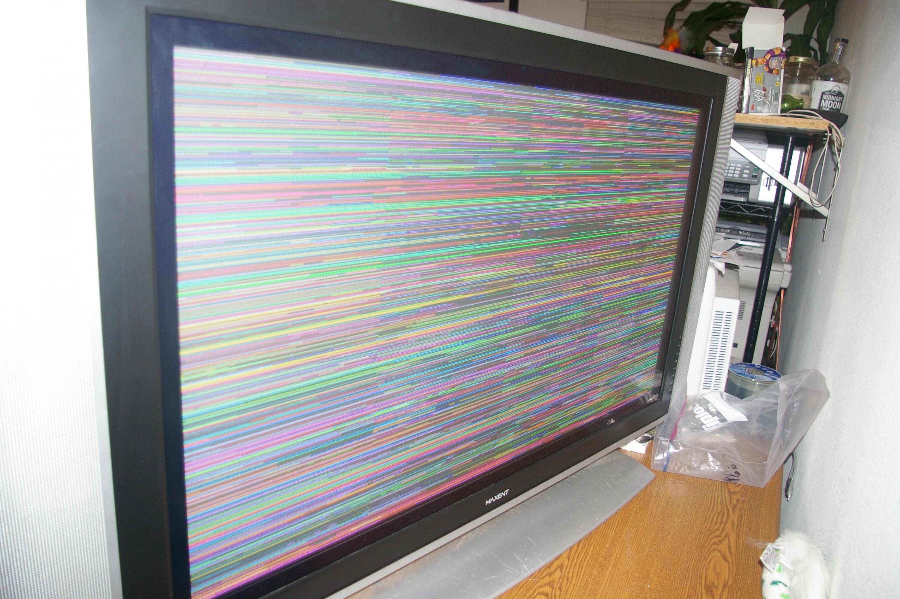

    I just picked up this heavy maxent plasma. My goal isn't to fix it, but to salvage parts, but I need to know what boards , if any, are bad on the unit.
    Powers on, and primes OK. Then , at least several minutes later, the entire screen starts to flicker with a faint noise and a horizontal line "static" pattern. It was hard to get a picture, but I have attached what I could.
    Thanks for any ideas.

          I may be mistaken, but I think the flickering and horizontal rainbow static seems to go from less intense to more intense as the set warms up. About 5 mins in, it's just flickering a bit , with mostly black screen. Eventually, the whole screen fills. I think when I press the menu buttons, I can see a change in the flickering/static pattern.

                  I believe the flickering is both display and backlight. When the room is dark, it looks like one of those scary movie tv scenes with random flickering against the wall.

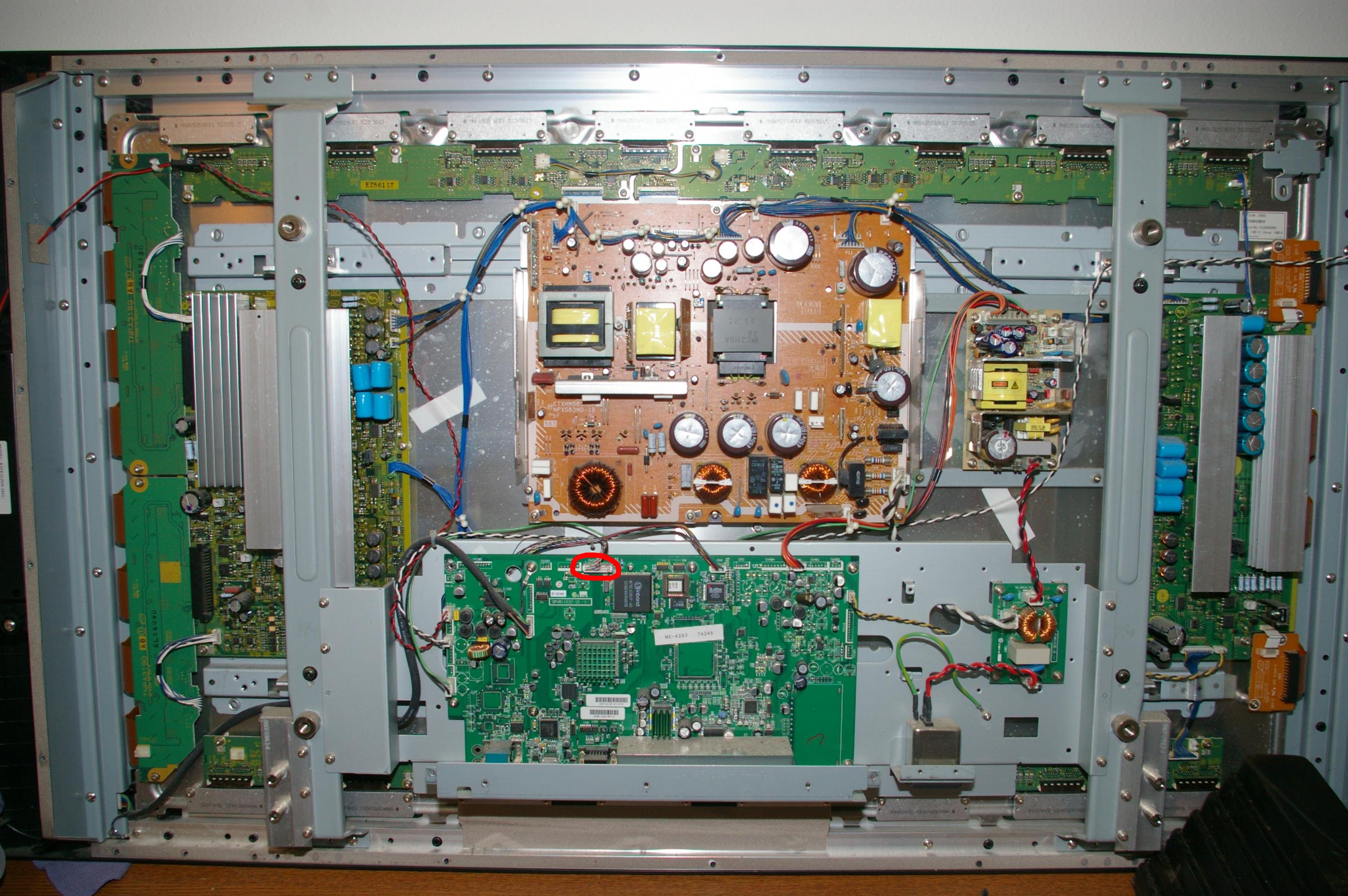

                    Panasonic panels do have test patterns but AFAIK you have to connect it to a Panasonic main board to activate them. What you can try is pulling out the LVDS while it is running. If the image freezes there is a fair chance the main board is the cause of the fault. It is hard to be certain though. It will be main board or D board in my opinion.
                      Re: Maxent MX42-x3 flickering rainbow display?
                      LVDS? Not exactly sure where that is located. Here is a picture of the back.
                        It looks like the main board on this unit has had many "flickering" and line related problems in the past when the set was newer.
                        I think I found the LVDS if it is that small cable with the separate ground connection going to the mainboard. If so, unplugging it seemed to have no affect on the display.
                        I'd just like to narrow this down to the parts that are definitely "not broken" at this point, because I might try to sell some of these, or keep them on the shelf for other use.

                          This is the LVDS.
                            This is the LVDS.
                            Well, when I unplug that one, the screen goes from the flickering action back to just black, with a dim backlight.

                                It sounds like a bad main board but it is not possible to rule out the other boards.
                                The SC, SS, SU, SD and P boards are all probably OK.
                                The D, C Panasonic boards, and OEM's main board is suspect.
                                Please note a plasma panel does not have a backlight, what you are seeing is known as the priming glow.
