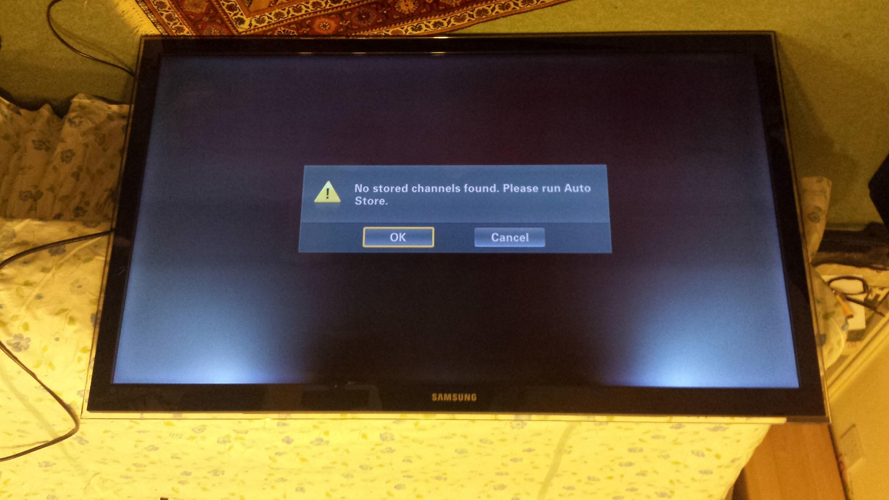

    Im currently working on this Samsung 46" LED tv which has two bright patches on either side of the screen (roughly where the speakers are mounted under the frame).
    Originally this TV had a faulty main board (which i have now replaced) but this particular symptom remains between the old and new main boards.
    Any suggestions on what to check please?
    Thank you,
    Demon

    My first guess would be something related to the LEDs on the bottom of the panel. Have they perhaps moved out of alignment while you were working on the set, or perhaps the diffuser film near them has? Alternatively, it is possible that those LEDs are stuck on 100% bright for some reason (whereas the others are on something like, say, 50% brightness.)

      ..or maybe the middle ones are off.

        2 very distinct points,
        maybe it's a group of 3 in series and the center one is shorted.

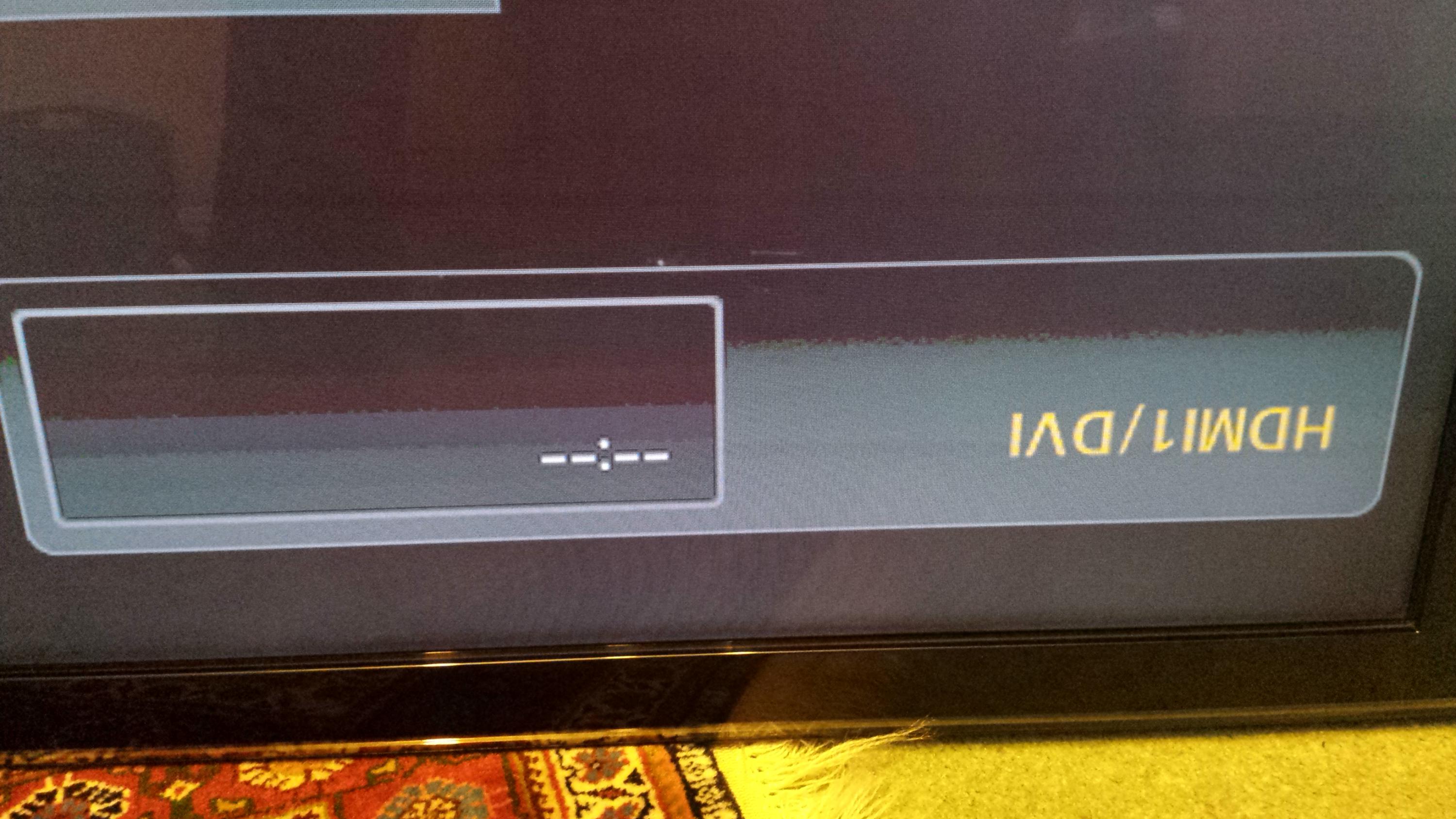

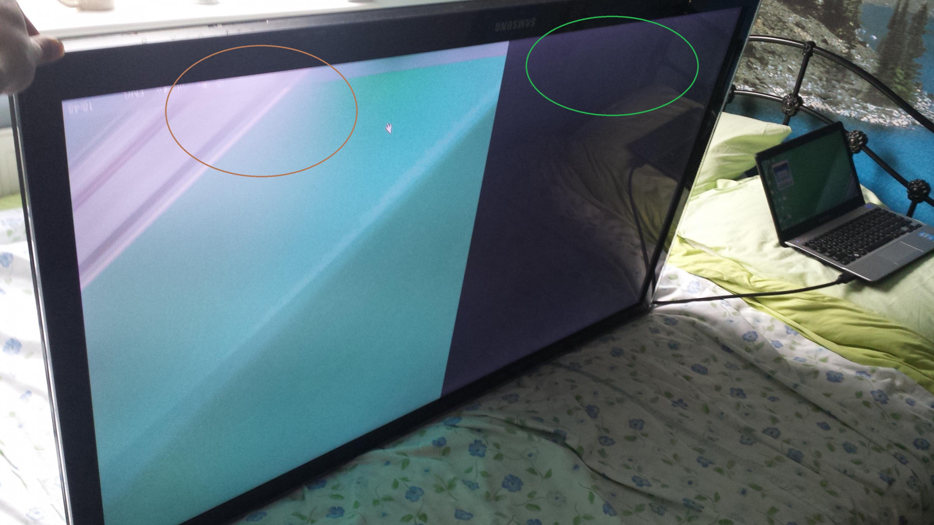

          Could this be a T-con issue? The reason i ask is that today i unplugged the LVDS cable and the backlight alone came on and the screen was fairly uniformly lit...
          I then connected only 1 side at a time on the T-con to test each half of the screen and had the same result - the side with the image had a bright patch (red circle) and the side without an image was uniformly lit. (pictures attached)
          I noticed that on darker images as well that the contrast gradient was very poor - The transition between colors was very "blocky" (see pic for example... it is not as smooth as i would expect). would this suggest it is a T-con problem? Is there any way to test?

            Re: Samsung UE46C6530 Bright patches on screen
            That's very odd, I have never seen a bad LCD panel do that (overbright in corners) so I don't know why it disappears with the ribbons out. Would you say the effect is completely gone? The image being solarised with one ribbon out isn't entirely unusual.
              Hi Tom,
              Yes on the side with the ribbon cable out the backlight is completely normal and on the side with the ribbon cable in it is still overbright.

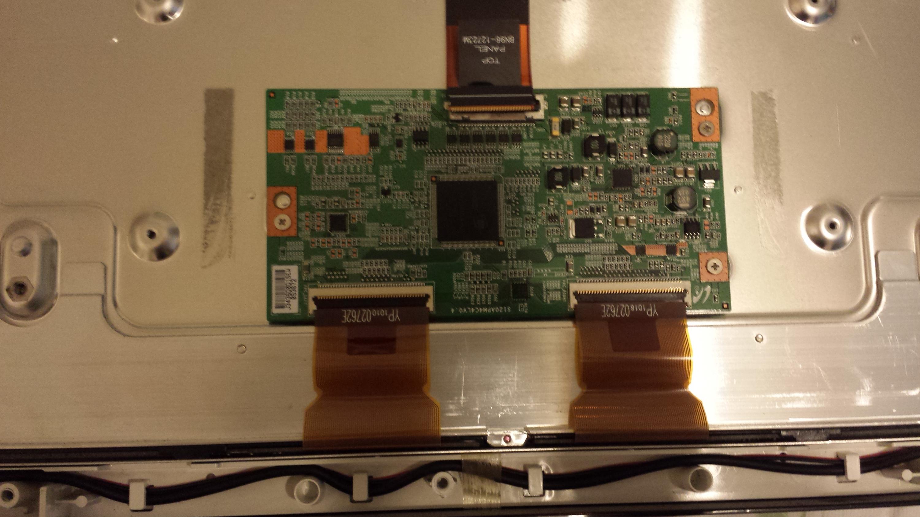

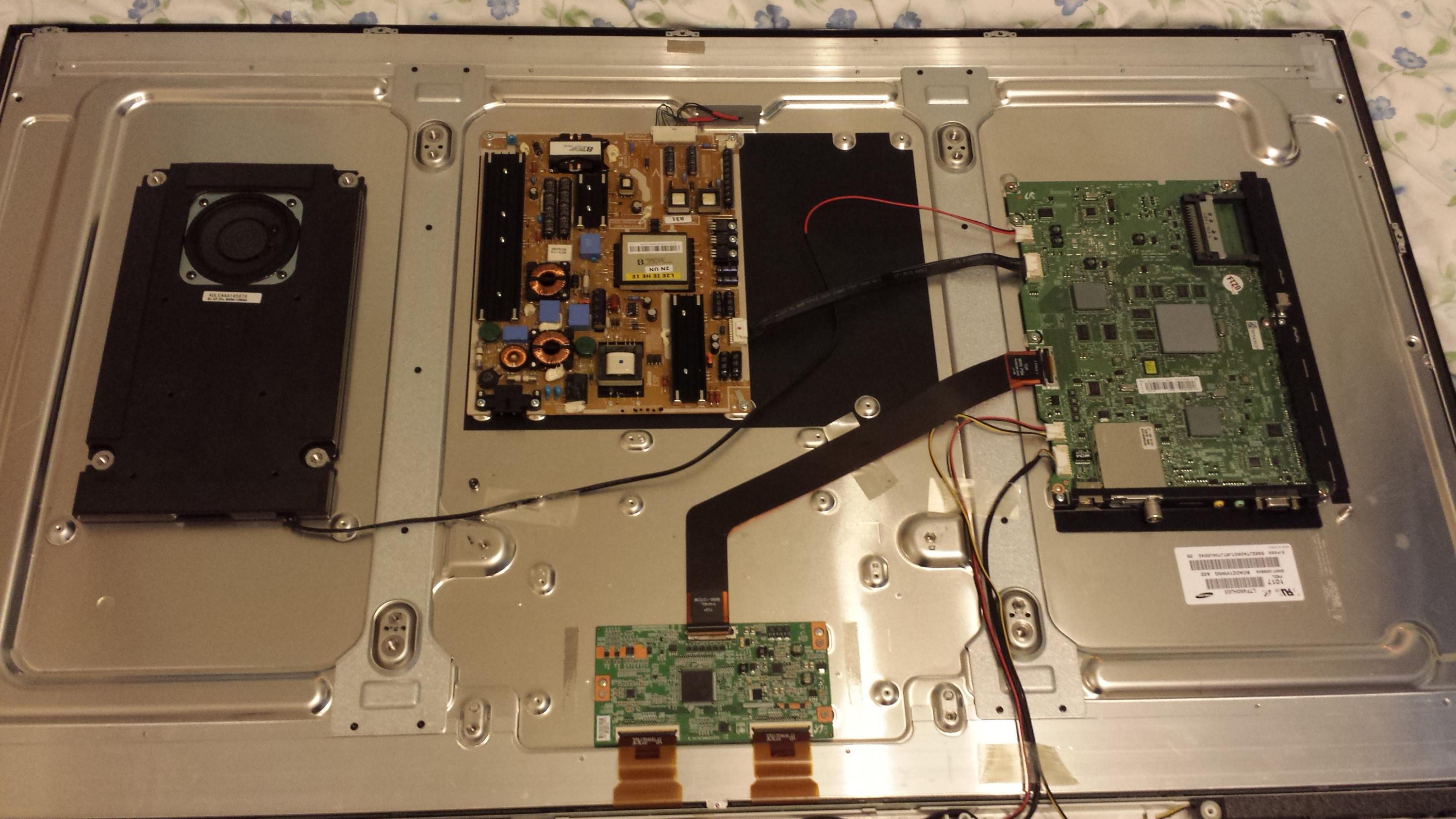

                  Some LED TVs called "Full LED TV" can dim individual parts of the image, but AFAIK that is not used any more on Samsung TVs. Sometimes they can dim the edges of the image though. Can you supply a picture of your T-con board? Any LED backlight control is usually on a separate PCB and will not be through the T-con panel ribbon but through the main board and PSU (usually) or sometimes T-con to PSU.
                    Correct you are sir! I just did a bit more reading and it seems that although on the LG tv's this is done through the T-con there are wires going directly to the LED drivers.
                    Pictures attached all the same.

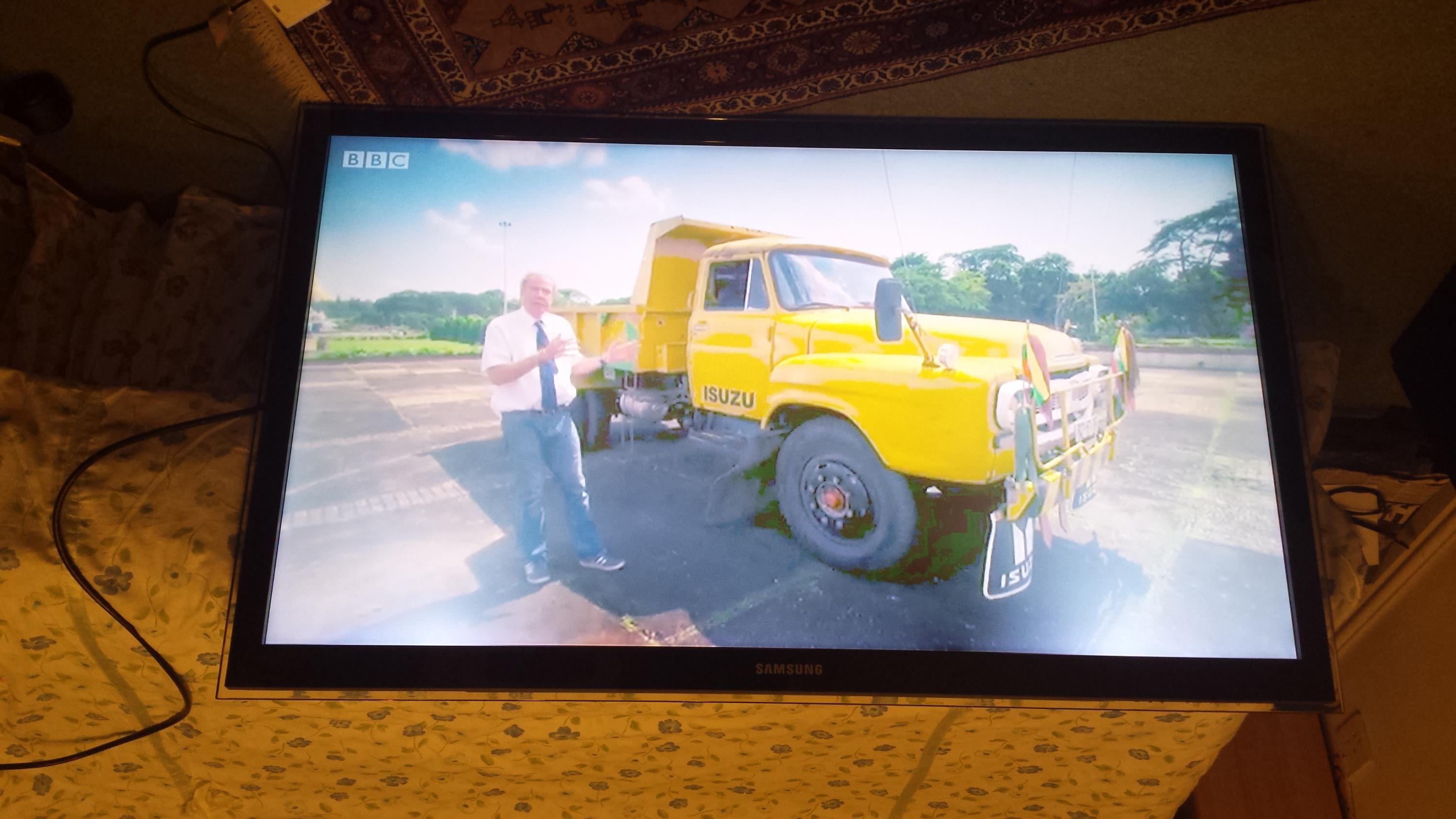

                          Update-Fixed!
                          Ok so as i had guessed, this one turned out to be a faulty T-con board...
                          I must admit, i had no idea a faulty T-Con could result in the bright patches, but what game me the idea was the funny colors on the screen!
                          Either way, i hope this solution helps someone else out there as well!
