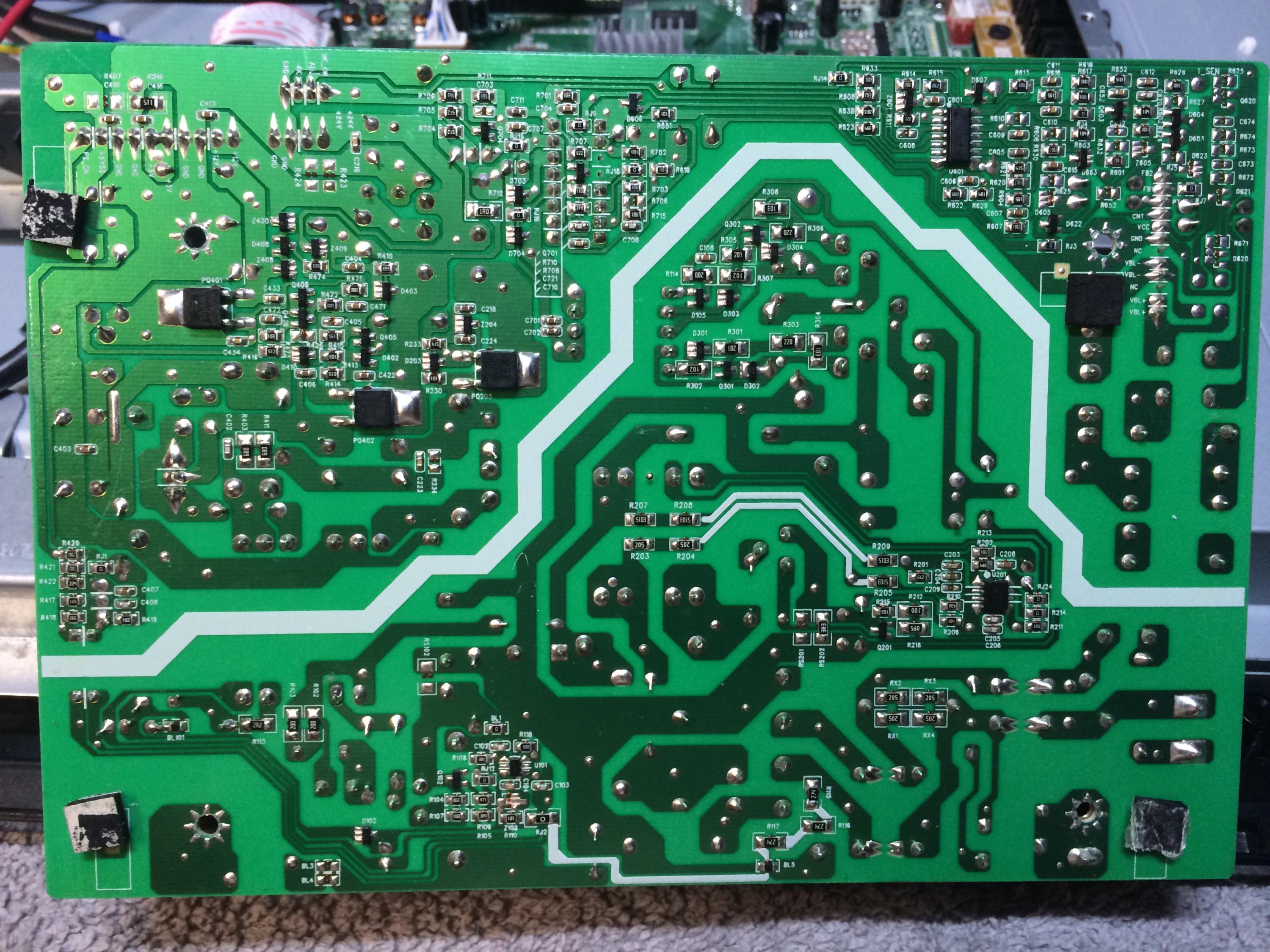

You do have to connect everything back together because you need to have PS_ON signal to turn on the PFC circuit, You can test the power supply board by itself by forcing it on but the high voltage section for the backlights may accidentally turn on while you are probing the board, so it is not a good idea.Never stop learning

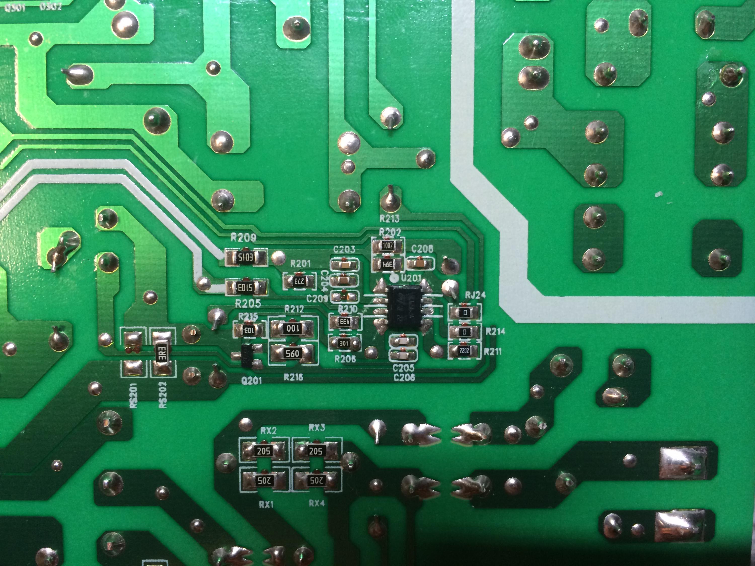

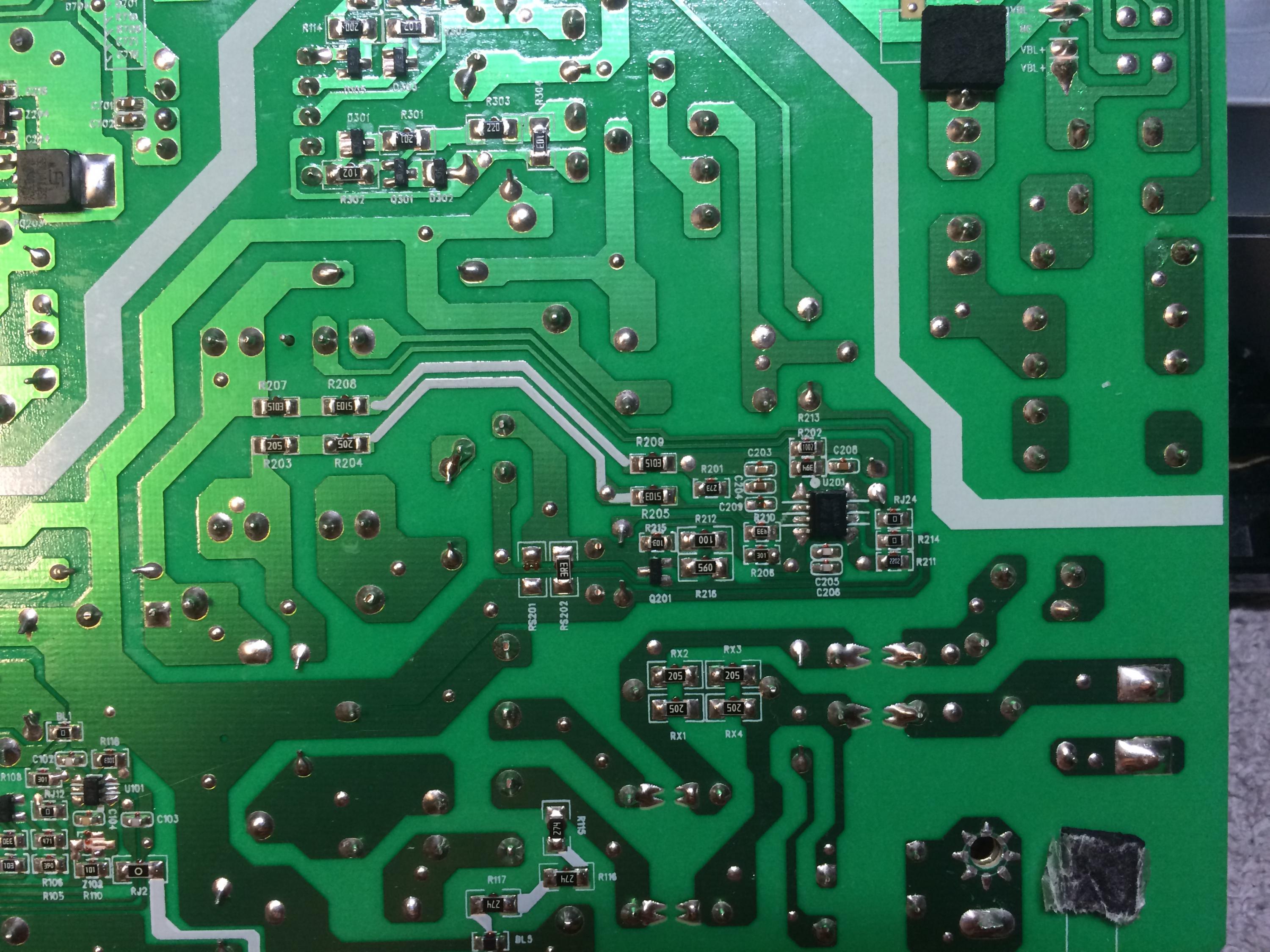

OK, I will need really good well focused pictures around that IC to see where pin 8 is connected to.Never stop learning
http://www.badcaps.net/forum/showthread.php?t=24809Comment
Re: Sceptre X322BCB0359
OK, the picture in post 30, I can see pin 8 has a filter cap positive pin connected to pin 8, then pin is connected to jumper RJ34, the other side of RJ34 is connected to resistor R213, but then the picture is cut out.
See if R213 resistance reading is.
"Ok it is not getting 12 volts. Shows 0.12 v" BTW, TV is on and you still have the other voltages, right? as shown in post 24.Last edited by budm; 05-23-2014, 10:36 PM.Never stop learning
here are some more pics

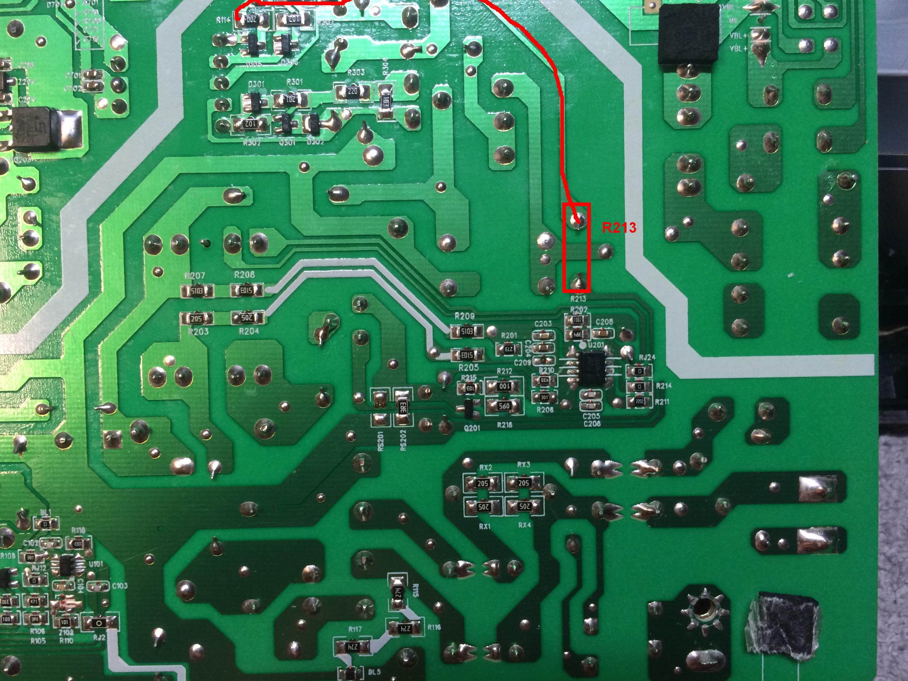

Check that resistor R213 to see if it is open, check on the bottom side of the board because I think it is mounted under the transformer. One of the R213 leg should be connected to pin 8 of the IC.Last edited by budm; 05-23-2014, 10:49 PM.Never stop learning

I cannot see it on the top side of the board, you should be able to read the resistance of R213. Is it a jumper? The other end of R213 is connector to the resistor R114 and then the rectifier diode D105 which is connected to one of the transformer (next to IC U701 which drives that transformer) winding to supply the 12V to run the IC.Never stop learning

OK, so to me it looks like that transformer is not being driven, but you should check out that SMD R114 (20 Ohms?) and the SMD D105 to see if they are OK.
We may have more complicate problem than I thought. Can you read the P/N of that 16-PIN IC U701?Never stop learning
