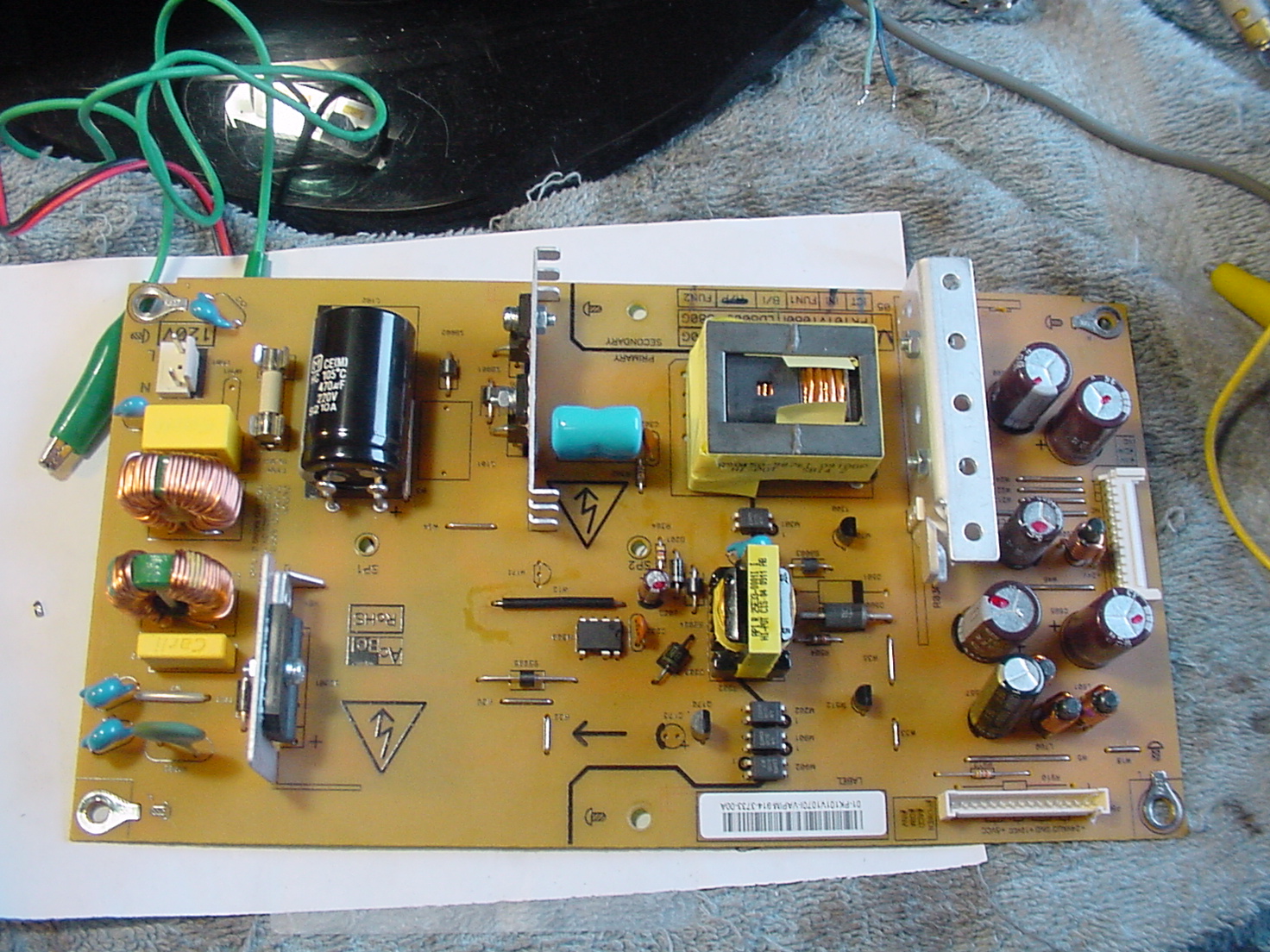

      I just picked up one of these today at the dump, I have several of this series with broken screens so I swapped out the power supply and it works again. I cant find anything shorted on mine and it did power on initially for about a minute before going into blinking fits. I think it sounds like a bad mlcc, but as I had 4 power supplies sitting in the shop I am content to just swap this one.

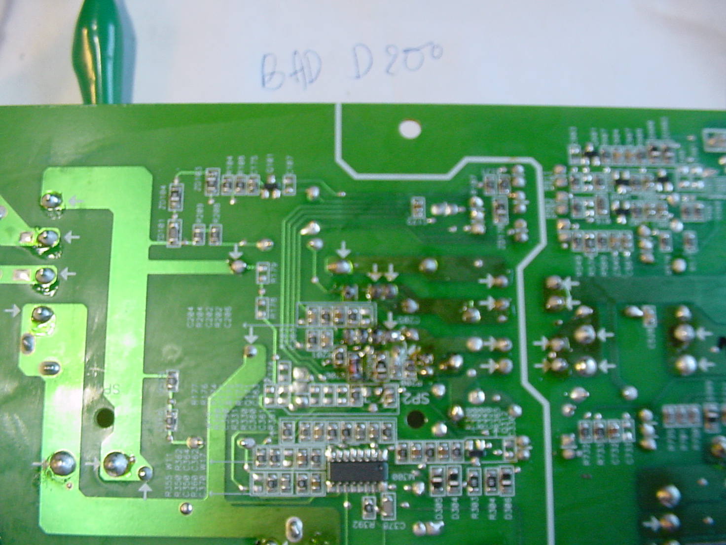

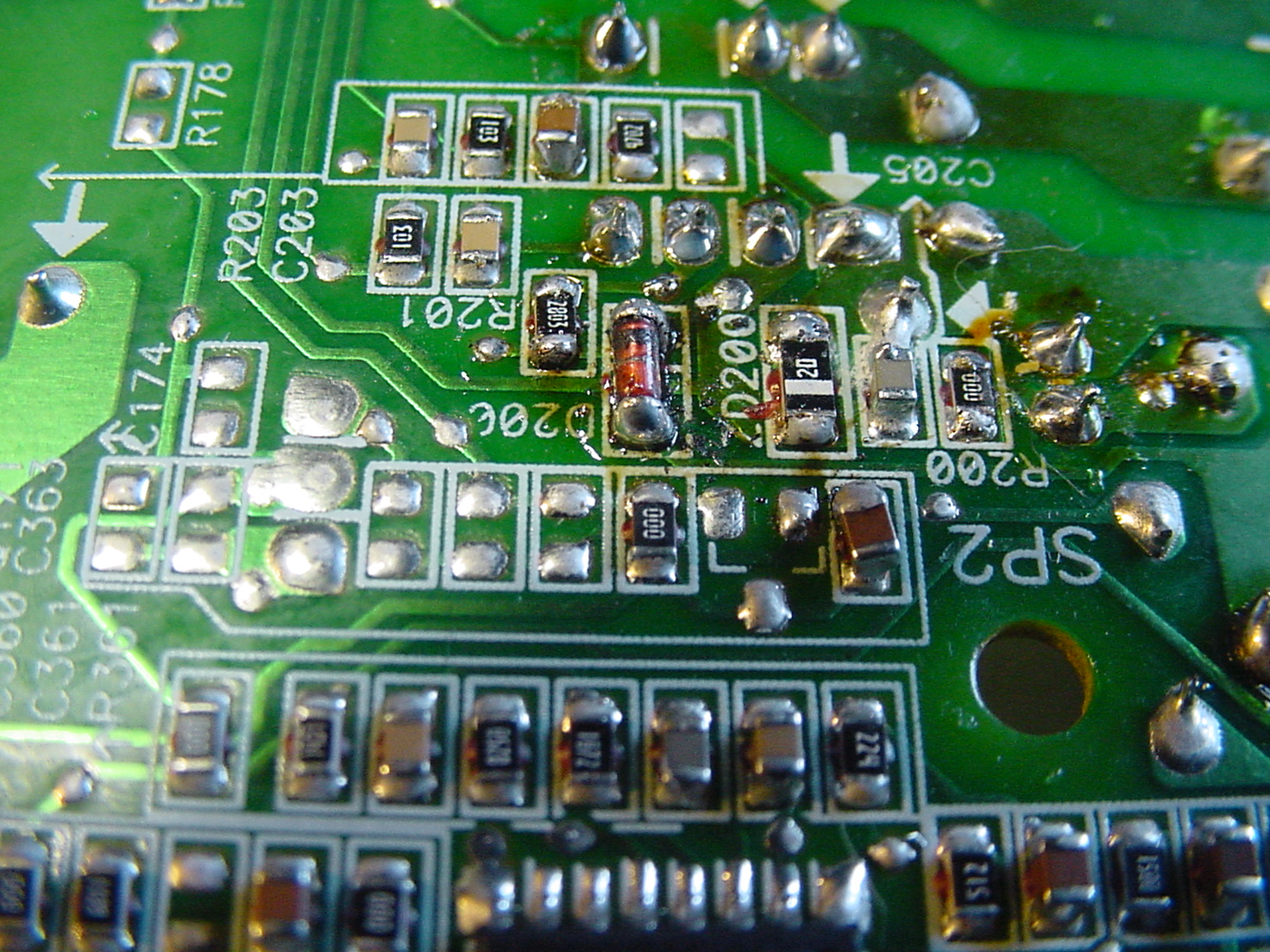

        I finally fix this problem with 5V stby goes into cycling up and down last week, at first I thought it was the startup cap but turn out to be D200 (I use 1N4148, it has leakage).
        It ran for 1 week now. Notes: there are at least two versions of this power supplies use in the same model of the TV.

          Good to know, I will have to try that out, did your diode test leaky or was it ok until under power? I didnt test that little bugger, just ran through all the usual suspects before swapping out the board.
          Liberating magic smoke one part at a time
            Re: Toshiba 32AV502R green blinking LED
            I use my SENCORE LC75 to check the leakage current with 25V applied. The TV is still working and comes on every time, before the fix it was blinking front panel green LED and the 5VSTBY was swinging up and down.

                      sobertob it is a very small smd diode on back of the power board,(75016973 (LD8008-380G) but there is more than one power board for this model, you may have one without that designation. Found a repair kit with these replacement parts for one of the other models (75014421) so I would give all these hard scrutiny if you have this board.

                        SOBERTOB, How about good clear pictures of top and bottom side of YOUR board?
                        There are more than one version of this TV:
                        http://www.shopjimmy.com/catalogsear...shiba+32AV502R
                        Which one is your power supply board?
