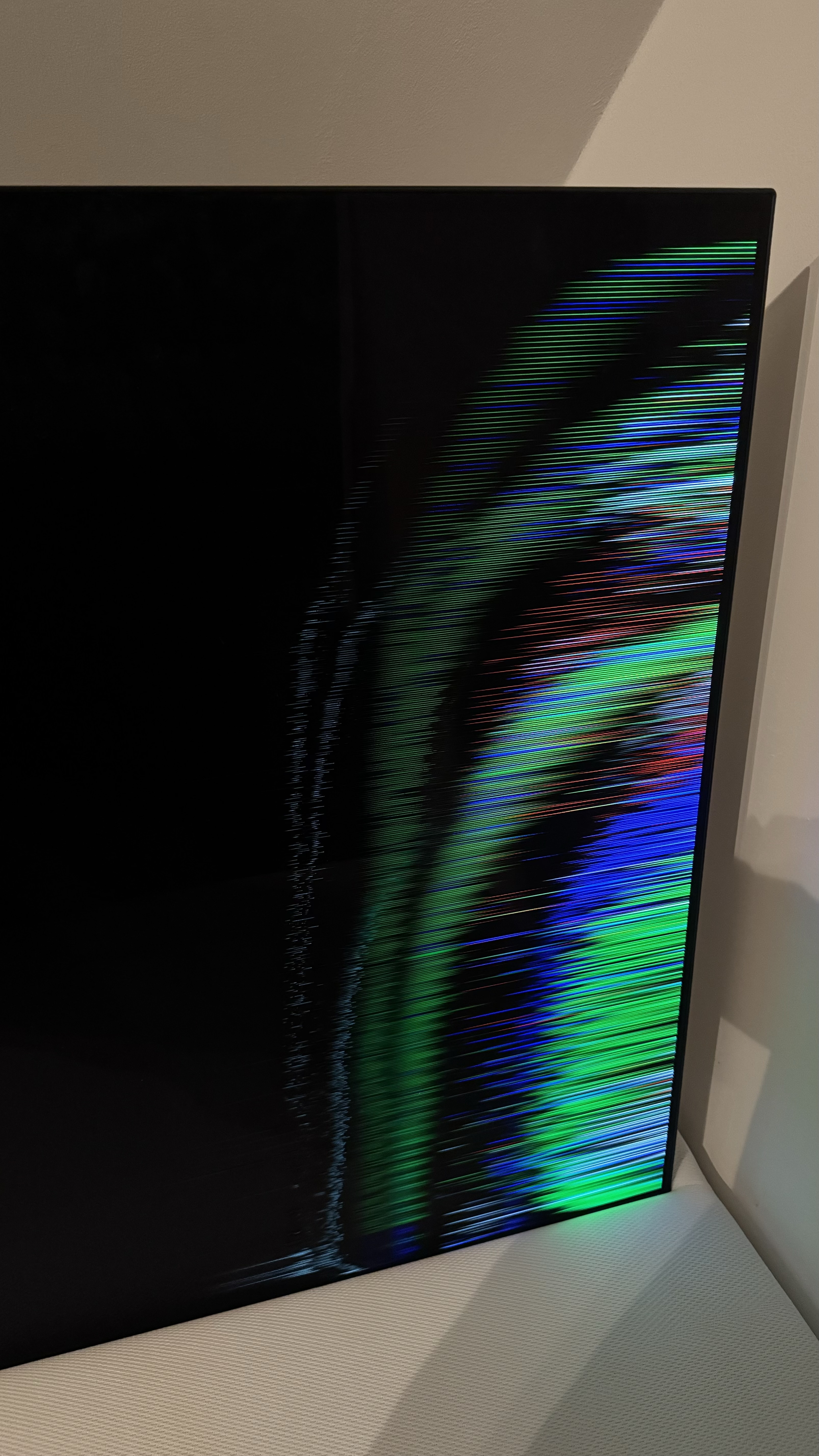

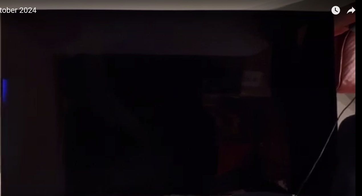

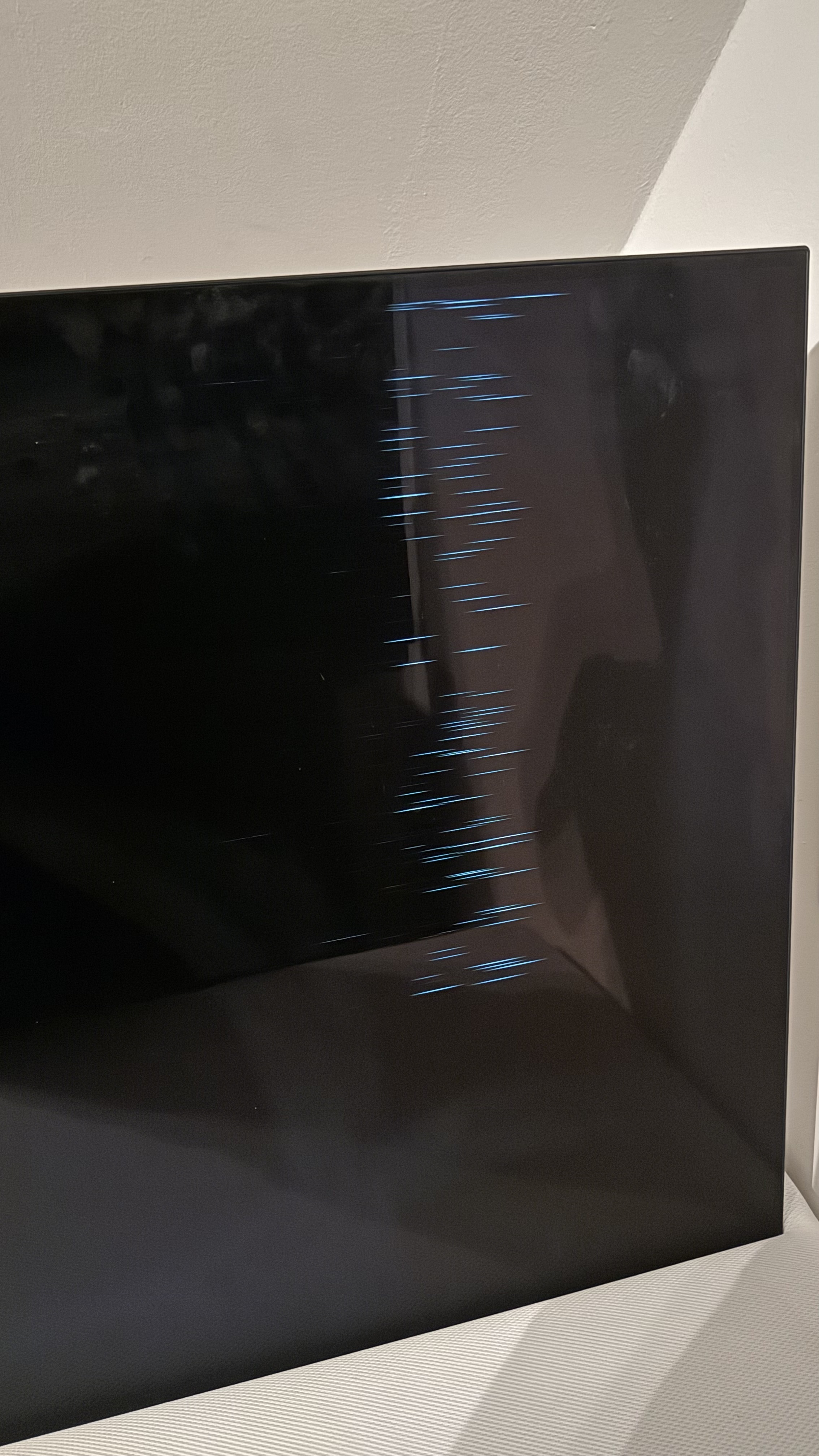

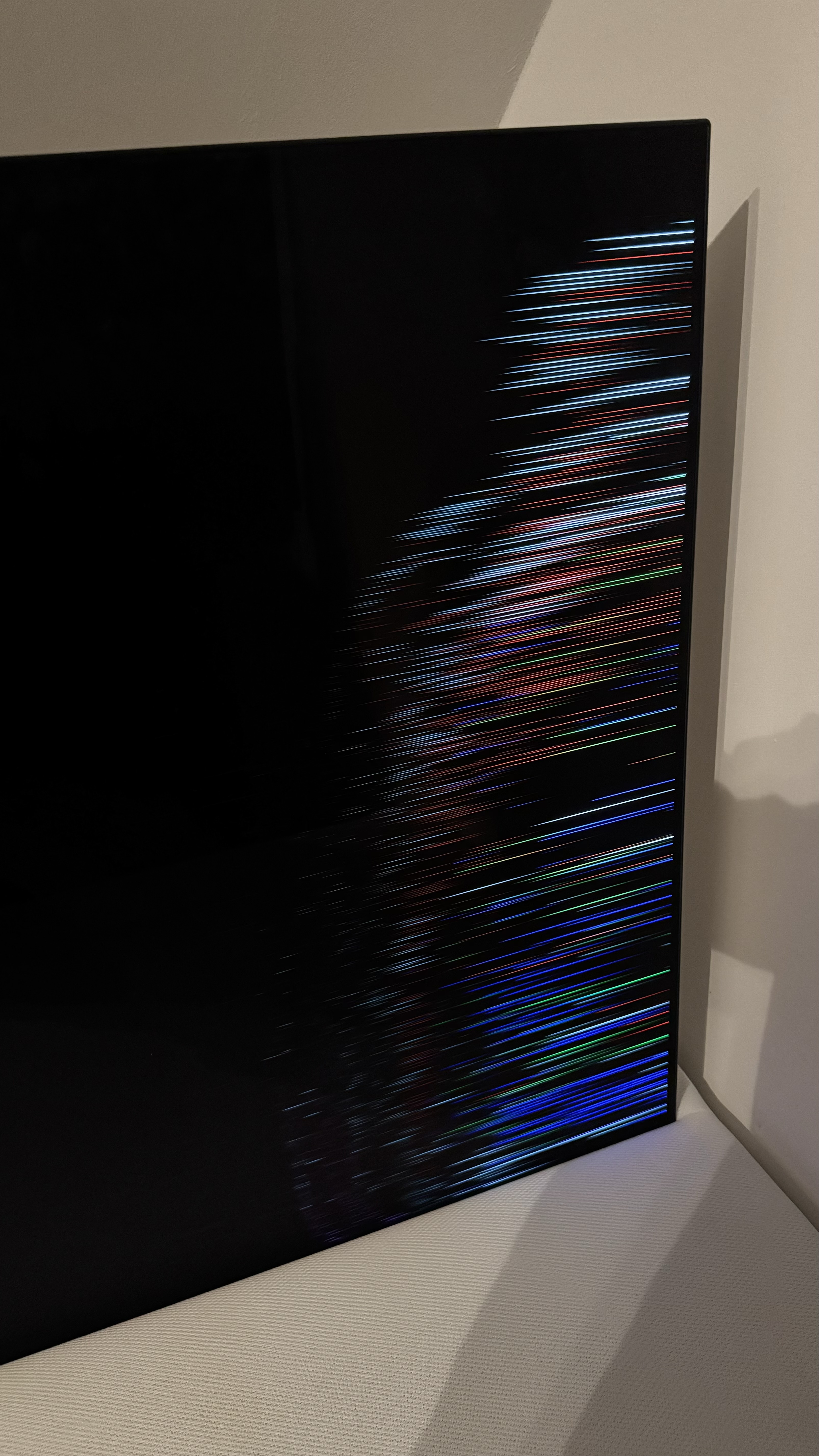

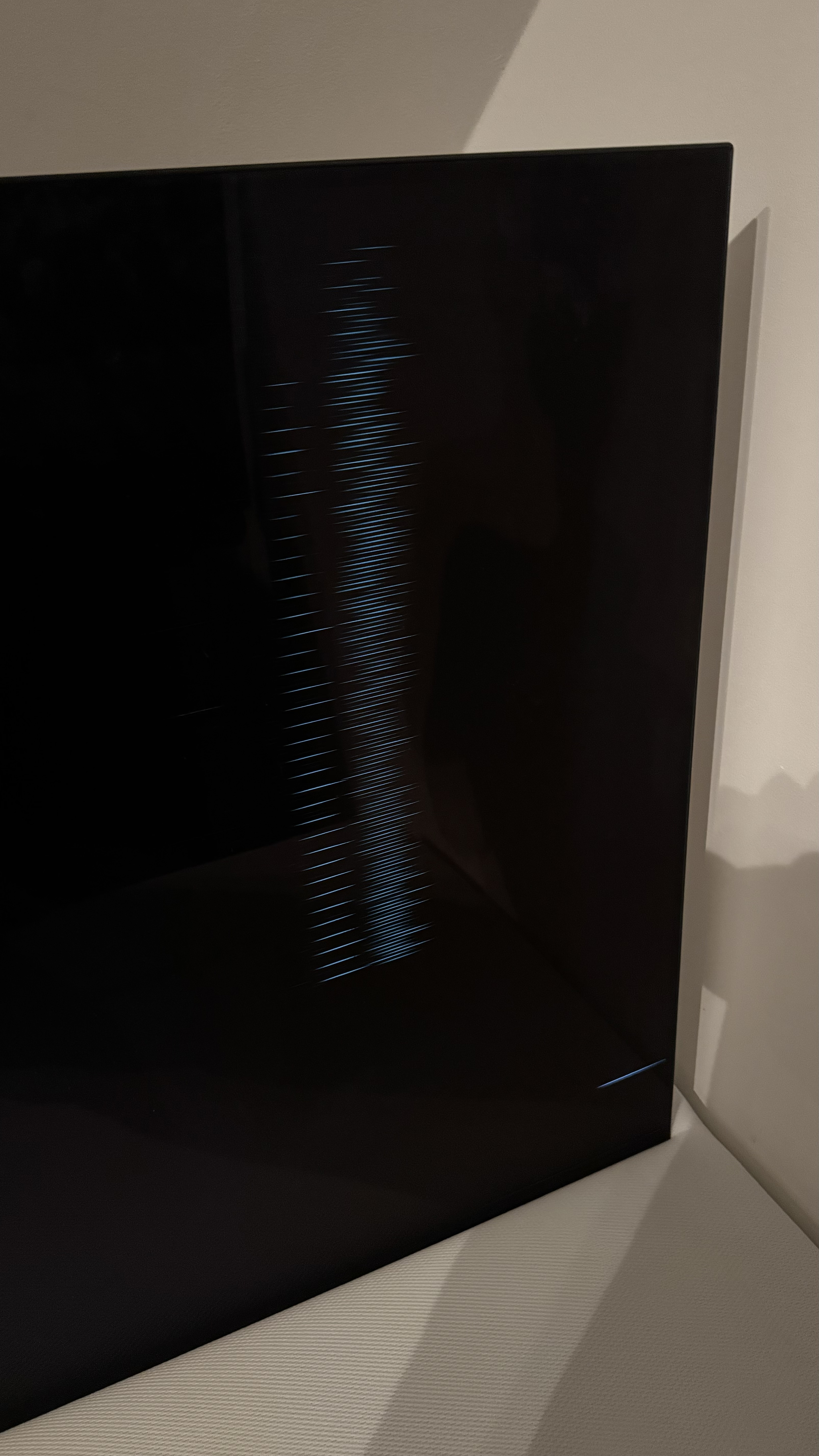

LG OLED C1, SOS-Turn Off, Stand alone test
please wait dismantling the screen and doing disaster , i wish to investigate more on tcon board.. -
I don't think those Tv have only a simple model code with 2 letters, give me eventually the complete model.. what i want to discover is if the CX has smaller screen than C1Leave a comment:
I swapped all working parts from my CX to C1 and other way around. Exactly the same results. CX working with both sets of Tcon and Mainboard and C1 same lines with the running HW from the CX.
now I‘ll to the dirty work
Leave a comment:
before you go to dirty repair,,,, try the working Mainboards of this T-CONSo I tried the T-Con from my working CX and unfortunately it creates a similar error with the artifacting lines in the middle.
https://youtu.be/xenV1ih4fDU
So I guess I‘m going to cut the TV to get to the buffers…Leave a comment:
So I tried the T-Con from my working CX and unfortunately it creates a similar error with the artifacting lines in the middle.
https://youtu.be/xenV1ih4fDU
So I guess I‘m going to cut the TV to get to the buffers…Leave a comment:
yours steps when you plug back EVDD socket... it show part on left side blue... then clear image... then horizontal. start1 OLED Cells , start2 and 3 T-con reaction... this why must invist on T-CON first if not then need to cutting the cover metal plate to have access to buffer boards
Last edited by Diah; 10-29-2024, 04:48 PM.Leave a comment:
you can compare both if MB work on it then T-CON will too.. for more sure show here the both in high quality photoLeave a comment:
Alright, I‘ll do so.
I also own another TV: CX running on an C1 mainboard
But I assume because T-Con and Panel are married It won‘t work swapping the CX-T-Con with the C1 one?Leave a comment:
ok. this noise from T-CON or at he buffer boards, i would go to invest with T-CON from same size and model.Alright, I did like you described. Uploaded a short clip on youtube. https://youtu.be/NooYblfm0JQLeave a comment:
Leave a comment:
do it again please before you put back the socket... press Ok on RC to pass the first page so come language page.. so we can see whole screen not only at the middle.Leave a comment:
Only the welcome screen like I‘ve seen before already. With some artifacting lines in the middle. After 1-2 sec. it powers off automatically.1 PhotoLeave a comment:
you need to exit power_only first ...disconnect the EVDD 24V from T-con side... turn on... optic will lit on... give time for it at this state.for 5 minutes,. install camera at the front of the screen if you don't have one help you..... while the TV ON plug back the socket you unplugged before let see what will the screen showingLeave a comment:
LG OLED C1, SOS-Turn Off, Stand alone test
Hello guys,
I recently picked up an LG C1 in 65 inch size. Previous owner told me that the TV won‘t start, so I did believe due to PSU issue, but not this time. I could narrow it down to the T-Con or Panel.
PSU and Mainboard work both like intended, all Voltages available, Optical on when T-Con lower Ribbon is disconnected and I even managed to get some picture with P-Only, IN-STOP cycle but only for 2 sec. before shutdown.
For the stand alone test the panel starts with some flashing horizontal white lines and then continues to build up some color on the left side of the panel with increasing in brightness and variation over a time of 5-10 minutes. See the attached pictures.
I‘m now stuck in further investigation on how to determine if it‘s and Panel or T-Con issue. Btw all fuses at T-Con are continuous.
Greetings from germany,
TheoTags: None
by alltvrepairsHi,
i have a 65 Panasonic TX-65HX710E using vestel 17MB170 main and Lg tcon.
Few drops of water fell probably near COF and have no display. Tried removing tabs but no.part of display present as if tcon fuse open. However 12v is present and tcon can be felt warm enough that supplies are present. Backlight and sound ok.
Anyone knows if this TCon 6870c-0805A has any special test pins for rgb test?
Appreciate your help....2 Photos -
by kcaHello all ~
I got the display to work by taping off several traces of the right-hand side ribbon cable on the TCON that leads from TCON to PANEL. However, despite dozens and dozens of attempts to find the right combination / range of traces taped... -
This specification for the ASUS VivoBook Vivobook Pro 15 OLED D3500QC-L1351W Notebook can be useful for upgrading or repairing a laptop that is not working. As a community we are working through our specifications to add valuable data like the Vivobook Pro 15 OLED D3500QC-L1351W boardview and Vivobook Pro 15 OLED D3500QC-L1351W schematic. Our users have donated over 1 million documents which are being added to the site. This page will be updated soon with additional information. Alternatively you can request additional help from our users directly on the relevant badcaps forum. Please note that...09-07-2024, 04:30 AM
This specification for the Gigabyte AERO 16 OLED BSF-A3LA964SP Notebook can be useful for upgrading or repairing a laptop that is not working. As a community we are working through our specifications to add valuable data like the 16 OLED BSF-A3LA964SP boardview and 16 OLED BSF-A3LA964SP schematic. Our users have donated over 1 million documents which are being added to the site. This page will be updated soon with additional information. Alternatively you can request additional help from our users directly on the relevant badcaps forum. Please note that we offer no warranties that any specification,...09-07-2024, 07:12 AM
This specification for the Gigabyte AERO 14 OLED BMF-72ESBB4SH Notebook can be useful for upgrading or repairing a laptop that is not working. As a community we are working through our specifications to add valuable data like the 14 OLED BMF-72ESBB4SH boardview and 14 OLED BMF-72ESBB4SH schematic. Our users have donated over 1 million documents which are being added to the site. This page will be updated soon with additional information. Alternatively you can request additional help from our users directly on the relevant badcaps forum. Please note that we offer no warranties that any specification,...09-07-2024, 07:12 AM
- Loading...
- No more items.
Leave a comment:
