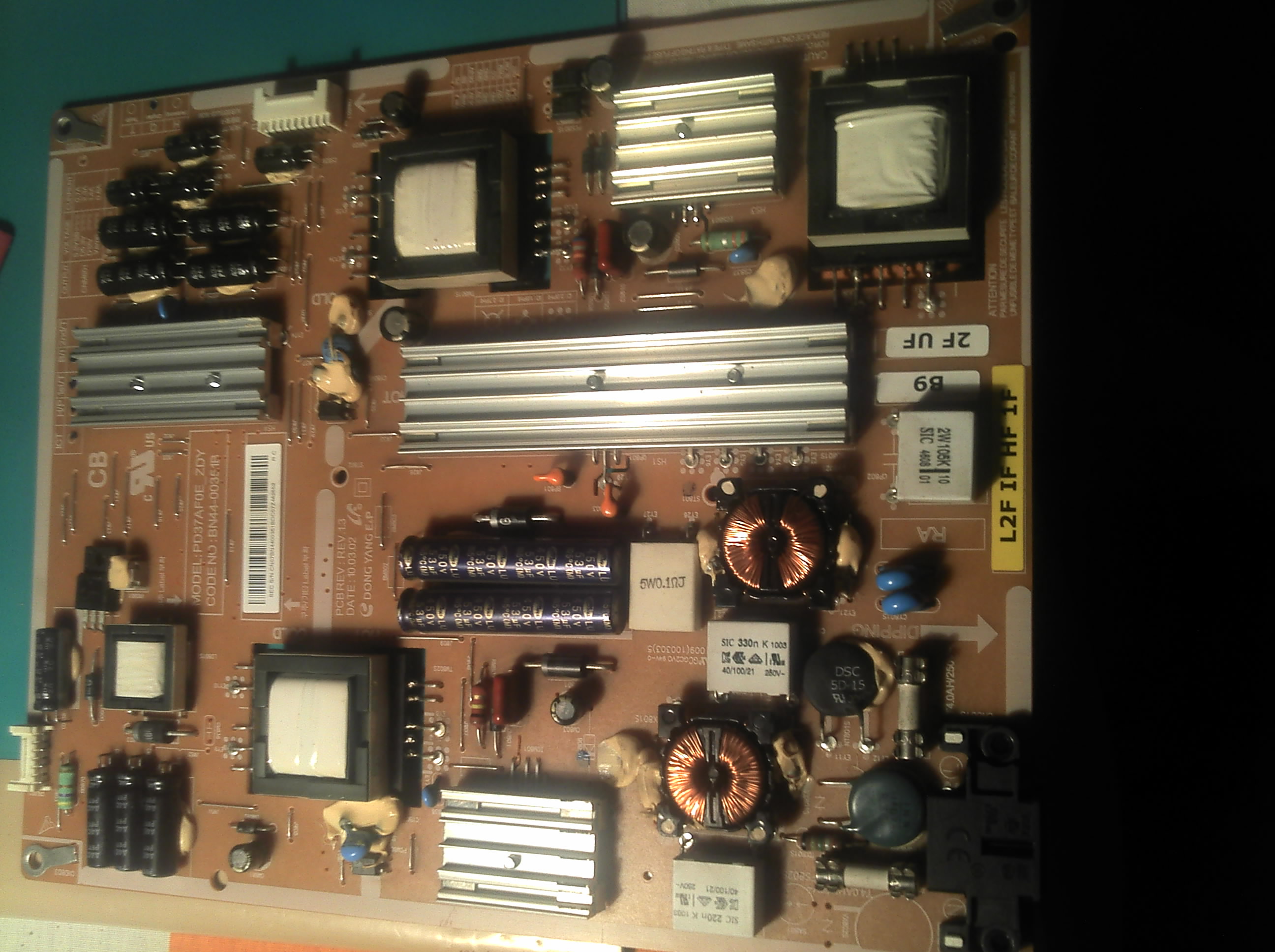

    hello again
    my tv is not working, nopower , no standy, no led ,no image
    try to dissasembly and no bulb condensateur, fuses working fine
    how to resolve it , thanks

    Re: samsung ue32c5100 not power no stand by
    posting some pictures of the boards may help you

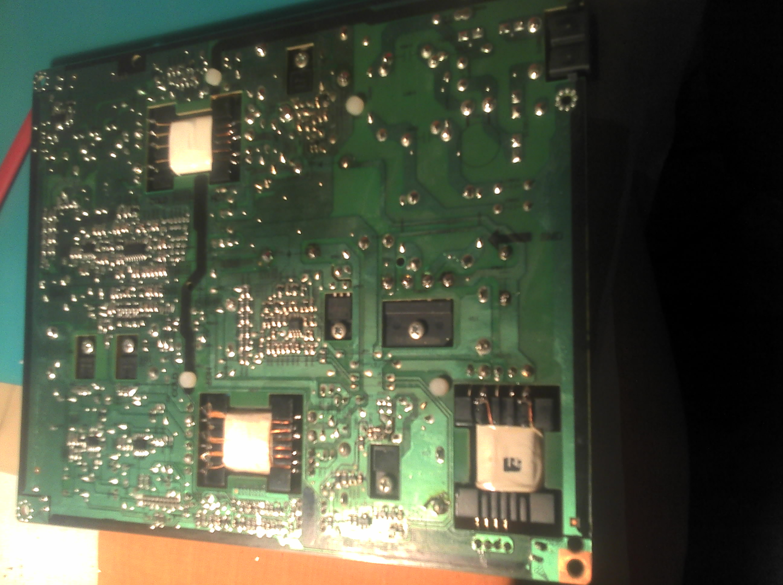

      Check for bad joints, and post clear pictures of both sides of the board
        waitinng one hour and post images of power supply . thanks
          hello again , upload pictures. thanks
            OK, did the TV just stop working or was it hit by surges? Did any one else work on it before?
            You can start with by check the DC voltage right at the two legs of the two long caps laying on their side, just be careful not to touch anything with your hands or body.

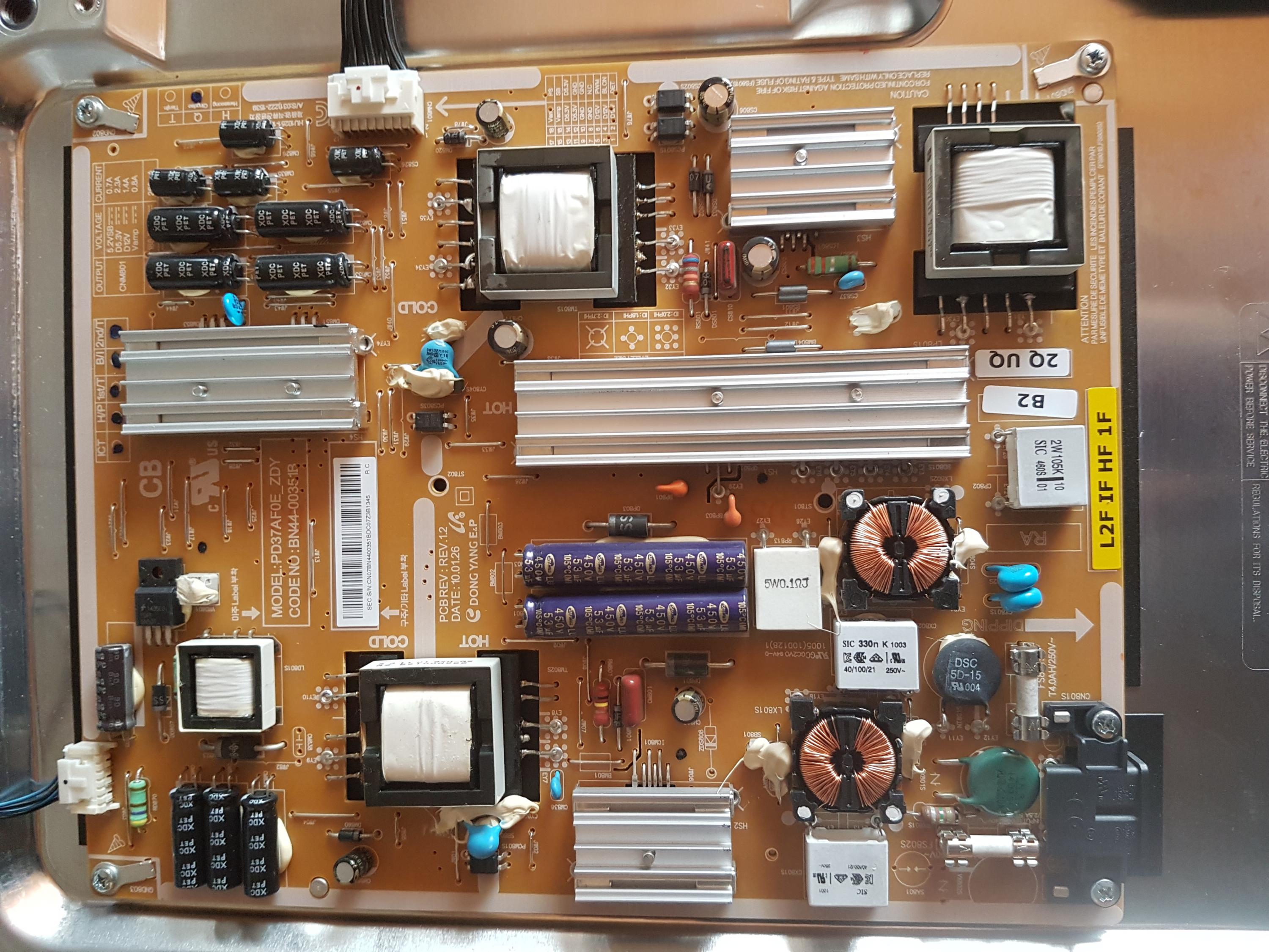

                  Hi guys
                  im having the same problem totally dead,i have checked for cold solder joints and i have tried disconnecting the main board legend to see if i can get back lights but nothing
                  warmed up the power supply and main board but still nothing also no voltage from the PSU legend but main 450v caps are reading 334 volts

                    Checked secondary side for short circuits ?
                      What voltages are you getting on ICS801 (STR-W6052S)
                      • sordids999
                        • May 2013
                        • 2158
                        • uk
                        0.15 volts but slowly dropping
                                That can't be if you do have 330Vdc on the main cap unless the trace to the transformer TM801 pin 3 is open or winding on pin 1/3 is open which I doubt that very much.
                                What did you use for GND?
                                One thing I would do on that board is to resolder all the transformer legs, all the legs of the devices mounted on the heatsinks.
                                • sordids999
                                  • May 2013
                                  • 2158
                                  • uk
                                  sorry my bad i hope this makes sense
                                  pin 1 10.89 volts
                                  pin 3 11.42 volts
                                  pin 4 11.43 volts
                                  pin 5 gnd
                                  pin 6 11.43 volts
                                  pin 7 318 volts
                                  • dick_barton
                                    • Aug 2015
                                    • 6643
                                    • Wales
                                    Pin 4 (VCC) needs to be a minimum of 13.8v to work.
                                    You need to check the components linked to it.
                                    ZDS801
                                    CS805
                                    RS802
                                    DS802/3
                                    to start with
                                      Leave the RED probe on pin 4 (VCC), Black probe on primary circuit GND (Negative leg of the main filter cap), then apply the AC to the board and see how high the DCV will rise up to.
                                      There are two caps and Zener diode on pin 4, so if the Voltage on pin 4 does not rise up to the start up Voltage then it may be bad startup cap, leaky Zener diode, or cap, or bad charge pump circuit inside the IC, see diagram for details.
