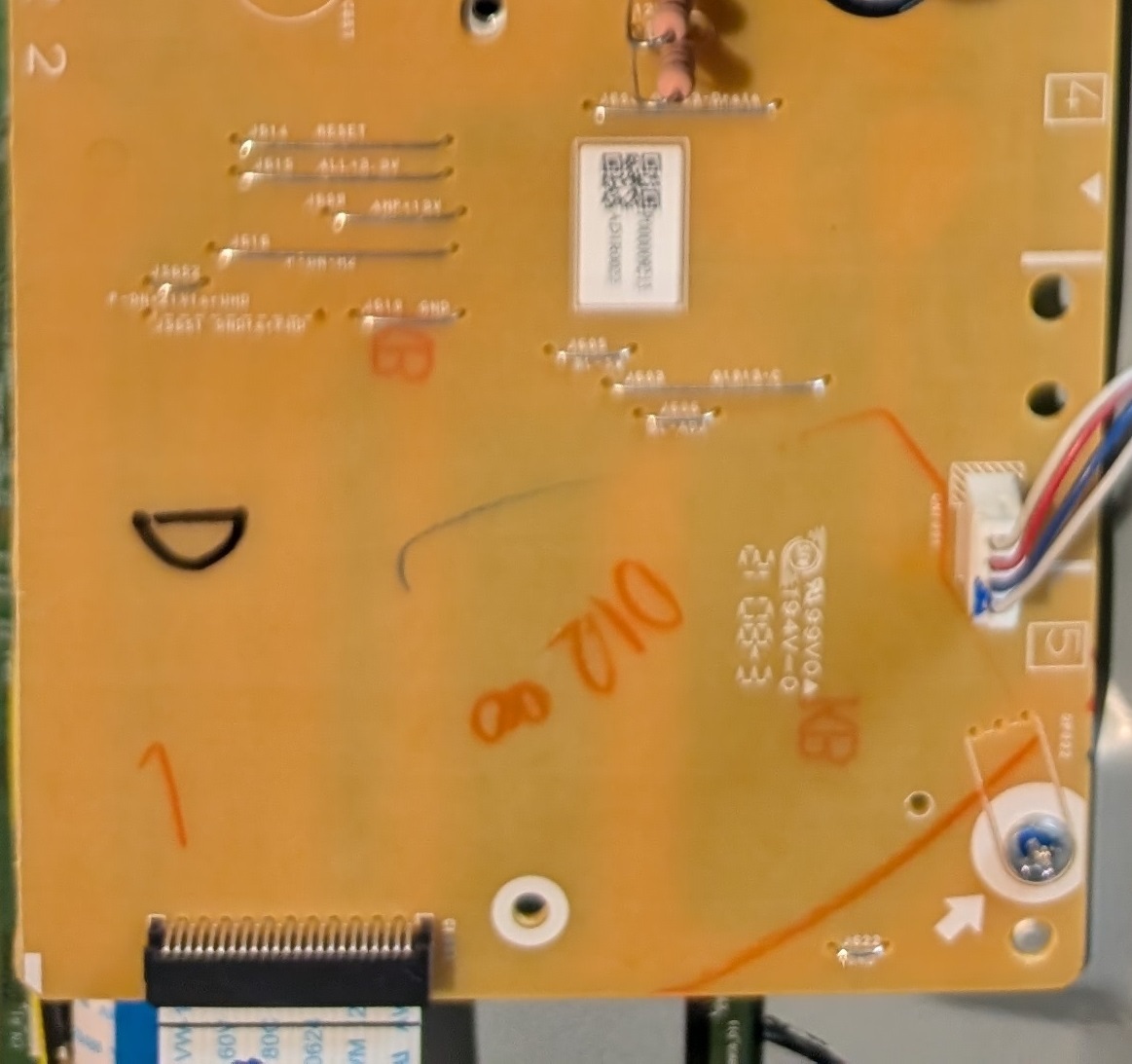

        let give try with this replacement... list all voltage with its pin name on the PSU socket at time it is on

              There isn't a Pinout chart on either side of the board that I've seen or recognized...

                Yea there is no chart anywhere on either side calling out the pins for that connector. Likewise I cannot find a schematic on Google. The seller is shipping the power supply today, so I should have it within a couple days.

                  post clear photo on this jumpers area they have sign

                    Underside added as well 😁

                      so the jumpers from the top are the print chart.... plug every things on and list the voltage as jumper name / measurements on the jumpers )

                            Here ya go:
                            J614 RESET - 3.31V
                            J615 ALL +3.3V - 3.31V
                            J609 AMP +13V - 14.38V
                            J616 P-ON-H2 - 3.28V
                            JS652 P-ON +21V for UHD - 19.8V
                            J605 BL-SW - 172mV
                            J603 01013-C - 0.00mV
                            J606 BL-ADJ - 155.1mV
                            I did not check J610 GND because I thought that might be a bad idea 😬

                              its look like in standby mode right now

                                  yours PSU right now with this reading working in Standby mode.. yours system Android.. so the PSU at such system always warm start... not cold start as other system like vidaa or Linux or web OS
                                  i have doubt if the other PSU will change some things... we wait and let see
