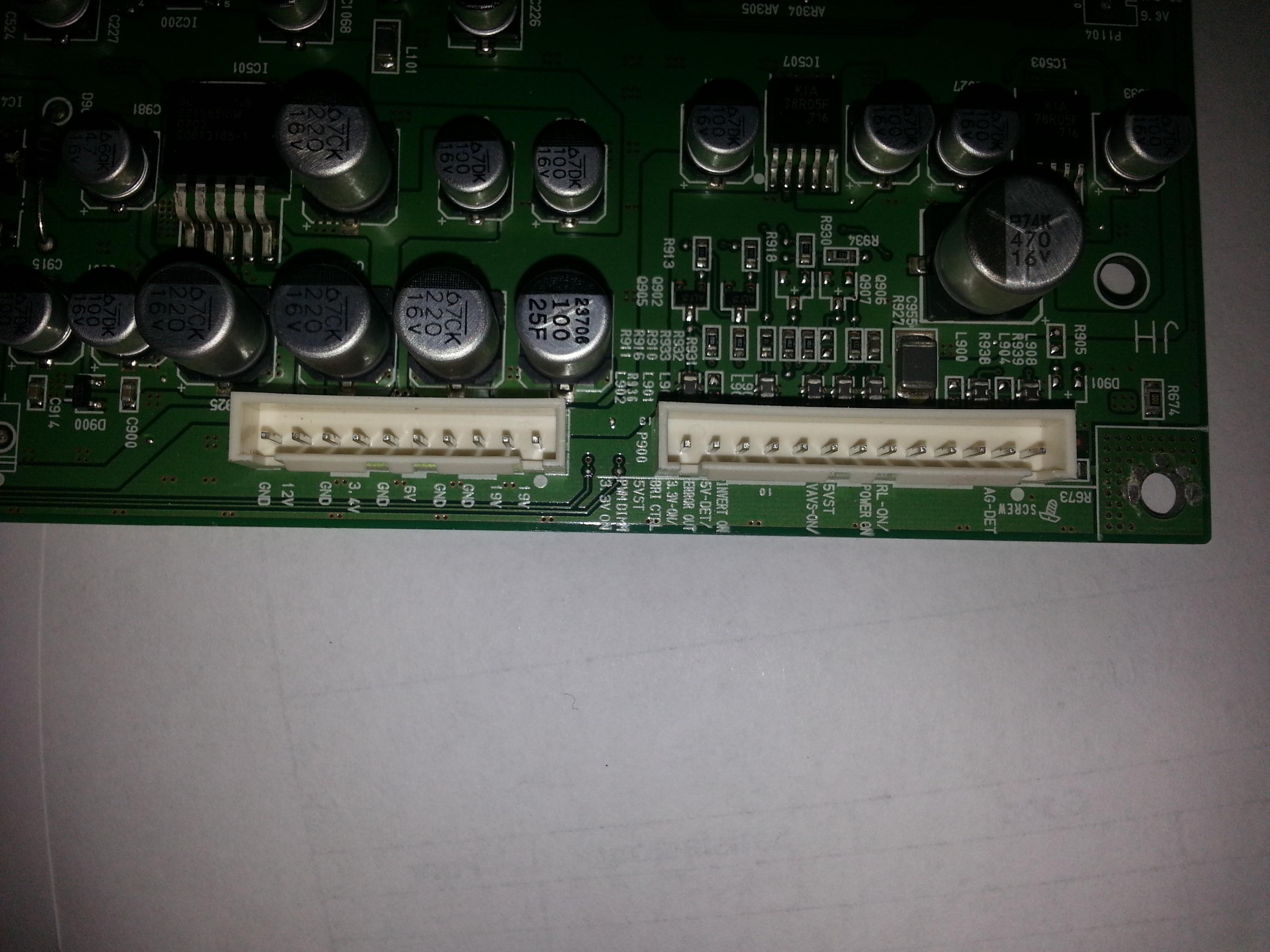

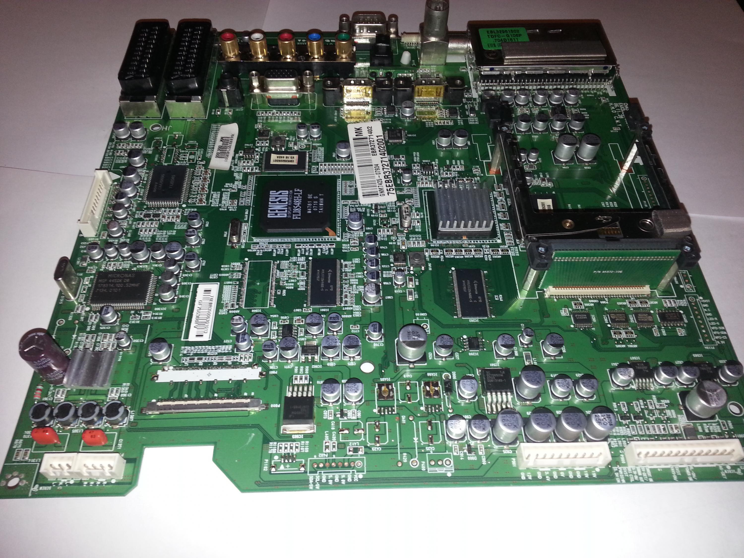

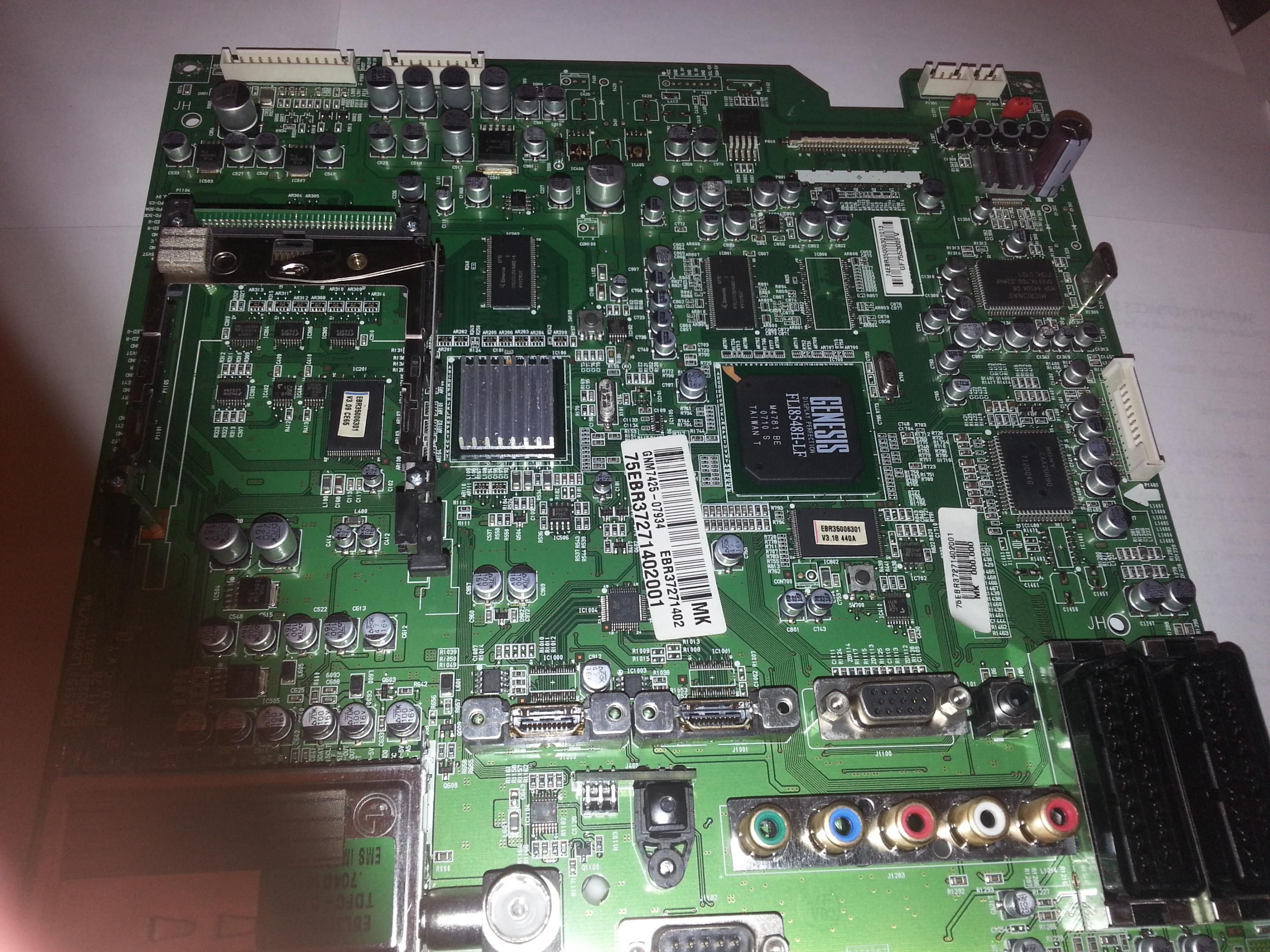

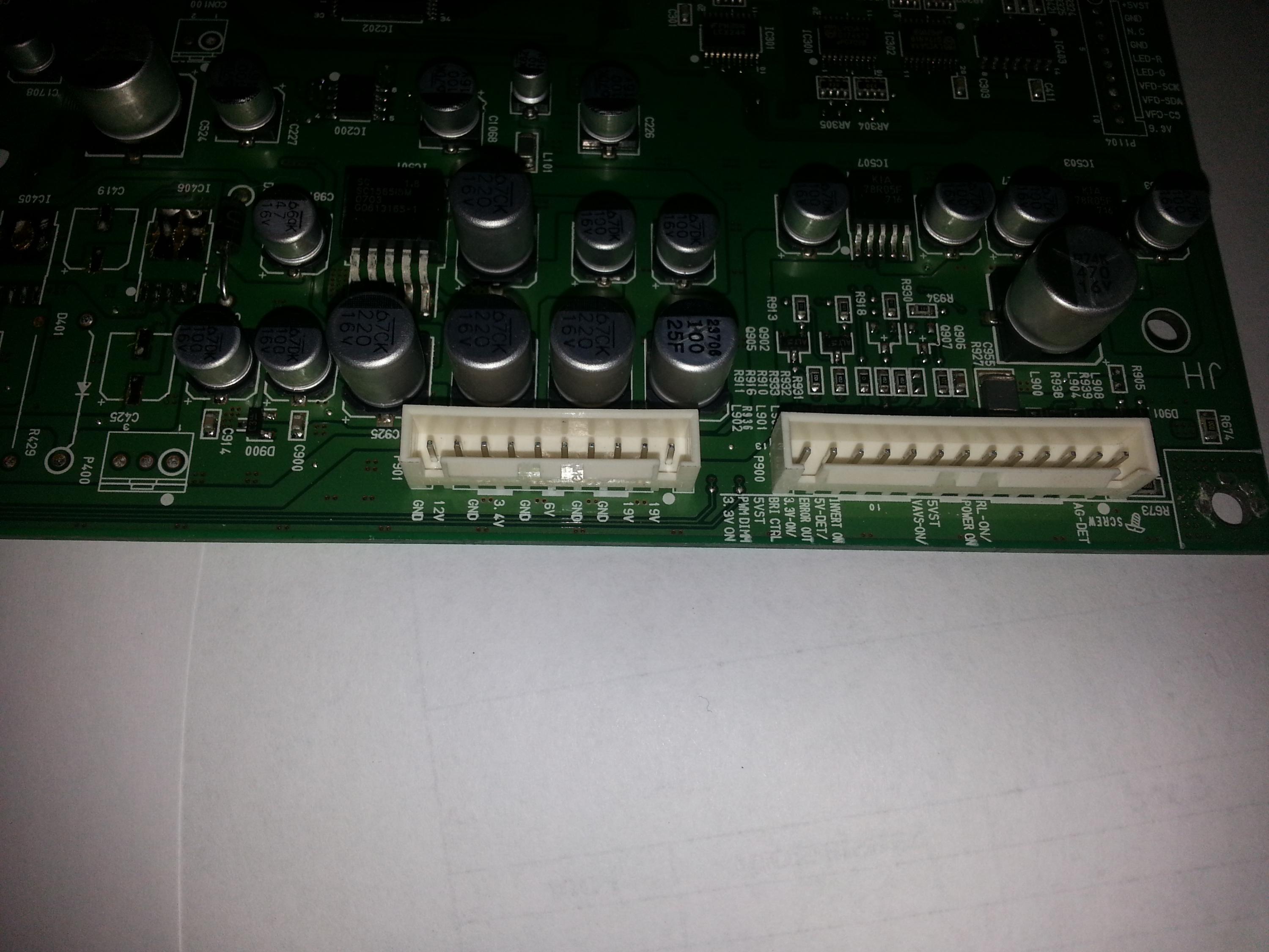

                  Re: LG 37lc55
                  Hi All
                  I have added a couple of pictures of the main board hoping someone can tell me which is the ps-on pin ?
                  Regards Ron

                    Re: LG 37lc55
                    I'm guessing right now in saying that PS_on may be the same as the Power on - indicated on the larger connector?
                    • Dgtech
                      E. Technician
                      • Apr 2009
                      • 1462
                      • Steeler
                      Re: LG 37lc55
                      Its kinda weird the way they did the designations on the side of the connector with it not going pin for pin along side, however, there are 13 pins and 13 designations. I'd just count off and check all of the voltages and post them all...just to be sure.
