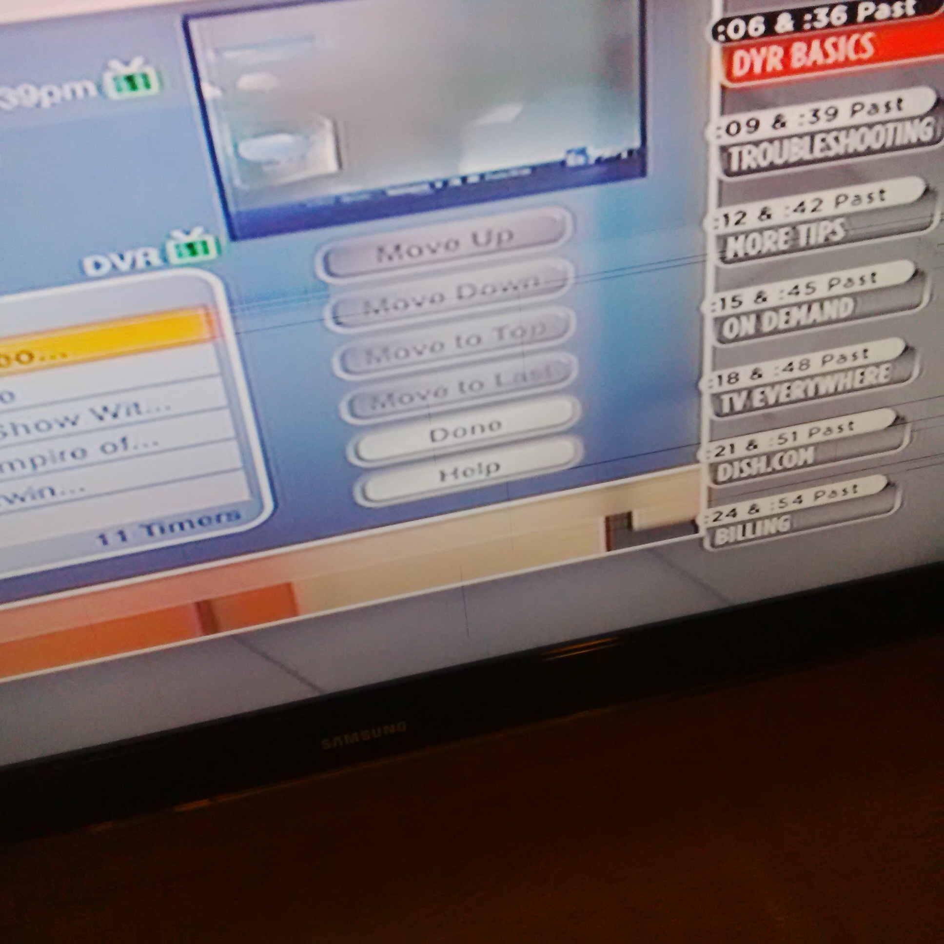

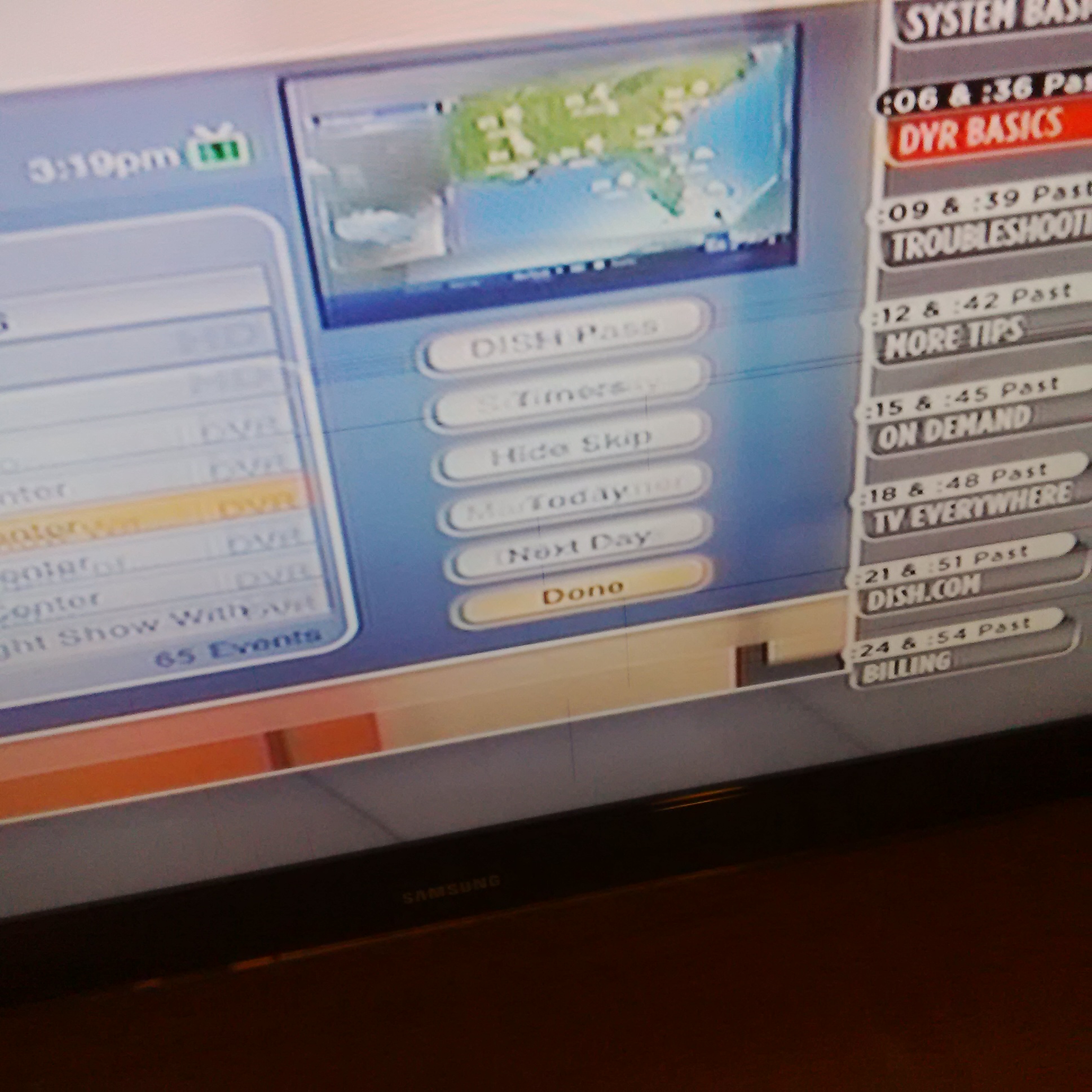

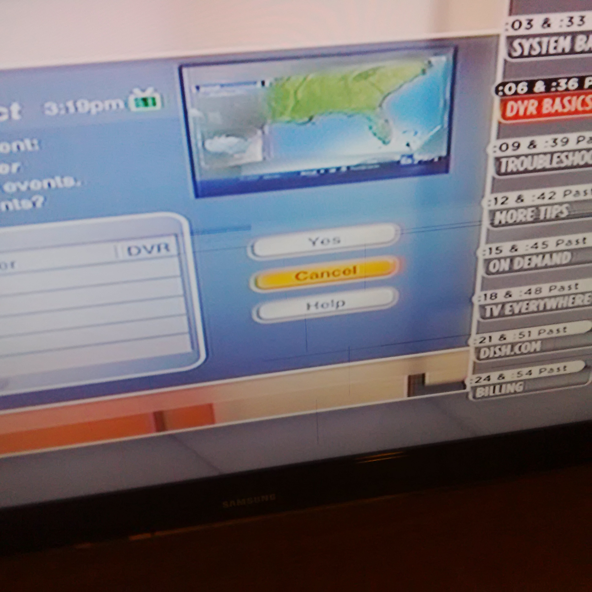

    I acquired this Samsung today. There is sound and backlight and when I reinsert the tcon cables I can get a picture. But the picture has little wavy lines in it. There is times that the picture is perfect but doesn't stay for long. I think I know the answer but should I be replacing the tcon?

    Did the problem get fixed after replacing the T-CON board? Thanks.
      Re: Samsung LN46A750R1
      It did! I gave the tv to my dad. He said it works great.

        @dcapper, Can I use your pictures in the new thread that I want to make for the collection of pictures on the screen to show if it is bad panel or bad T-CON?
          Of course. I thought the t-con for that was cheap but it looks like it they are around $40 now.
