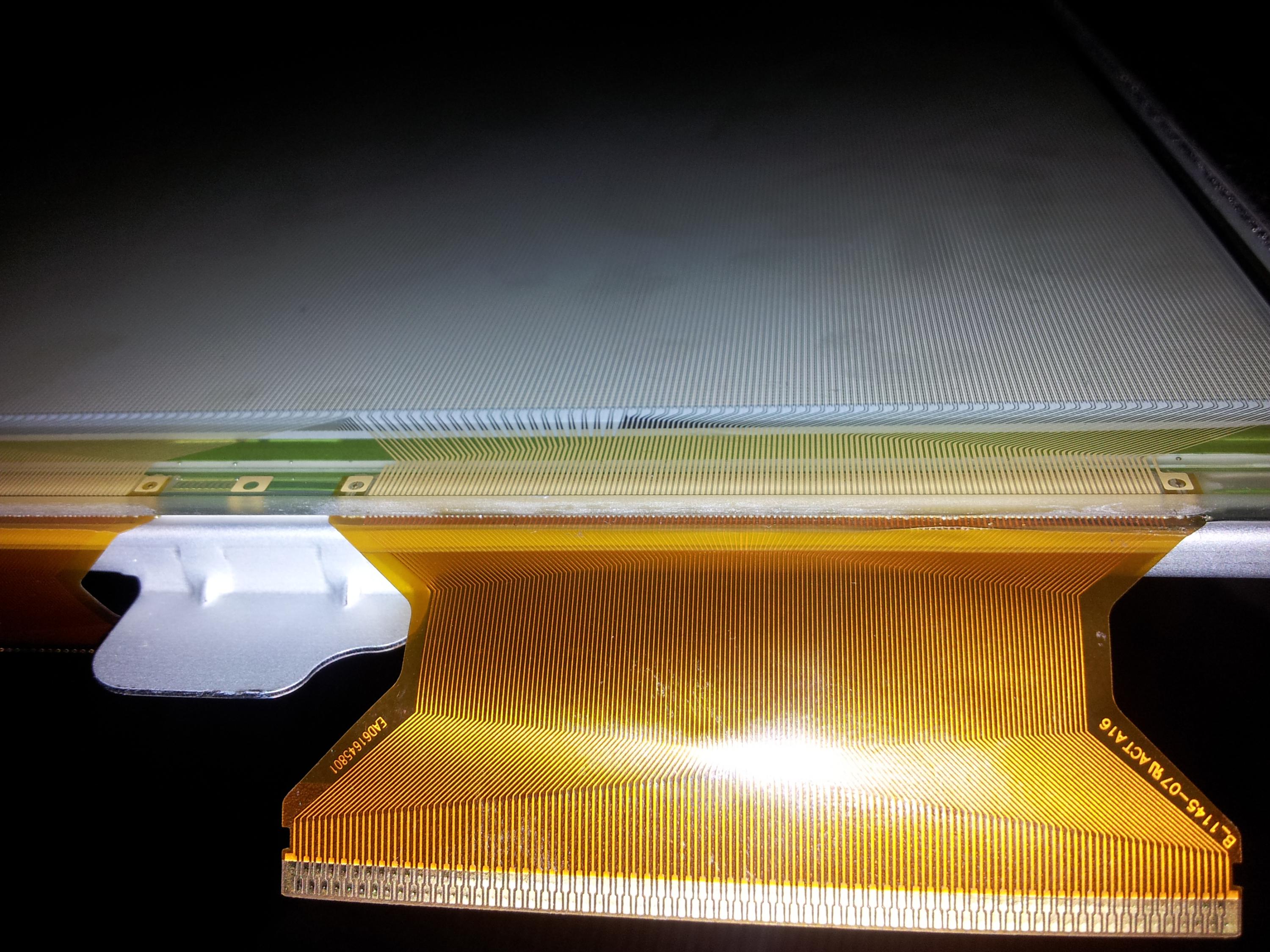

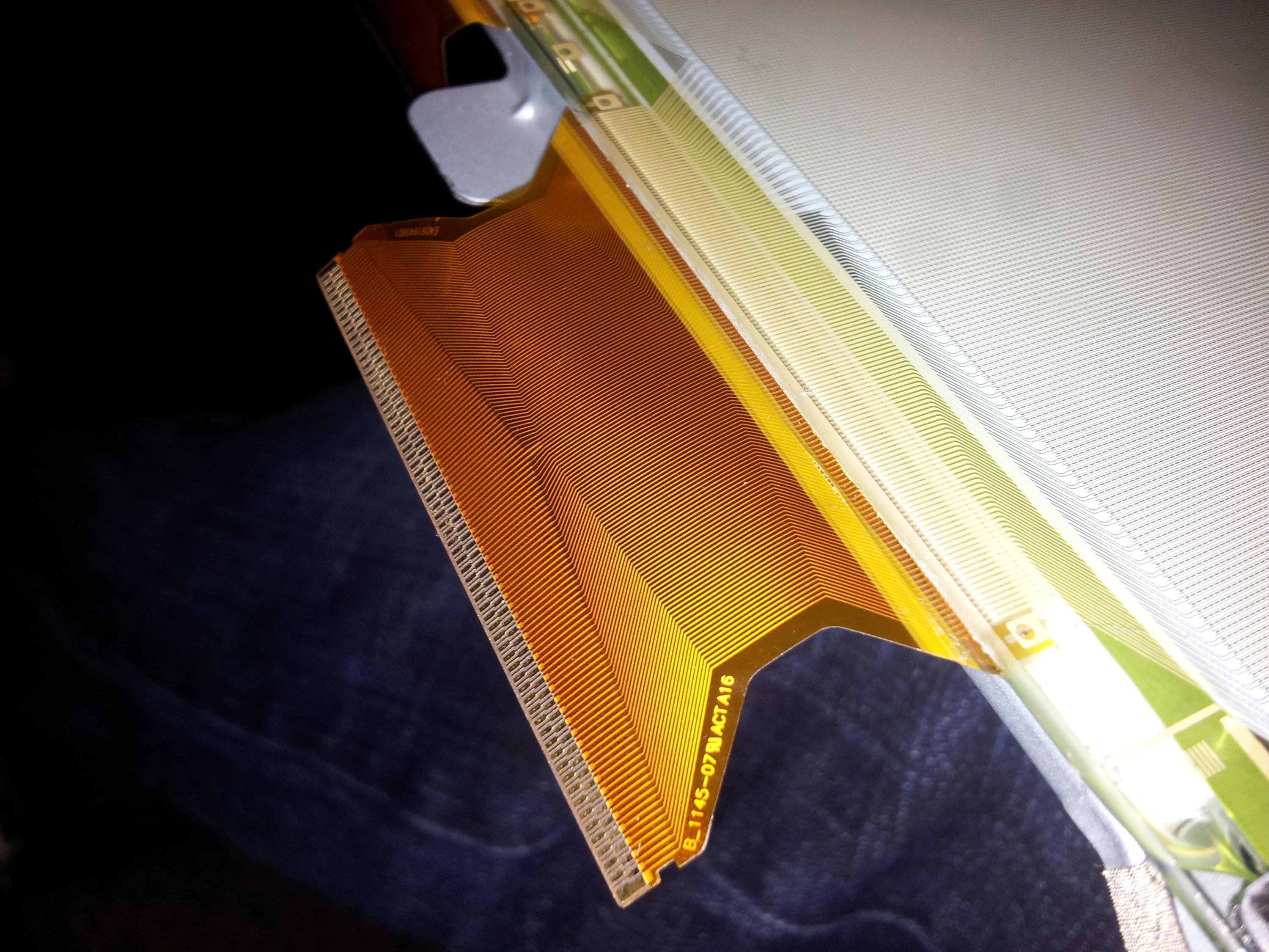

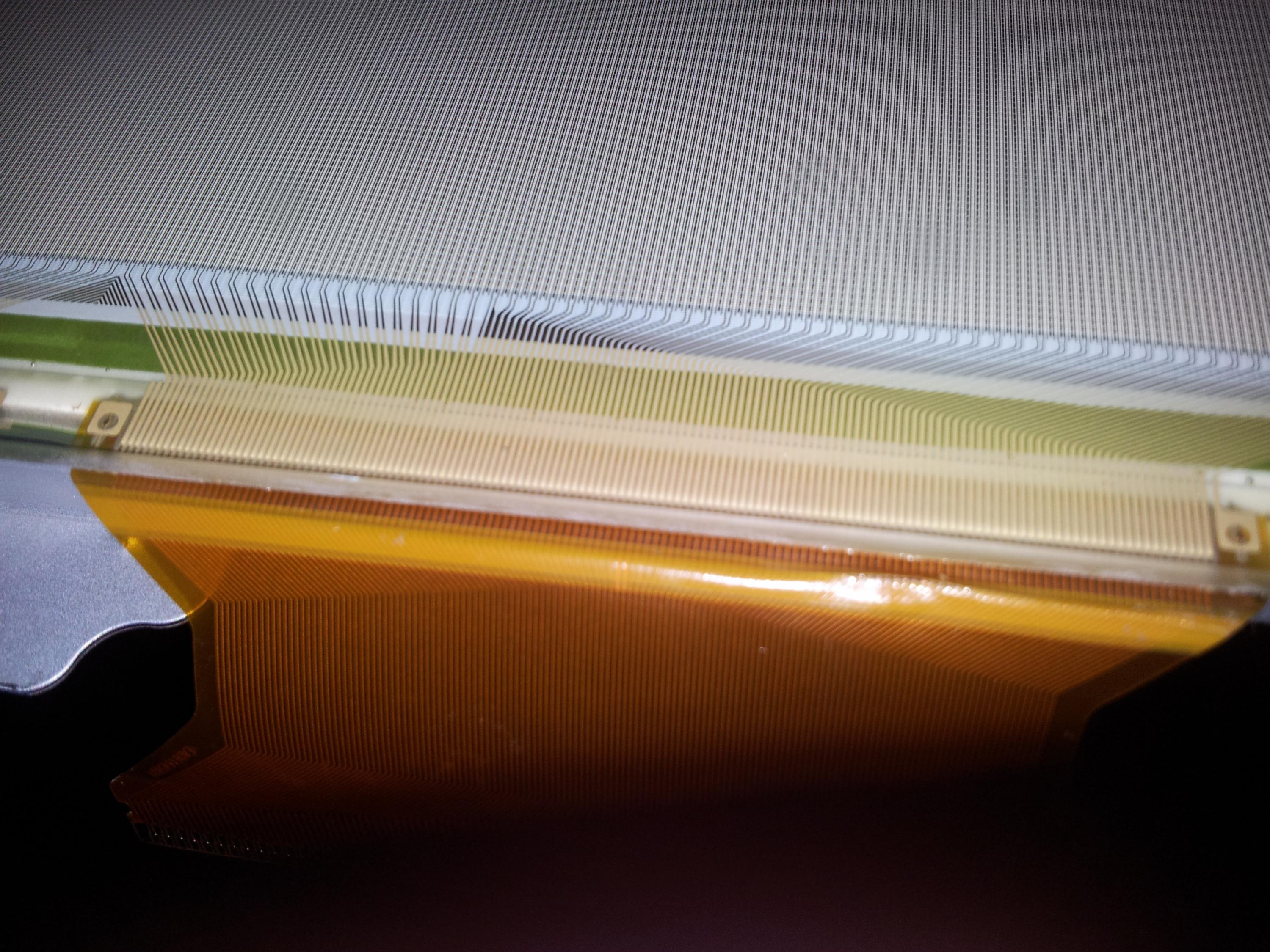

                      I have just disassembled the panel and I have found some suspicious damage. Here are the pictures:

                            It is hard to get really close image with standard camera but actual top plastic layer is broken and the conductive part of the ribbon is exposed. The only thing which baffles me is:
                            1.) why the bottom buffer died when the damaged ribbon is connected to the top one..
                            2.) Why I am not getting image at least on part of the screen?
                            Any Ideas?

                              Exactly the same I had. I'll upload a picture shortly.
                                Re: LG 50PA650T Plasma- Help required
                                I think you will find ribbon defect lines up with the screw mounts or plastic nibs. They seem to eat into the ribbons on these.
                                That must be 5th LG 2012 series 50" FHD with this problem. (50PA5500, 50PA650T, 50PM670T)
                                  It is very difficult to actually see if the conductive part broken, even if I put LED torch behind the ribbon i Can't actually see the breakage. The conductive part is definitely exposed as the top layer bubbled and rubbed through. I believe this happen when you grab and squeeze the screen by palms when moving etc..
                                  I am still tempted to get a new buffer as I can't see the conductivity breakage yet ..
                                  Eeehm , will have to think about if is it worth the risku buying the part.
                                  Tom , if you still have the panel disassembled would you be possible to test it with torch light to see if the snapped lines are visible?
                                    I have since gotten rid of this TV unfortunately. Simply bending the ribbon back showed the break easily.
