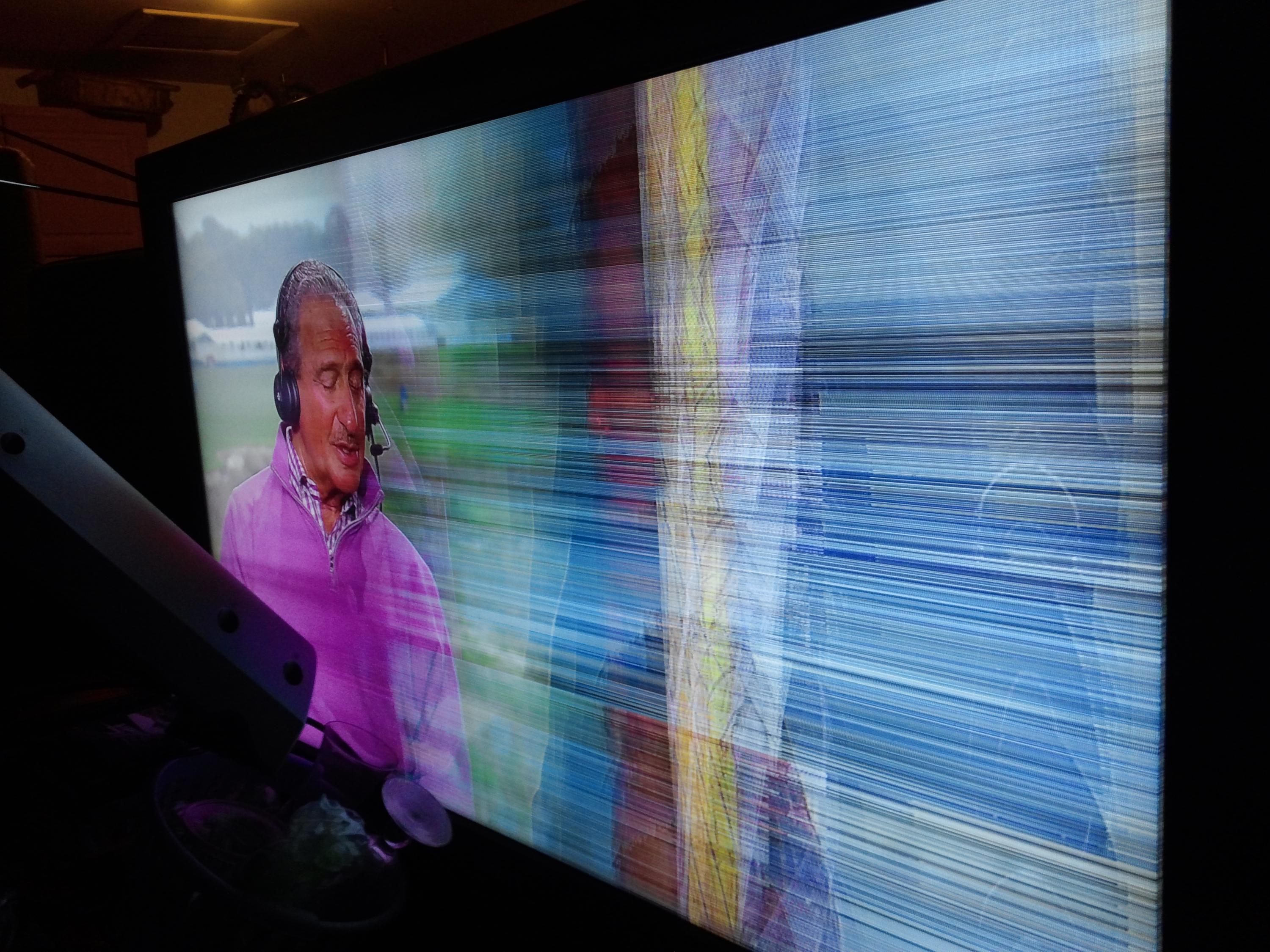

    Hello just had a quick question.my sony lcd has a problem..when i first turned it on the picture was slow to respond lower right screen.then the picture whould roll.few lines but not all the way across the screen.so i tried to trouble shoot the problem..then i turned the tv on again then i had backlights and sound but know picture..so i removed the left rear tcon board ribbon then my right side was white and have a pic on the left..so i thought i was the panel...so i removed the cord to the tcon and moved it around..then i got a whole picture .but the picture was rolling and the same as before..so im thinking it needs a tcon???anyone have any suggestions? ??you guys are smart..you have helped me in the past..and i thank you....

    Re: Sony kdl46s4100 half a picture
    does sound like the typical tab bond problems. And this model is known for that problem also.
      Well i thought so but look at the picture?i also removed the front trim and checked the tabs on the panel but cant find a bad one..also the only way to get the picture whole like you see in the pic is too manipulate the tcon plug not the ribbon...and the tcon is making noise in tandem. With the picture disturbances. ..
        Also im hearing a buzz from my power supply transformers..so i checked my 12v going to my mainboard and its at 11.5v just thought to let you know.
          You could try cleaning the t-con connectors with electronic contact cleaner. This TV is also known for main board issues, but that might be a far-fetched diagnosis at this point. It's still something to keep in mind.
            Yes your right..i cleaned the plug to the tcon..looked at the pins also..just thinking it may be the tcon..if you just play with that plug then you get the image you see in the picture..mabe power supply or main?hell i dont know for sure??
              I am thinking panel more likely, possibly you are flexing the frame when you fiddle with the T-con?
                now I'm not flexing the panel..i thought it was panel related..but if you wiggle it and the panel was out you whould get nothing?when you plug the cable in sometimes it stays and other time it shows nothing..so is it voltage being too low from the power supply causing the left side of tcon to act up ??or tcon failure??or main board issue? ?but when you move the plug and the picture comes back allthough looking like that..but working somewha. .bad connection or cable..but who knows . I CAN TAKE VOLTAGES IF ANYONE IS INTERESTED?
                  T-con boards rarely discriminate between the LHS & RHS of a picture in that manner (that leads to a fading between the sides.) That can only occur due to some signal not reaching the panel, due possibly to a bad T-con, ribbon cable, tab bonding or bad driver IC on panel.

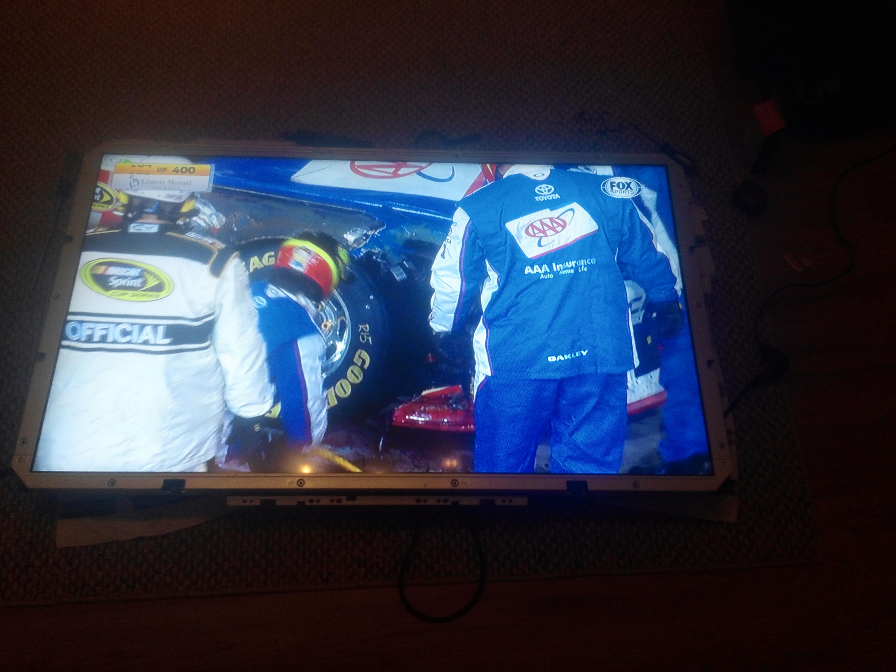

                              You know when your right your right..i just didnt want to just throw the tv away..so i will gut it out..
                                Tab problem simi fixed...

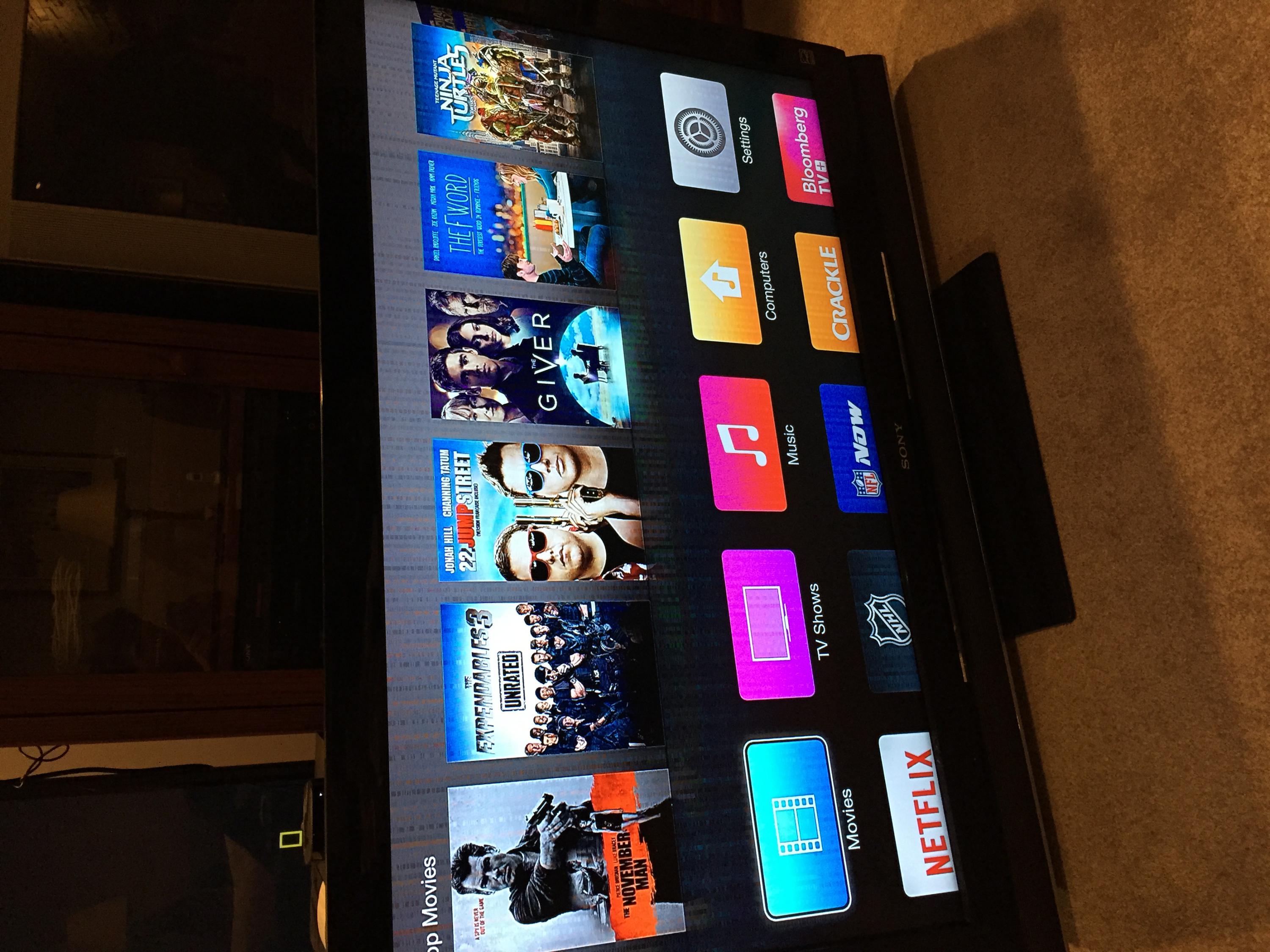

                                      hey tomstr, how did you end up with the final fix?? Your last picture looks like its pretty much there!
                                      I just picked this one up, looks to be green/blue pixelated, searched but couldn't find anything, yours seems much worse than mine so any pointers appreciated! Just got it in from the cold and found the service manual, hope to start on it tomorrow and dig in.
                                        Allgo, yours looks more like a mainboard or tcon problem.
