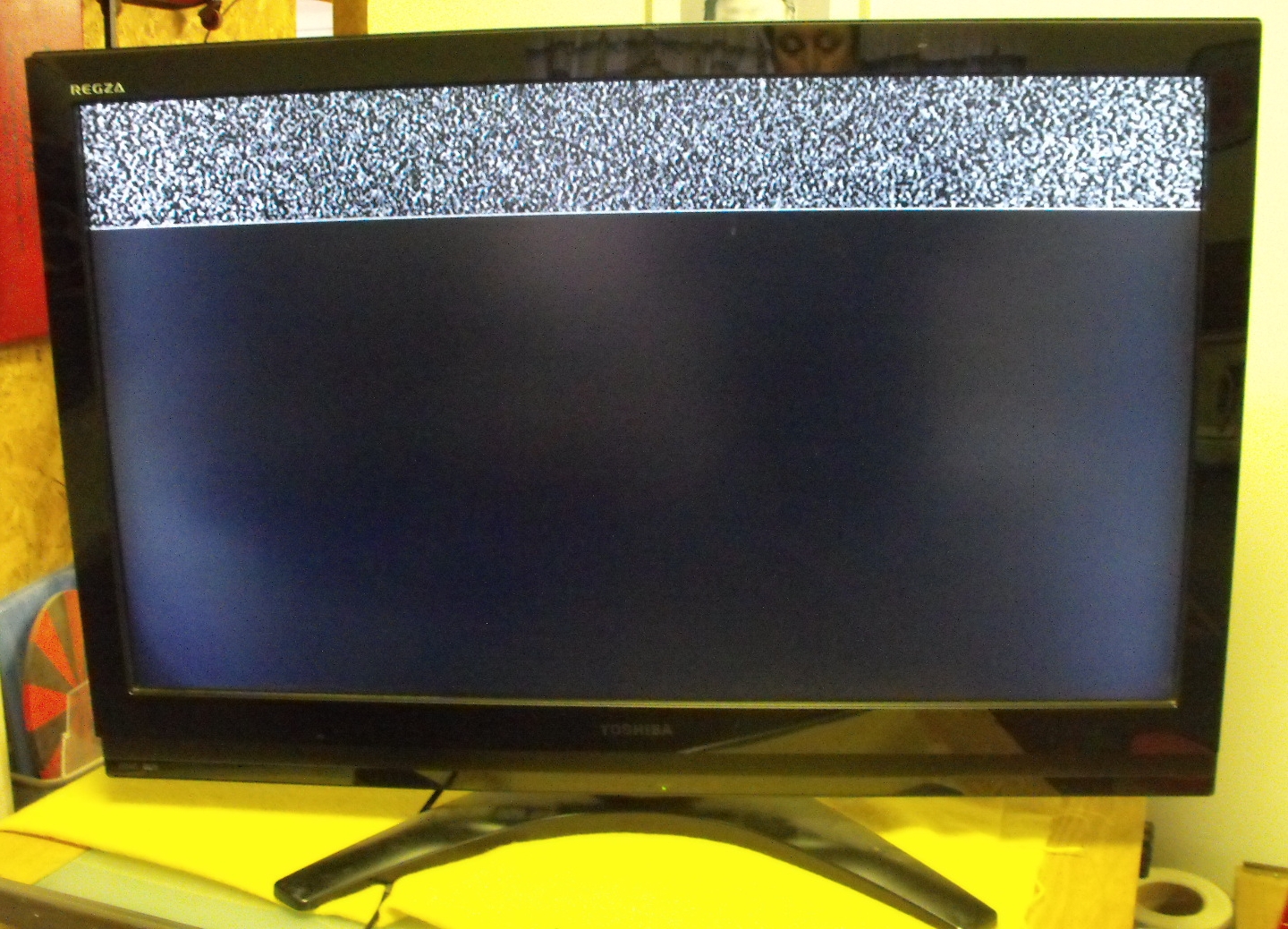

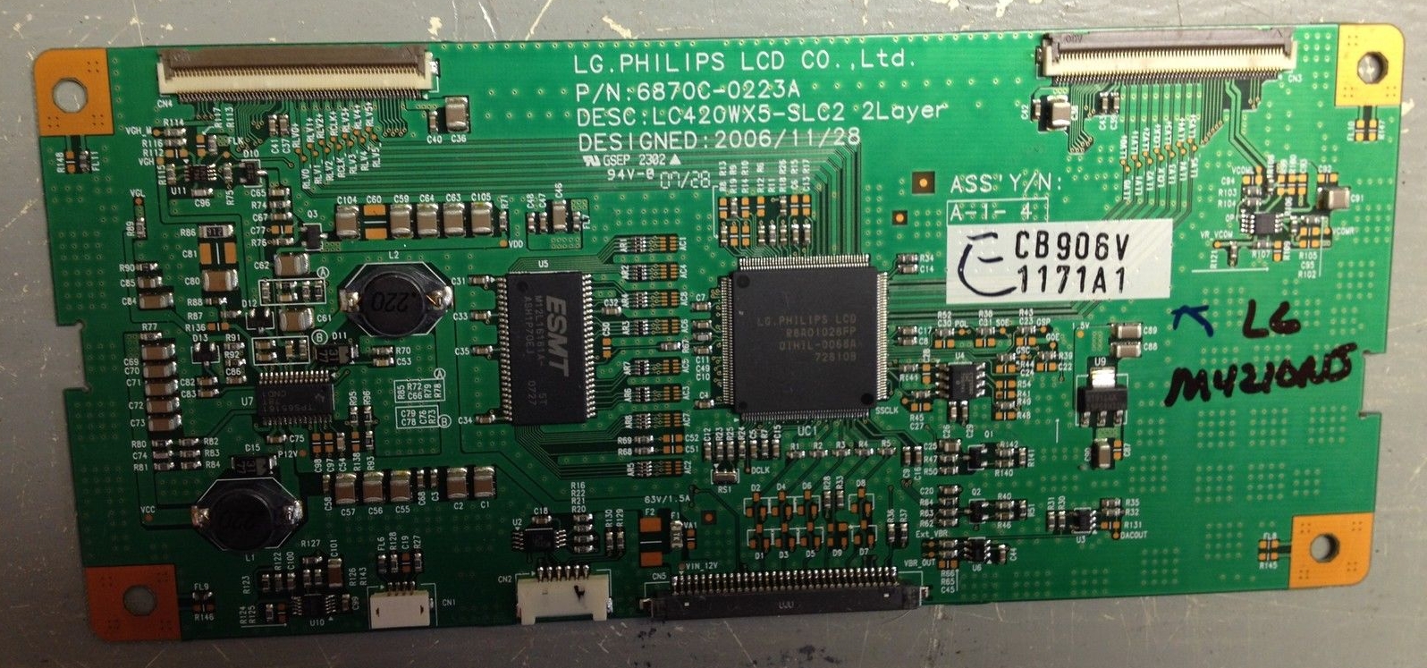

    Toshiba 42HL67 has and issue I have not run across and that only the top 25% of the screen shows and the rest is black. I though TCON but If I'm thinking correctly that woul be a left half or right half of screen issue. Not sure where to start on this one so any help is always appreciated.

    The T-conn board should be the cheapest of the boards to replace. Try that first.

            Just bought a TCON so I will report back once I get it and install. Maybe subscribe to this thread if you want to see if that fixes it.

              did you try to flex the screen or apply pressure to where the fault occurs around the edges and see if it changes at all? if it changes when doing that then it is most likely a tab bond issue. i do know that quite a few of the regza's did have problems with panel failure do main to tab bond issues if i remember correctly. i had 1 that had vertical lines. so that might be a t-con problem. did you try to clean and reseat the cable to the t-con and from the t-con to the panel?

                  Well put in a TCON and that did nothing so money wasted and back to square one.

                    Re: Toshiba 42HL67

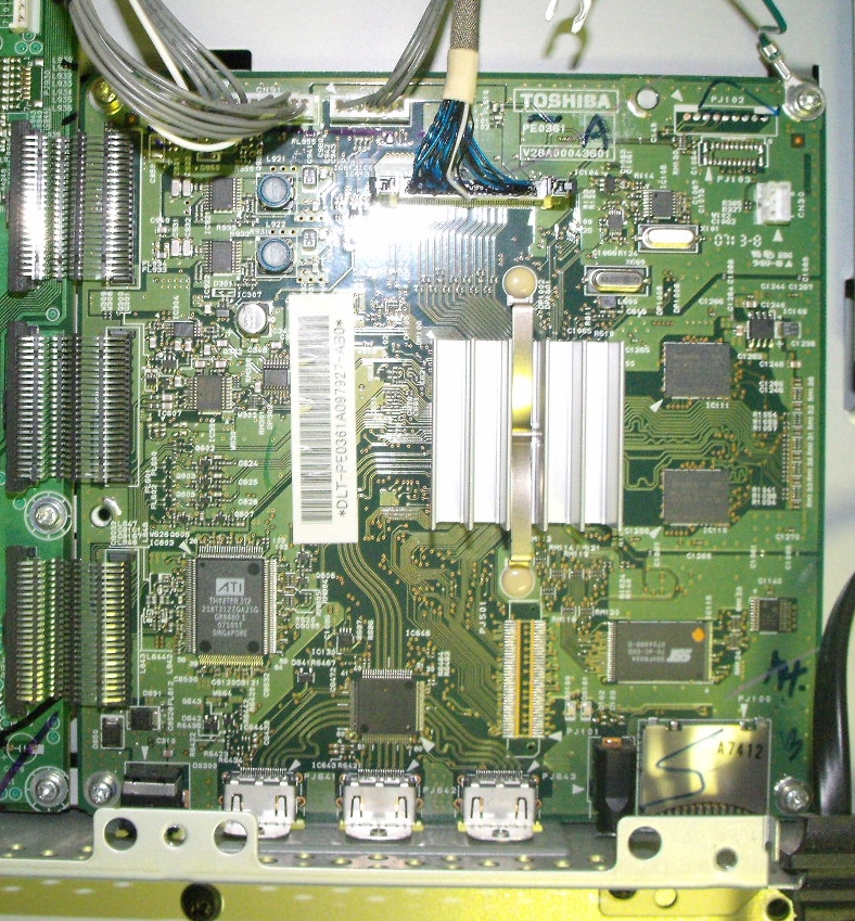

                    can you post a picture of your T-CON board or a part number, I look up this model tv on shopjimmy, I see on one of the T-CON board listed, there is the famous AS15-F on board, which is known to go bad.
                      Re: Toshiba 42HL67
                      90% sure this is a panel fault, AS15F has nothing to do with it.

                        Screen shot then Tom? here is the TCON I put in.

                              Yep screen is toast! top tab on the side. I can push on it and bottom of screen works but still has a white line horizontal through it.

                                that sucks! thats why i asked you to check the tab bonds before ordering a board cause those sets are known for panel faults. you gonna try and fix the tab bonds or scrap it?

                                  I tried to fix it but still had line through it so I just scraped it out.
