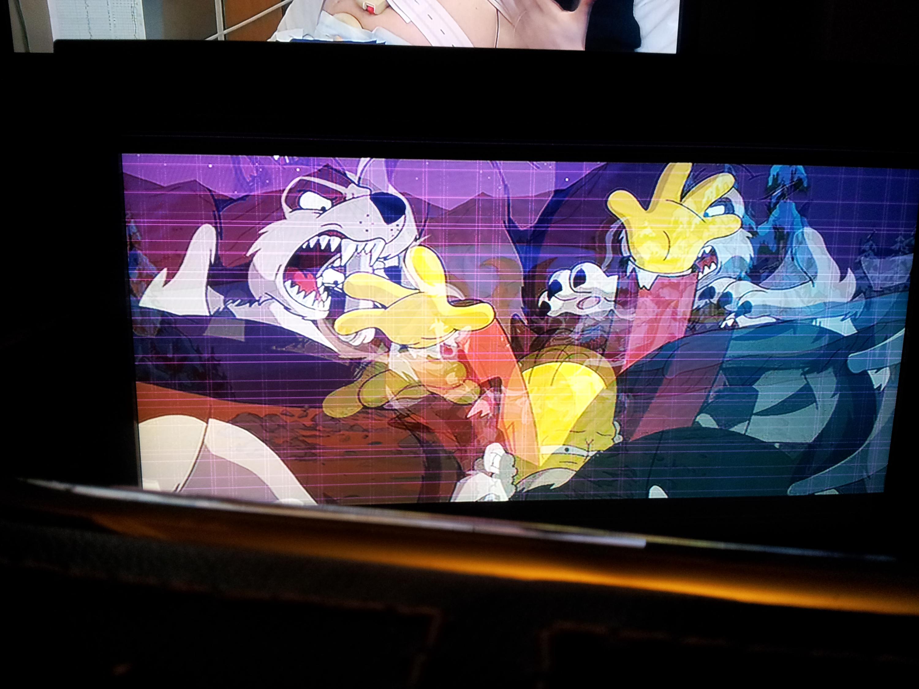

Grid pattern Samsung LE32A456C2D
  • viduka
    • Mar 2014
    • 64
    • Scotland
    Grid pattern Samsung LE32A456C2D
    Can anyone give me a fix for a grid patten on my Samsung LE32A456C2D. I've attached an image should the pattern.
    If I disconnect everything and get the check signal cable screen there appears to be no problem with the display so I'm thinking its the main AV board but any advise would be great.
    Thanks in advance.
    Last edited by viduka; 04-11-2014, 01:55 AM. Reason: Didn't attach image correctly
    Re: Grid pattern Samsung LE32A456C2D
    Do the lines move or are they frozen in place?
    • viduka
      • Mar 2014
      • 64
      • Scotland
      Re: Grid pattern Samsung LE32A456C2D
      The lines move. Like flickering
      • viduka
        • Mar 2014
        • 64
        • Scotland
        Re: Grid pattern Samsung LE32A456C2D
        Anyone any ideas ?
          Re: Grid pattern Samsung LE32A456C2D
          All power supply voltages seem OK? I have never seen this before, very odd.
          • viduka
            • Mar 2014
            • 64
            • Scotland
            Re: Grid pattern Samsung LE32A456C2D
            Still don't know what caused it. Had a Faulty PSU for same TV that I repaired and tried in this to check and it cured the fault. So something on the power board.
              09-07-2024, 05:50 AM
              09-06-2024, 11:40 PM
              09-06-2024, 11:40 PM
              09-06-2024, 08:40 PM
              Samsung Galaxy Book Flex NP950QCG-K01DE Notebook Specification for Upgrade or Repair
              This specification for the Samsung Galaxy Book Flex NP950QCG-K01DE Notebook can be useful for upgrading or repairing a laptop that is not working. As a community we are working through our specifications to add valuable data like the NP950QCG-K01DE boardview and NP950QCG-K01DE schematic. Our users have donated over 1 million documents which are being added to the site. This page will be updated soon with additional information. Alternatively you can request additional help from our users directly on the relevant badcaps forum. Please note that we offer no warranties that any specification, datasheet,...
              09-06-2024, 06:20 PM
