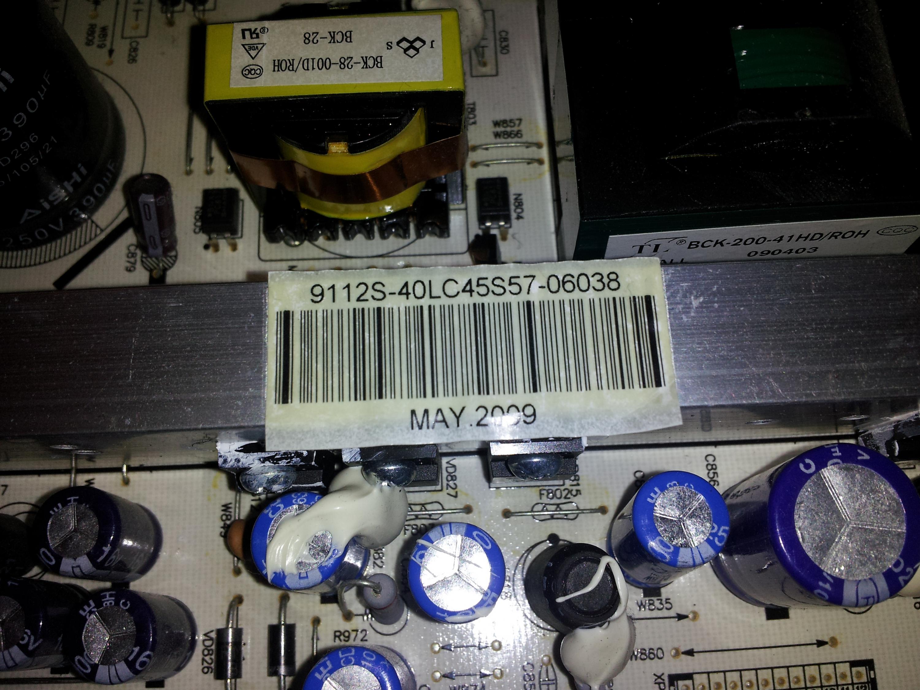

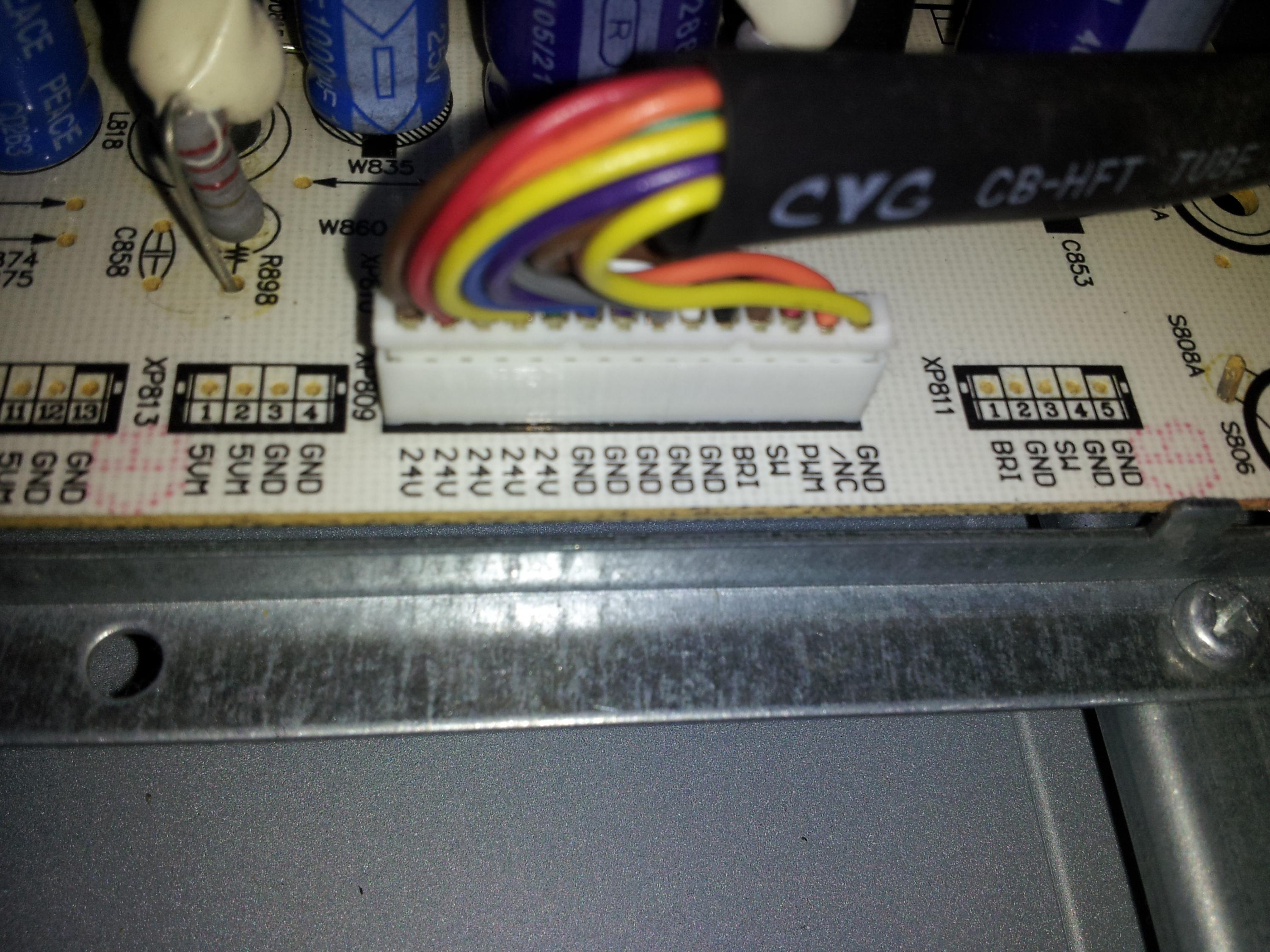

      The wine sound is sounds like a high pitch ghost busters siren like that of a mouse. When I unplug the inverter and plug the power cord back to it, it becomes a steady high pitch sound like that of an old CRT TV when it is off but goes away once turned on. Also the unit will fully power up and I can see the "No Signal" message dancing around the screen if I take a flash light and shine in through the back. The voltages are stencil screened onto the board. I have included some attachments of the board and a close up of the connector that feeds the inverter. I removed the inverter cable from the PSU and powered it up. I found that all of the 24V legs on the connector read 24V. The SW leg reads 4.7 and the PWM leg reads 2.5V.

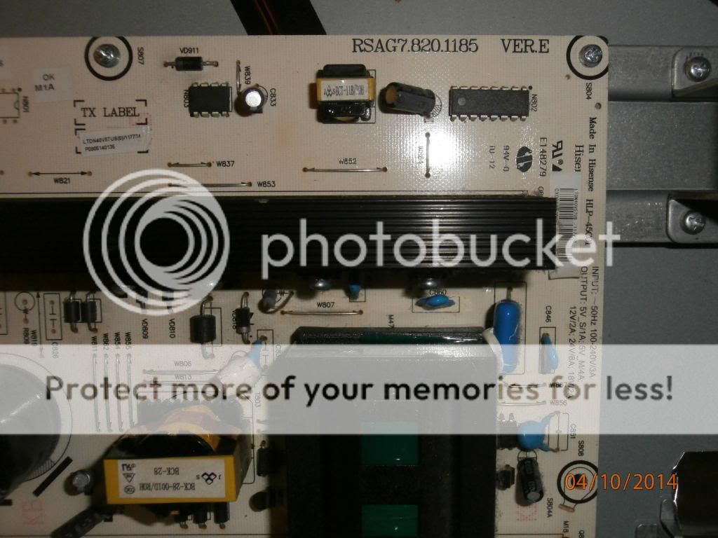

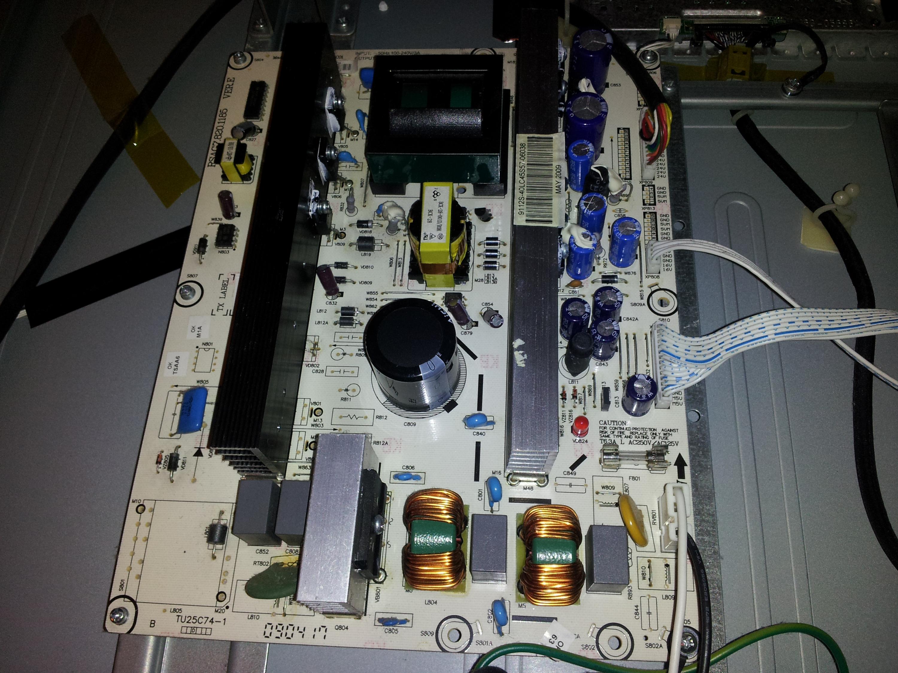

        Show us good clear pictures of the inverter board, also straight shot pictures of the power supply board.
          Re: Proscan 40LC45S57 with red LED and clicking.
          I have attached some more pics of the PSU board and inverter board. I don't have a cap tester so unable to test them.
          I tried taking the pics in such a way that you could lay them out together to create one big picture.
          Here are the PSU board pics.
