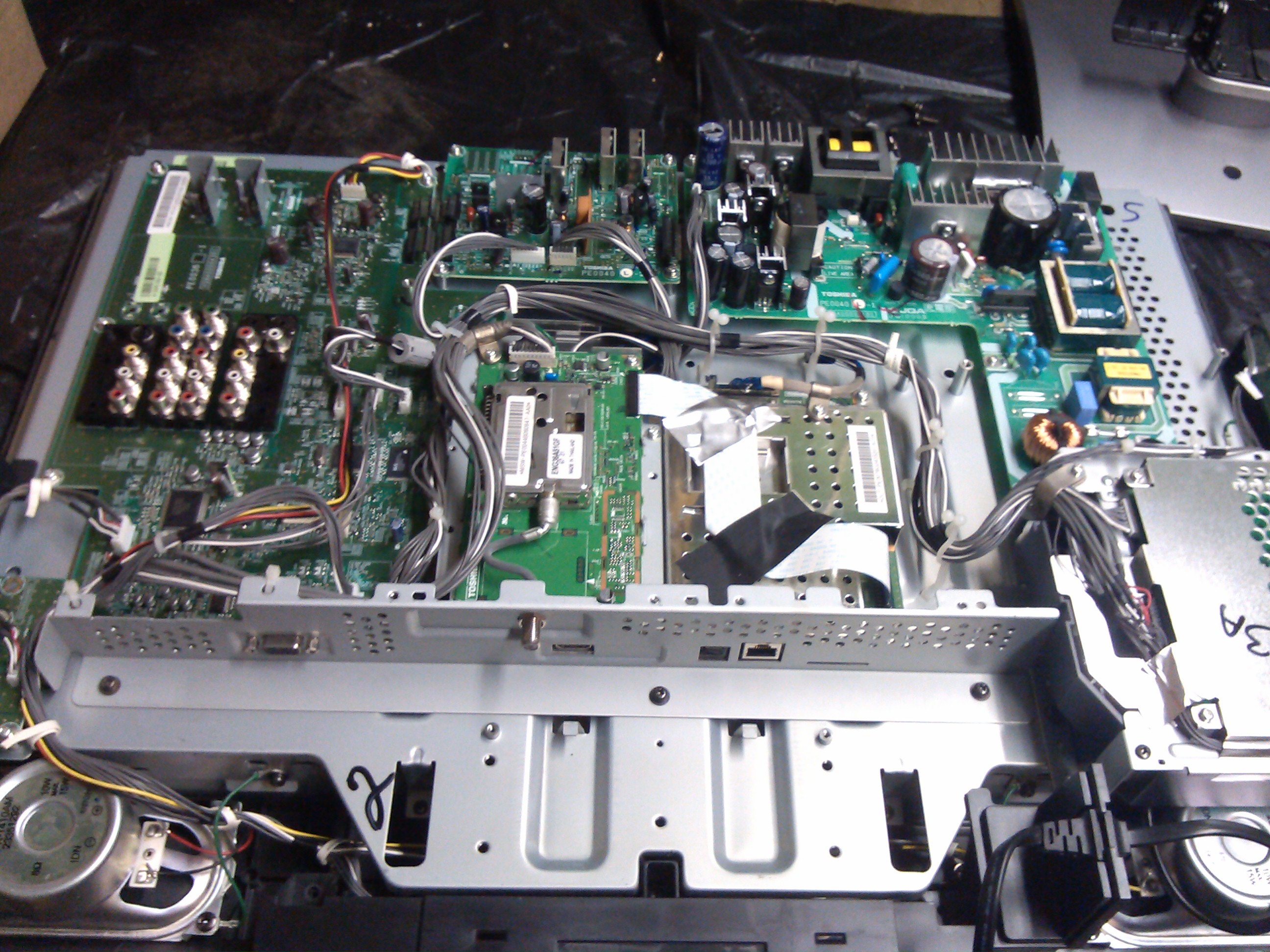

toshiba 26hlv66 no picture?
  • mattstolte
    • Dec 2013
    • 612
    • usa
    I get sound but just white picture, main board or tcon? im not sure how to figure that out?

    I see dead caps

    Re: toshiba 26hlv66 no picture?
    I'm not sure either, but you could try re-seating the LVDS cable(s)?
    -David VanHorn
      If just white glow on the screen and cannot see the user menu, then check the SMD and the DC Voltage on both ends of the fuse on the T-CON board.
      Picture of the screen shot?
