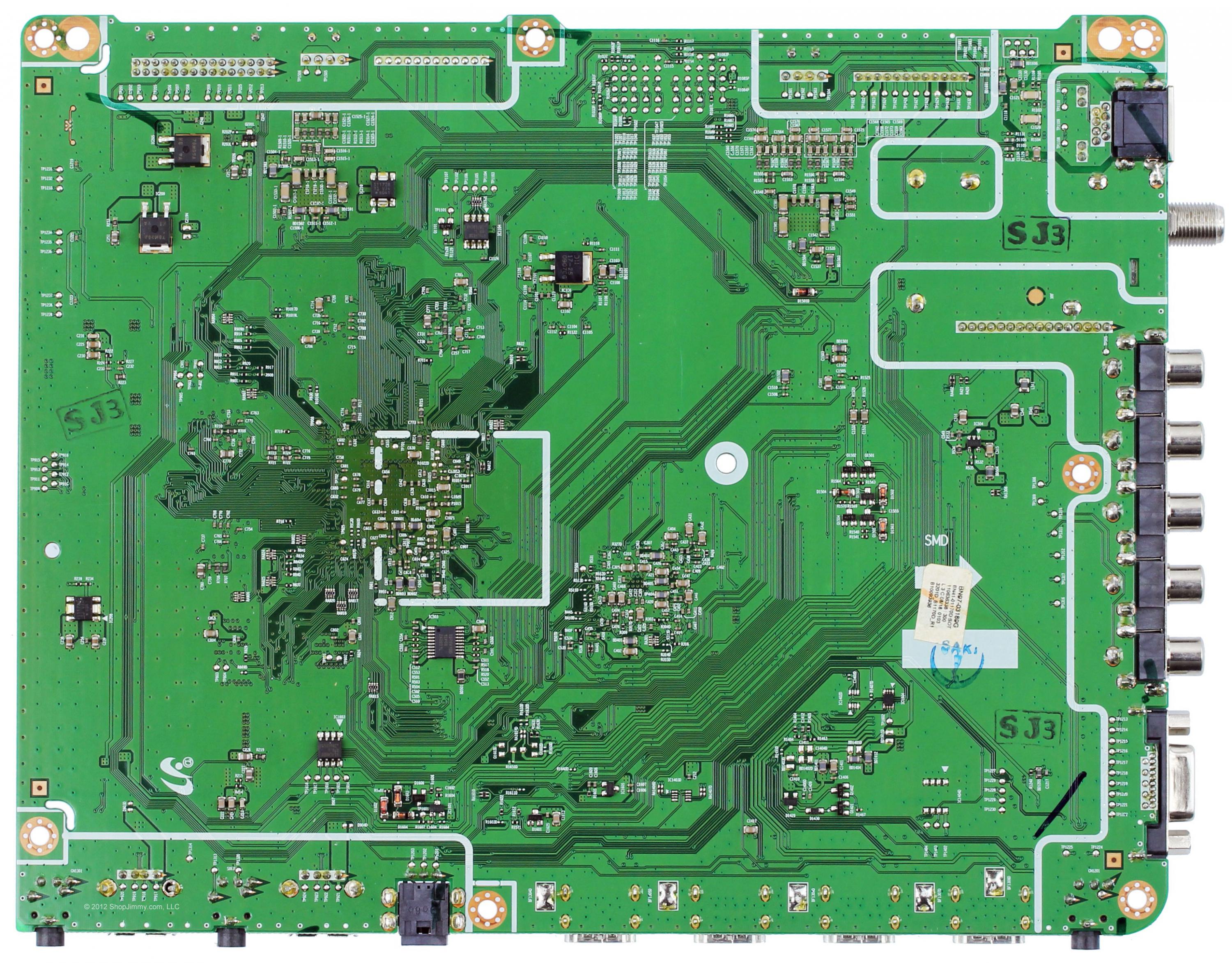

        Re: Samsung UN55B8000F Mainboard Issue(Relay Clicking Issue)-Help!!
        If I can get up some pictures of the bottom of the board, think you can help me trace it out and what to check out?

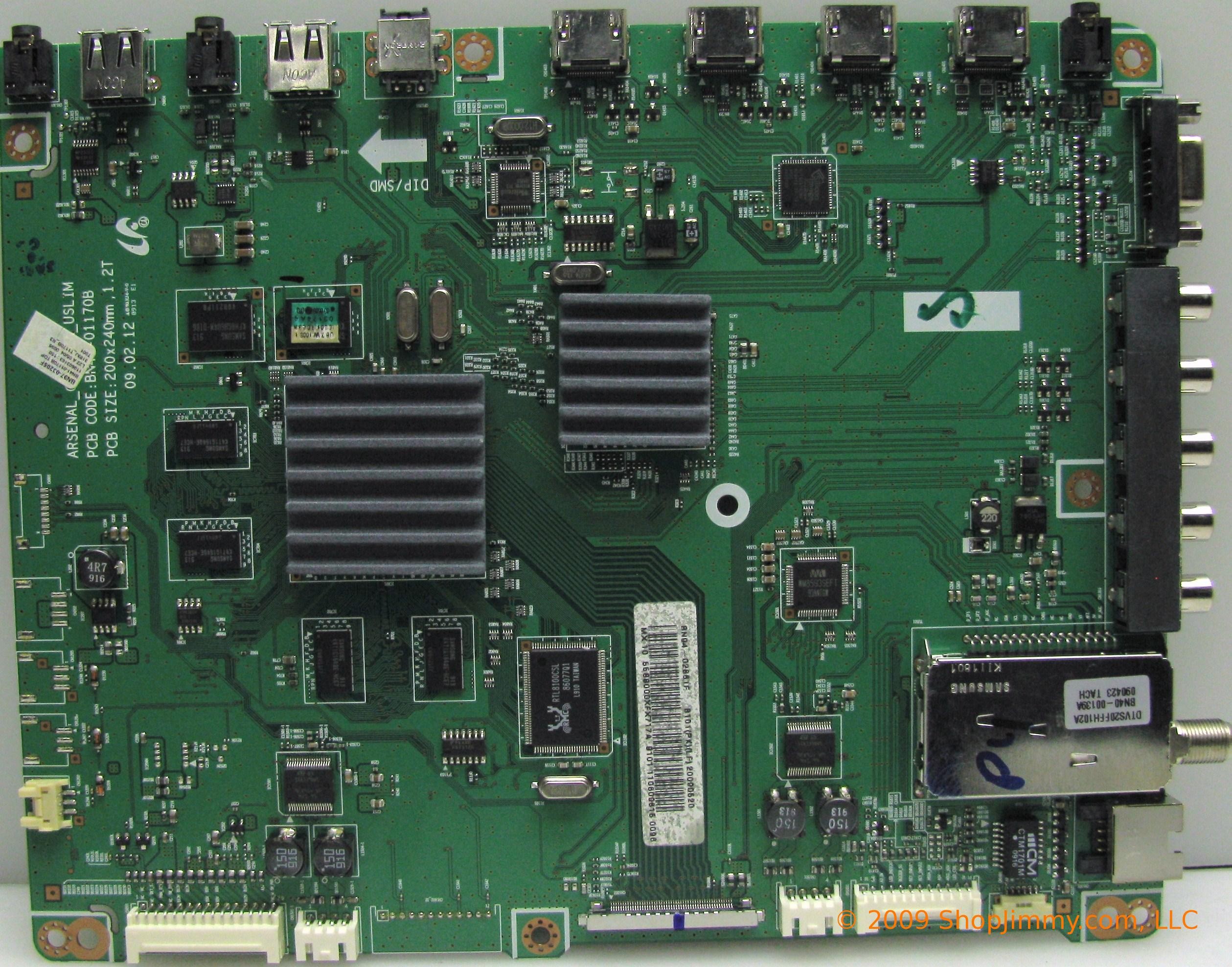

            Apparently, this board BN94-02640M has the same build as mine. All the IC numbers and board id #'s match along with the part numbers on the components.
            Shopjimmy image of the underside.
            http://www.shopjimmy.com/media/catal...40m-bottom.jpg

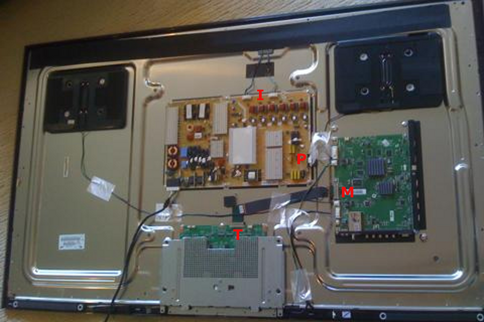

                I have been playing around with it some more and got the standby light to come on.
                Once I plug in the AC, the blue light turns on and goes off along with a click and it does the continues clicking but not more blue standby. I do get a steady 5v standby with it clicking on/off.
                No relay clicking or blue standby with mainboard disconnected. Suspected mainboard fault still?
