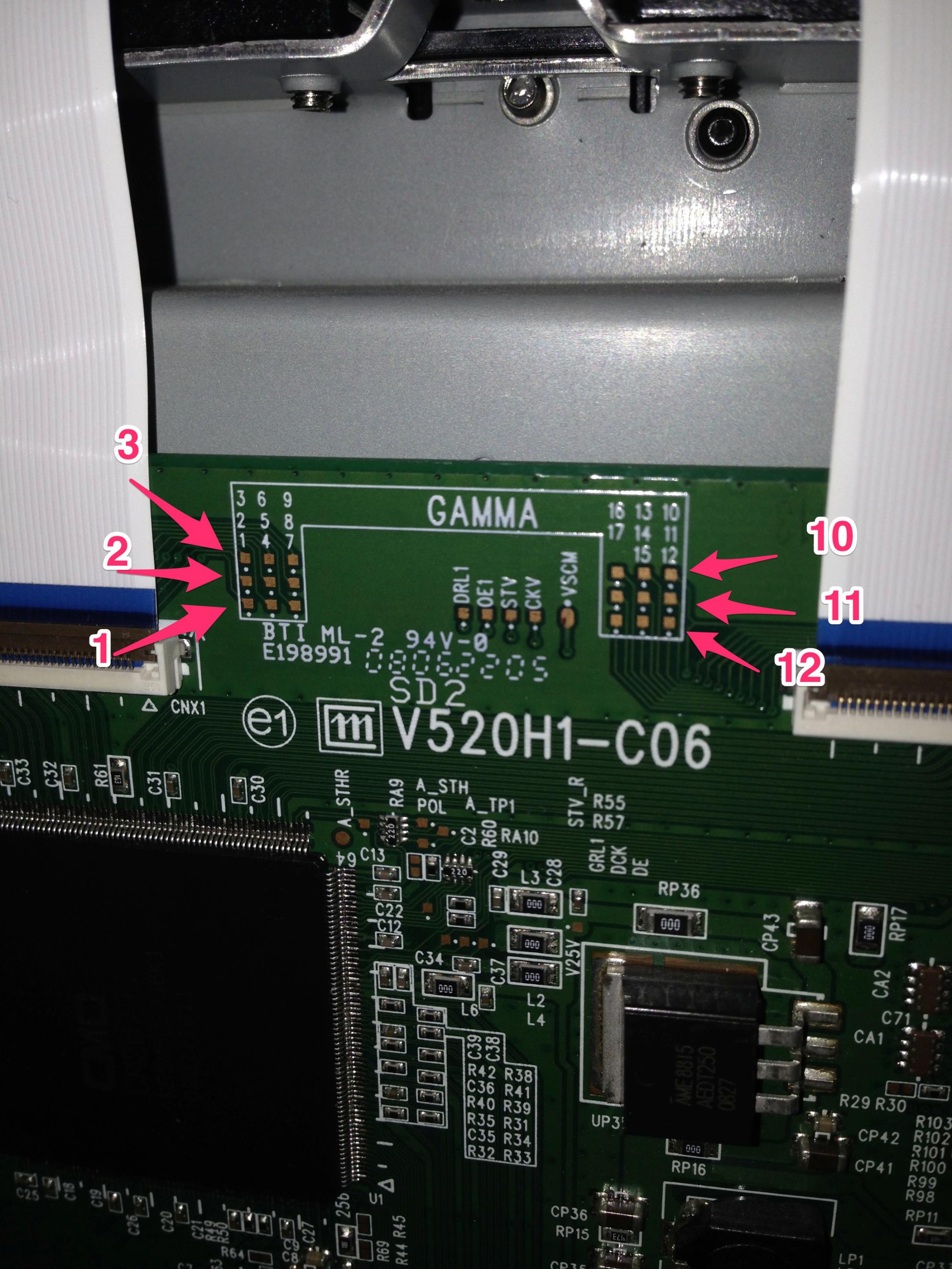

                So.... Bad news.. Before I could succeed getting the IC of the broad, I got a Tcon replacement, and I put it in, but the TV still looks like crap. Unless the Tcon replacement is messed up exactly in the same way mine was, I think it could be something else. Any ideas?
                AD
                  Re: Samsung LN46A500T1F Color Distortion problem
                  The way to check would be to make those gamma measurements again.
                  Just recently, picked up a 37" Sony with a gamma problem, which is actually my first. I haven't done one before. Should be a good subject for a video.

                    OK... first of, please let me know if I'm understanding the numbers correctly according to the picture bellow... Is that the right order?
                    If so.... here are the values.
                    Volt 1 15.1
                    Volt 2 12.9
                    Volt 3 12.1
                    Volt 4 11.32
                    Volt 5 10.92
                    Volt 6 10.6
                    Volt 7 10.47
                    Volt 8 12.61
                    Volt 9 9.23
                    Volt 10 6.43
                    Volt 11 6.1
                    Volt 12 4.46
                    Volt 13 6.77
                    Volt 14 7.52
                    Volt 15 5.78
                    Volt 16 7.93
                    Volt 17 3.2
                    AD

                      From the voltages, looks like another bad tcon..
                      A lot of tcons are commonly misdiagnosed as coming from a "bad panel" so I wouldn't be surprised. It has happened to me before also.
                      They see something wrong with the picture, assume its a bad panel, and assume all the parts inside are good, working, and Then labeled as tested.

                        Did I interpret properly the numbers arrangement?
                        AD
                          #32
                          Yep, you interpreted it correctly, and right there's another bad t-con. So yeah, did they claim to test it? They probably didn't...

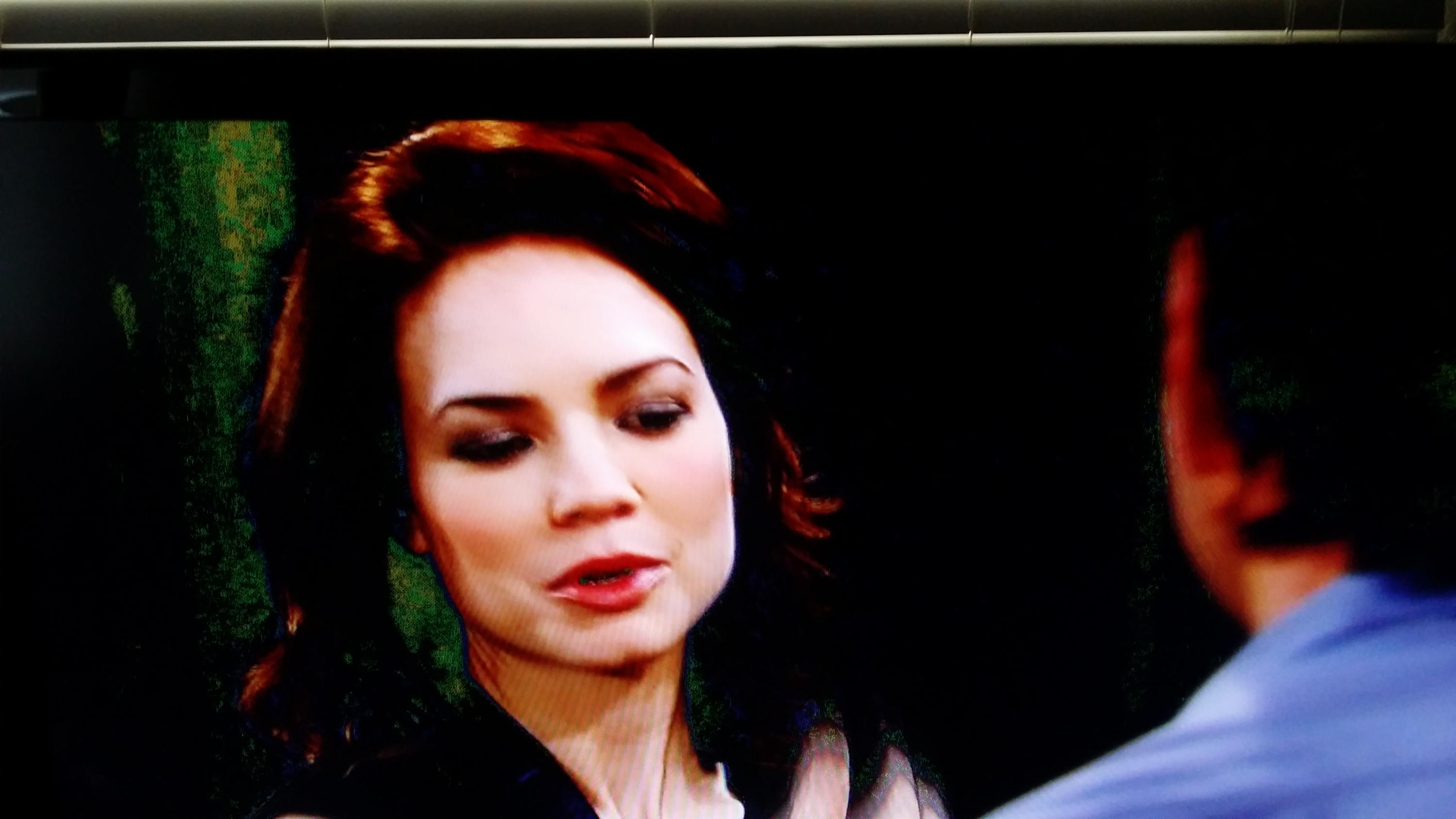

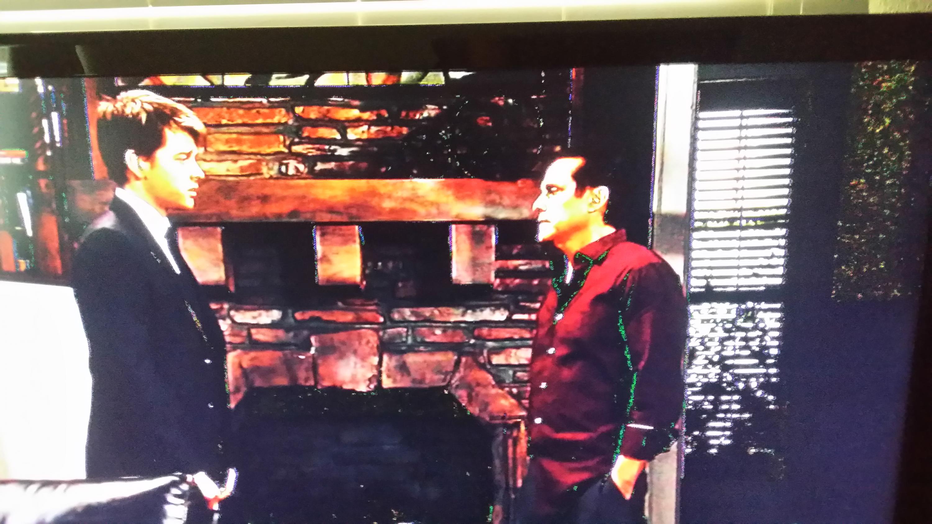

                                  Hi everyone, I need help with my LN46A500TIF Samsung TV color Distortion as well ... however, I do not have Solarized Distortion. I would like to replace the parts myself if it is feasible.
                                  *I do not have Cable, Use OTA to watch TV, Netflix, Chromecast, & Blue Ray
                                  TV Settings: MUTE 182 Power
                                  - LVDS Out format has to be set at JEIDA.
                                  -- If LVDS is set at PDP or VEGA, the image produces Solarized Distortion.
                                  - TV is set to "Movie" not dynamic.
                                  -- when the TV is set to "Dynamic" the pixels have less distortion.
                                  Color Distortion: using OTA
                                  - On OTA HD channels, there is significantly less noise/distortion of pixels.
                                  - Images with light colors (white,cream, bright blues, yellows, or pastels) do not have pixel issues
                                  - Images with dark colors sometimes have blue speck outlines instead of black
                                  - sometimes images look completely normal (no noise/distortion of pixels)
                                  - On non-HD channels, the black colors are shown as green or red pixel specks.
                                  - Images never look normal
                                  - channels are noisy.
                                  Color Distortion: Using Netflix
                                  - Pixels do not interpret the red color correctly. (displays as pink or orange-ish)
                                  - I do notice kind of a "heart-beat" in the pixels.
                                  Visually inspected MB & Power board:
                                  - caps are not bulging
                                  - caps are not leaking
                                  - didn't notice any issues with masking or solder but I'll have to recheck that
                                  - disconnected connector cables to Power board & reconnected to see if that would fix the issue, nope.
                                  - disconnected the connector to the TCON board and reconnected, did not fix issue.
                                  Overall TV Never has these symptoms:
                                  - I do not have any bar lines (vertical or horizontal) on the screen
                                  - I do not have any blocks of missing/empty colors/pixels
                                  - I have not had any problems with my turn turning on/off.
                                  - Audio works fine.
                                  **** Looking online, this problem seems like it could be related to CFLs, TCON, or Power board.
                                  - I was going to take a scope to the caps on the power board but I don't know how I could get a reading off of them the way they are soldered, so I haven't done that yet.
                                  - I was thinking of removing the caps on the power board and checking their capacitance I'd rather do that as last resort to see if something else may fix the issue.
                                  The less distorted picture is an HD channel. The heavily pixelated picture is from a SD channel.
                                  --- I was informed that this maybe a main board issue, if so, can anyone direct me in the correct direction on what I fix. If it's too complicated or not worth it, I'll buy the board. ---
                                  Thank you

                                          I did do a software update and that did not fix my problem. I also have my TV in JEITA format due to the other two formats causing solarized distortion. However, I do not how to verify what software was installed onto the TV. Does anyone know how I can find that out?
