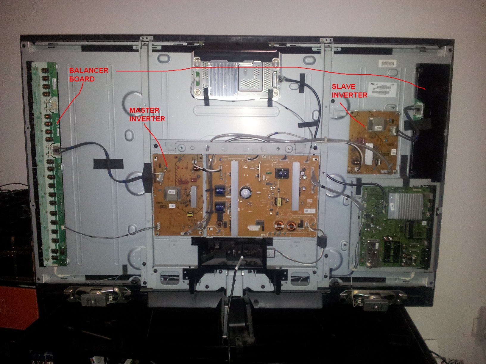

    Hi, I've a more global question compare to my current problem (post link)
    When you start your TV, you don't have any image or light but you do have sound.
    What would be the reason for loosing the backlights (inverter problem) and the image (T-Con problem) at the same time ?
    The only common point would be the Powser Supply board ?
    Or maybe the logic board ? I've read that the logic board is suppose to send the signal to the inverter to lit the backlights.
    I still have sound though ...
    Can an inverter board problem impact the T-Con board ? (and inverse)
    My points is that many people have suggested to me to change my t-con or inverter, but it just don't make sens to me ...
    Hope anyone can help me and point me to the right direction.

    It can be the main board is not sending the switch B+ to feed the T-CON board or the T-CON board SMD fuse may be blown, as for the backlights, you may have bad inverter circuits, lamps, or the main board is not sending the signals to turn on the backlights.
    Do you see any LED flashing the error codes?

      When I power up the TV, I got no lights, no image, just sound. Then the TV turn off and I got a 13 blink then 14 blink and it keep on 14 then.
      I understand what you say, but what would be the odd to have a T-CON failing at the exact same moment as the Inverter ?
      Except if you tell me that a T-CON problem can impact the inverter (or reverse).
      This is why I'm guessing this is a more about power supply or logic board (this is the main board right ?) problem

                    Mainly in those documentation, you can see that there's only one inverter board
                    I got 2 + two intermediate board ... not sure what they are for.

                      They are master and Slave.
                      Does you TV look anything close what is shown on page 68 of the CTV-45 EX1 traning manual?
                      "It does feel a bit odd that all screen size are there except mine :s" What do mena by 'S'?
                      Pictures of your TV so we can see what we are dealing with?

                        Ok, I'm starting to understand the difference with my screen thx to the training manual
                        For small screen balancer and Inverter are on the same board
                        And since my screen is too big, those are separated, the balancer would be the long board and the inverter the intermediate board ?

                                    OK, I will need the GOOD CLEAR closed up pictures of the small white connector on the Balancer boards, and the closed up pictures of the master inverter, slave inverter, the power supply boards. The pictures must be clear enough for me to read the labels on the connectors so we do some testing of the signals on the connectors.

                                      So here it is: http://entrepot2.free.fr/tv/
                                      There should be all the pictures in HR(a bit heavy ...)
                                      As for the balancer's connector I wasn't sure of which one you were talking about (well I guess the smaller one connected to the inverter)
                                      So I split the balancer board in 2 pictures in HR so it should be enough to see (the voltage ?)
