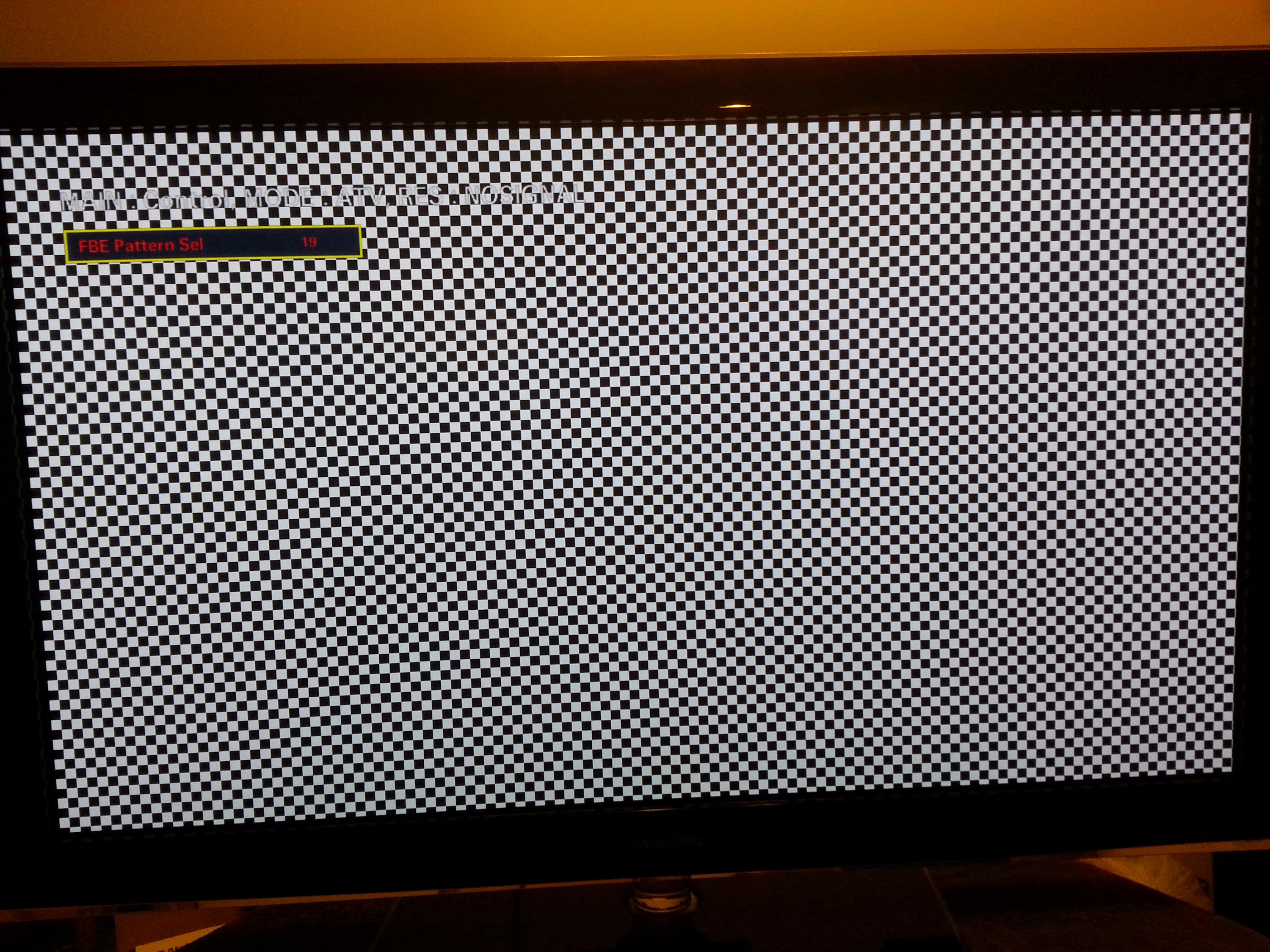

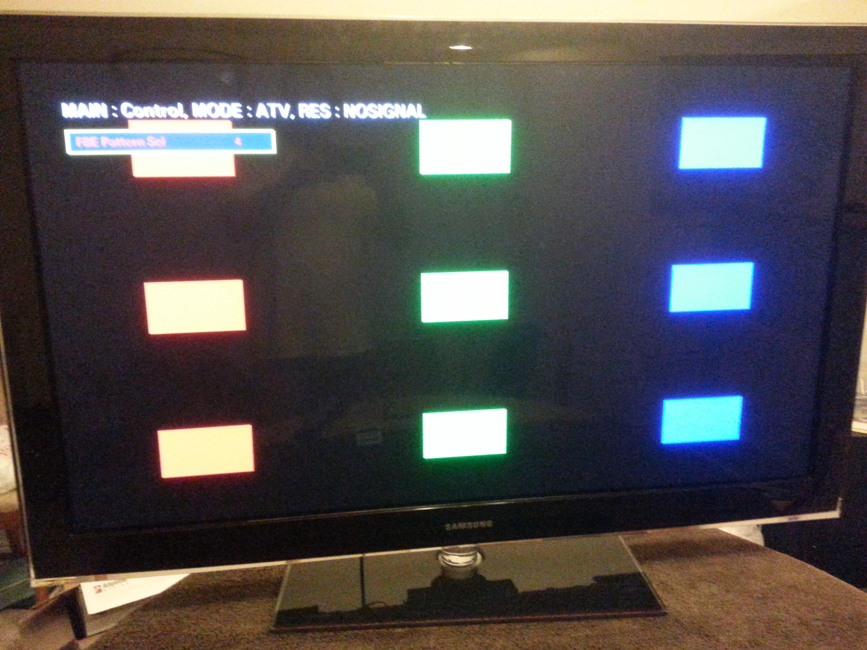

    I'd say a good chance of a loose connector for that part of the panel, doesn't look like a bad panel to me. Also make sure ribbons from control board are seated into the boards correctly.
      Re: pn50b650s1f

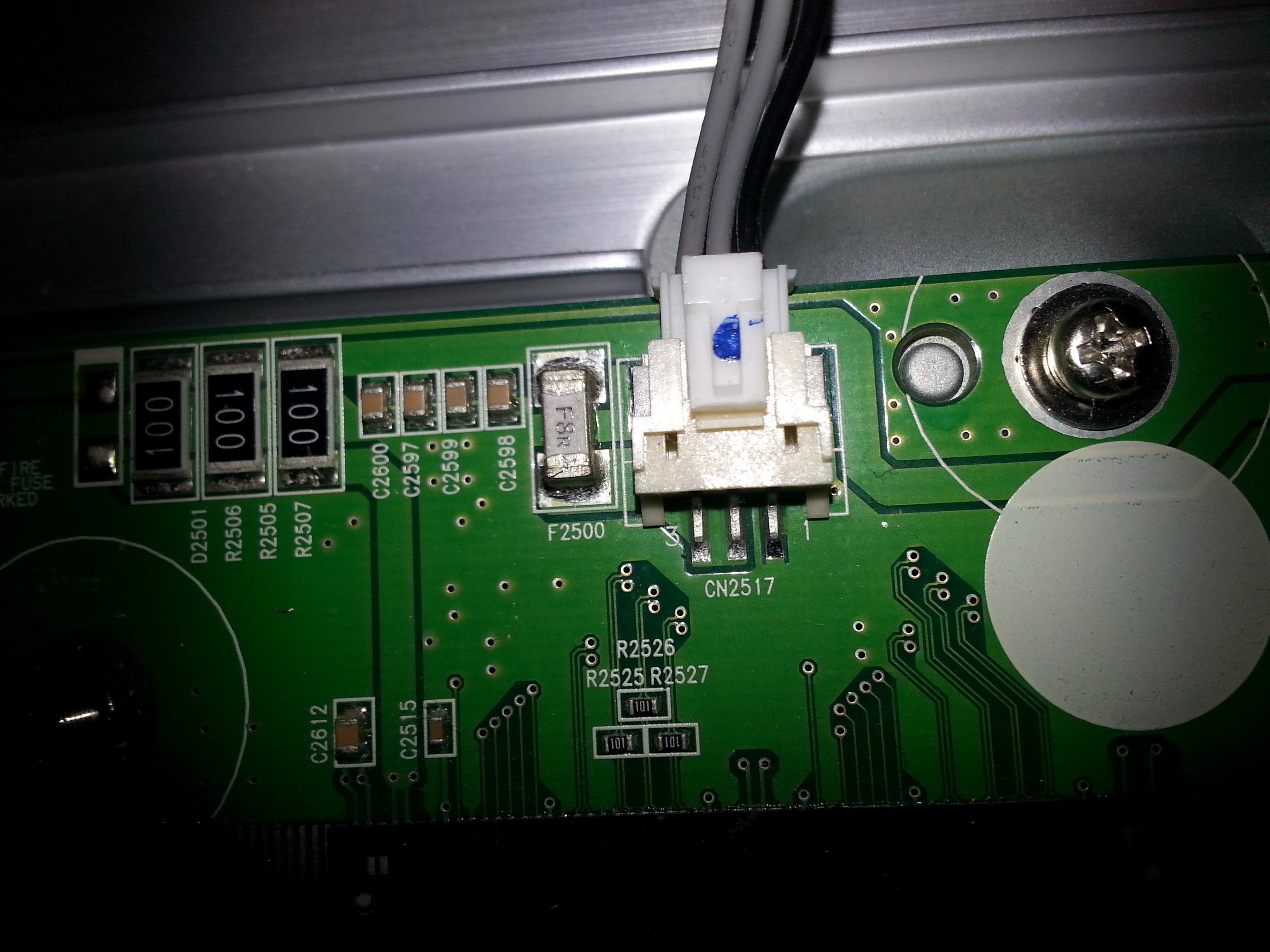

      thanks i will try that. i soldered a thin wire on the fuse just to see if it start up. which worked. will this affect anything? just for testing of coarse.
        Re: pn50b650s1f
        If the fuse blew there's a chance the panel is bad, but it's quite rare for one to fail like that.
          Re: pn50b650s1f
          yeah thats what i though. the fuse is there to protect the board i will amagine. any ways i just hope the cable that connects the two together is right. ill try to check the buffer cables this evening. thanks to you both.
            Re: pn50b650s1f
            ok . update i looked at te bottom buffer boards. i didnt see anything visual wrong so i decided to reow the board a little just to see if there was a change. now the red line is yellow .. go figure..
              Re: pn50b650s1f
              You've gone from losing both green and blue to losing only blue for that part; in my opinion, that's progress. Whatever you did, try doing it again. Check ALL connectors on BOTH ends of the control board and buffer boards.
                Re: pn50b650s1f
                thanks tom for the advise. and to keep me going with it. i hate to giving up. but i was going to. update , after all the panel is good. i reflowed the left side lower buffer board with a heat gun . and it work im back to a normal picture. i see how long it will hold up being these tv heat up.... does any one know where i could fine the mini ceramic fuse for this buffer board .. thanks to caeb and tomm for your help.. hope this helps someone else. reading is fundamental. great job guys..

                  Make SURE you install the heatsink for the X-buffer if you run the TV for longer than about 30 seconds.
                  What is the rating of the original fuse?
                    #29
                    Re: pn50b650s1f
                    The original is an 8 amp, here is a similar fuse on digikey, Its 250v ac 125v dc Tom will that fuse will hold up in that location?

                        tom what are the heat sinks your talking about? i dont see any on the boards. is it the metal plate you have to take off to get to them ?
                          #32
                          Re: pn50b650s1f
                          Yes, the metal plate is the heatsink. It absolutely MUST be installed or failure of the panel is likely.
                          This should work as a replacement:
                          http://www.digikey.com/product-detai...90CT-ND/813068

                            well that didnt last for long. i left it on about an hour. and know i have a purple line in the same area . im really nervous about reheating it again. i guess i have nothing to lose. what do you think . is it the heat flow of the board or something else.
                            so i turned t off about 20 minutes turned it back on and know the purple line is gone.. im loosing it..
                            is it possible that i dont have the fuse. will this make a difference ?. HHHmmm; maybe ill wait to get the fuse before i make things worse.

                              What part are you reflowing? If it isn't the ribbon portion some flux added to the joints may give you a better reflow
                              Liberating magic smoke one part at a time
                                #35
                                Re: pn50b650s1f
                                i flowed the left side lower buffer the side where the line is located.im assuming that each buffer controls the side it is on . am i right ? ill have to go to RS to get some flux. im just really nervous to melt he plastic connectors. i wish i new where exactly to heat so i dont have to heat the whole board..
                                  #36
                                  Re: pn50b650s1f
                                  well i reflowed the board again with flux and it last about an hour. an the purple line returned. im at my wits end. i thought i had it this time. im going to ware out the screws threads. i think, im just not heating it up enough or it just cant be fixed..
                                    #37
                                    Re: pn50b650s1f
                                    UPDATE; so i figured i has nothing to loose. so what i did was, so to not heat the ribbons and tabs, i left the heat sink on. to protect these part. and i was bold enough to heat each set of chips for 30 seconds each. at a low setting on heat gun. and so far so good. the set has been working about 2 hrs. i think i got it. call it lucky . i figured i had nothing to loose . so after 2 week and 150 bucks give or take. and the most important thing .knowledge.. thank guys
