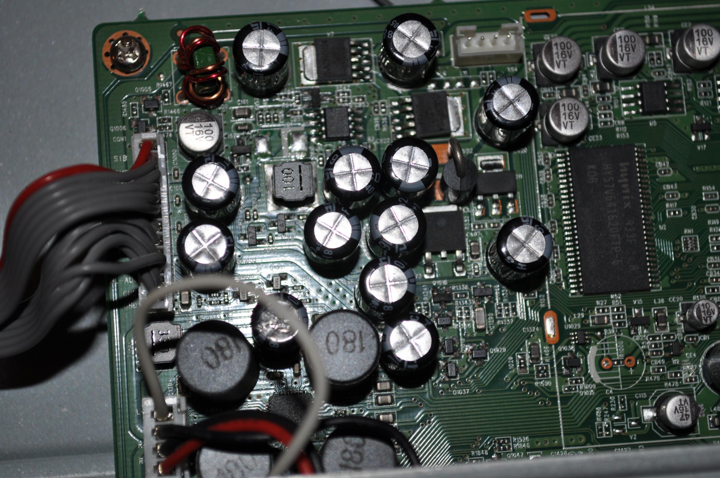

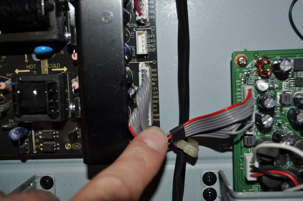

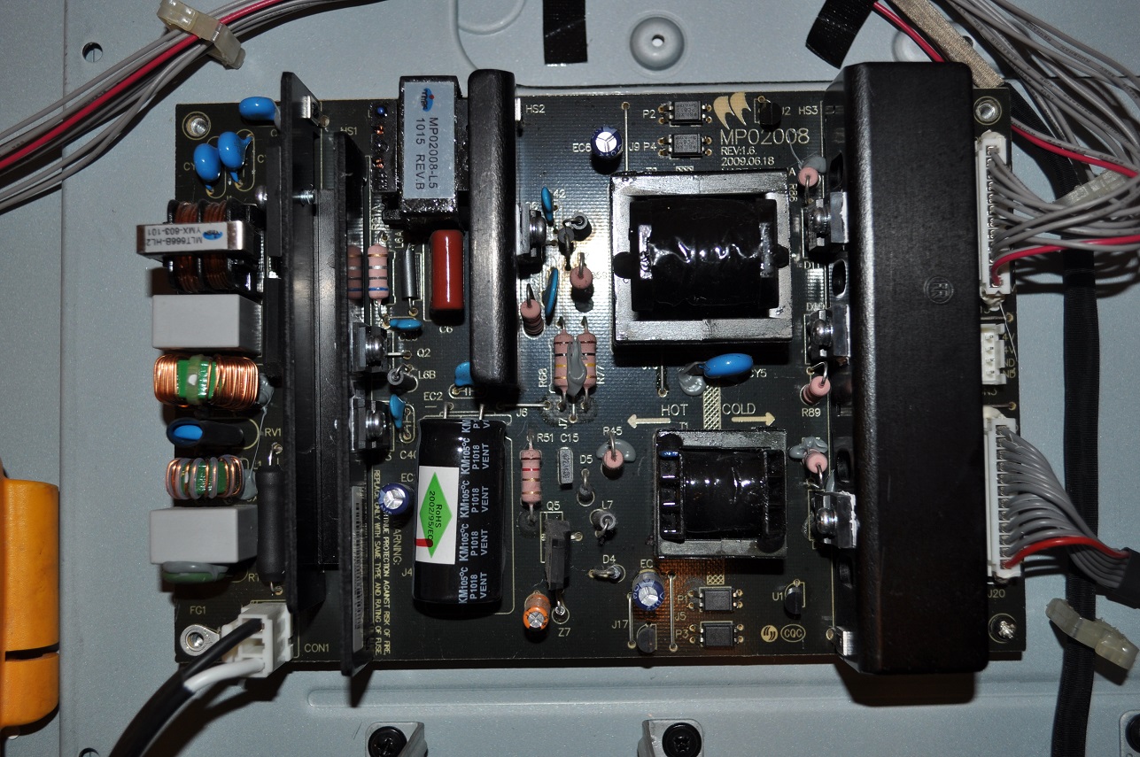

    I picked up a Dynex DX-32LD150A11 cheap that the owner said it would not turn on. It has the red power light in front but wont turn on. Checked the power supply no bulged cap's. I'm thinking power supply is ok and am leaning towards bad main board any suggestions? Tested all pins
    G
    G
    ADJ .0021
    BK .0034
    12v 11.91
    12v 11.91
    G
    G
    5V 5.216
    5V 5.216
    5VSB 5.216
    PSON 4.802

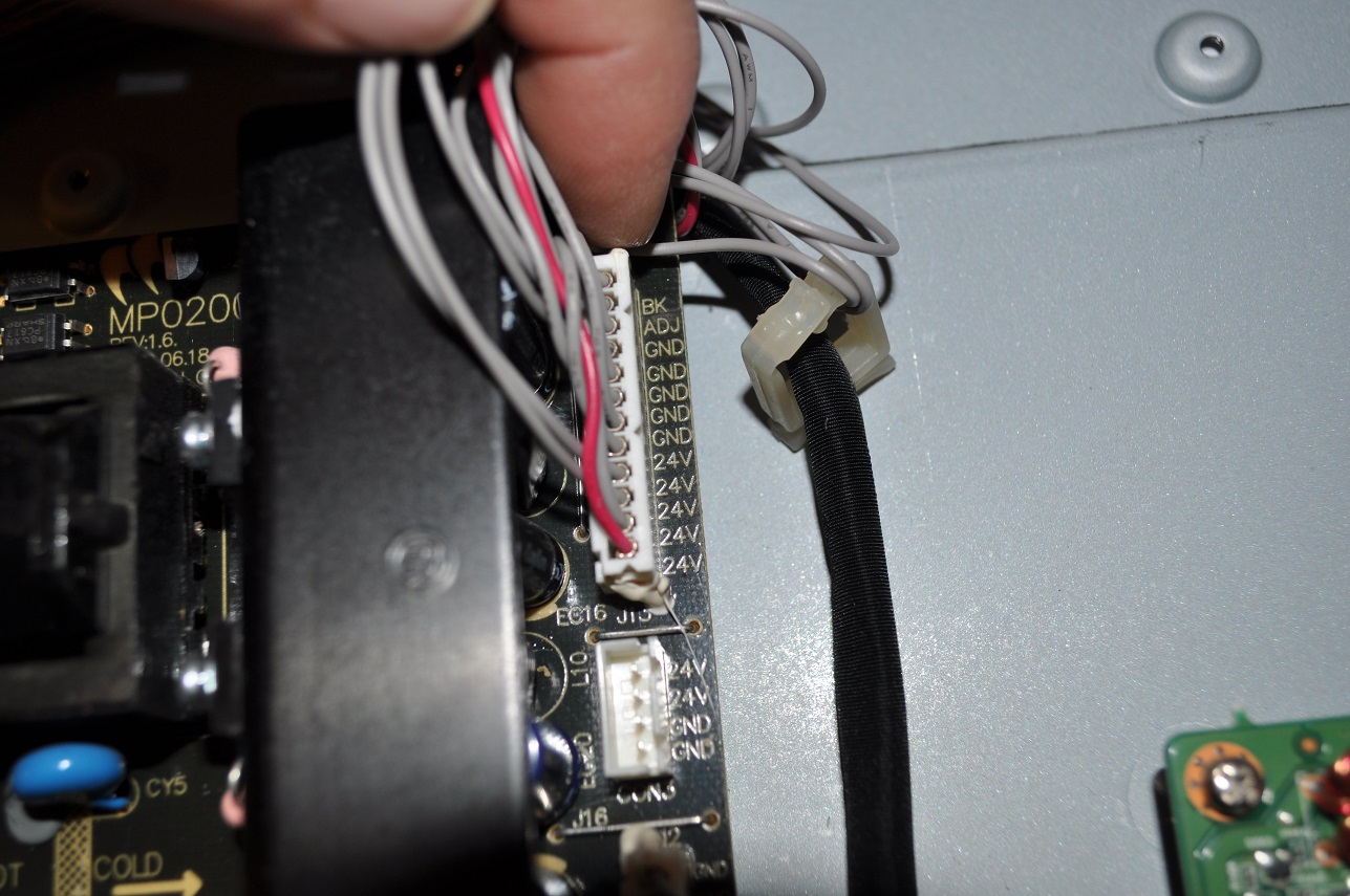

    Upper block shows 24.48VDC on all 24v pins

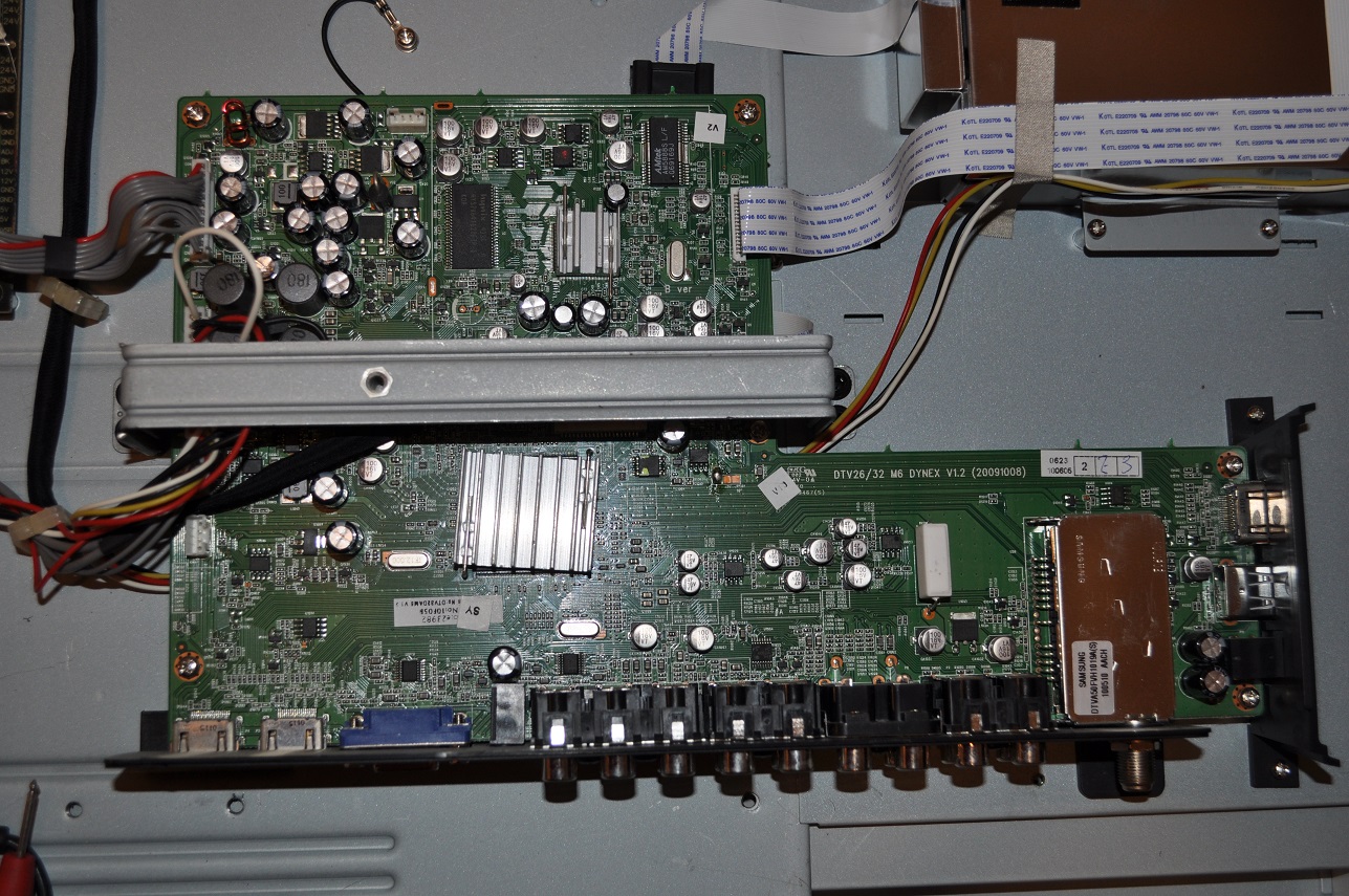

    A couple more pics...

      I am able to force the backlights on using a 1k resistor from a 5v source to the BK pin.

        I tested the Regs on the main board and here is what I got:
        U0000 0 3.302 5.208
        U1002 0 1.036 3.297
        U0001 0 3.324 5.195
        U0013 7.76 0 5.002
        U0011 0 0 .0093
