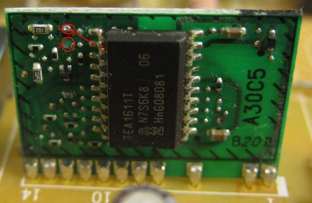

      ive got a panasonic viera i picked up for cheap & repaird even cheaper, had the 10 light blinking blah blah , its the 15v rail fault i belive (dont quote me) theres a little chip on the board for the 15v rail i cant remember off hand but you remove a 1uf smd cap and then the tv should fire up again http://i1179.photobucket.com/albums/...IMG_3251-2.jpg thats a picture of what you may be looking for if you own a plasma, get some freeze spray ( i used butane) crazy i know but i blew away the flamable gas anyway that worked for me to remove the tiney capacitor and tv worked fine there is 2 of them on the power supply board, posting pics of your boards would help alot more.
        Re: Panasonic TC-P50G25 10 blinking light failure.
        Completely different TV.... I've done a few of those and they are easily fixed but unfortunately it's not so easy on these sets.
