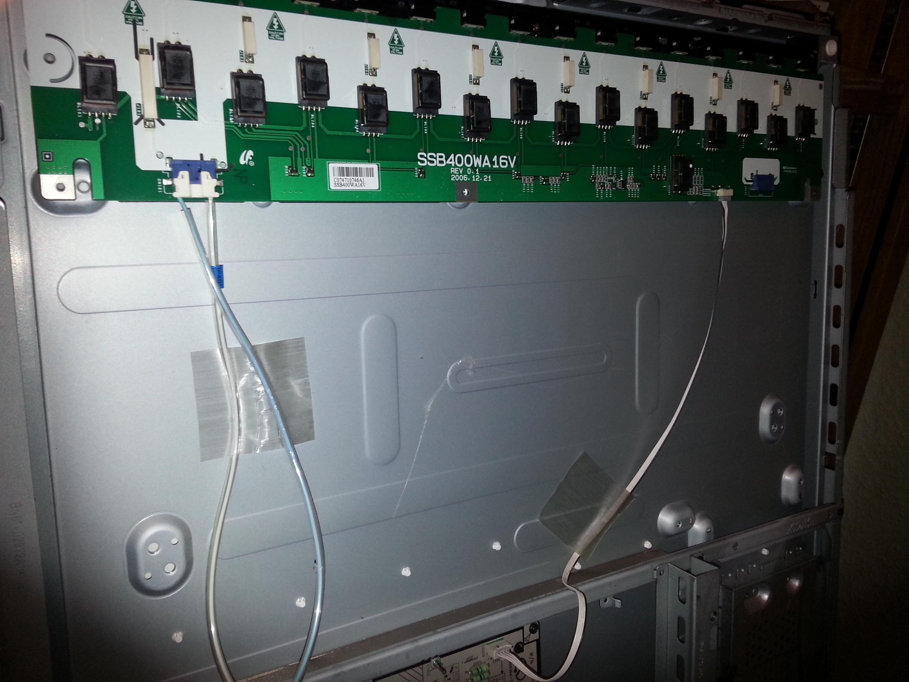

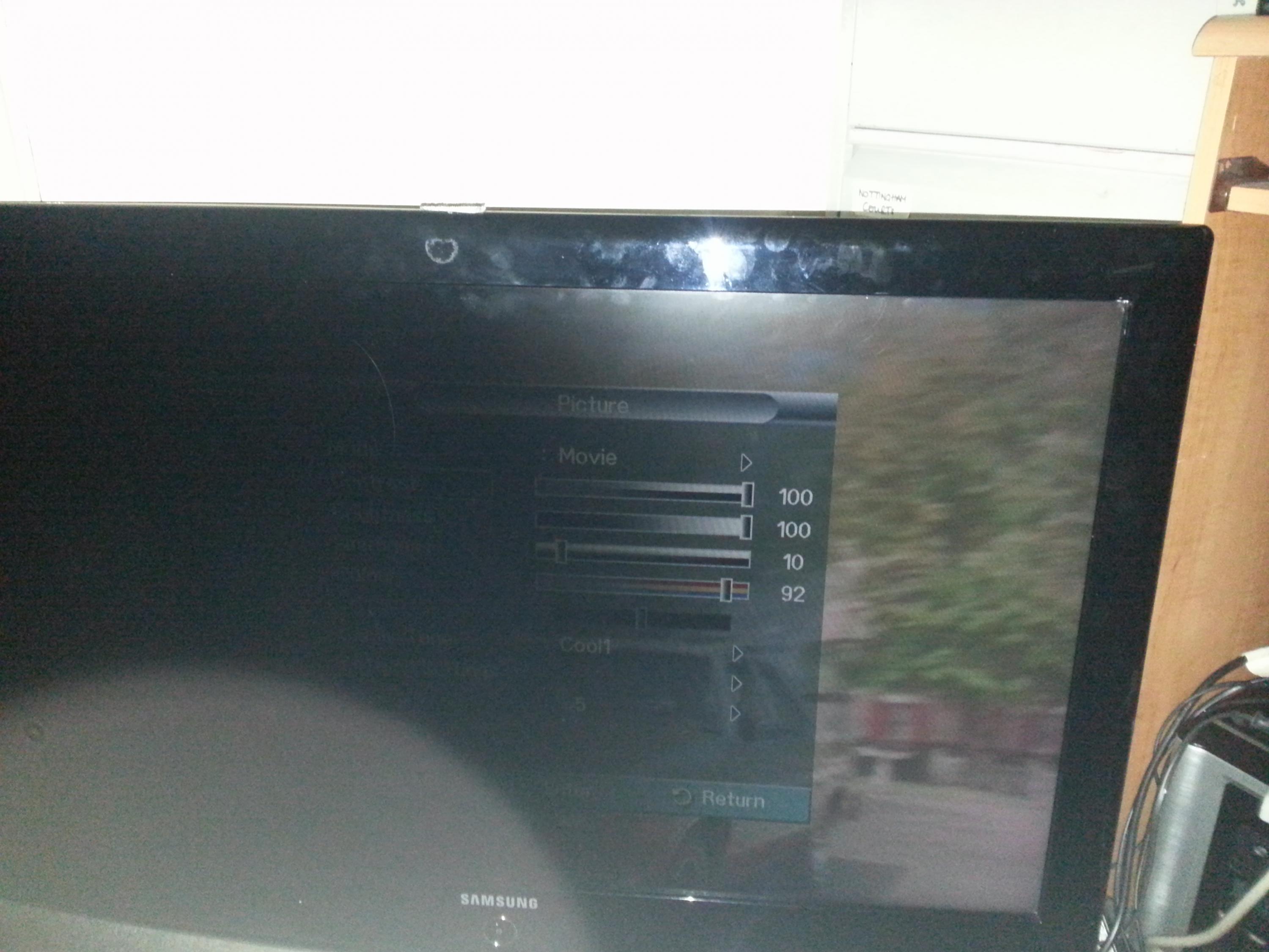

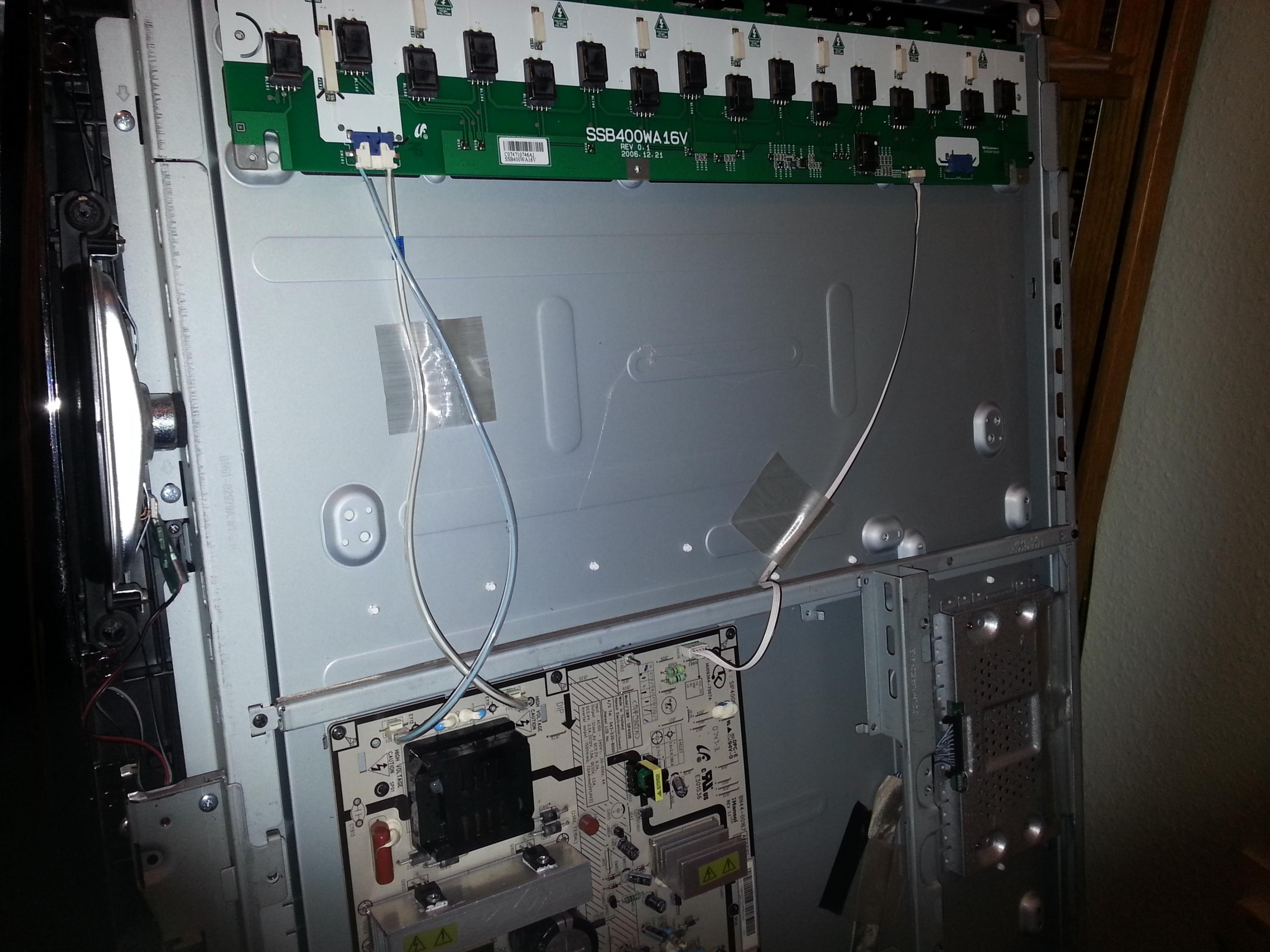

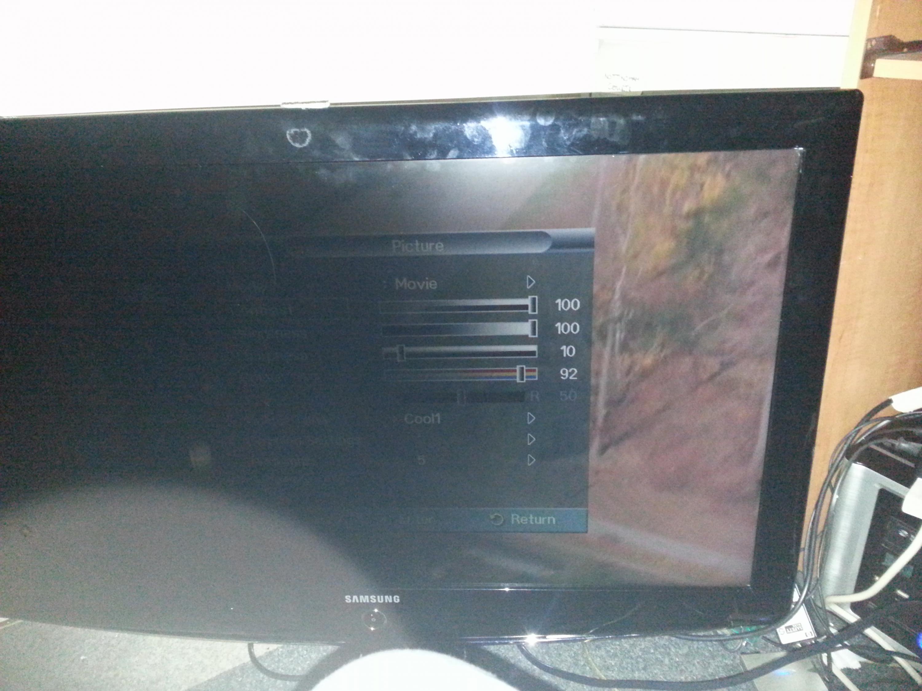

    But now I am presented with another fault on the same set. After I replaced the main board and got the picture up it turns out that the whole screen does not light up only the right hand side lights up, The side that the inverter fits!!.
    It looks like the tubes are only lighting half way , That is assuming they run horizontal not vertical. they stay on not fading out as the 2 second dark fault.
    So now I am seeking more help could this be faulty tubes or faulty inverter board or maybe the transformer on the power board t1801.
    Has any one had this kind of fault on one of these sets or is this a common fault, have tried searching for this fault but all I can see is either they don't come on at all or the 2 second to dark screen nothing on only lighting half the screen.
    Any help much appreciated on how to pin point which parts are faulty, I will include some pictures of inverter and power board and of screen view.

    Re: Samsung LE40R87BD
    Hmm--That is odd....
    Normally the tubes--if they light at all--light their whole length--may get an odd one doing odd things sometimes--but not all of 'em at the same time....
    Check/confirm PSU rails etc, make sure the caps are good/replaced,--dunno, not had that issue myself....
          Doesn't look like a tab bond fault but Ron can confirm by setting TV to dark image and checking in a dark room - the backlight should fade if it is a backlight fault, or it will be solid if not.
          My guess - the main HV transformer on SMPS is not being driven right,for one reason or another, and the output is not sufficient to strike the tubes and make them light fully. Once the tubes strike, their operating voltage requirement reduces considerably.
            With room light off at night and set powered up looking at the back of set you can see bright light through holes in metal casing near inverter board but further along by the main board you can't see any light through the holes, This makes me curious as it is quite clear their is no light coming through toward the end of the tubes so they are clearly not lighting up at the ends. And as you say I could imagine maybe one or possibly two tubes being faulty but not all tubes.
            I did remove inverter board and cleaned all contacts that slot into connection with fibre glass pen, on the off chance they were poor connections . This made no difference what so ever.

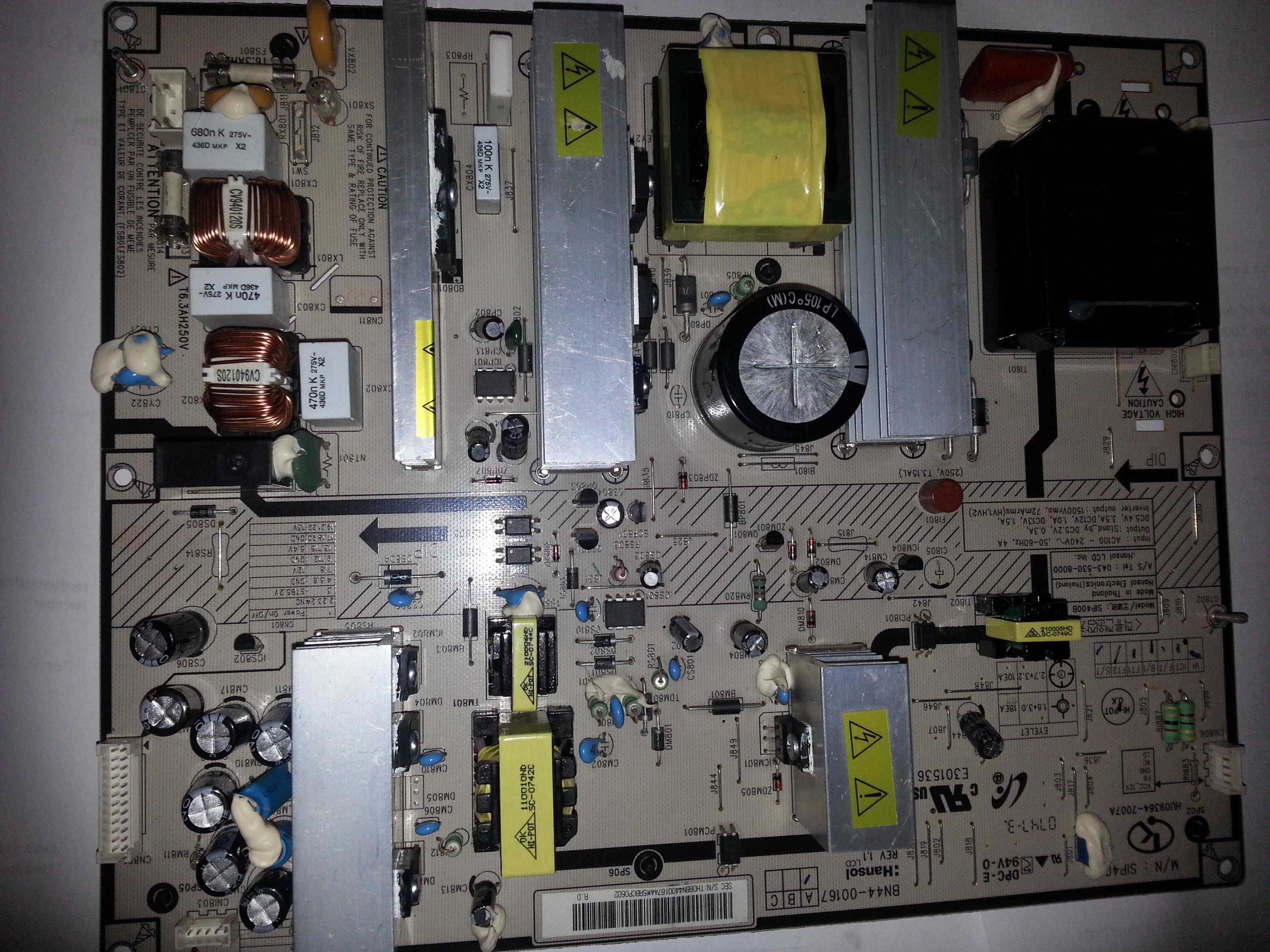

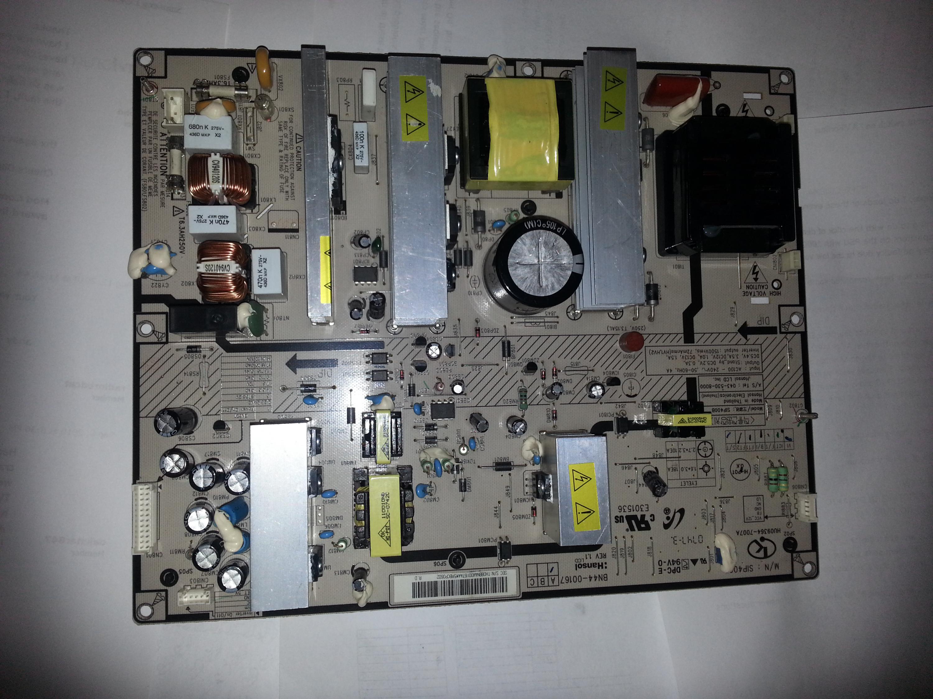

                      Hi Tom
                      I am attaching a couple of pictures of the power board hoping you may point me in the right direction for the hv transformer on the smps not being driven correctly to strike the tubes to light up fully.
                      Any help would be much appreciated.
                        I'd check that red cap near the transformer (check on cap meter, no need to do ESR test.) Also, make sure you're getting the full PFC voltage across the large 450V capacitor - around 390V when all running.
                        Drive waveforms are generated on secondary near TI802.

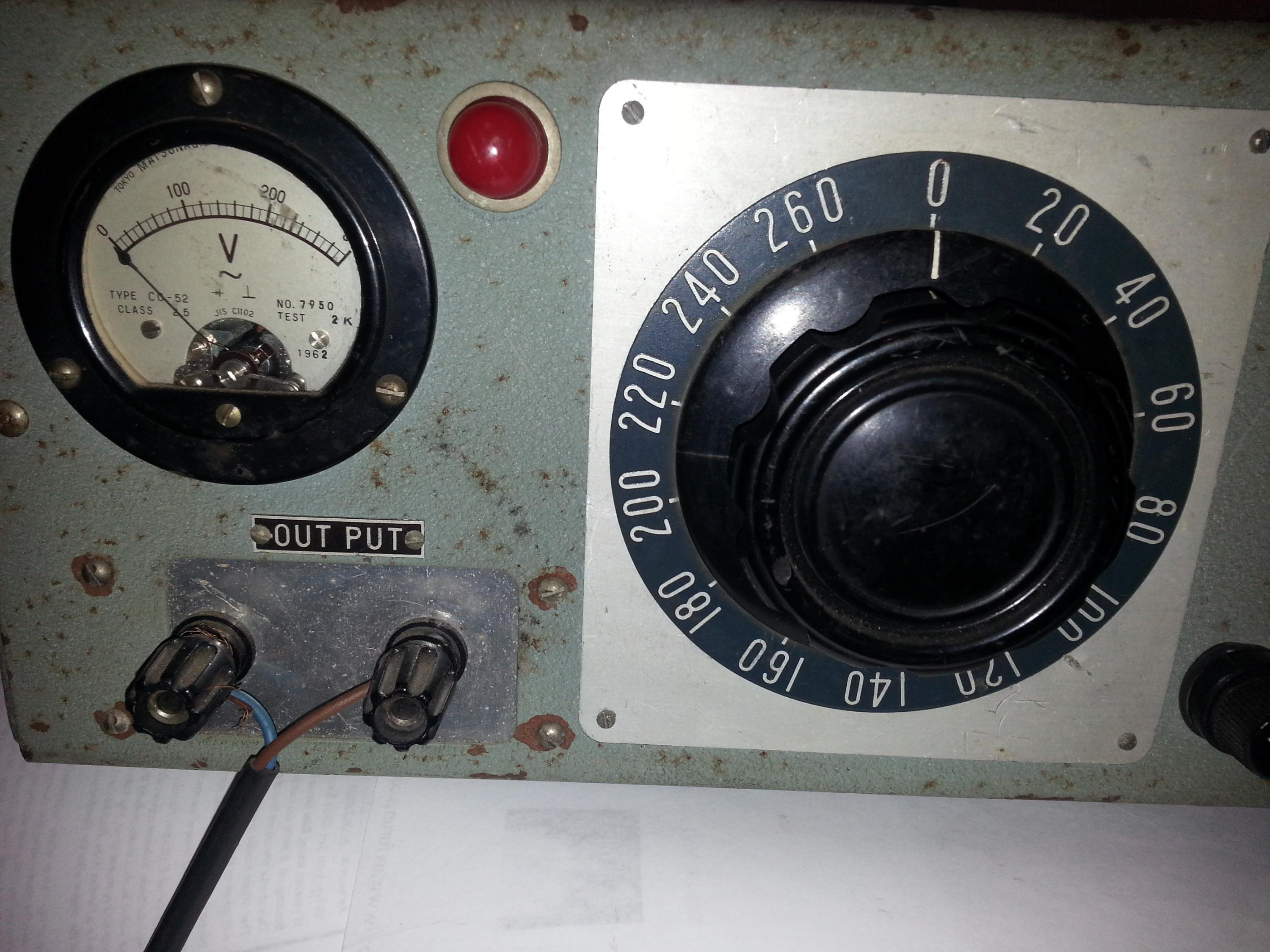

                                    Is their any way I can test tubes with a direct power source say with a variac transformer to see if they fully light up , And also could I check the inverter board using the same method to rule them out ? My variac transformer ranges from 0-260 volts.
                                    See picture.
                                      Unfortunately the tubes require about 5000V to strike (ignite) then about 2500~3000V to operate. Also they operate on about 30kHz~60kHz so a 50Hz variac would not do it unfortunately.
                                      You would need a high voltage probe (100X) for an oscilloscope or multimeter to test the output safely.
                                      You can also try a common trick for old flybacks and that is to take a neon bulb (little indicator thing, like you'd find in an extension plug) and place it near the HV cables and the bulb connectors. It should glow near the HV. I have done this before. Where it does not glow requires investigation.
