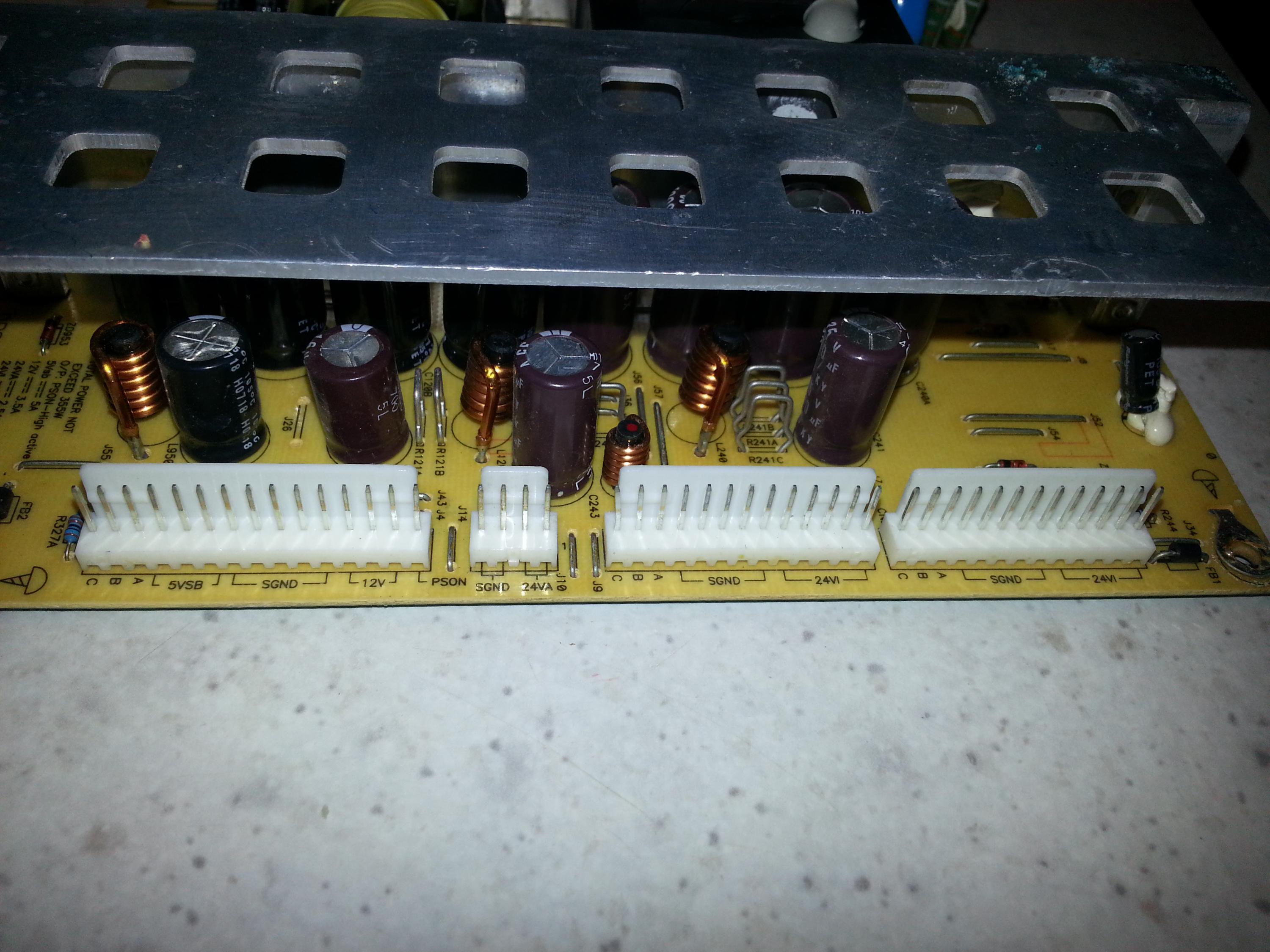

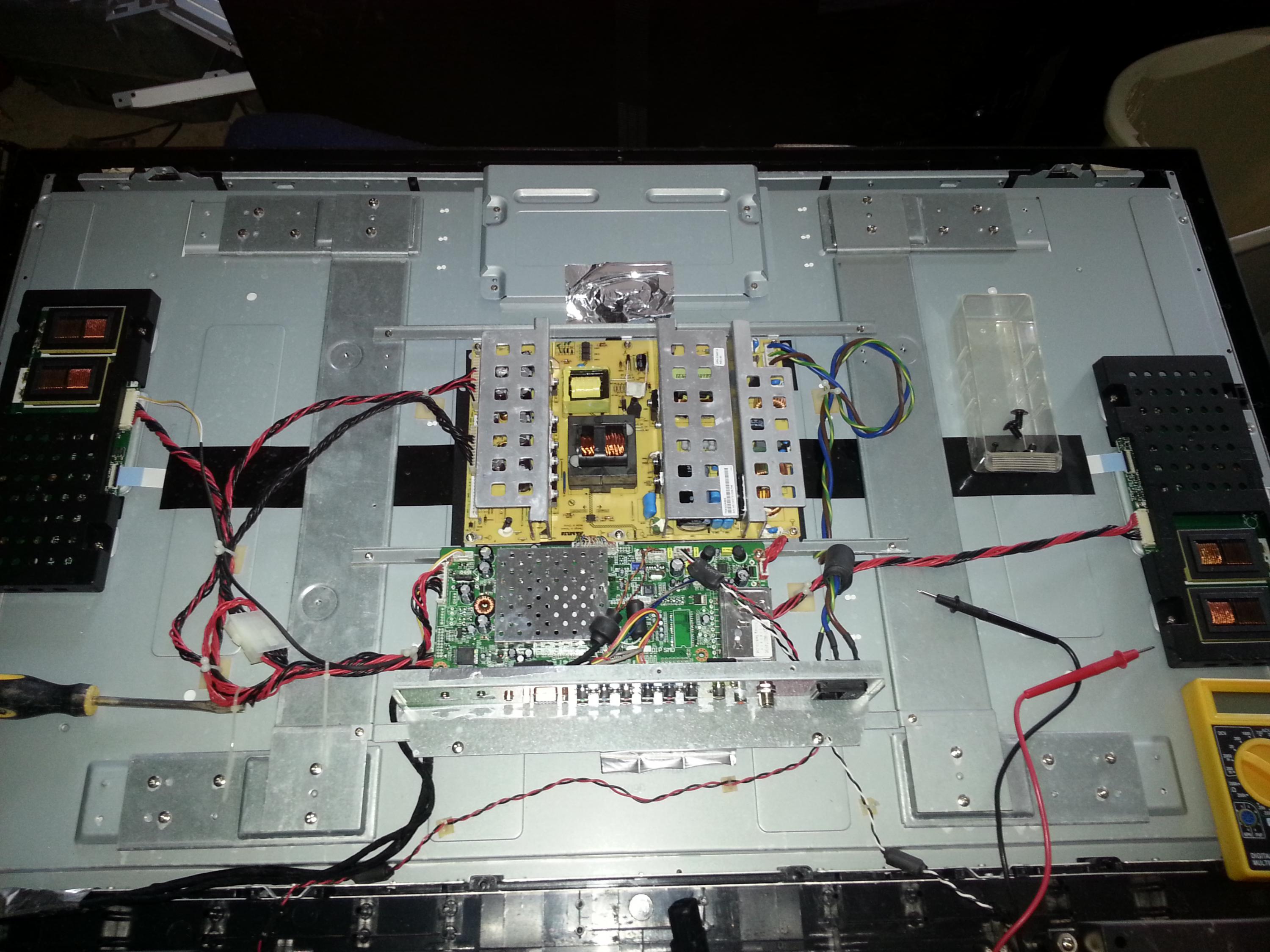

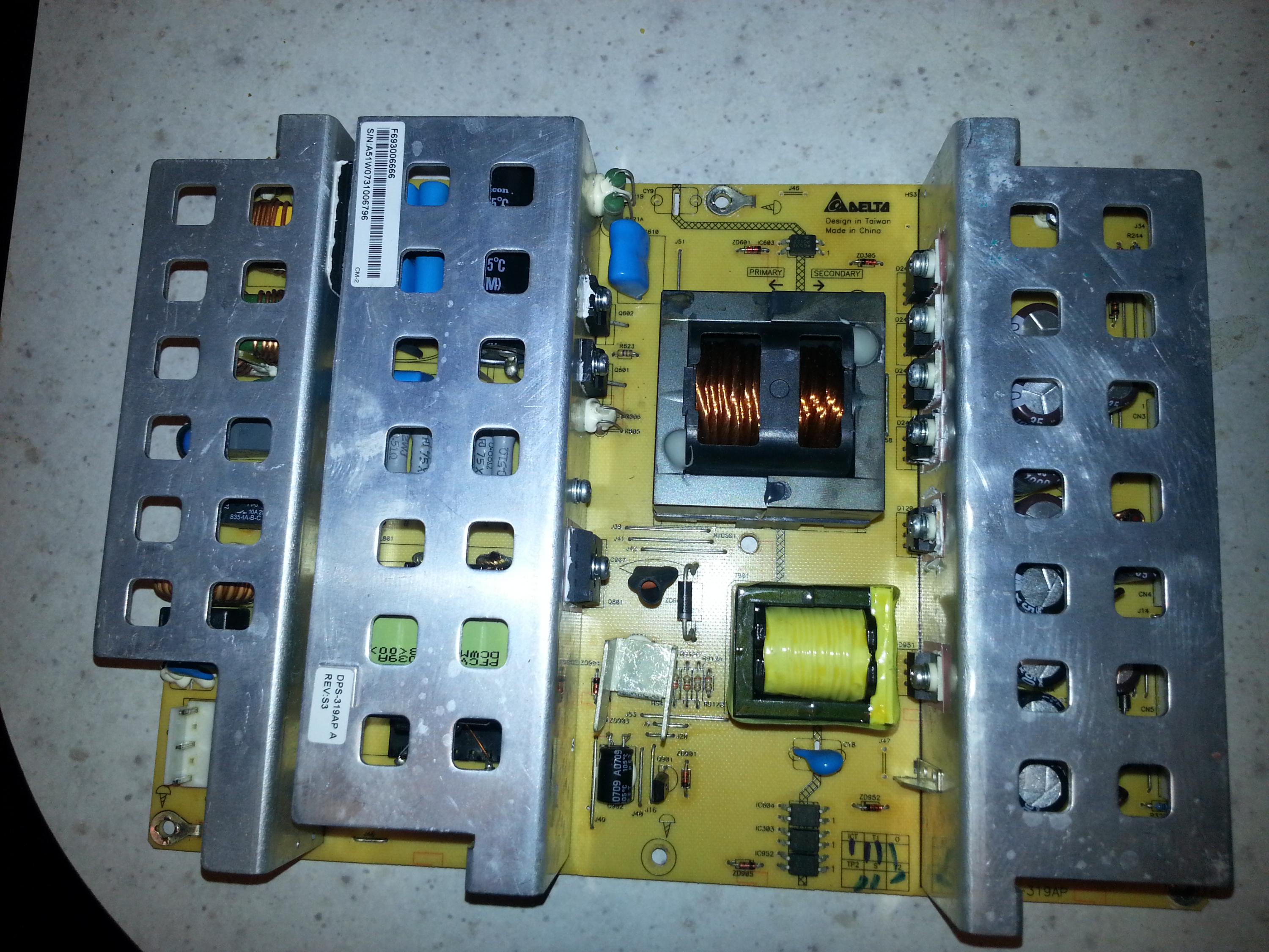

      My power board does not look like that one in the video, here is a couple pics. is is possible to check the voltage of caps to see if there is a bad one? I went along and was getting readings on some and then one did not read anything and the ones after did not as well. could the one that read 0 be bad?
        Re: Polaroid 42" help
        Pictures of the whole back side of the TV so we can see all the board. Check the DC voltage at the PSON pin when TV if off and when power switch is activated, use the chassis as the ground ref point for the meter. Please also read the basic LCD troubleshooting guide. This is the same power supply used in VIZIO TVs.
          Reading at pson is .17-.18 when off and 5.08 when on

            That indicates the main is sending the signal to switch on the power supply. what other voltages are present on the power board? It looks like your board is supposed to have 12v and 24v in addition to the 5v you already tested. What are the voltages on those pins when the pson is at 5v
              So you do have PS_ON, next we need to find out if the PFC Voltage booster circuit is working or not, you will have to get to the two pins of the main filter cap (the 450VDC Black cap under the heat sink), the voltage on the two legs should be about 370~400VDC when TV is powered up. The 12V/24V SMPS require this PFC voltage to run.
                The pins at 12v is 11.83 and 24 dont read anything. It reads a 1. On the left of the meter
                  Try moving your meter to the next highest range, probably 200V. (24V is out of range for 20VDC range.)
                      There are three 24V output connectors: 24VA, and two 24VI. You must use the Ground pin of each connector for testing the output voltages just to be sure cause some time the Ground for 24V is not tied to the common ground of the power supply outputs.
                      Since you are getting the 12V, the 24v must be working since they are generated by the same power transformer.
                        so I moved it to the 200 on the DCV and I get 24.8 and I have to use the 1000 and I get 535 on the big black cap.
                          "I get 535 on the big black cap" That cannot be right, are you measuring right at the two legs of the cap?
                          So you are getting 24VDC at all 3 connectors, if that is the case, the power supply is OK.
                          Need to look at voltages and signals at the inverter boards next if the 24V feeding the inverter boards are OK.
                              Remove the black covers so you can closely inspect the board for any blown fuses or components. Take good closed up pictures of the boards and around the connectors so we can see if it has any labels for the pins of the connectors.
                              If you can see the P/N on the boards, report that also.
