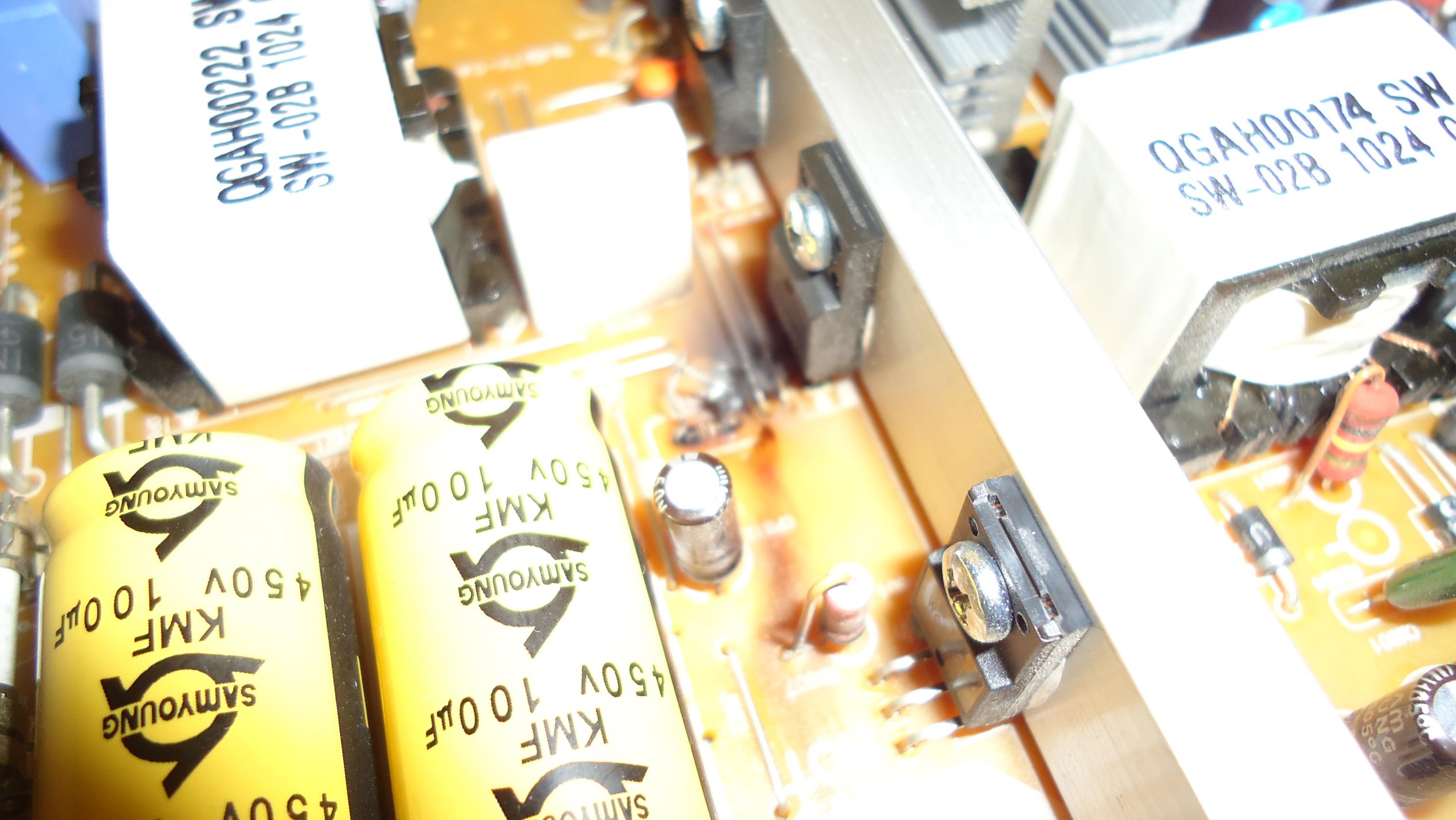

    I have a Sansung power board with what used to be a ceramic capacitor.
    I could use some help with the values.
    The print says 22kv 221
    Any help would be appreciated.

      Here is a pic of the wire that used to be a cap.

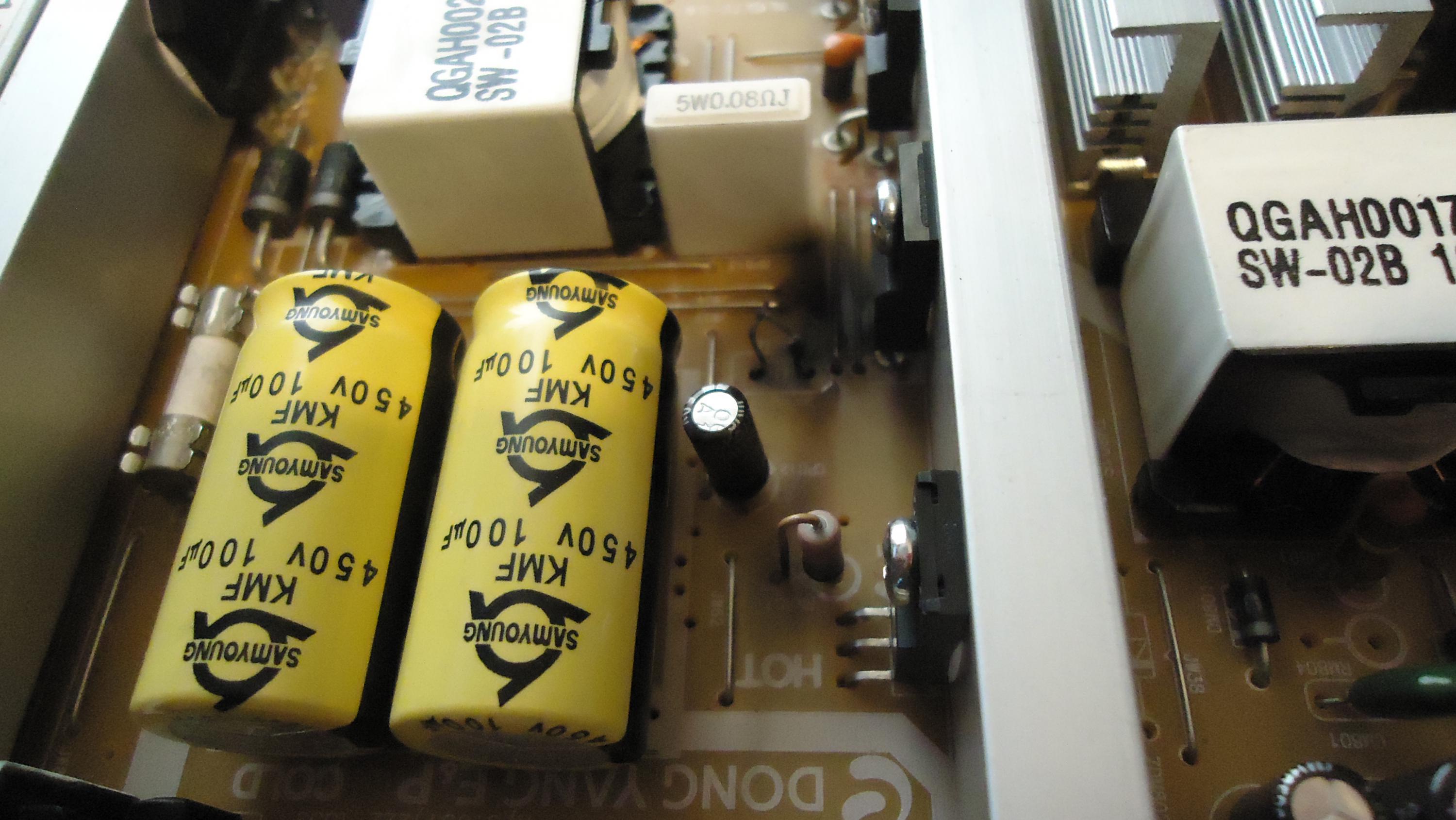

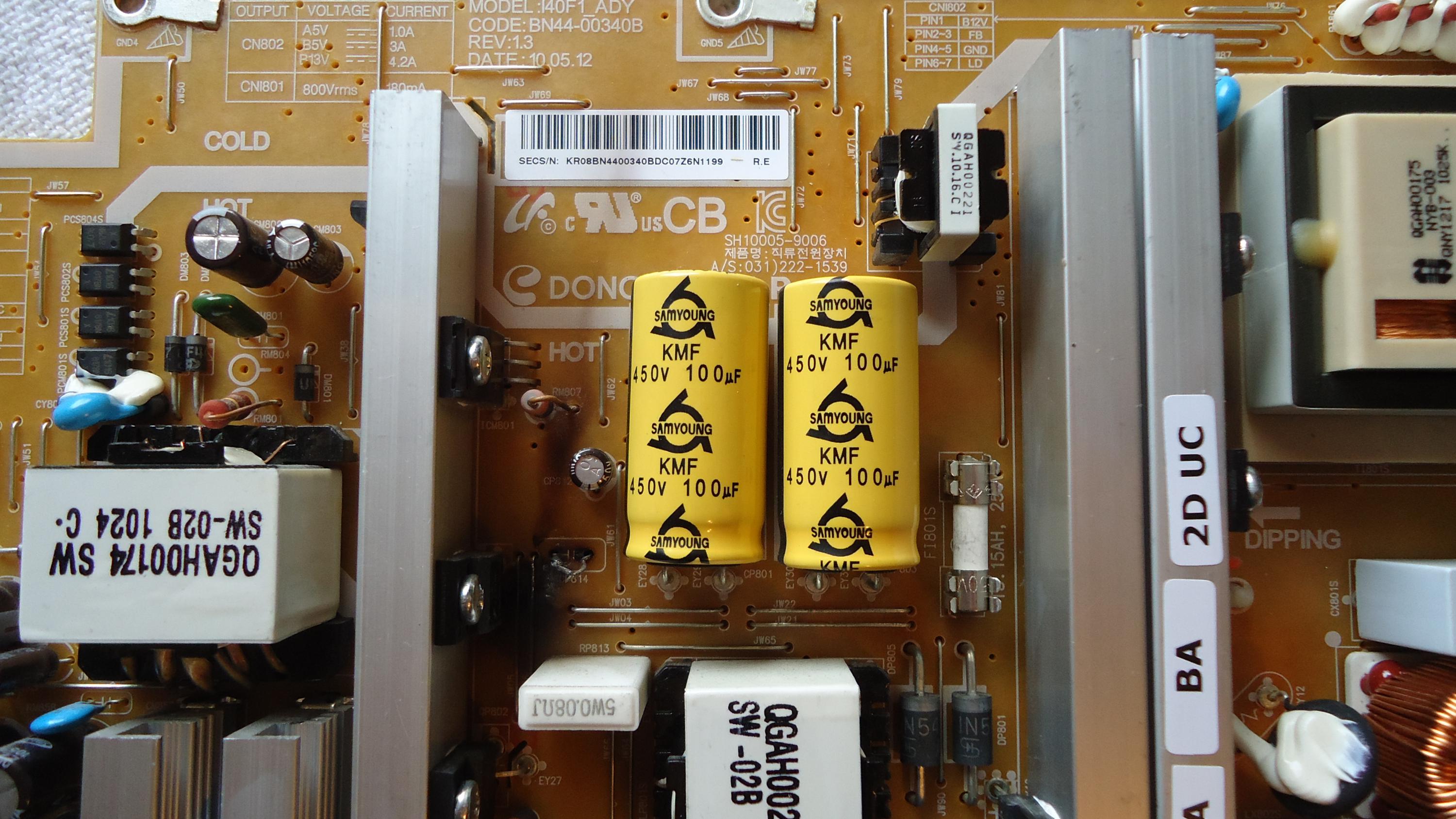

        2 more pics
          Re: Need help to ID a ceramic capacitor
          220pF 2KV
          http://www.mouser.com/ProductDetail/...HWvWY21jNb1wmn
          You can go with higher voltage if it will fit the foot print.
          http://www.mouser.com/ProductDetail/...EyXctvG3VVE%3d

            i would say thats a 220pf/.00022uf ceramic cap,not sure what the 22kv is for,it sounds a massive voltage for that resistor 22 k volts??,unless this board is in crt flyback or something,lol

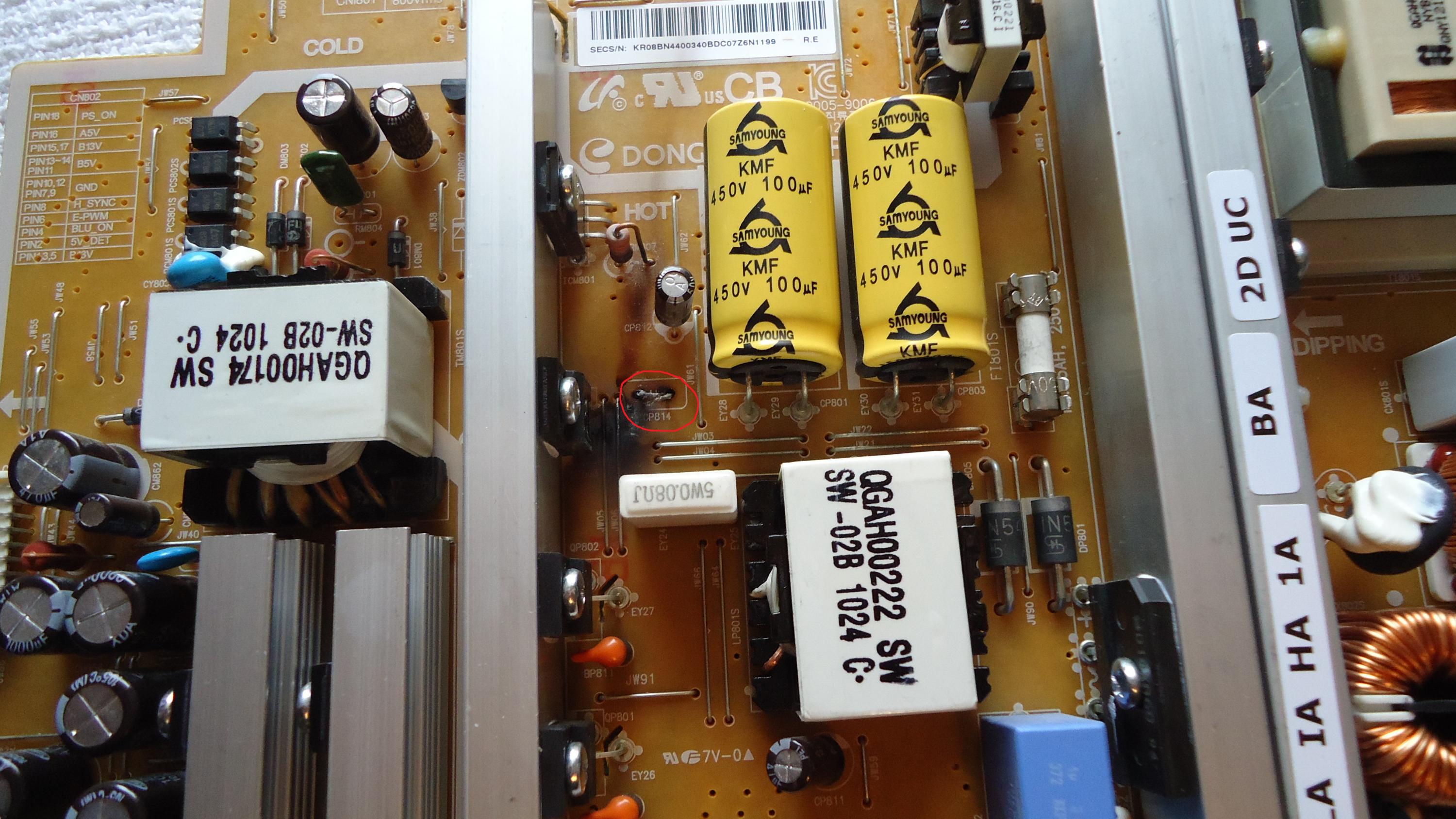

              The schematic is shown as 2KV.
                doh,i didnt think to look at the board part #
                  Thank you all for the help . Some of these caps confuse me but I'm learning.
