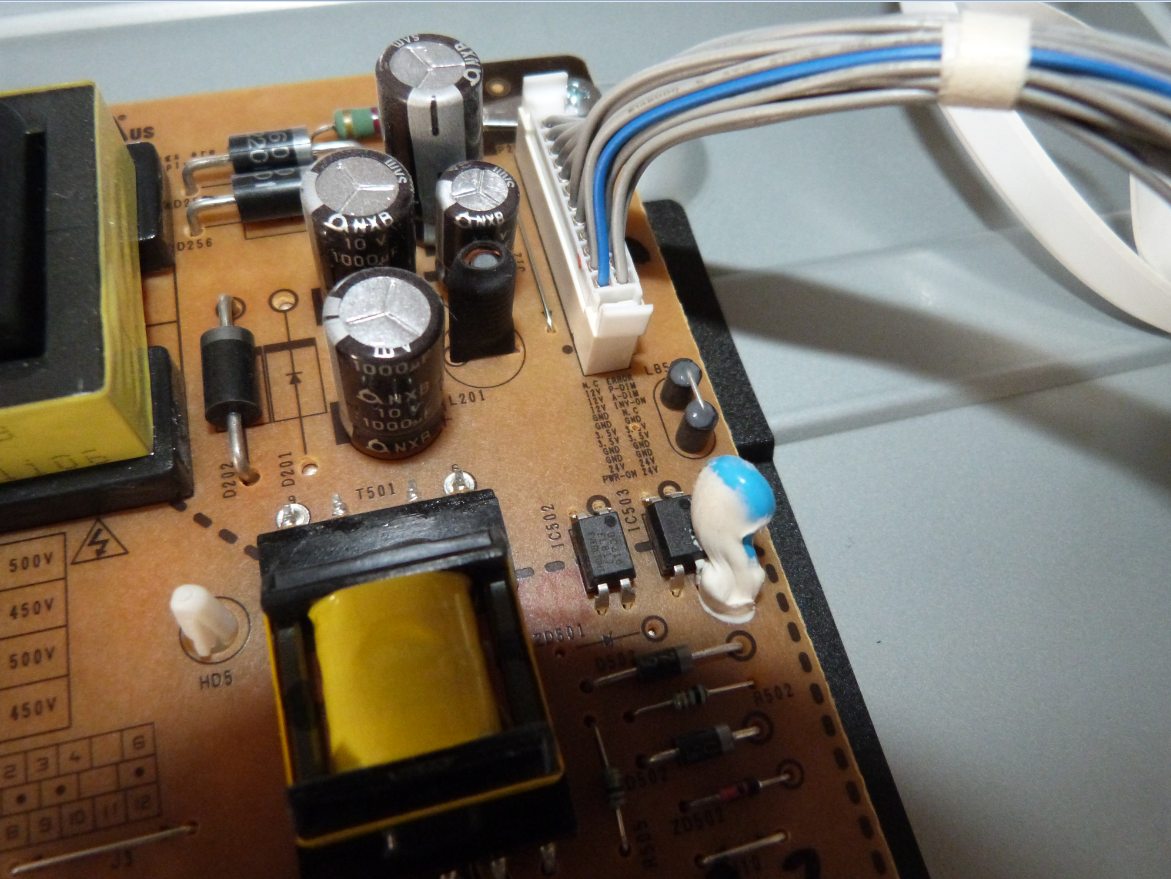

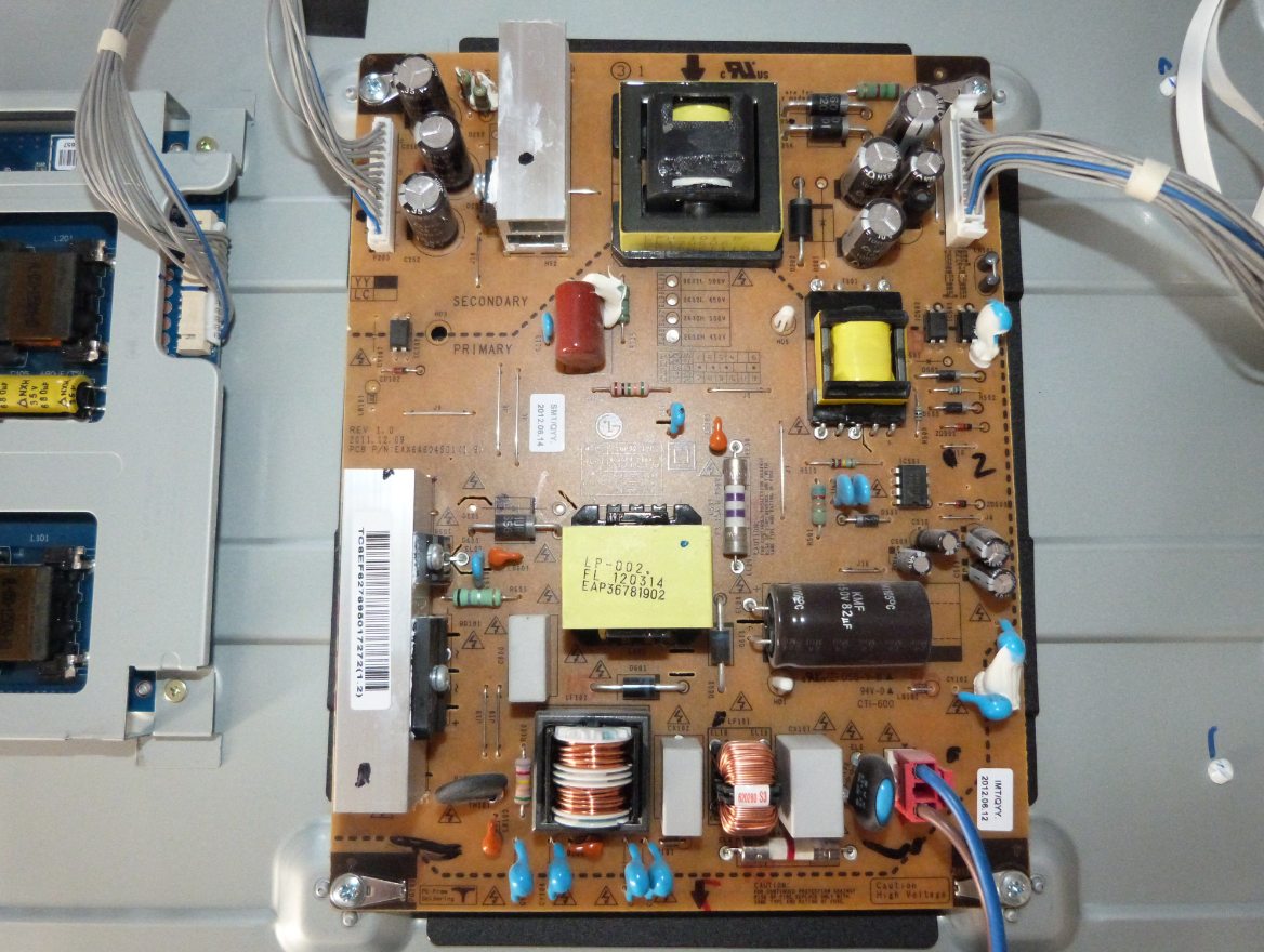

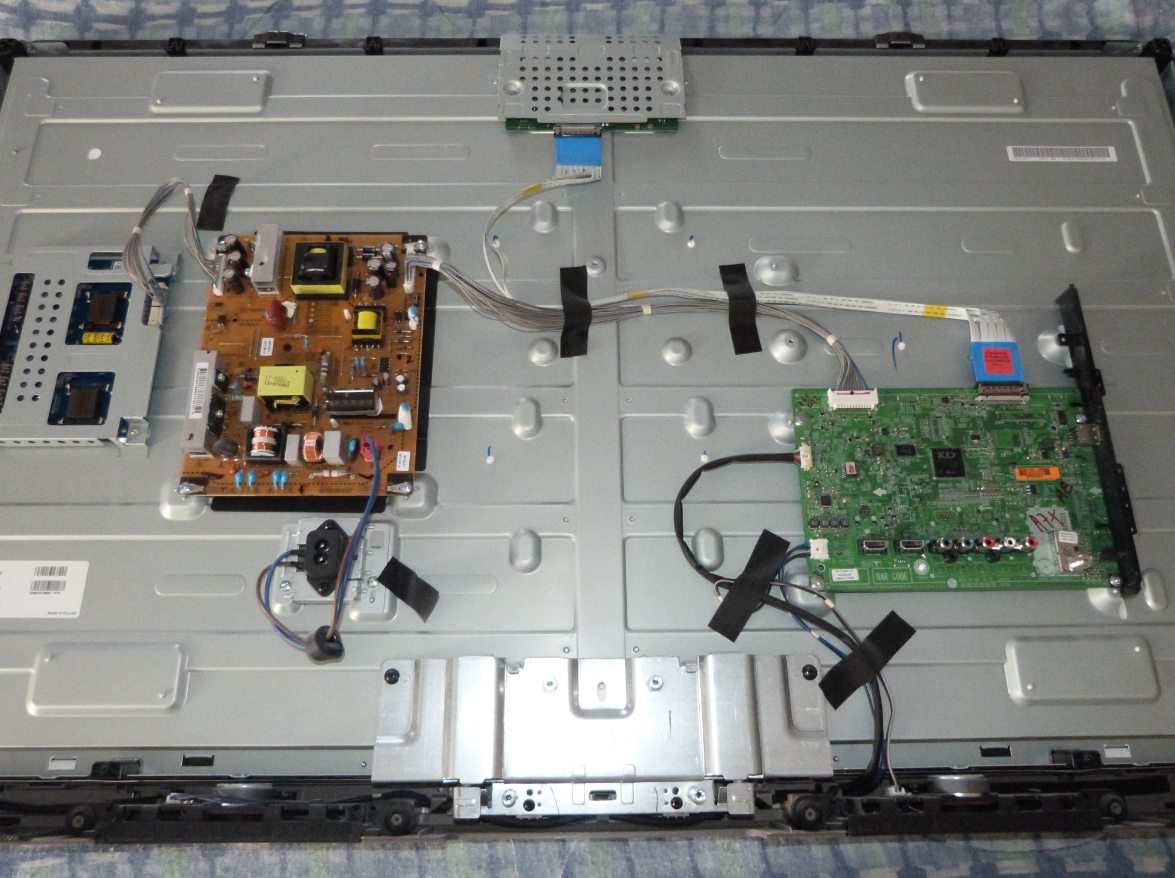

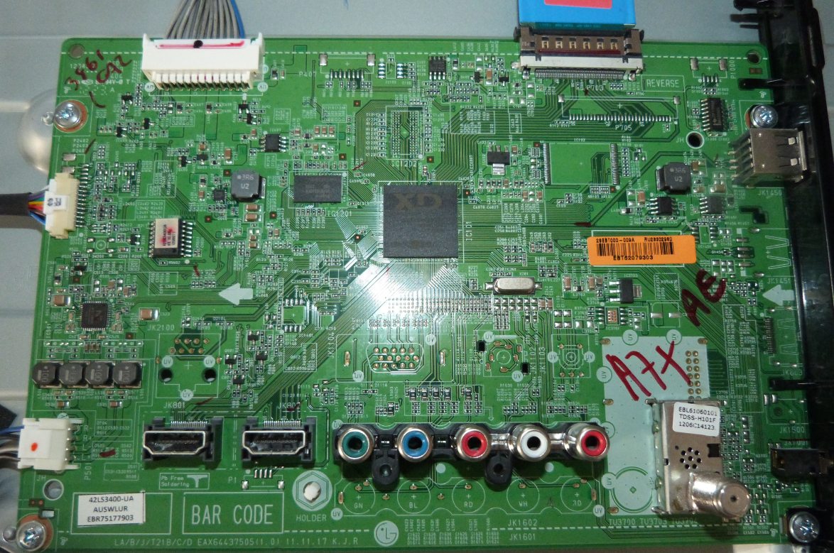

    Hoping you guys could help me diagnose this LCD TV. Standby light is solid red when unit is plugged it. On power-on, the standby light flashes 3 times and then stays off. No visible damage, caps look ok, and fuses check out ok (shorted).
    Attached is the service manual and some pics of the boards.

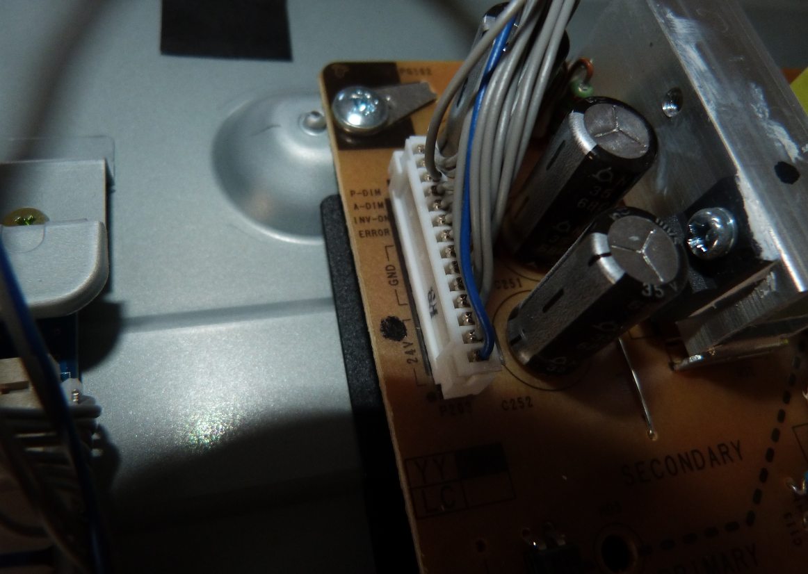

    Here are the voltages I'm getting off of the pins when the unit is "on". The low voltages seem to be in spec, but nothing on 12 or 24v.
    P201:
    Left row, top to bottom (see pic for V reference)
    87.3 mV
    87.3 mV
    87.3 mV
    0 V
    3.576 V
    3.576 V
    G
    G
    2.2 mV
    3.444 V
    Right row, top to bottom
    V bouncing
    1.152 V
    V bouncing
    3.248 V
    3.575 V
    3.575 V
    G
    G
    2.2 mV
    2.2 mV

    Checked the 2 mosfets on the bottom of the power board as well. Here are the readings, in kOhms:
    Q101:
    GD = OL
    GS = .051
    DS = OL
    Q102:
    GD = OL
    GS = OL
    DS = OL
    Can barely read the tops of these mosfets, but this is the best identification I can make out:
    10MN6
    ON
    6K16b214
    Hope this leads us closer

        If you look at the bottom side of the board you can see the pins' labels, you can report the voltages of those pins of CN201 so we will know which pin has what voltages.
