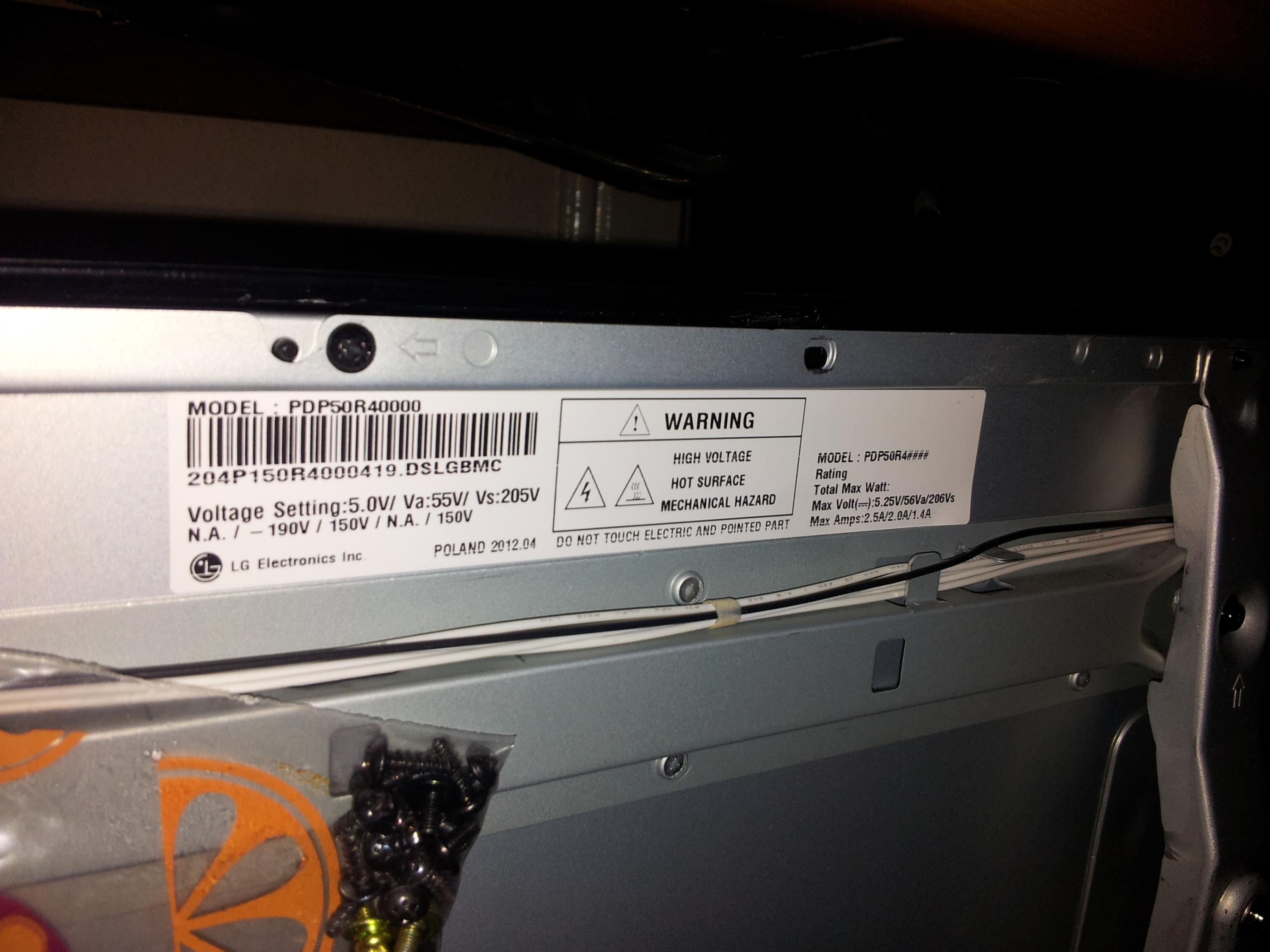

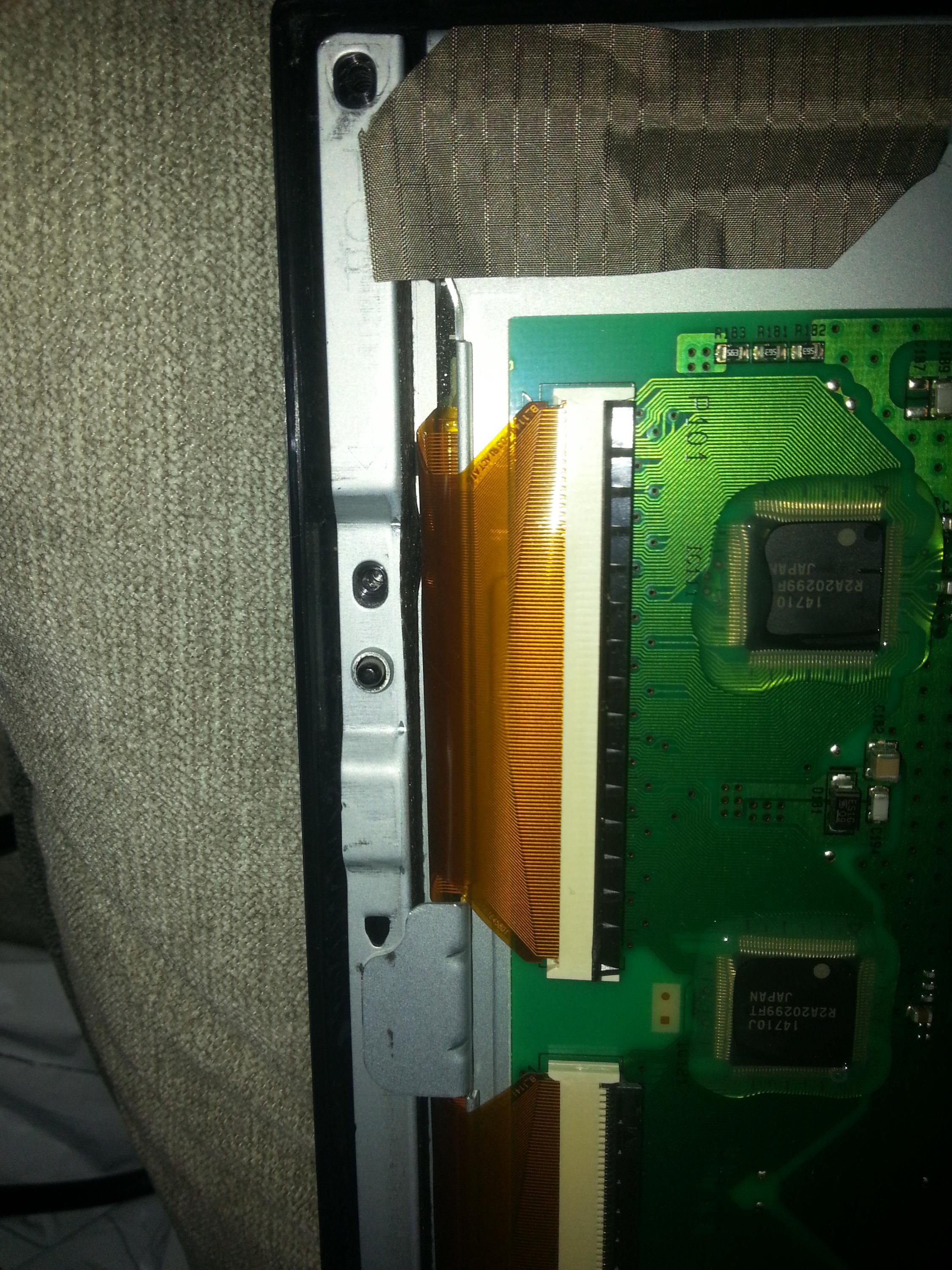

    Hmm, I picked up this LG 50PA650T full HD 1080p 50" plasma. £50 bargain, so from never touching a single modern design LG plasma in a week, I've got two!

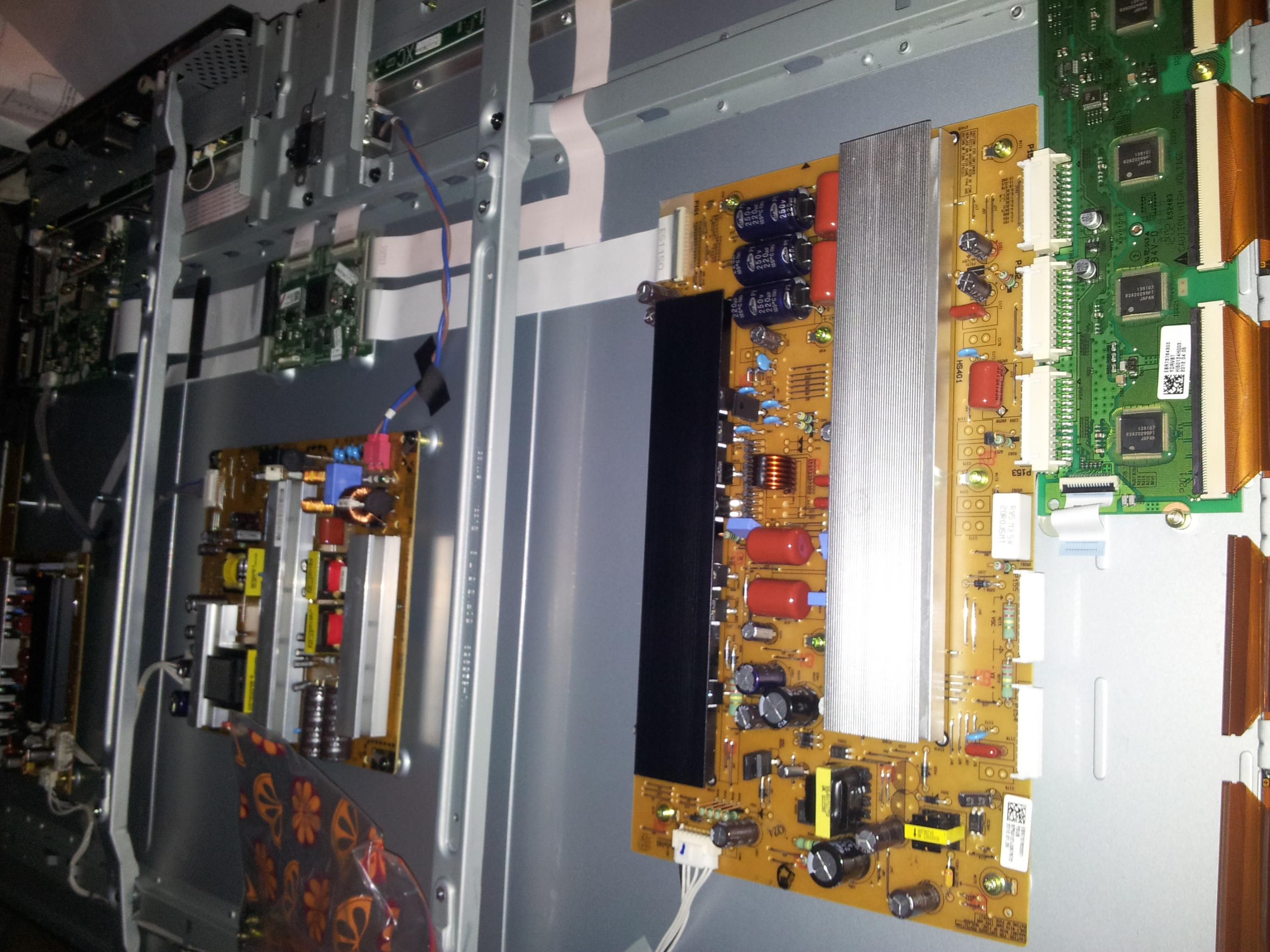

    Turning on, got Vs/Va, but -Vy and Vsc all over the place, no image on panel. Uses a PDP50R4 panel, which is a fairly significant change from PDP50R3 (the panel Vsc/-Vy is offset by some third, unknown voltage, which is very odd; will have to investigate this later. Had thought practically all R&D had stopped at LG PDP.)

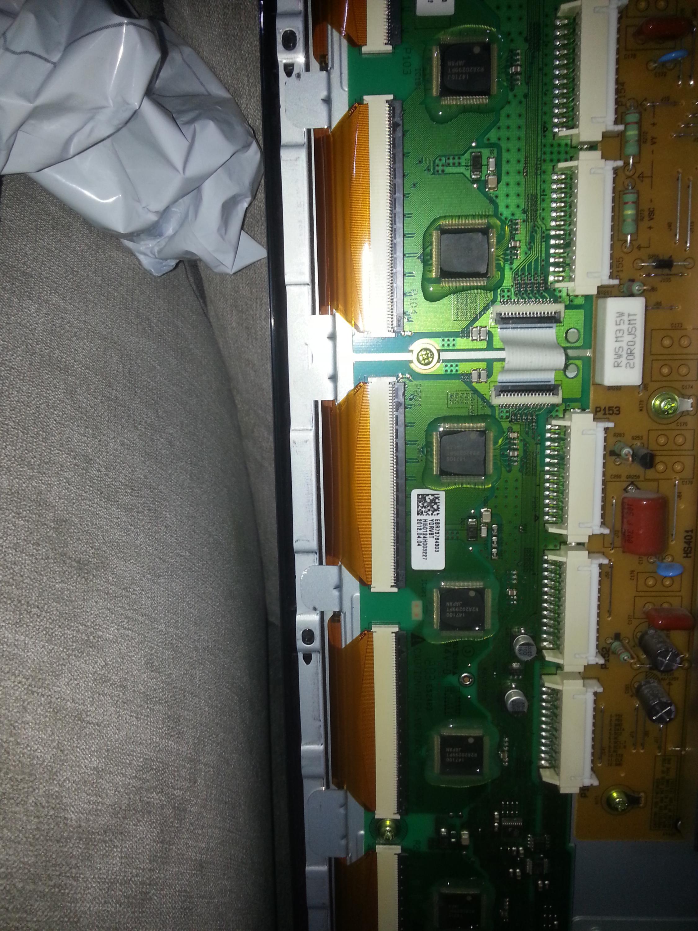

    Remove top buffer, got picture on bottom half... good Vsc/-Vy too. Image is a little fuzzy but this is probably due to poor ERC (half panel connected = half capacitance so panel not properly sustained.)
    Top most buffer chip is shorted. Now I remember this thread from freakaftr8.
    https://www.badcaps.net/forum/showth...light=50pa5500
    He had a bad top buffer and a ribbon rubbing against the panel shorting the new buffer out.

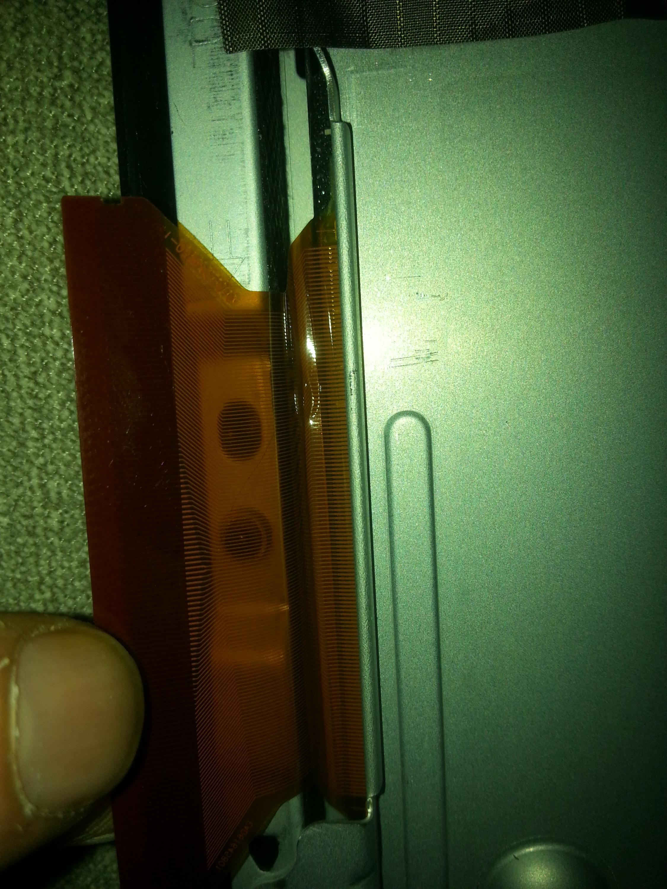

    Here, I'm a little worried, because I can see a dimple in my top ribbon, not present in any other ribbons. However, I cannot find ANY shorts between Z-sus out and this ribbon or between this ribbon on chassis. Not even high ohm. All >66 Megohm on my meter.
    So, what could have happened?
    1. Maybe it's a random buffer board failure, this is a fairly new TV though, so it is a little unexpected. There are no heatsinks on the buffer ICs like in older LG panels.
    2. Maybe the ribbon is rubbing against the frame like in freak's case, but only when the panel warms up or if the TV is flexed slightly (side plastic is a little scratched and two screw mounts are damaged.) There are no cracks in the panel at all and bottom half will sustain image OK. AND, here's the important bit, when I check the buffer chip (top buffer IC) with my meter, the part which is shorted seems to correspond to this area of the panel. However, I don't believe that not addressing each line will blow a buffer as freak states. Case in point, unplug a ribbon, and it'll work for hours with it out. I did it accidentally for 10 minutes with this TV and no harm to the bottom board. So it must be a short that kills it.
    3. Maybe we have a panel failure like in PZ70 Panasonic though I can't see any blown pixels or shorts in ribbons apparently this only shows up after the panel gets warm.
    Potential fix:
    If it's (1) just replace the buffer and enjoy; (2) replace buffer and isolate the ribbon with some insulator - as Freak said it might be shorting? or (3) scrap the TV for parts - hopefully not as this is quite a nice TV!

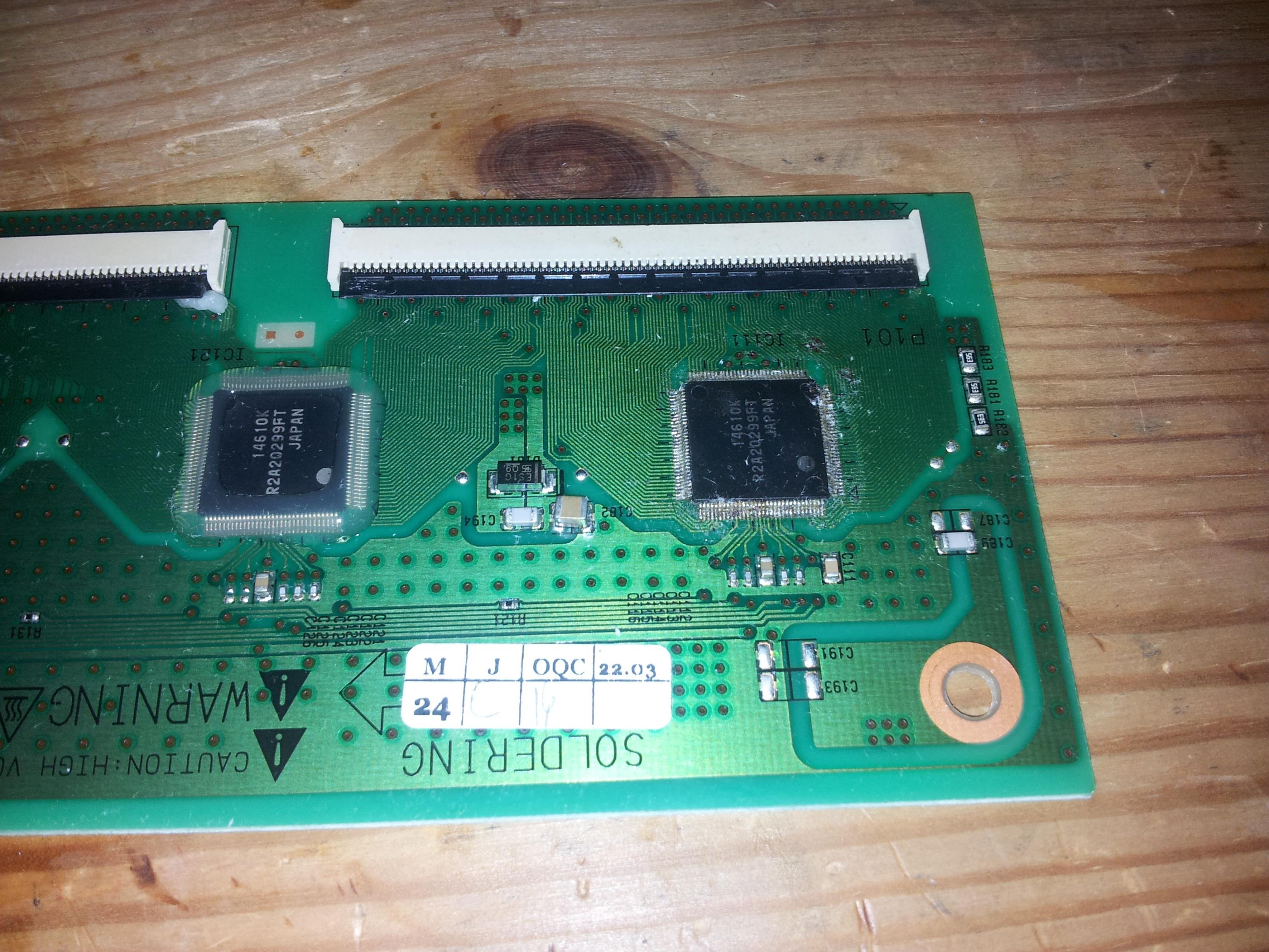

    Re: LG 50PA650T - possibly bad ribbon... (PDP50R4 panel)
    Trying to get this buffer IC is proving difficult; want to preserve board!
    It's soldered to bottom of the board too. Tried hot air, with no luck. Will have to try some more, I guess. The thermal lug/pad is connected to the massive SUS OUT node. Half the board is connected to the same!
        dont suppose you have access to an ir rework station tom66? would make removing the ic easy
          You may have to use a bottom heater to heat the board from the bottom side, and use a hot air nozzle that heats the entire chip at once
          Don't know what that epoxy\glue is but more than likely it's also gone under the chip as well. Hopefully heat softens it or you're going to have even more fun.

            I have not been able to fix this. The damage to the panel appears to be fairly severe. I do not think it can be easily fixed. The ribbon would need to be transplanted from another panel. I believe freakaftr8 is having the same issue with a 50PA5500. I suspect the 50PA4500 (720p panel) may also be affected.
            It appears, essentially, the plastic posts around the edge of the Razor Thin panel break away, eating into the ribbons. There is no protection for the panel ribbons. This wasn't a problem on older TVs with thicker frames. Definitely appears to be a case of form over function. It's a real shame because it's actually quite well made inside, aside from this flaw.
            It's a serious design flaw with these. I posted on AVSForum and my post was pulled. I guess I upset the sponsors of that site there (LG do a lot of advertising on AVSForum.) Seems the newer models are still affected by this critical design flaw. Crazy. Don't buy razor thin LG plasmas. Bad panels are such a common issue with newer TVs. Foolish me thought plasmas were immune, at least somewhat.
              Yes this is absolutely verbatim by exact same issue. What a poor design flaw. The dimple you see in the ribbon actually cracked the connection in the ribbon. If the buffer is replaced you will see a few lines missing. These buffer ICs do not like this. They would either like to see all lines supplied or none at all. If otherwise, they short. Really odd.
              I attempted a ribbon repair to no avail. I ended up removing the cable from the panel, still looking for a donor.
                I got one yesterday. Top IC shorted, same dent. If you look at the space between the frame and ribbons there is a nice even space, apart from the top one that has a small lump sticking out right where the crease in the ribbon happens.
                  Yep that's how it happens. If you remove that top IC from the buffer board the rest of the screen will power up. Attempted repair mine with another ribbon cable and some of that 3m double-sided electronic safe but never went very far with it didn't seem to work.
                  What a crappy design completely destroys a perfectly good panel because of some stupid black plastic tab that doesn't need to be there

                      So the other end is bonded to the screen like LCDs, with nothing to solder to ?

                        I believe it's glued to the panel.

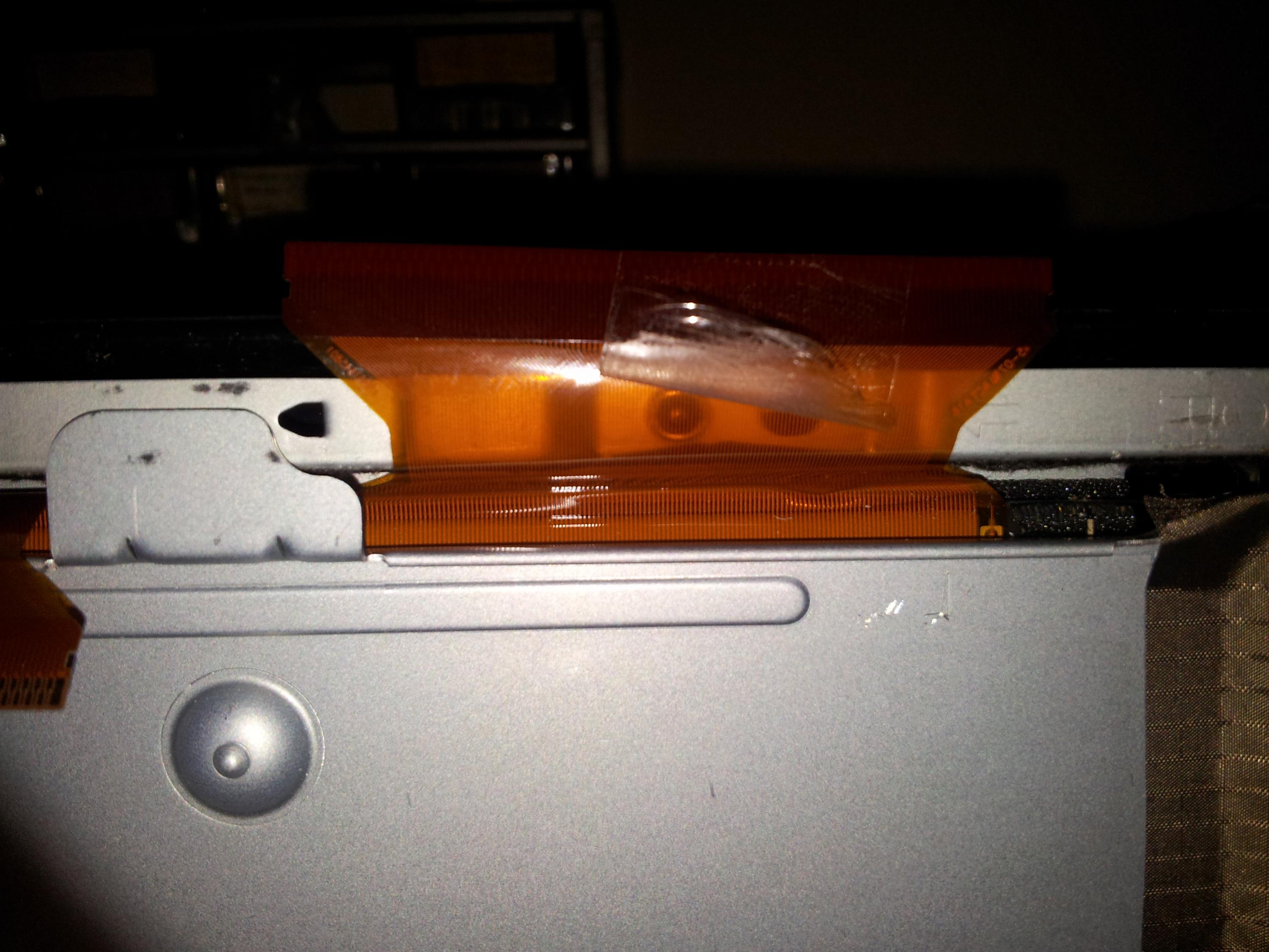

                          Yes bonded to the panel and then glued on top of that. That part I might add is very solid.
                          Unfortunately their choice in a ribbon cable is very flimsy and thin unlike earlier plasma sets where the cables were very thick and hearty.
                          I believe this is partially led to the demise of the ribbon cable being cracked to begin with

                                It is quite possible to reattach them ribbons. I have done so on a PS50C96HD where someone who I wont name was heavy handed and ripped the ribbon off. I was able to scrape back the mask and use very small solder braid to rebuild the connections. Not easy but possible, after I coated it with silicon to prevent shorts still working to this day. Wish I had images of it but never took any at the time it looked bodged but works and every row of the screen was working.
                                  Tbh you might be able to do it it on this set depending on your solder skills ? It takes a long time and trust me alot of profanity will be said. What you think ?

                                      If there is something to solder to then I'm up for giving it a go. Stupidly big thing is taking up half of my sofa.
                                      So remove the screen from the frame, remove the tab and resolder it, or leave the tab attached and just repair the broken connections ?
                                        It took a while to say the least and alot of effort. Wasn't too tricky to solder after removing the mask just tim the points then hold the sold braid on one side, tac it then the opposite side. Was hard though as I had to solder at least 8 copper traces which are tiny. I used a microscope and duck tape to hold everything in place.
