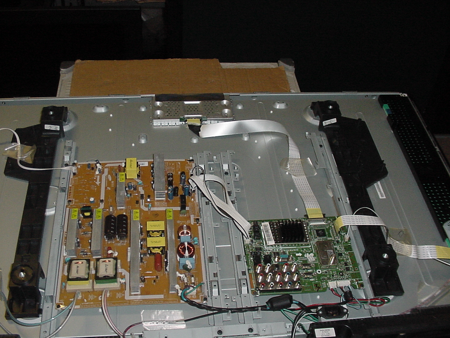

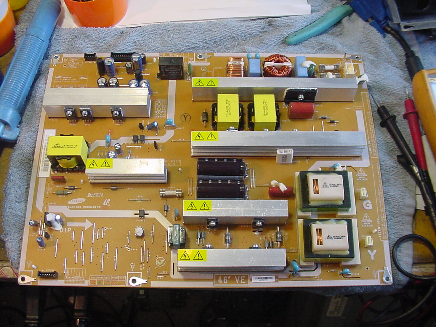

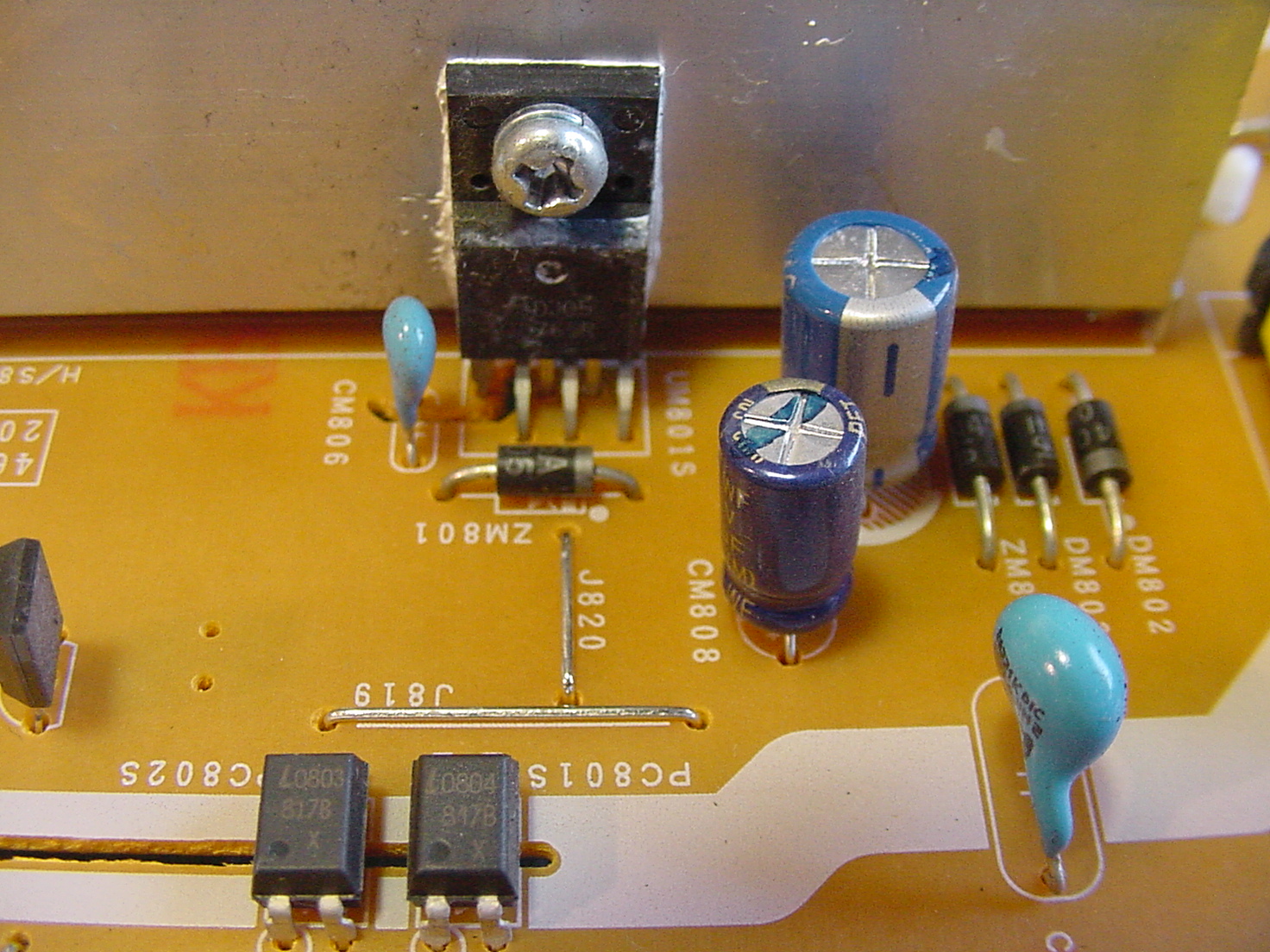

    Got this one in today.

    does the set turn on? What are the video issues? I guess it played a good amount of time 2008 untill now. They just dont make them like they used to make them. Disposable
    Society.
      Re: Samsung LN46A550P3FXZA with bad caps

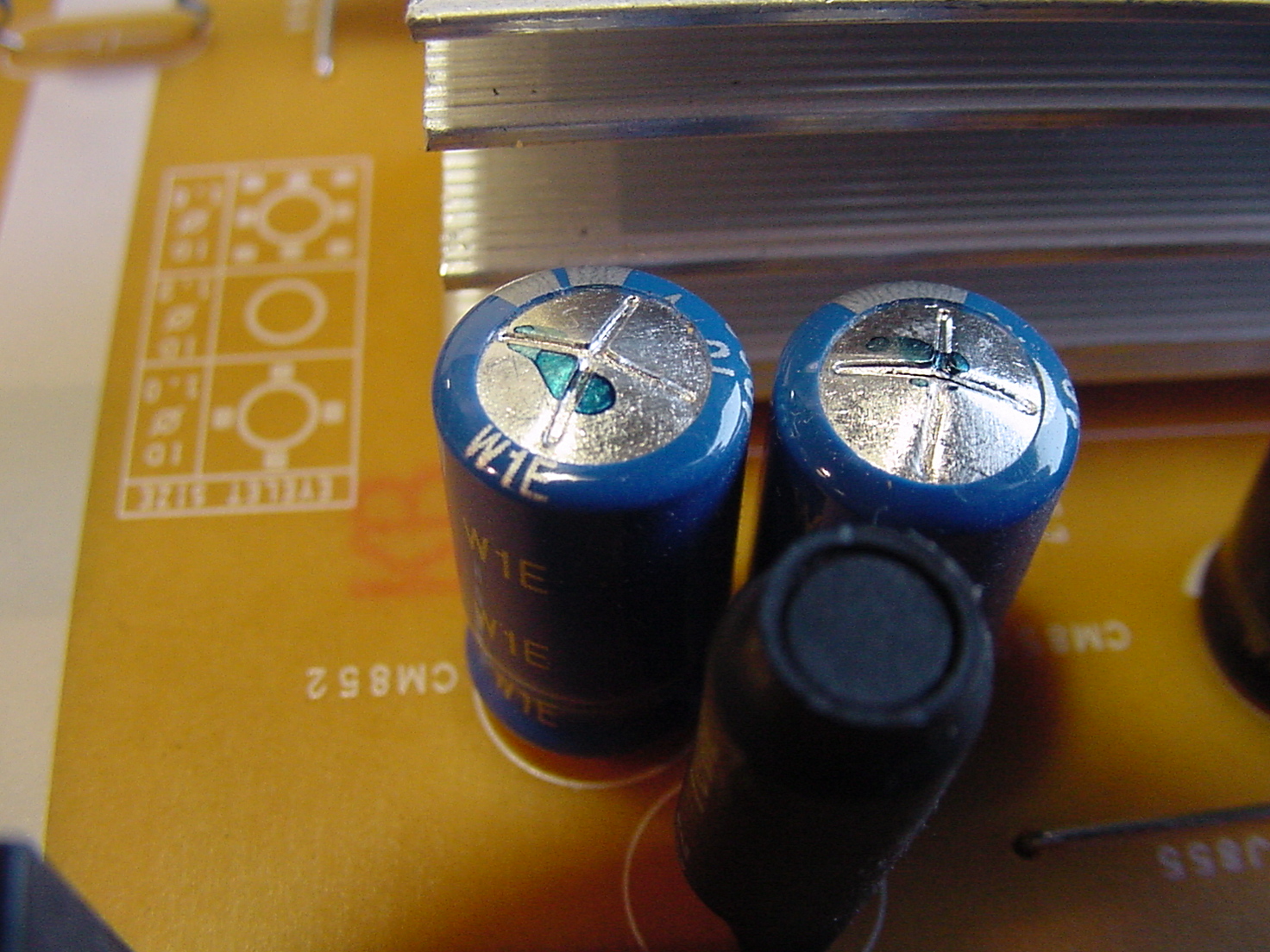

      It was cycling on and off when plugged into the outlet, then it stops completely. It works fine after a new set of caps are installed.

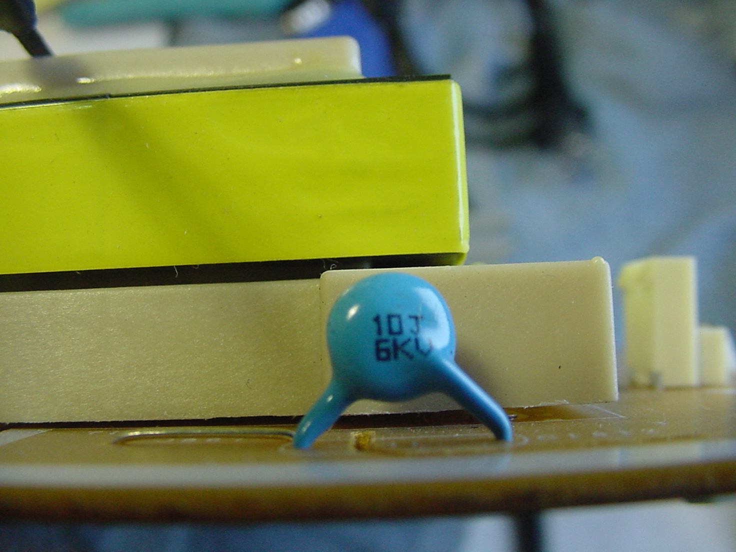

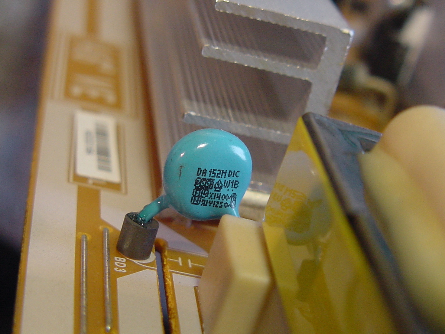

        is that ceramic caps for HV transformer ballast? those bad too or just 2 bulged caps?
        just ridiculous question, how do you know the ceramic caps were bad? that is look good from my view.

          Didn't know they still were around to have bad cap issues. Nice fix.
            Just two caps with bulging tops (picture #16), I replace them as a set. The two small ballast caps are fine.
              got it. thank you. replace them as a set to prevent callback and bad reputation.
