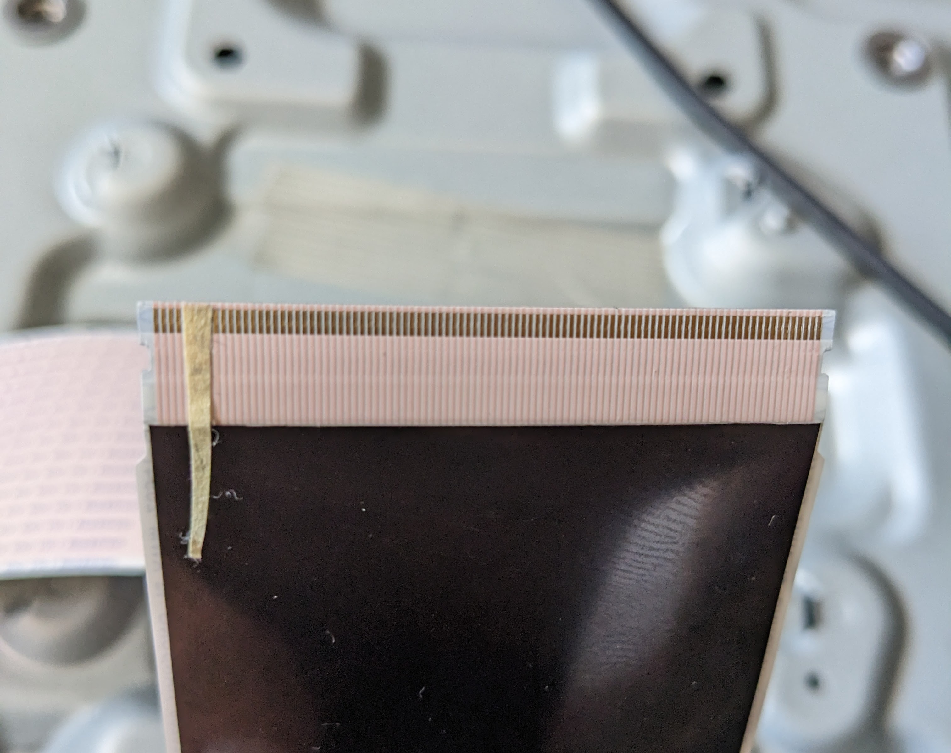

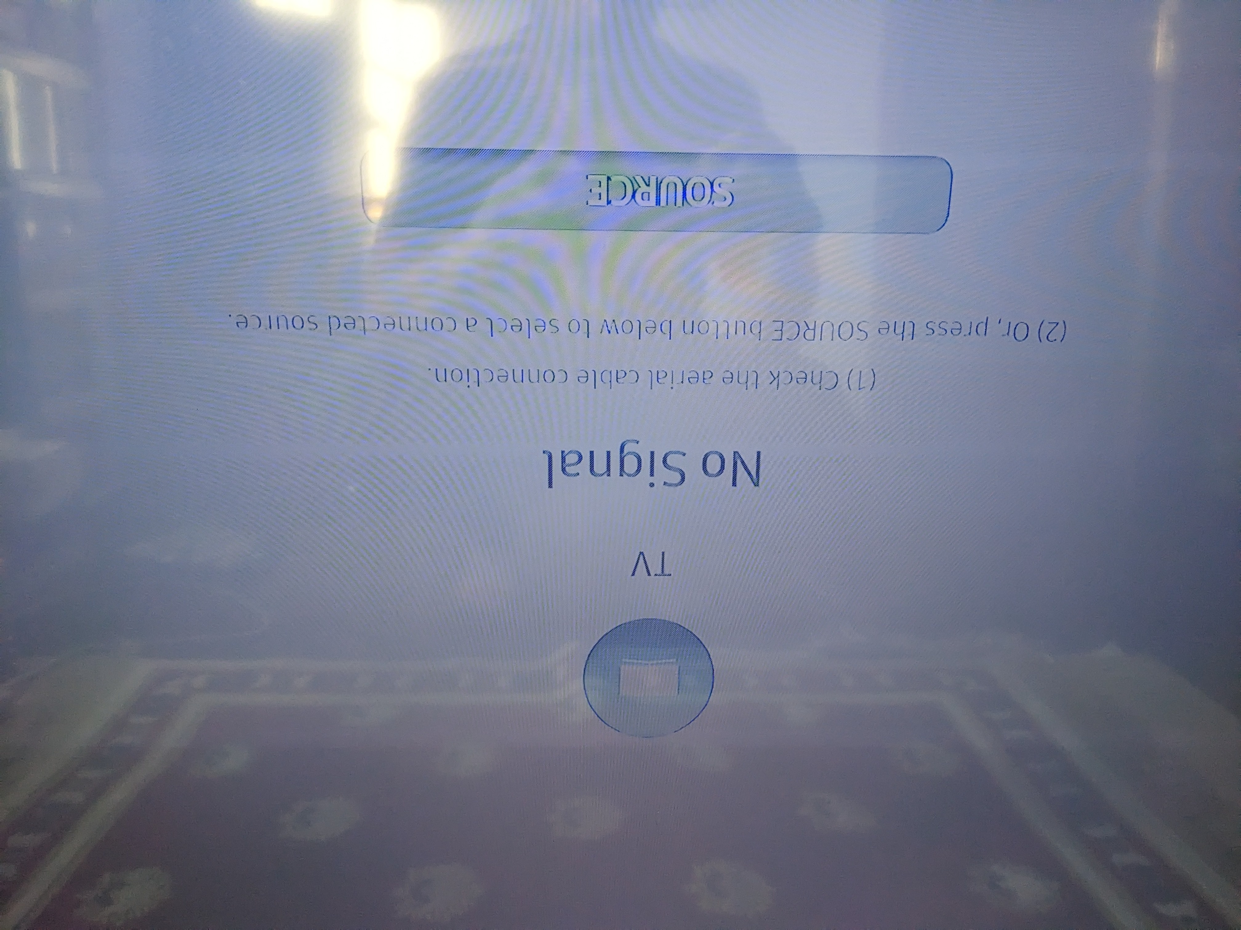

    I've ended up with a Samsung QE50Q60T with the classic bootloop problem. I've read plenty tape solutions on these forums but never seen one that made me progress to an image. Perhaps the model number makes a difference.
    I've tried the usual disconnect LVDS and disconnect left/right methods and TV boots with no image on both. What amazed me though, if I tape the pin that sends 7V VCOM voltage then the TV starts up normal but due to missing VCOM voltage the image is whitewashed.
    I've disconnected left/right VCOM from each other with another sticky tape in between and applied 7V external power to either side and it just made the TV go to bootloop mode again. I was expecting at least one half the work normal if the fault was with the VCOM rail. I was wrong.
    I'm certainly baffled, what is so special about the VCOM rail that makes the TV get upset? It is not consuming much power either so clearly not a short but I cannot figure out what else does that rail drive to initiate a feedback to main board. I wish I could just disable the feedback and just power VCOM.
    Any ideas?

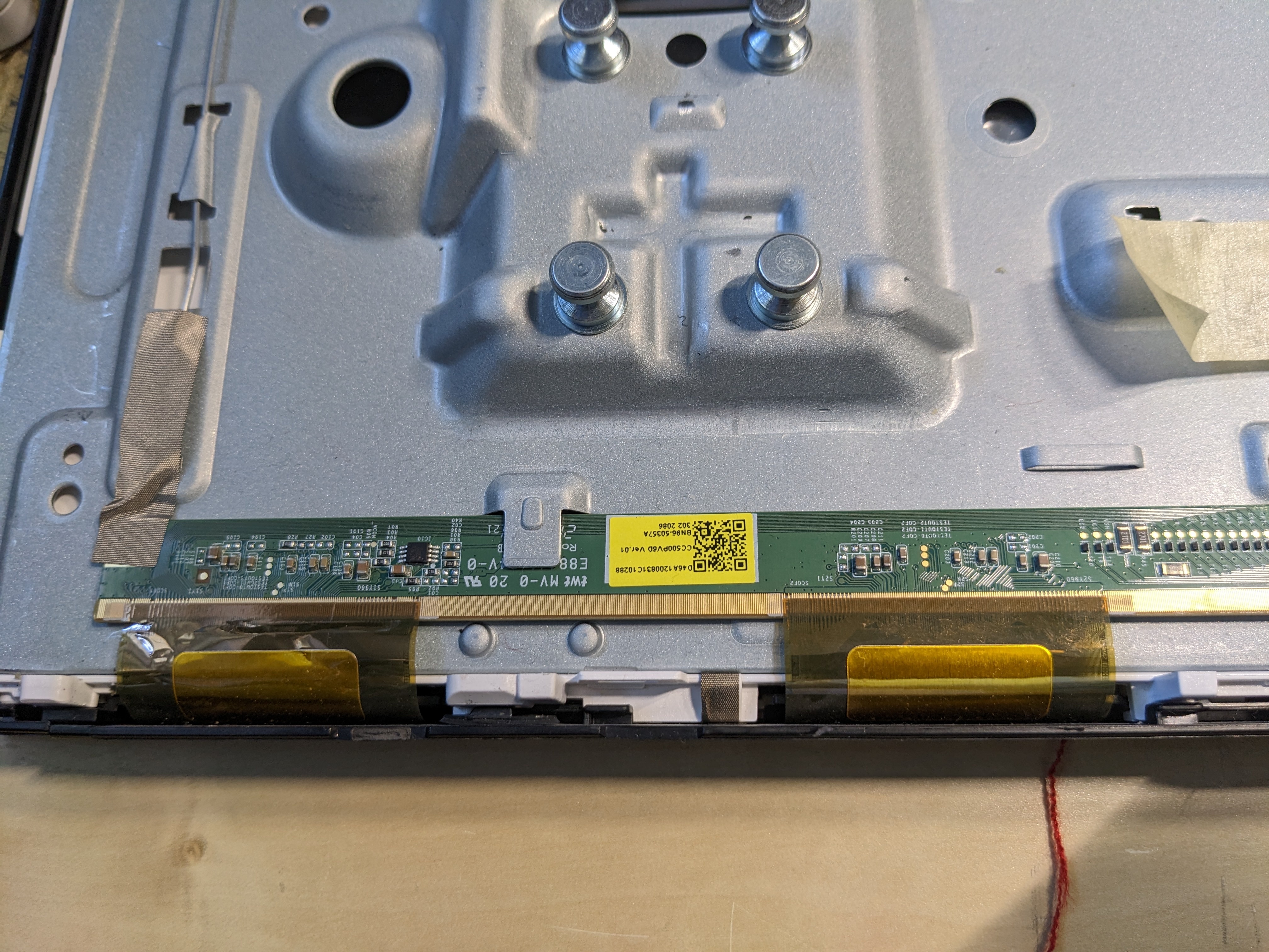

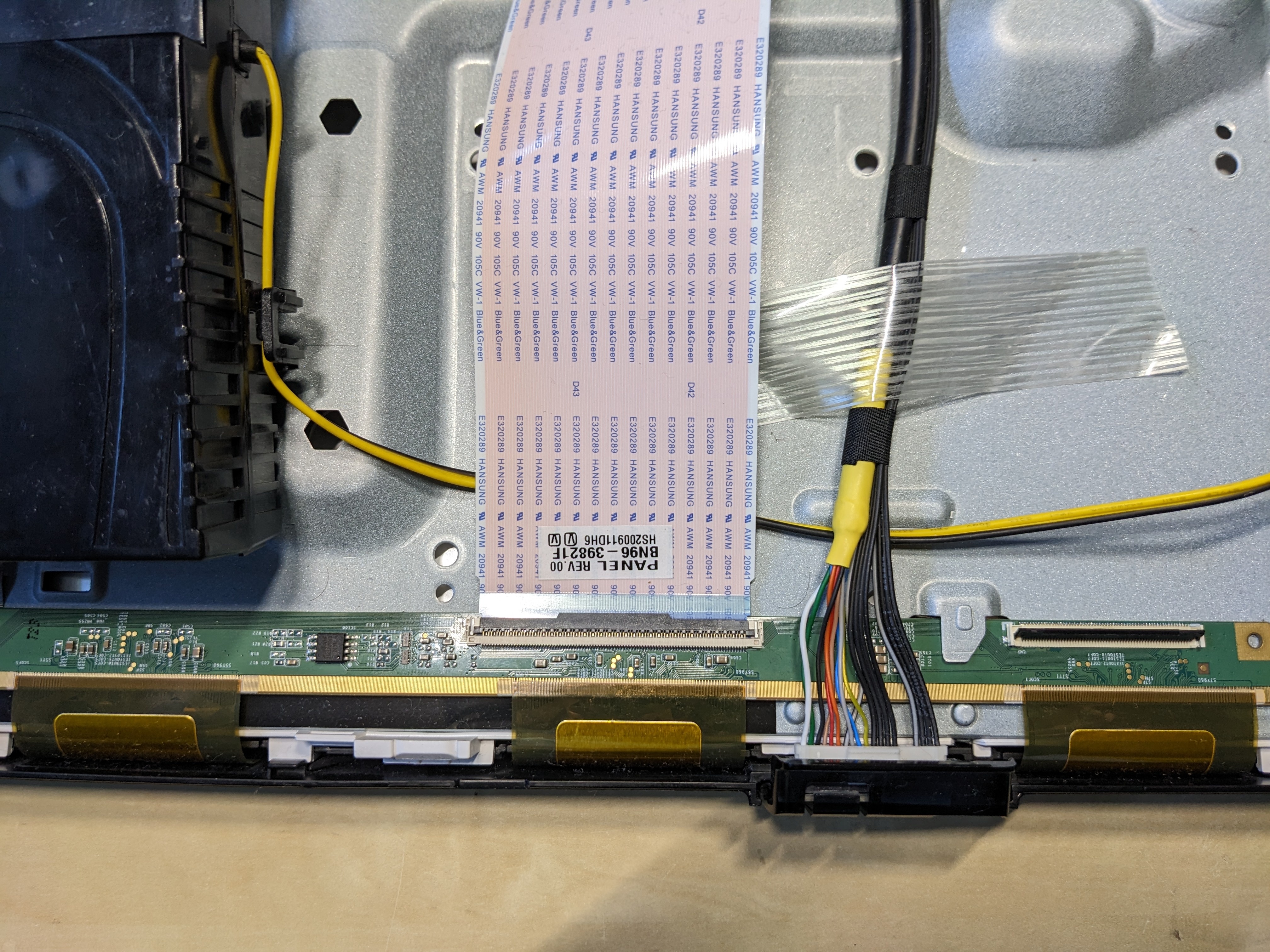

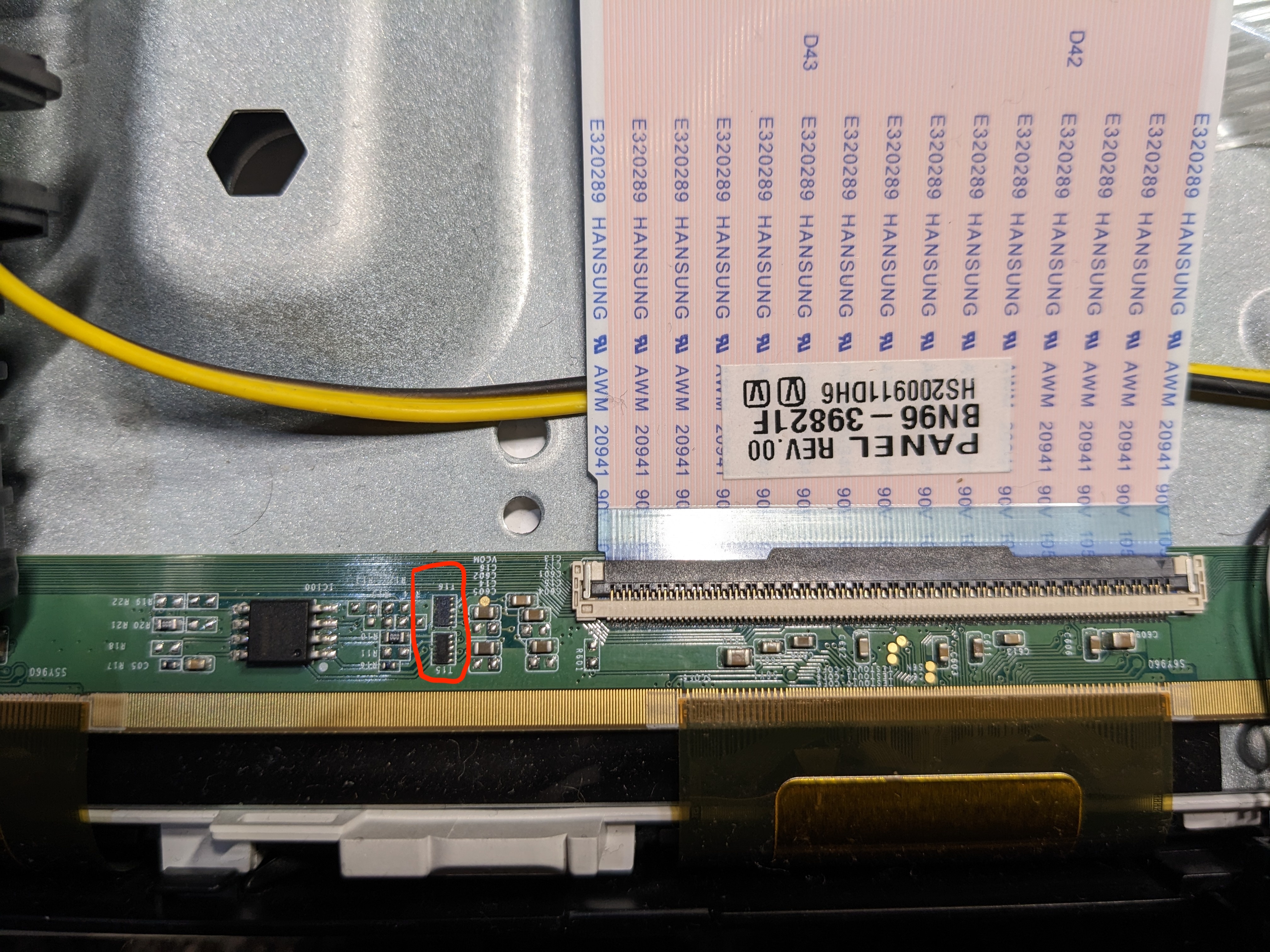

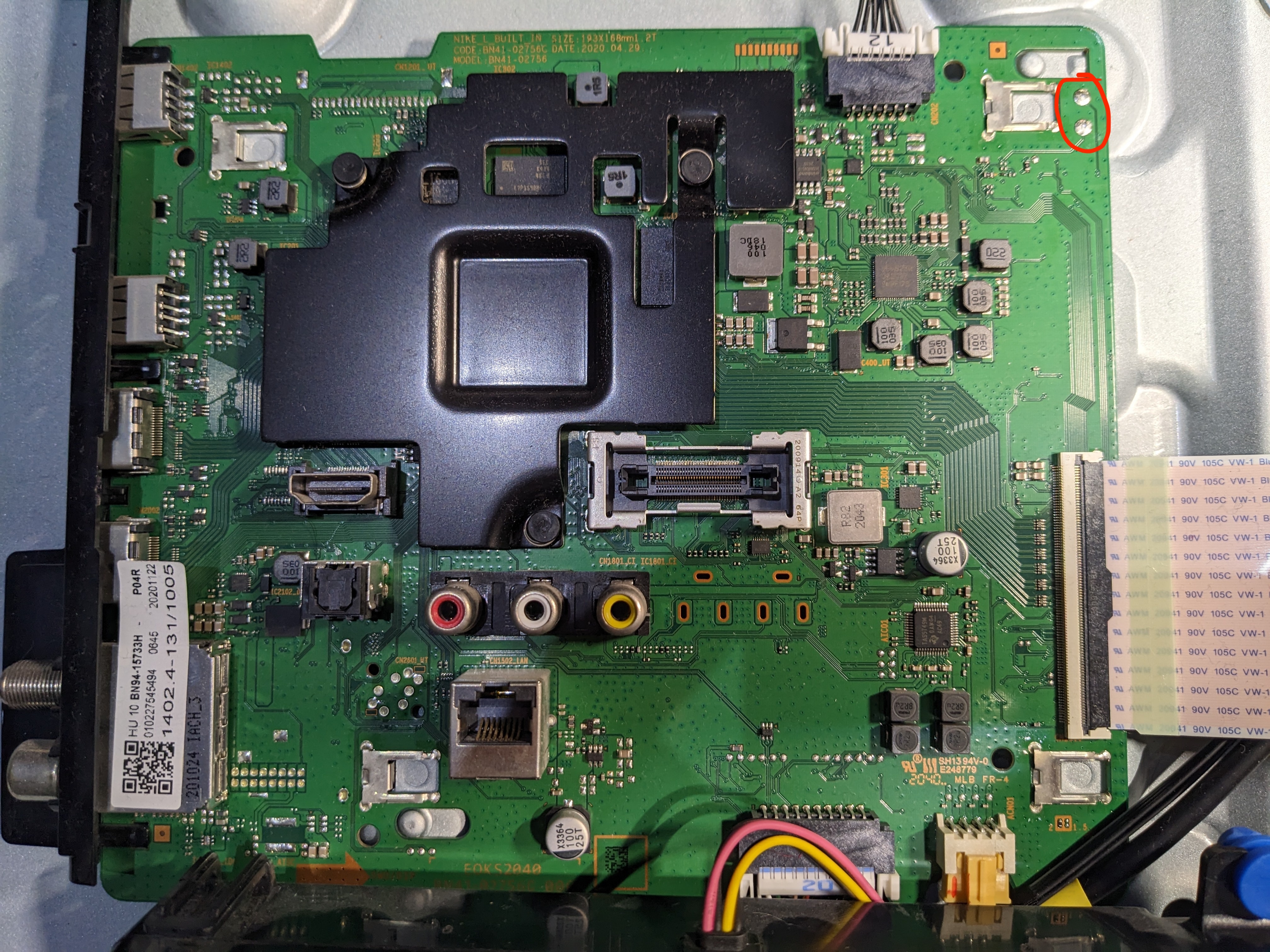

              There are no marked FB_TRDY_1 or 3 on the board but I put a jumper on the points highlighted on picture 1 (remember seeing them referred to as feedback test points). Unfortunately made no difference. It is just continuous loop with no difference on left/right of panel.
              I only have two diode assemblies and they are both on the left hand side (pictured). Second one reads 1,2,4,5 correctly as a diode but the first one only reads 2,4,5 and reads nothing for pin 1. Does it worth putting a standard diode between 3 and 1 to allow current flow or am I just jumping to a conclusion too early?
              • lotas
                • Jan 2016
                • 4671
                • Russia
                Yes, these are these points, you just have a different panel (from a different manufacturer), this panel does not have them and you have one lvds cable, you should only have a U-shaped cable connecting the two halves, so disconnect it from one either side, take a photo of both planks.

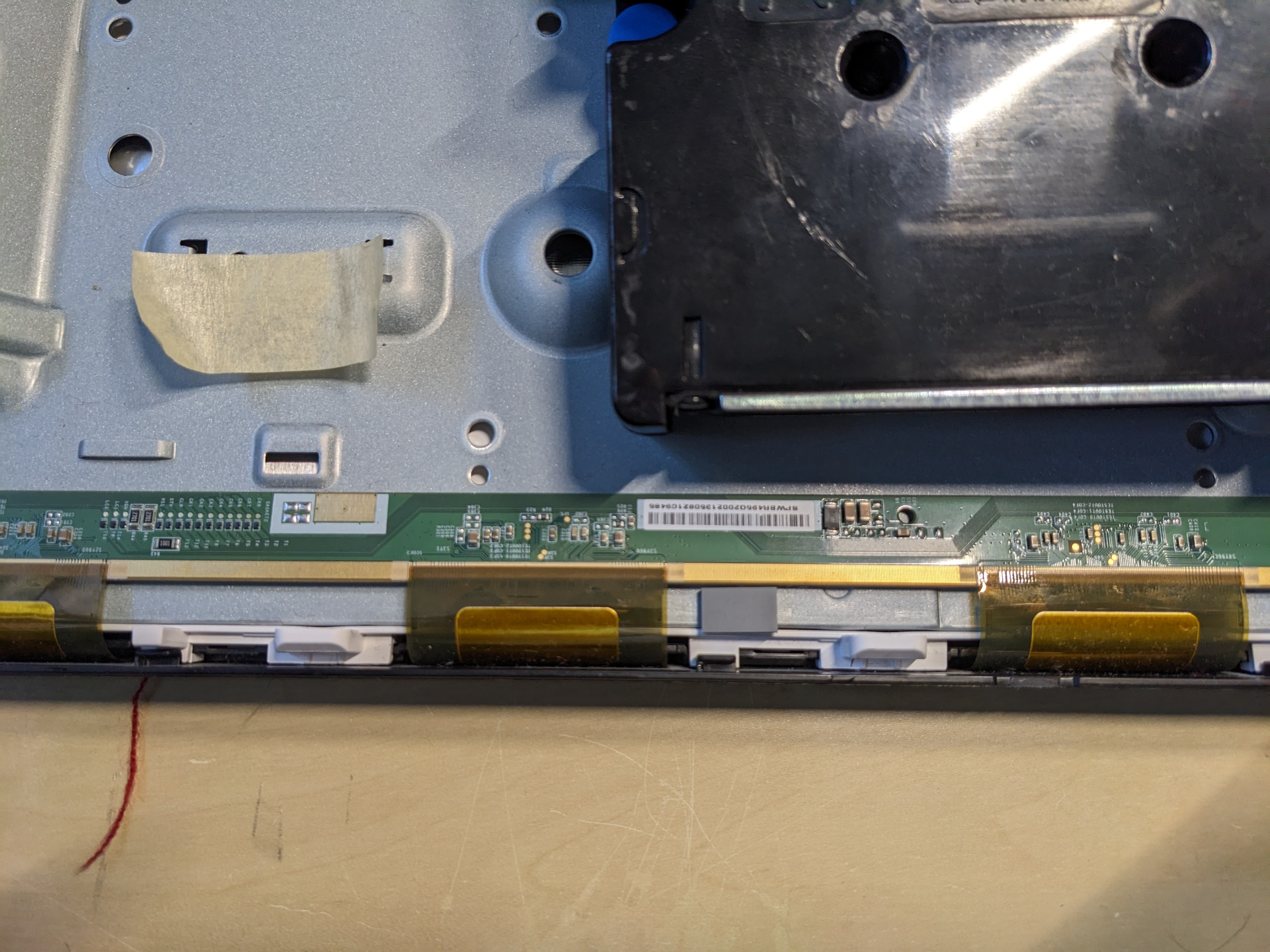

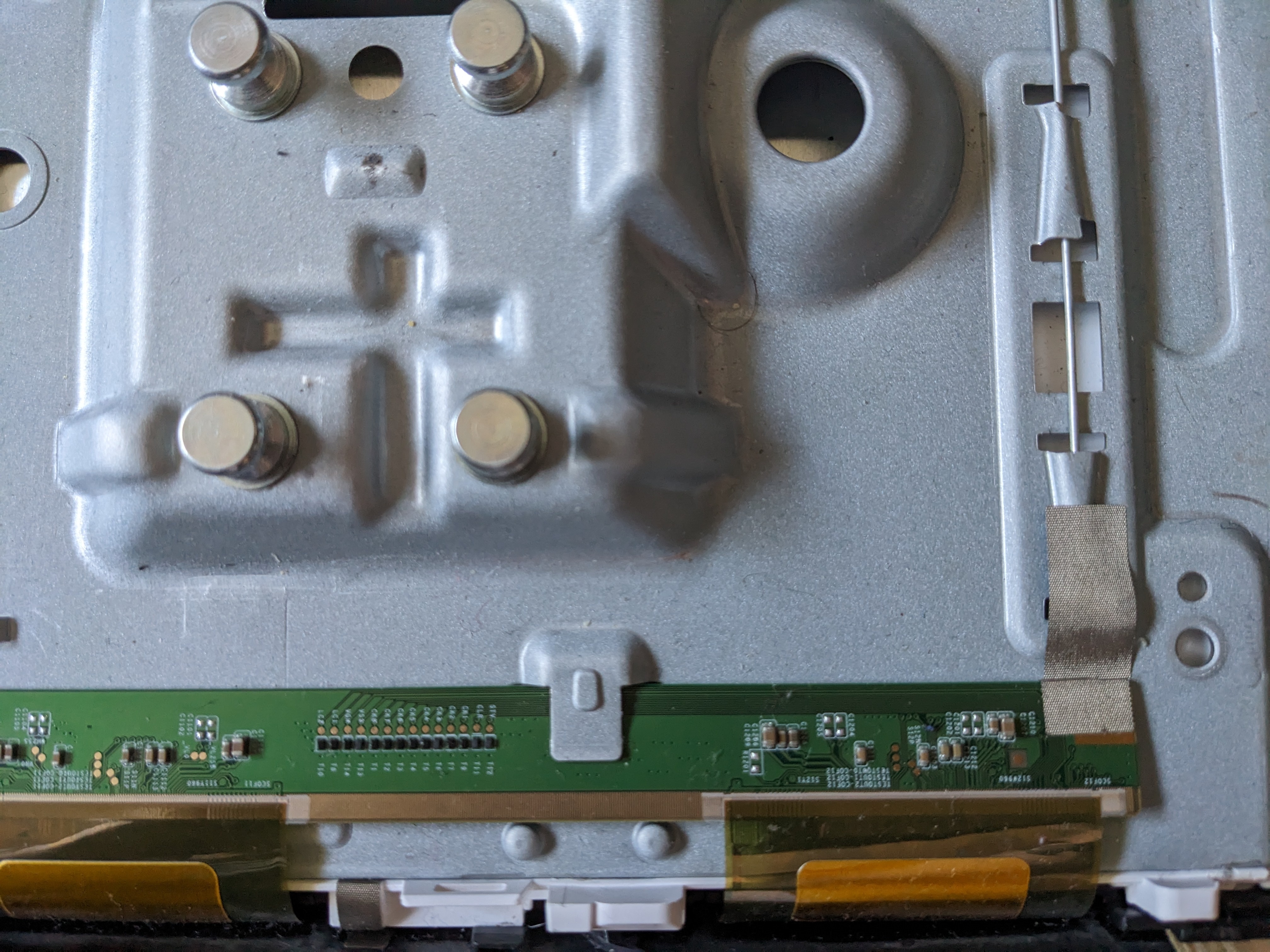

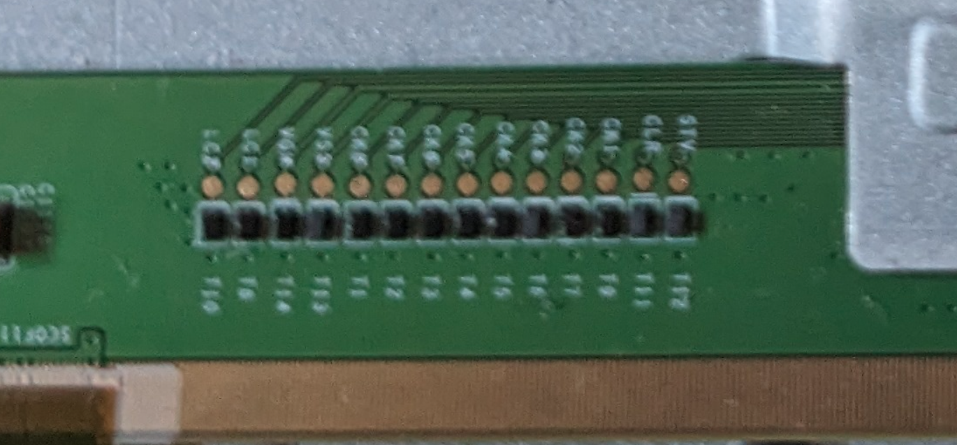

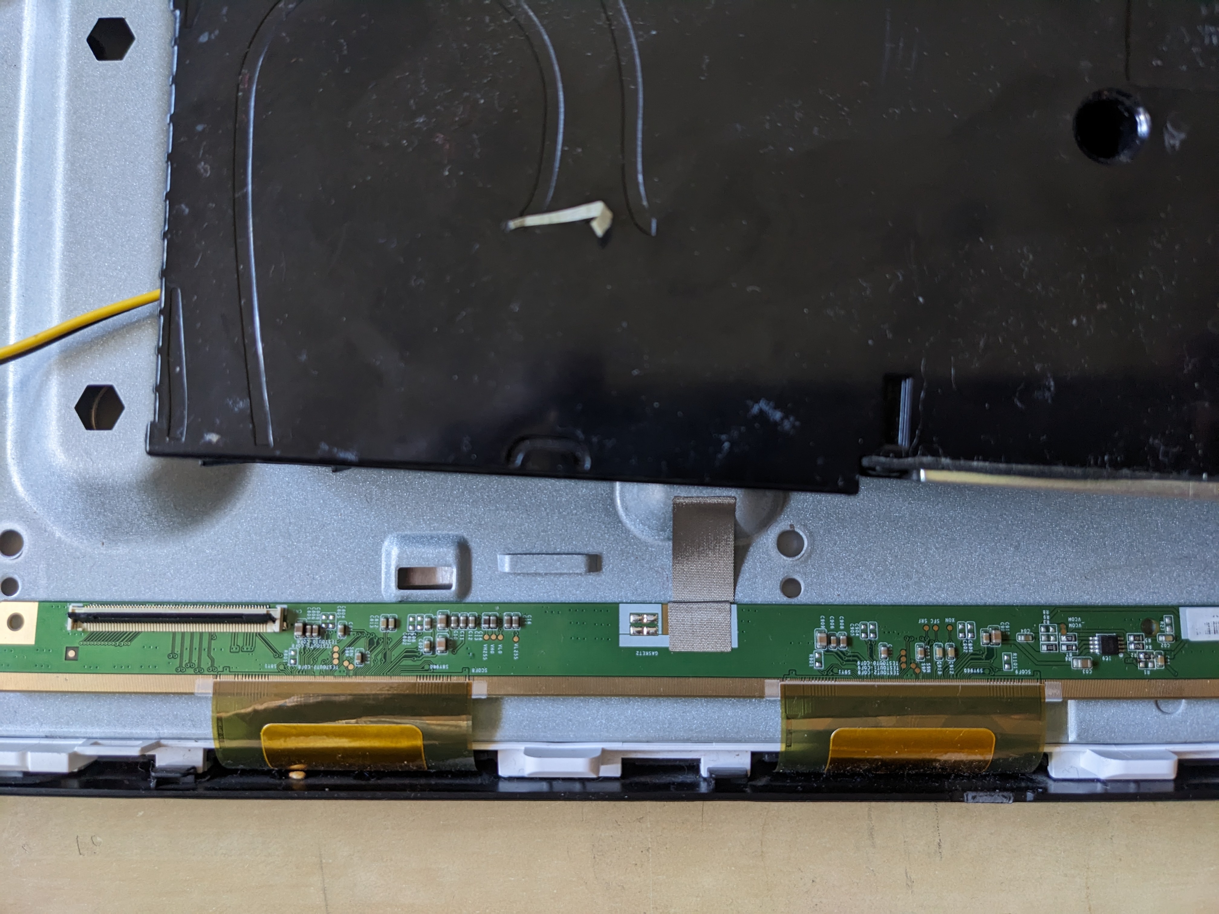

                  My photography skills are not any better but here you go
                  • lotas
                    • Jan 2016
                    • 4671
                    • Russia
                    Check these test points on both sides for resistance, relative to the ground on the bar itself.

                        These measurements were carried out with the U-loop turned off (that is, the left and right strips were disconnected from each other)?
                        • efidan
                          In progress
                          • Feb 2023
                          • 8
                          • United Kingdom
                          Apologies, you are right. Below are the measurements without strip and without connection to mainboard. >200M ones start counting from 50M and goes over what my multimeter can read. Perhaps a digital multimeter cannot read them correctly.
                          Left Right
                          LC2 - -
                          LC1 - -
                          VGH 5K >200M
                          VSS 1K 6M
                          CK8 >200M 1.3M
                          CK7 >200M >200M
                          CK6 >200M >200M
                          CK5 >200M >200M
                          CK4 >200M >200M
                          CK3 >200M >200M
                          CK2 >200M >200M
                          CK1 >200M >200M
                          CLR - -
                          STV -
                          Should I suspecrt CK8 - Right?
                          • lotas
                            • Jan 2016
                            • 4671
                            • Russia
                            Yes, and VGH on the left side is lower than on the right....
