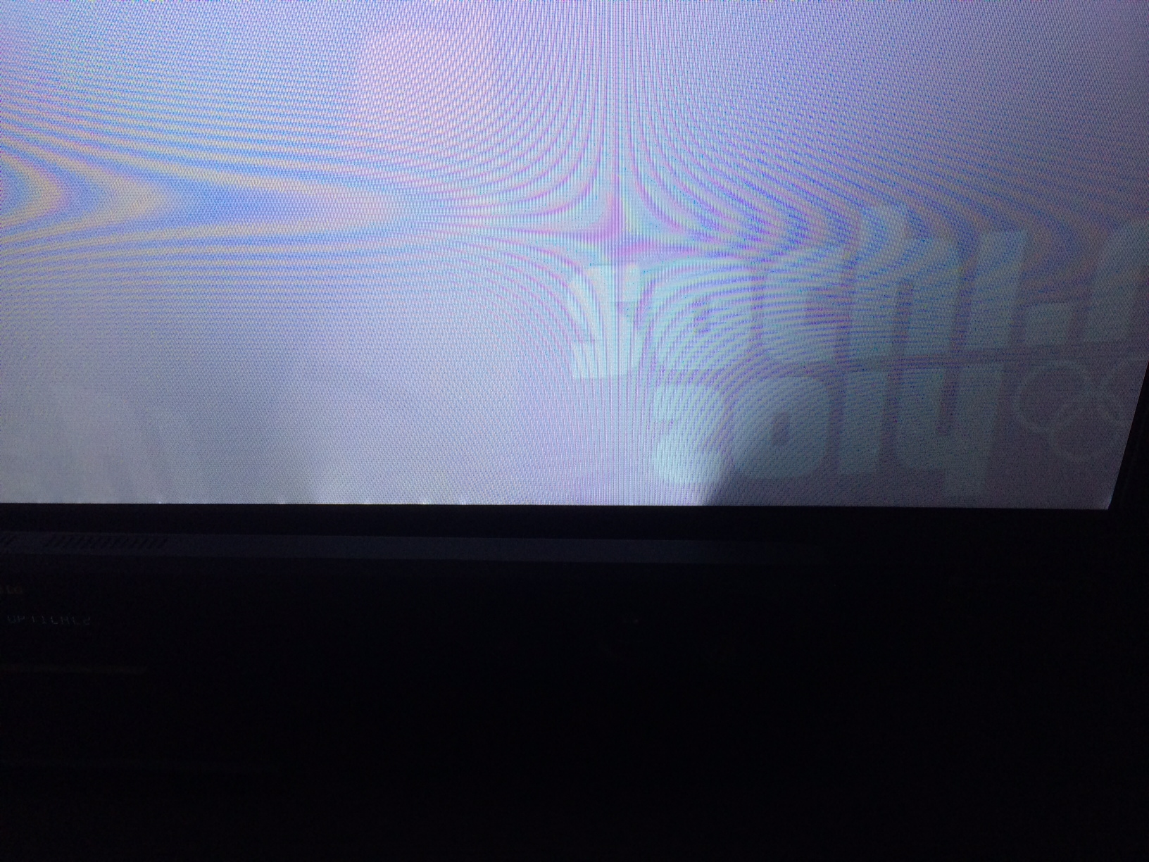

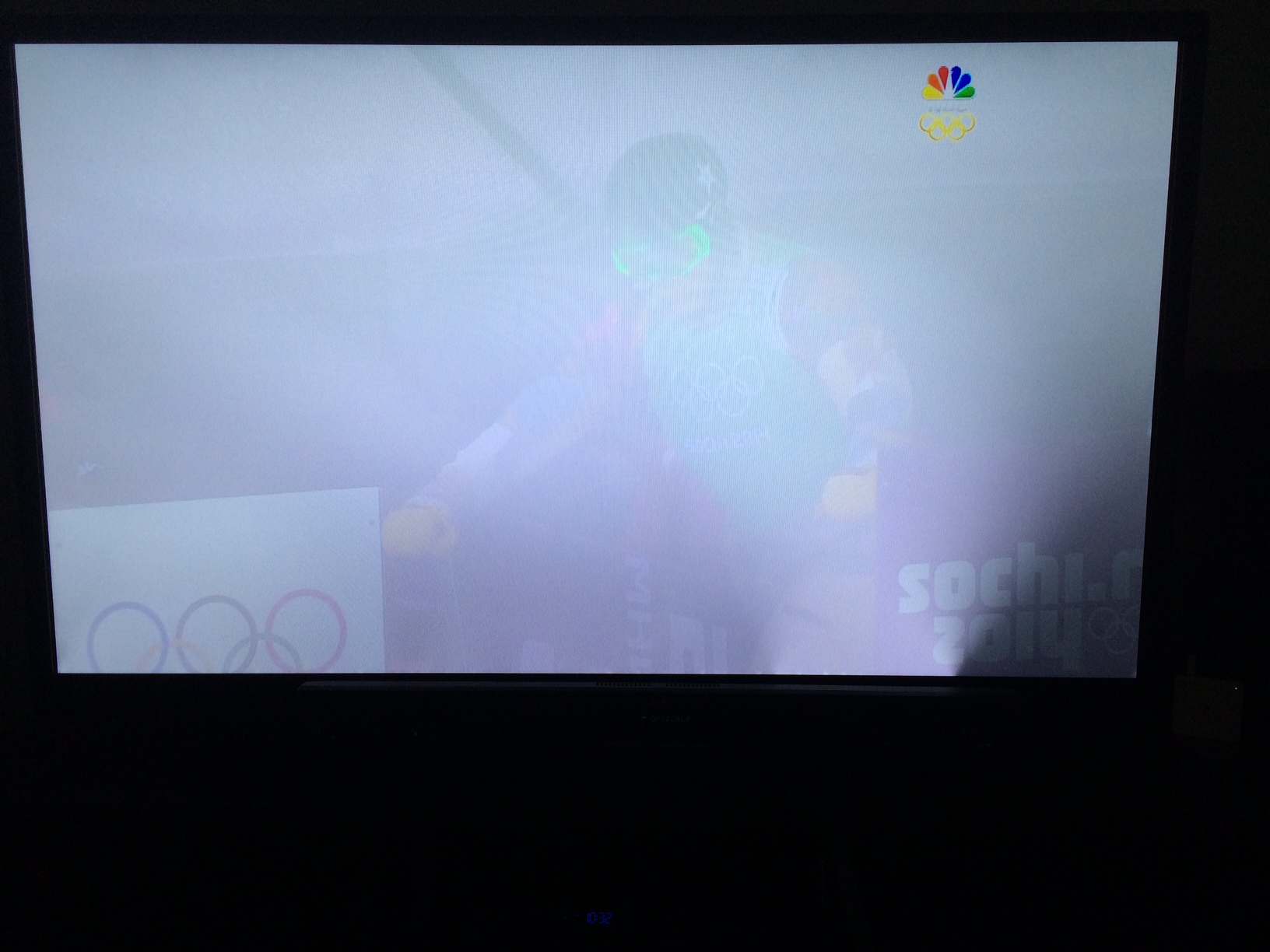

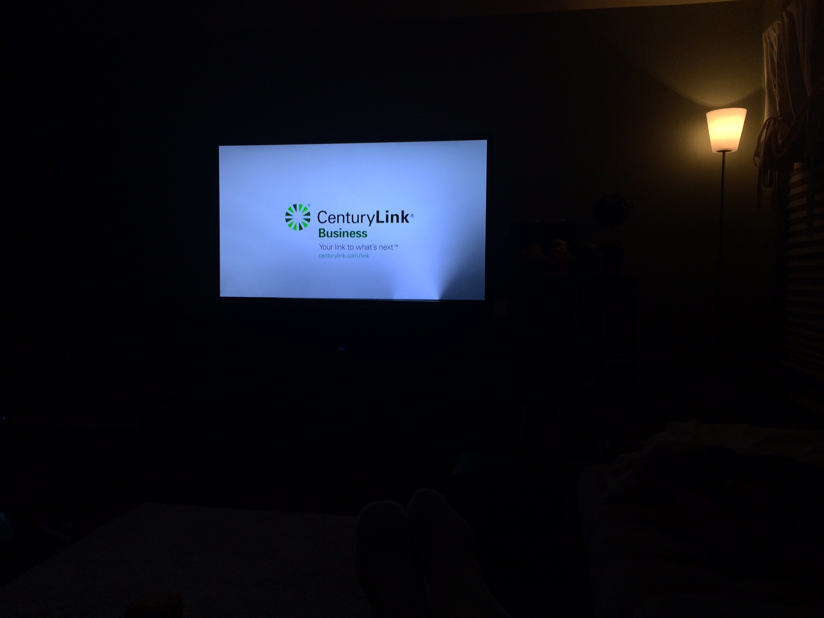

    I was watching my 70" LED tv, that i purchased about 6 months (refurbished) and noticed that about 8" of lighting went dim around the lower perimeter.
    It returned to normal a few times, but now appears to be out for good. The tv is still watchable but in bright scenes, it can be annoying. Can anyone explain what the problem is, and whether this is something i can fix myself, can have repaired, possible repair costs, etc.
    I've attached some photos for reference.

    You have a backlight problem.. Looks to be an edgelit LED system.. The lower right strip, some of the LEDS went bad. The reason the LEDS to the left of them are brighter is due to overcurrent from the bad ones going out.. Either a bad string of LEDS or a bad connection. either way it can be a tedious job. Especially if the strip is bad, the LCD panel needs to be removed..
    First you need to start by removing the rear cover, with the power disconnected and take clear pictures of the power supply. This is the board the power cord goes into.

        Its a difficult repair with high risk of LCD panel damage--due to its huge size. 70" of 0.5mm glass panel--is FRAGILE!
        A 42" is bad enough to potch with!
        This has to come off, complete with its tab-strips connected to the PCB's etc, and these too are very delicate. Do Not Strain Anything--even letting the tab-PCB's flop under their own weight can wreck them/break vital connections between panel and PCB....
        The dealer--would write the set off, as a dealer repair would be replace the whole assembly, backlight, LCD and T-Con etc....
        Then you have the issue of replacing the actual LED's. Advise all the LED strips are replaced--all at the same time--with new ones--IF they can be got....
