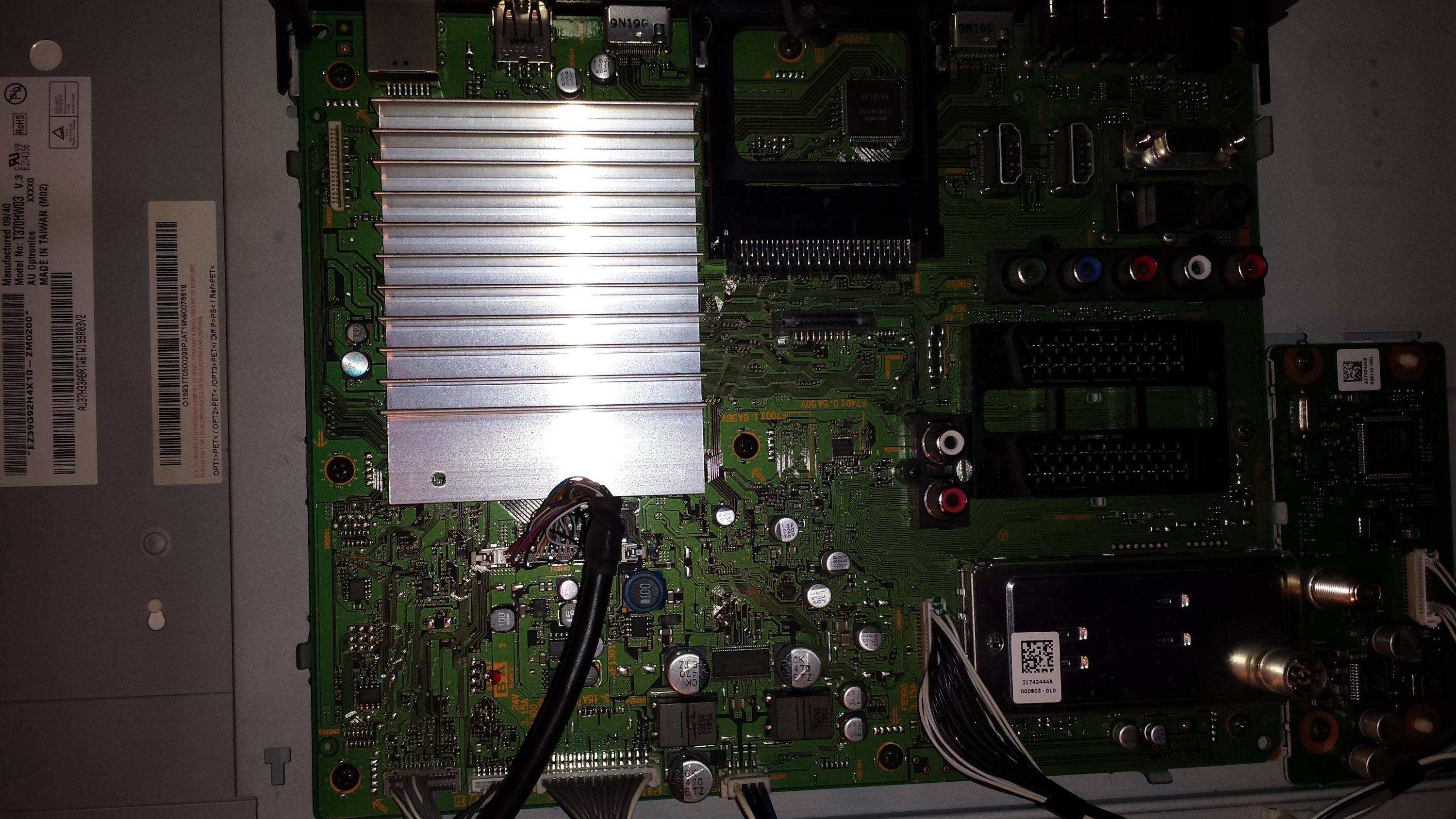

    Hi, I have here a 37 inch sony kdl-37v5810 when the tv is powered on its just a black screen with no backlight and the green light is on and flashes when buttons are pressed but no sound so don't think set is powered up fully, I read the dc voltages and the only one which seemed a bit strange was the 15v read as 17.8v, I then unpluged the cable going from the inverter to the main board and tried to power it then i got a backlight with black screen, Does this sound like a main board or a power board fault? Recieved my DCA55 today so hopefully that might help fix it. Still waiting on my fluke 87 arriving.. :-)
    A few pics added that might help

    Re: Sony Bravia KDL-37v5810 Power Fault
    Anyone know how i further test this tv??
      Post good clear pictures of the back side of the TV so we can see what we are dealing with.

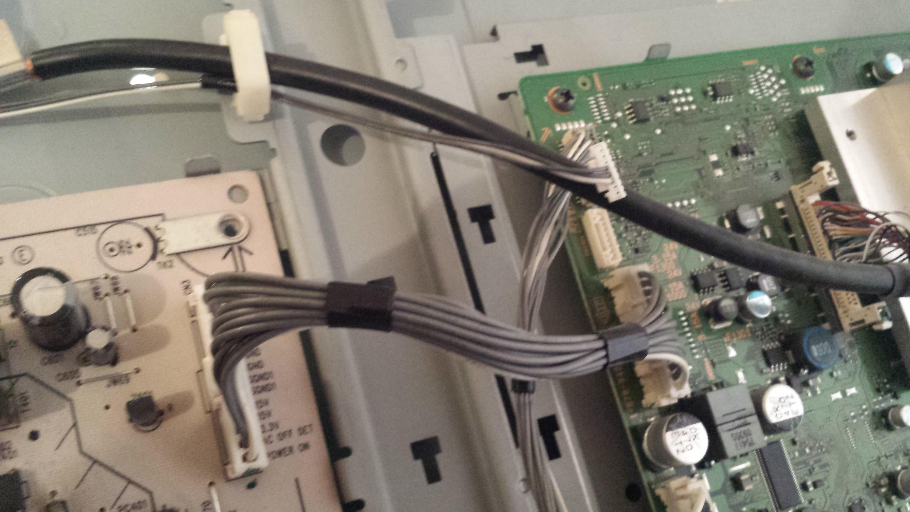

        Hope this helps..

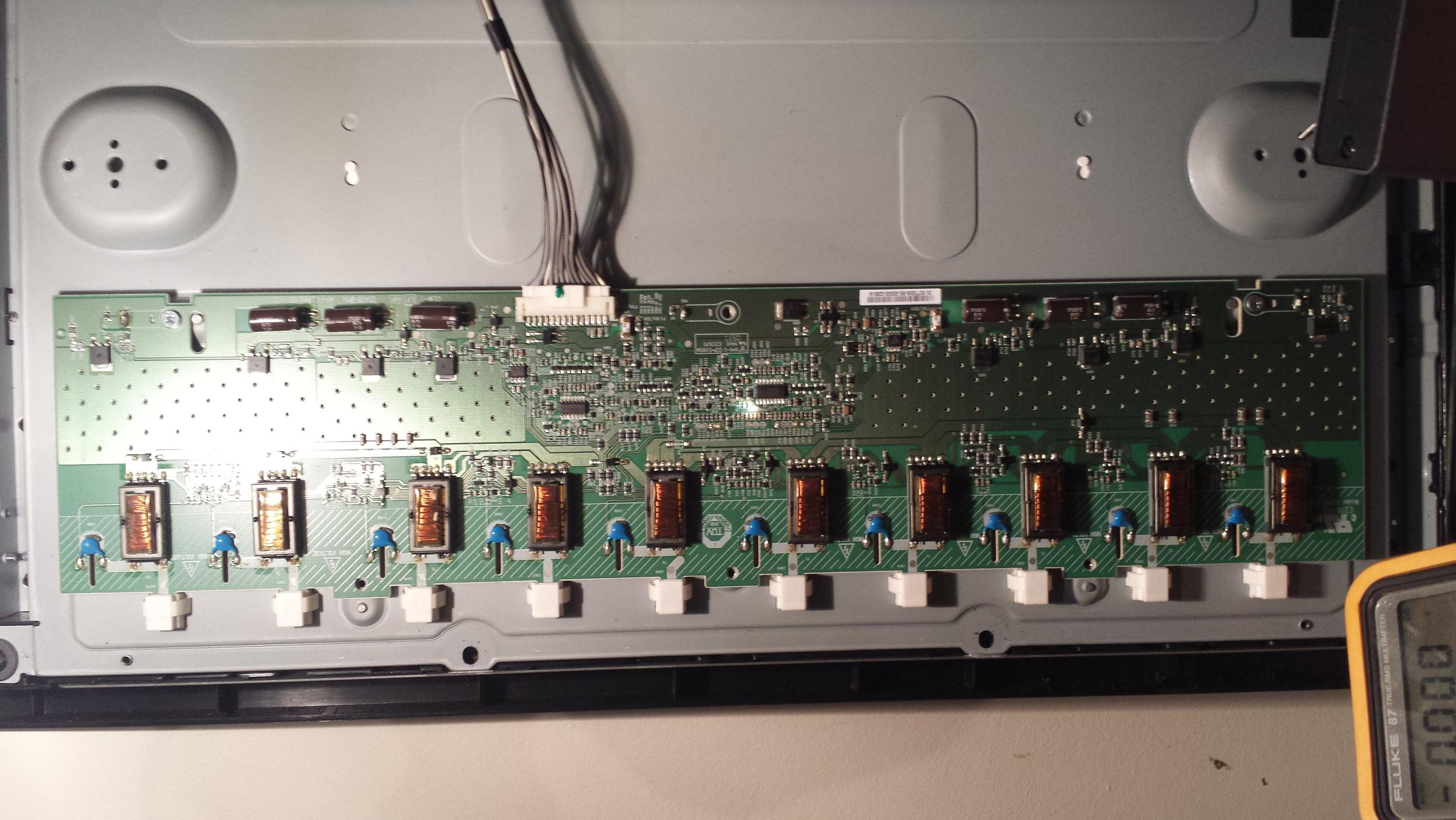

          OK, you need to remove that black cover off the Inverter board, remount the board with out the cover, then you have to measure the voltages and signals at that white connector on the Inverter board. Aslo post good clear pictures of the inverter board especially around that white connector.

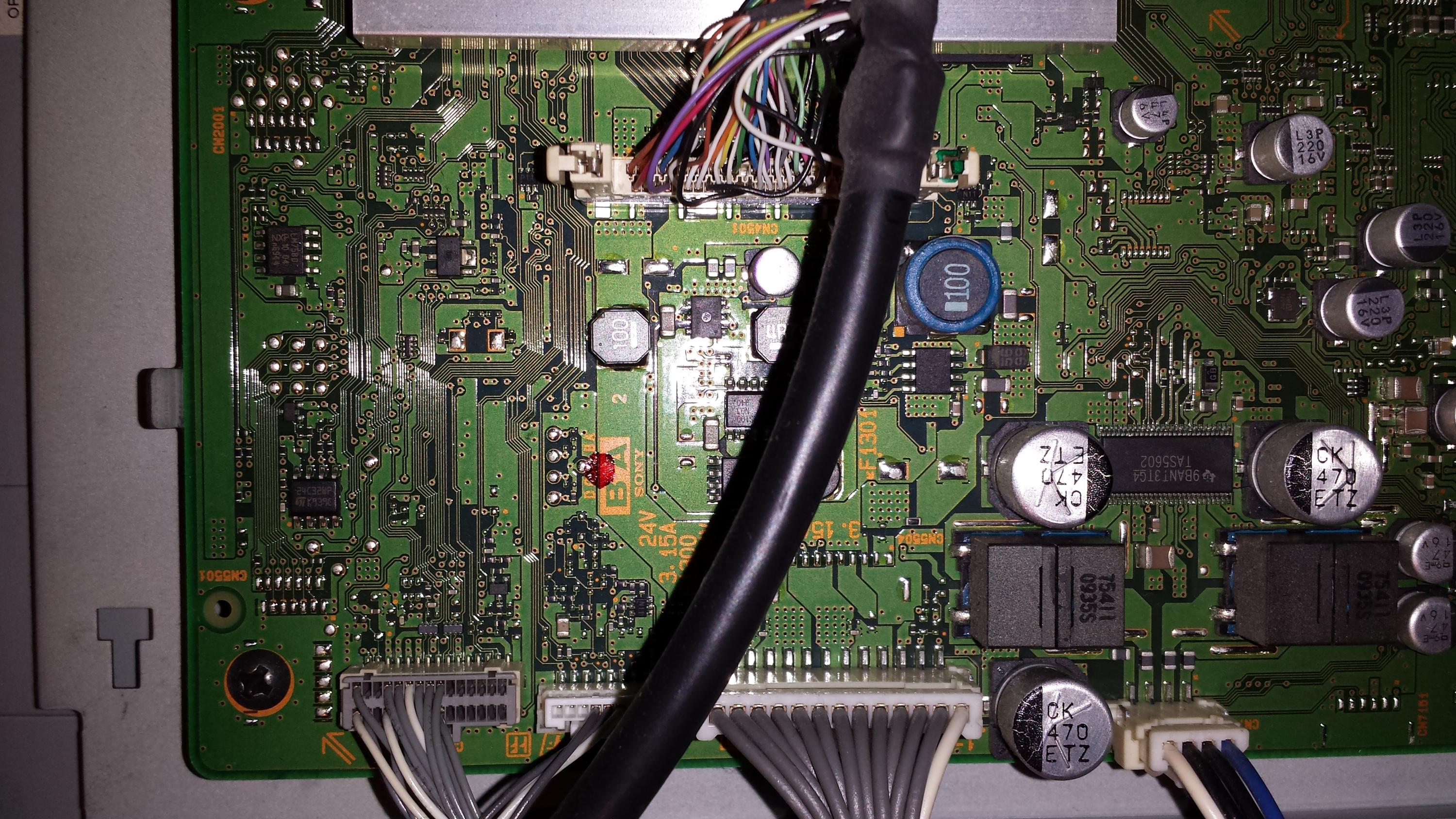

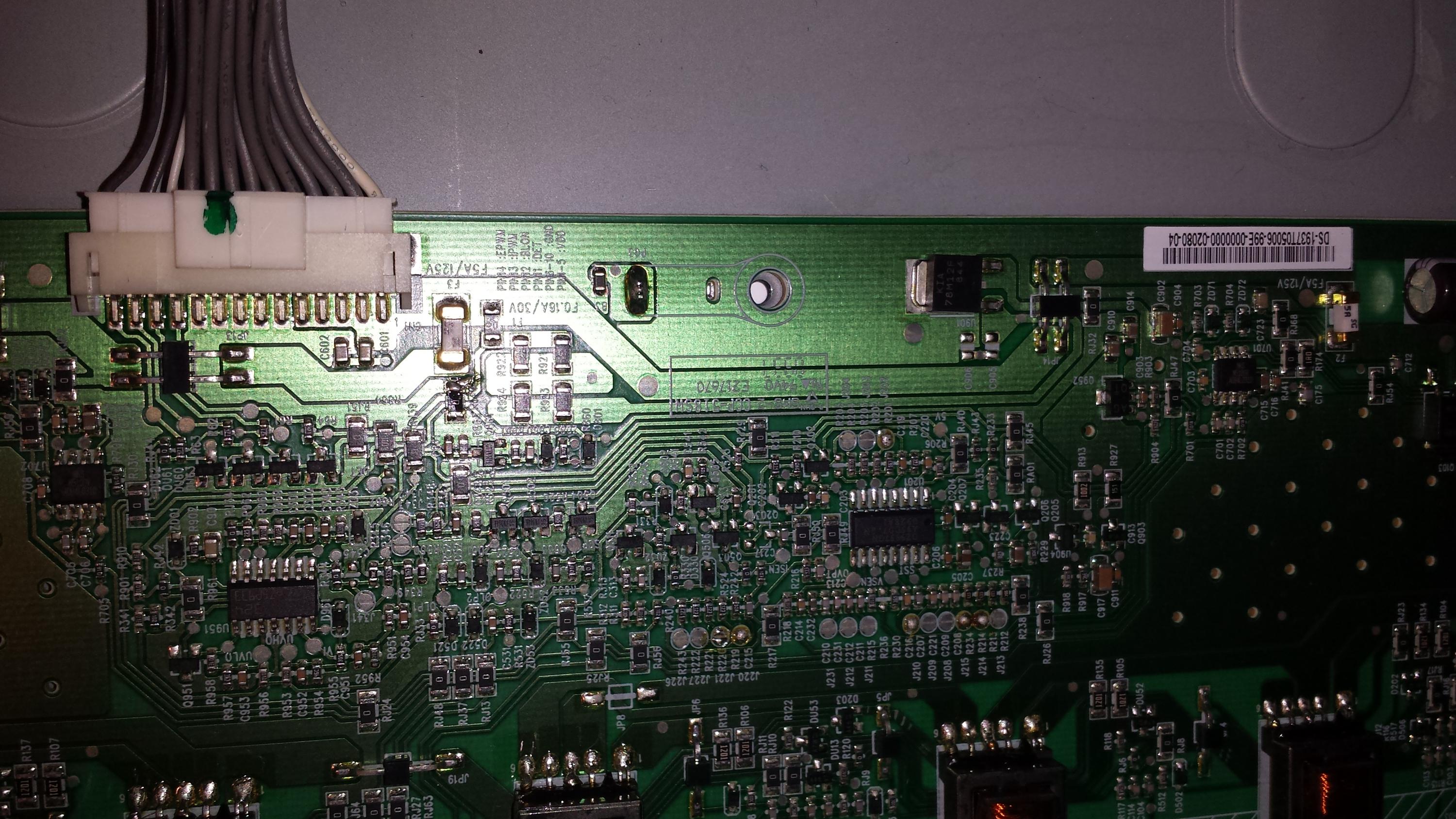

            I wrote a reply to you ages ago but must have forgot to hit send, Sorry.. ;-) Voltages on pins 1-5 VDD on inverter board is 24.81 DCV, also getting same 24.81 both sides of f2 and f3, tested f1 on the t-con and not getting any voltage there either side,
              OK, to the right of the Inverter board connector CN1, you can see big fuse F3 (F5A /125V), next to that fuse is small black fuse that looks like resistor, it is F1 (F 0.16A/30V), check and see if that fuse is open, it should have 24VDC at both ends of the fuse measure it with ref to the chassis ground.
                Yep , Gettin 24.81v either side of f1 fuse.. ;-)
                  Pin 12 is the BL_ON pin, what DC do you get there, it should be >2VDC? so far your power supply is good.
                    Pin 12 BL_ON reads 0.029v
                    I think i mentioned before the only strange voltage from the psu is the 15v which reads 17v
                      OK, so the main board is not sending the BL_ON, but the PS_ON is OK because the 24V is on. You also not getting the the 12V to feed the T-CON which is also switched on by the main board to turn on the MOSFET on the main board that feed the switched 12V to the T-CON. Reading of 17V on 15V is not big deal right now, that 15V may not be regulated power supply for probably the audio amplifier circuits.
                      It looks like big troubleshooting time for the main board.
