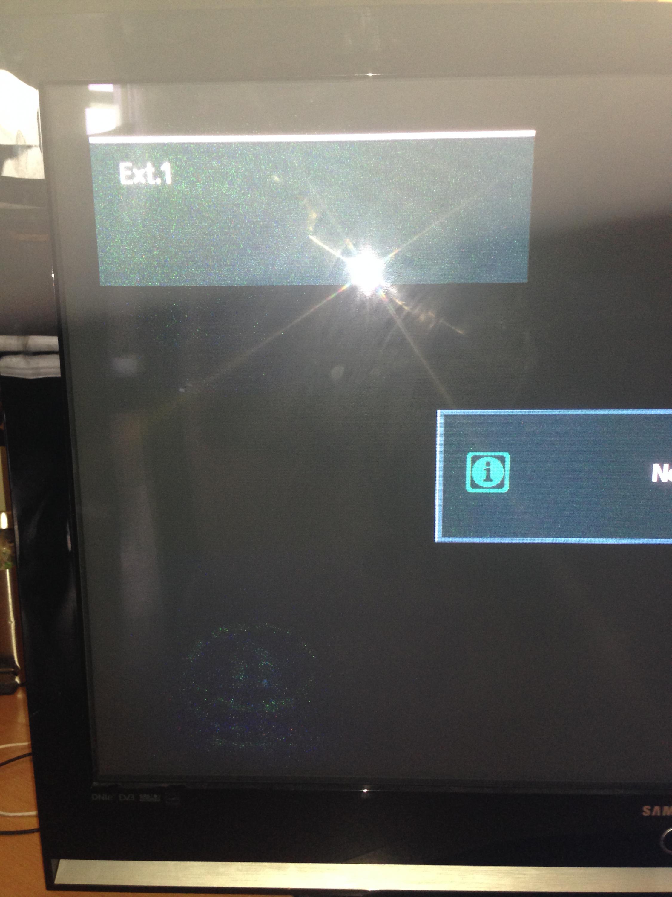

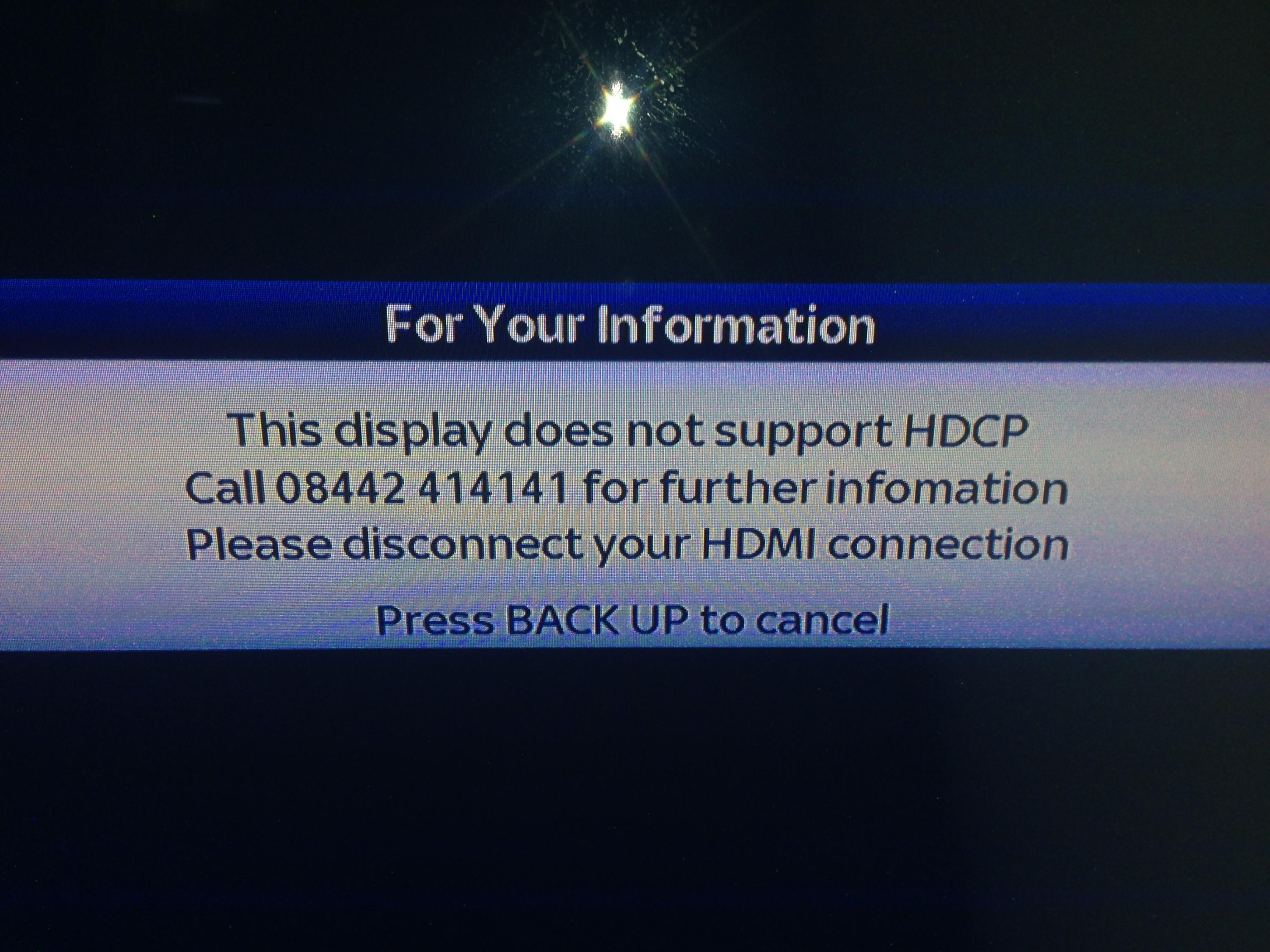

                  ok tried that and this is what i get see pic also on black screen theres another problerm as seen in next pic sparkles and bottom left looks like a logo ?

                        Looks like it's working, HDCP not supported. One of the other guys is probably more up to speed but encryption issue i'm guessing?

                                also what do you think the prob in pic 2 is the tv had sparkles so i up the volts and got rid of most of them but still when on black screen is look like pic 2 ?
                                  Re: ps50q7hd
                                  This is a common fault with older TVs, and you can blame hollywood / copyright industry...
                                  They insist on encrypting the connection between the set top box/bluray and the TV because they don't want it to be copied. If the secret encryption keys used to encrypt this are compromised then the data can be copied. The keys are usually compromised after some time because people copy them and the standard is horribly broken allowing anyone who knows what they are doing to copy said keys after monitoring the HDMI data for around an hour or two.
                                  End conclusion is TVs that are older than a few years can have their keys revoked (banned permanently from showing HD content) and the boxes will refuse to send them HD content. Yes, this means any TV nowadays because it turns out once the signal reaches the main board it's completely unencrypted from main to t-con/panel/PDP... and there are full datasheets describing these formats in my signature for example and across the wider internet.
                                  Even though PirateBay and other sites are full of pirated movies, sports, TV, often less than two days after release - in other words, it's not making any difference - they continue with this "f**k the customer" policy.
                                  Only thing you can really do is get a "HDCP stripper" - like HDFury - but they cost a lot of money...
                                  NOTE: eBay has banned HDCP strippers because of the industry complaining, despite them not being very complex at all... the HDFury retails at $250 but looks to contain less than $10 of parts. http://www.3dfury.eu/images/hdfury2_5.jpg So if it were not for the 'bay banning them then you'd have cheap ones from China in no time... and the industry would hate for their broken, expensive standard (£1.50 per bluray player, £0.10 per disc, £3.00 per TV) to seem even worse!

                                    Aging panel? I worked on one of these and had the same issue. Gradually got worse as it running on a black panel and I think with the blue screen on it was bad too in selected areas on the panel. I tried forever to adjust it out with little success. Was not too bad watching it normally.
                                    As for no PS3 or any HD, I don't have an answer but if the output resolution is correct for what the TV can process I'm at a loss but that message is probably being sent by the skybox and the image is good so something is working.

                                        Yeah, looks like panel aging to me. I couldn't get rid of it on my Q96 properly... luckily the Q96 was a freebie. I would never pay much for one of these sets, too many problems.
                                        Same cause as LG panel aging prematurely, but there's no firmware update for these...
                                        Notice the poor discharge on the gradients.
