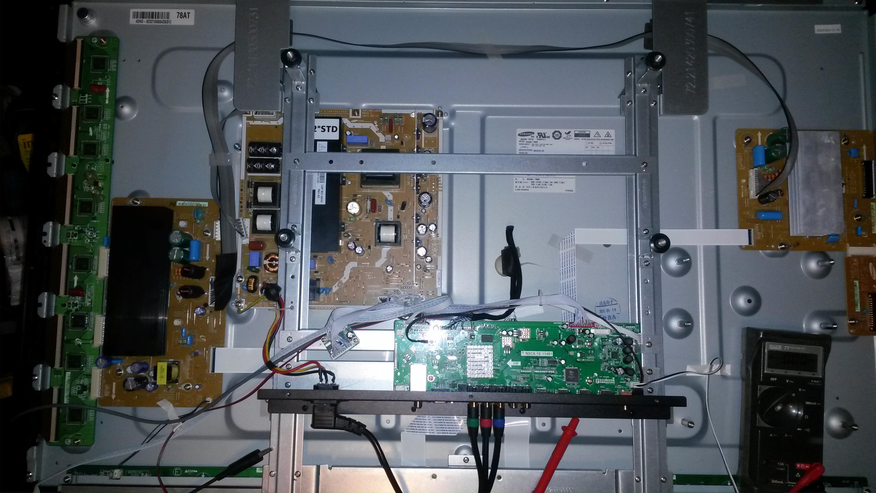

    I have an RCA 42PA30RQ with no picture. I get the 2 clicks when powering up and a steady blue led on the front of the tv. I checked my voltages and it looks like my vs and va start at the proper levels and then drop off.
    I disconnected power from the x main, no change, and disconnected the y main, no change. With the main connector disconnected from the power supply, I get the same thing, power comes up and then goes back down.
    Nothing appears to be hot, burned, cracked, smoked, swollen. Took my meter to most of the devices and everything looks ok.
    I saw a couple of threads referring to the led on the main board, my main board doesn't appear to have one, unless I just don't see it.
    Anyone ever have a main board go on this model?

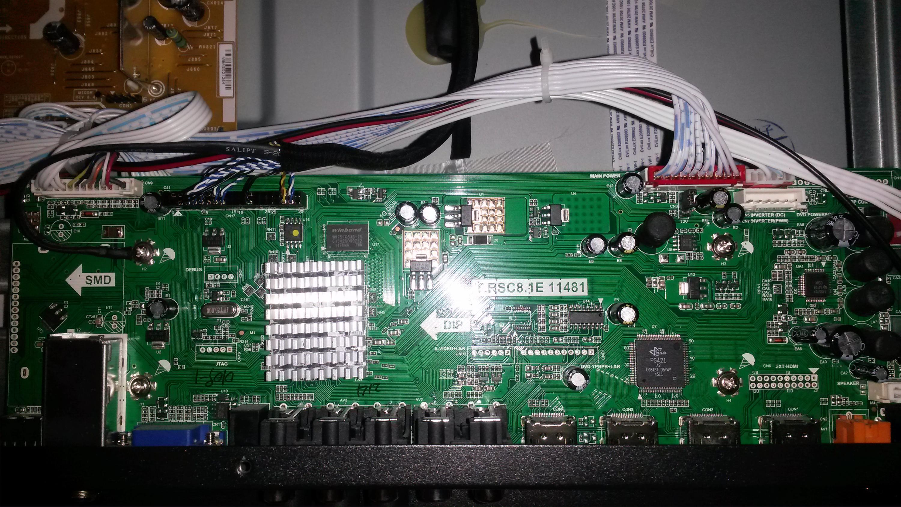

    What chassis is this set using?
    A couple of pics can help....
    TELEFIX
      Re: RCA 42PA30RQ No Sound, No Picture
      Thanks for the reply. It's a samsung chassis, but which one, I'm not sure.
      I'll attach some pictures.

              Got the new x and y mains. No change. The power supply keeps dropping off. Wondering if the PS is toast. I can her a noise (oscillation) in the y main, that's when the High Voltage in the power supply drops off. The noise was present on the previous board also
                Pulled the y buffer, power stayed on. Live and learn. Hopefully the y buffer didn't damage the y main. Going to order a y buffer, then try the old mains, then send back the other cards I bought.

                          Well, I tried it with the old boards, and the buffer removed, and the high voltage stayed up. I'll order another buffer and try it with the old boards. So many different versions of that board for this model tv. Shopjimmy recommends using the pba # to match up parts. I see a few out on ebay, time to drain my paypal account a bit more. If this works, at least I can return the other boards for a restocking fee.
                            Got the new buffer board, it's bad too. One chip looks like it's bad. Different reading from the other one, but still reading shorts to output pins. Returning it and ordered another one.

                                Got another buffer from shopjimmy, and used a new y main as well, looks great. No more ebay parts for me, well at least buffers.

                                    I've fixed a few of these. All the ones I've worked on had both the X and Y sustains shorted. Replace only one, and it will instantly become a paperweight.

                                      The Y buffer can easily be tested. https://www.youtube.com/watch?v=51SZsfH60EY
                                      The X Sustain usually only needs two RJH30E2 MOSFETS under the heatsink replaced. The Y-sustain I believe required 4 RJP30E2 MOSFETS and the driver ICs.
                                      Getting sound requires you to use the correct input source, whatever the TV was set to when it went out.
