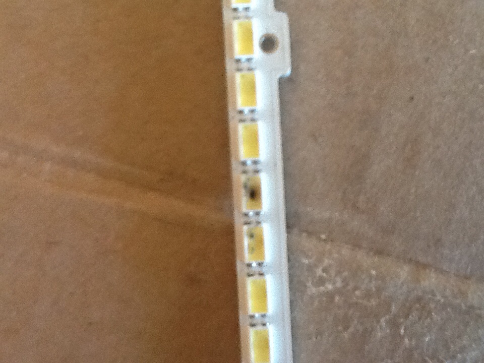

    I checked with ohm meter top of strip went to one wire and bottom of strip went to other wire. I guess they could be two series parallel ckt.

      Exactly that. If you check again you will find continuity with top wire and anode of 51st led and second wire with cathode of 50th led. I guess this way the circuit doesn't fail with open led in either/or of the parallel runs.
      Stay tuned will have my glue tomorrow and will test my repaired strip hopefully by mid-week.

              Finally got mine apart and the right side has some bad LEDs but don't how to "jump" the bad ones.... ???

                Well this is a late reply lol but I had luck removing individual leds from a bad strip and using them in my strip.
