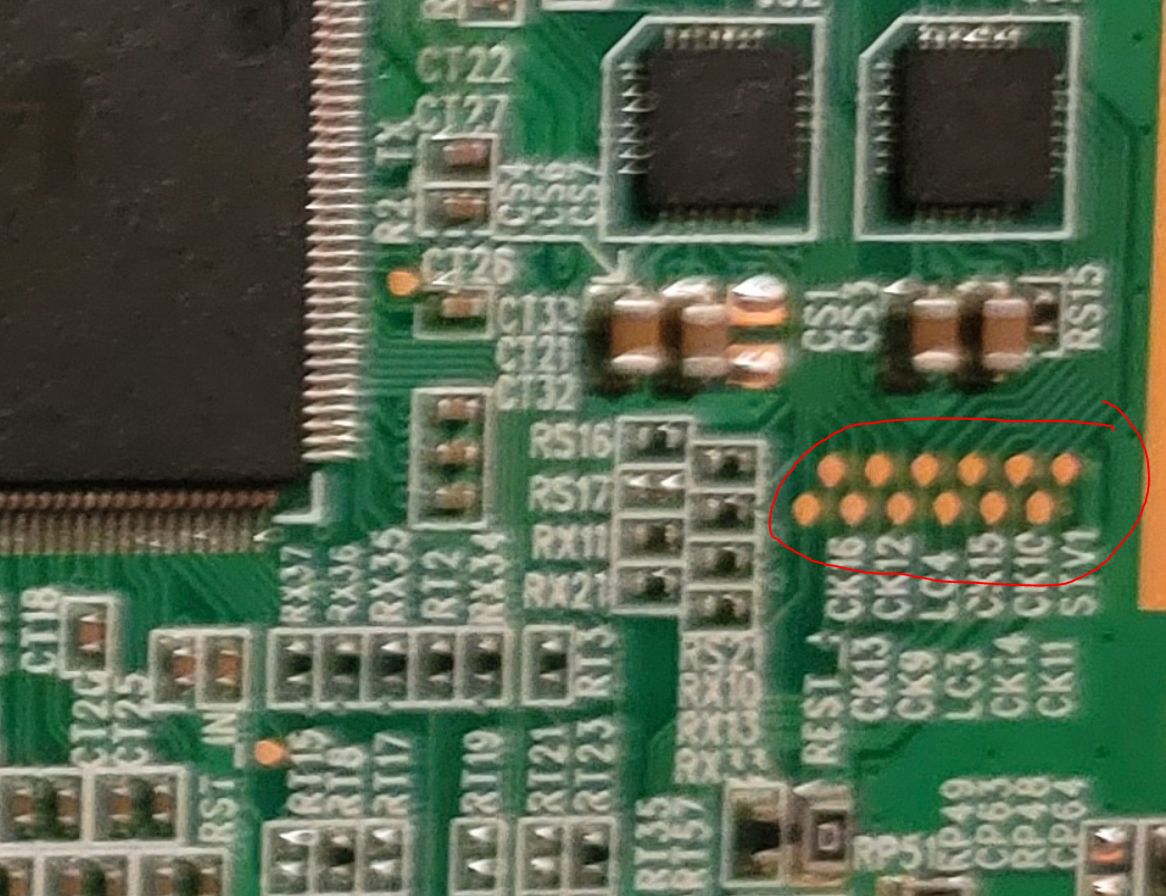

                • petehall347
                  • Jan 2015
                  • 4426
                  • United Kingdom
                  is u403 cooked ? or is it just dirt ?
                  • Helikvar
                    • Jul 2018
                    • 68
                    It was just dirt .I cleaned it up and sent another pic.Its temperature goes up to around 46°C when tv is powered on for about 10 minutes .
