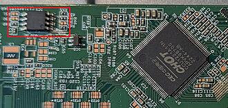

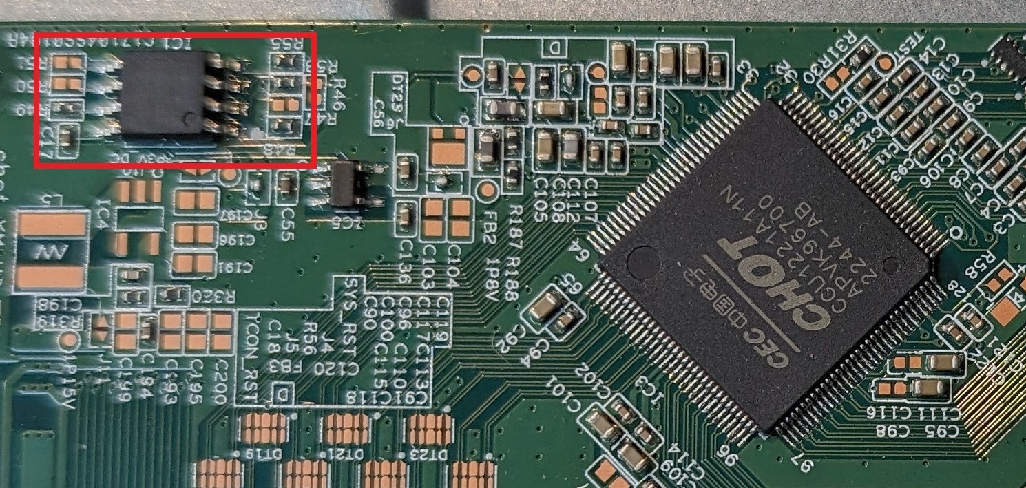

                  this mean the firmware on T-CON was disrupted, or the IC play crazy.. after disconnect LVDS and fed the t-con with 12VCC drive it to reset.
