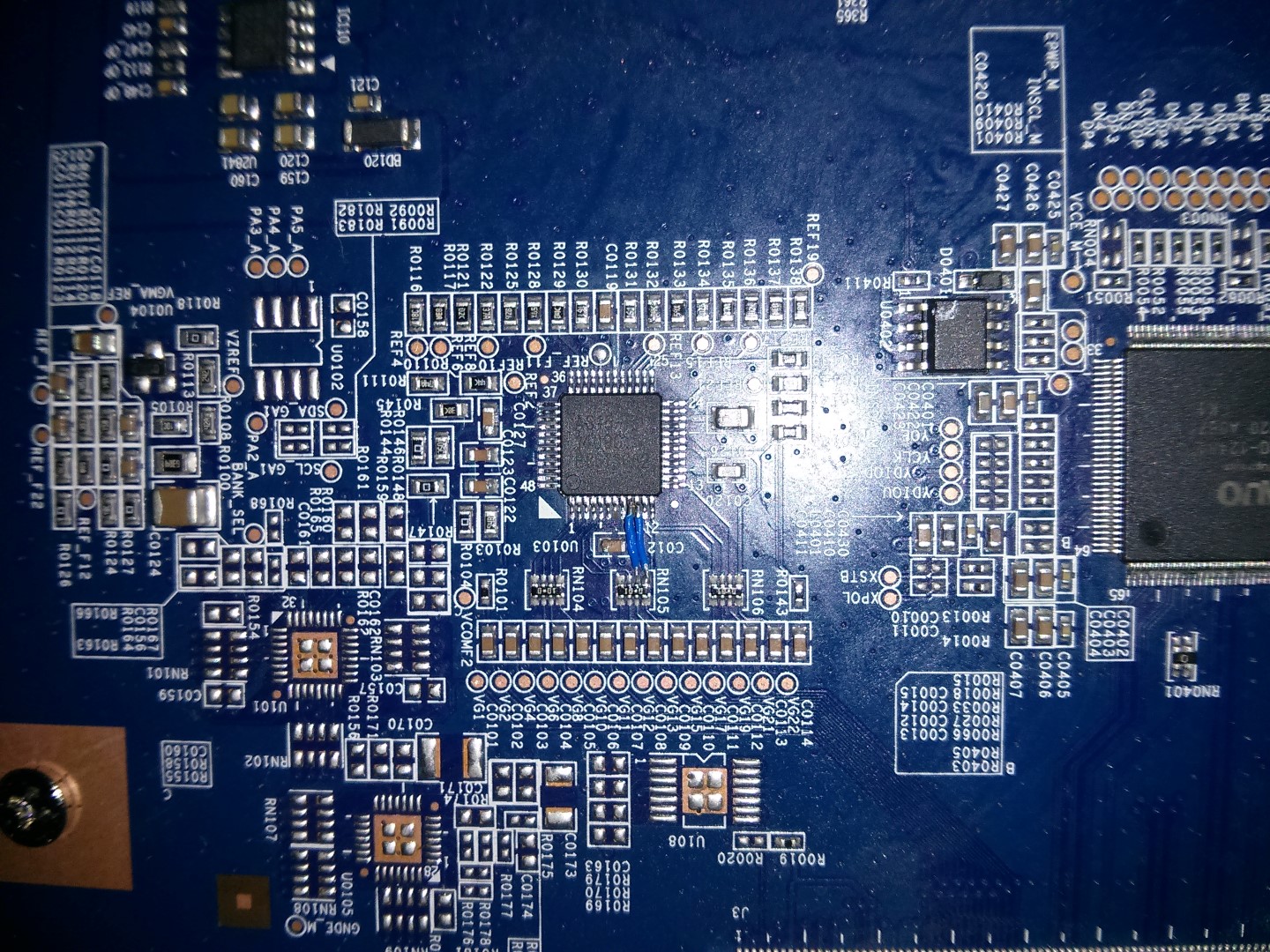

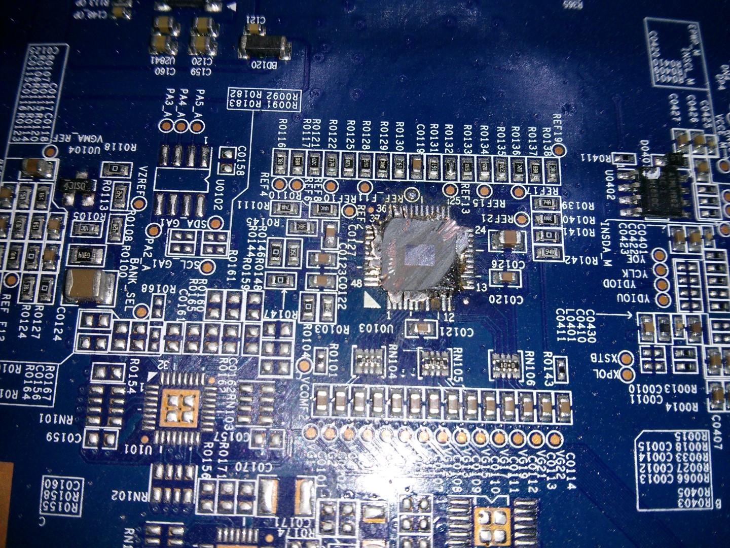

    Got this one with T370HW02 TCon with AS15-HF and ordinary picture brightness problem. From 14 pins 1-3 are at ~15,5 V, than it drops to 11 V and decreases normaly. I guess pins 2-3 are faulty and should be lower, right?
    Re: Samsung LE37B650, gamma?
    You should check gamma voltage points not chip directly. A picture of the fault would also help.
    • Behemot
      • 4845
      • CZ
      Sure, how do you think I'd measure those tiny leads? It looks OK optically.
      Image at http://www.wisiny.com/media/catalog/...0HW02%20VE.jpg, measured VG1-VG22.

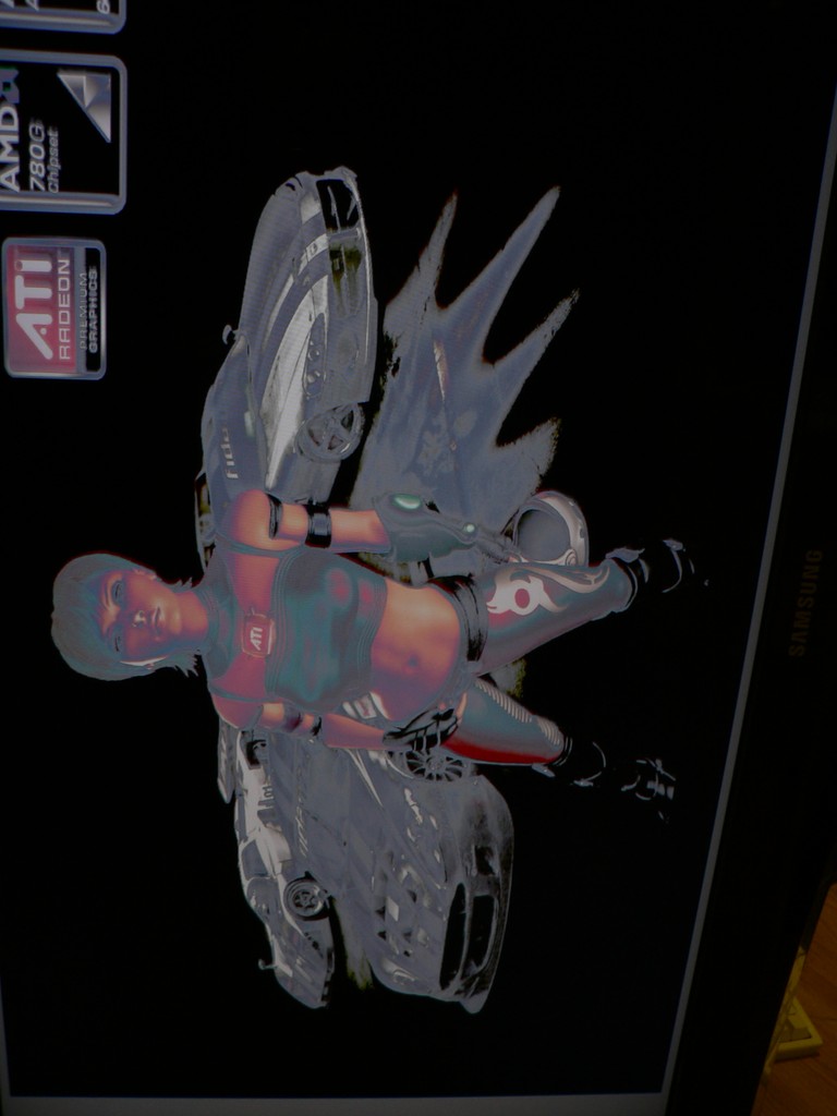

        Err--I Think Tom meant a Picture of the set's Picture--Illustrating the Fault, not a pic of the T-Con!
          Could you share full voltage set? The monotonicity requirement is only a basic test. The voltages should also be symmetric about the mid point.

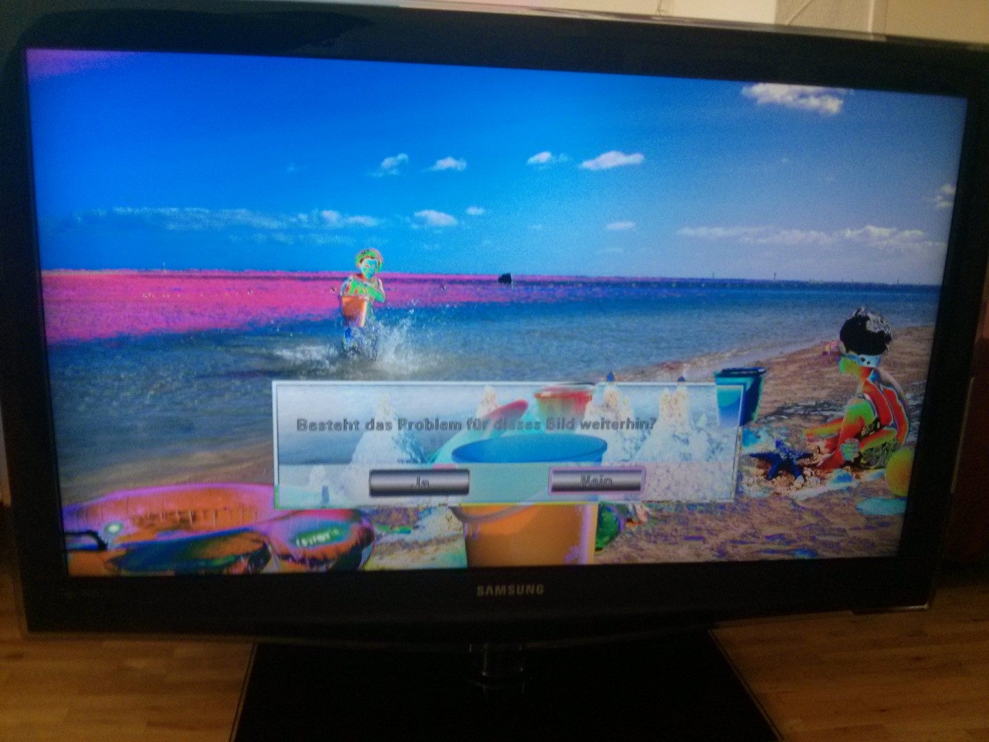

            Oh, stupid me Here you go. Quite a milky one, eh?
            It goes like (rounded, I don't remember so many numbers)
            15
            15
            15
            11
            13
            8
            8
            7
            7
            5
            4
            2,5
            0,4
            0,3
            Seems that also no. 5 is bad.

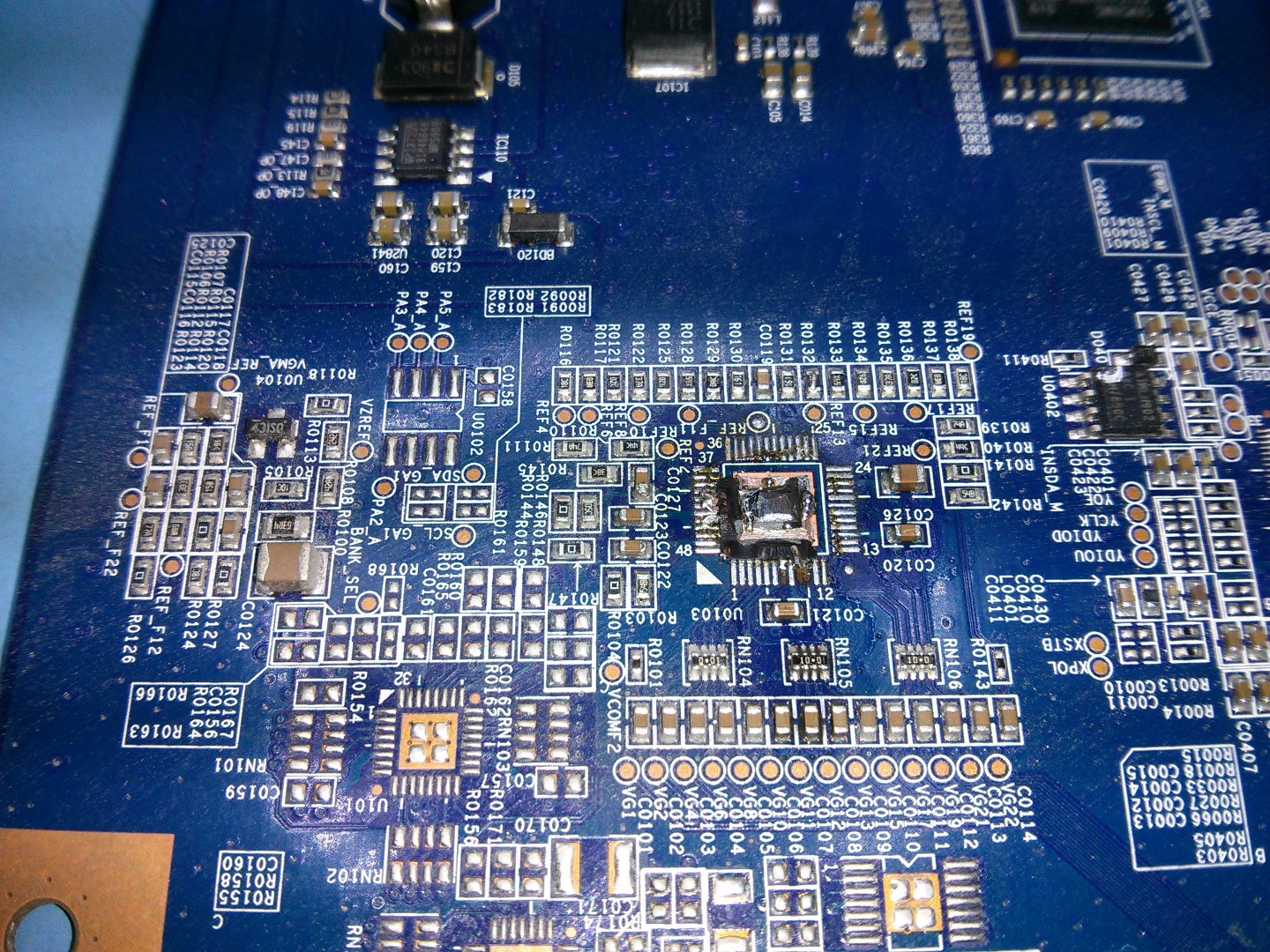

                I am idiot, soldered wrong direction. Heard a spark, only LED was still on. OK, will try for second time, new chip, hopefully nothing else is bad…maybe even this one is OK but I am not taking the risk since the soldering is the worst on it
                Anyway, there was chip version with solder tab, I have full-plastic package only, will have to create some cooling for it or heat transfer to the metal cover, problem is it is at least a centimeter above the chip

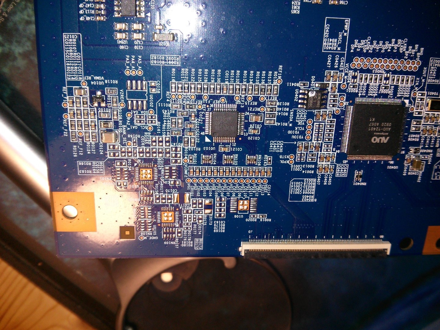

                  Second try is a success
                  After like 20 minutes it was just slightly warm. Do you think I should place there just some small heatsink or I can leave it be as it is, without cooling?
                    I would use a heatsink myself.

                      Dear all,
                      thanks for this thread. I repaired my LE37B650T2P with the same problem. It was really hard to remove the old AS15-HF Chip. I tried with my rework station from two sides, but no way. Then i used a dremel tool to remove the chip. It worked for me. I removed two little pads from the board Then i used two little wires to connect it directly to the chip. I tested the tv and everything is working fine. I ordered a cooler for the raspberry pi to use it with the AS15.
