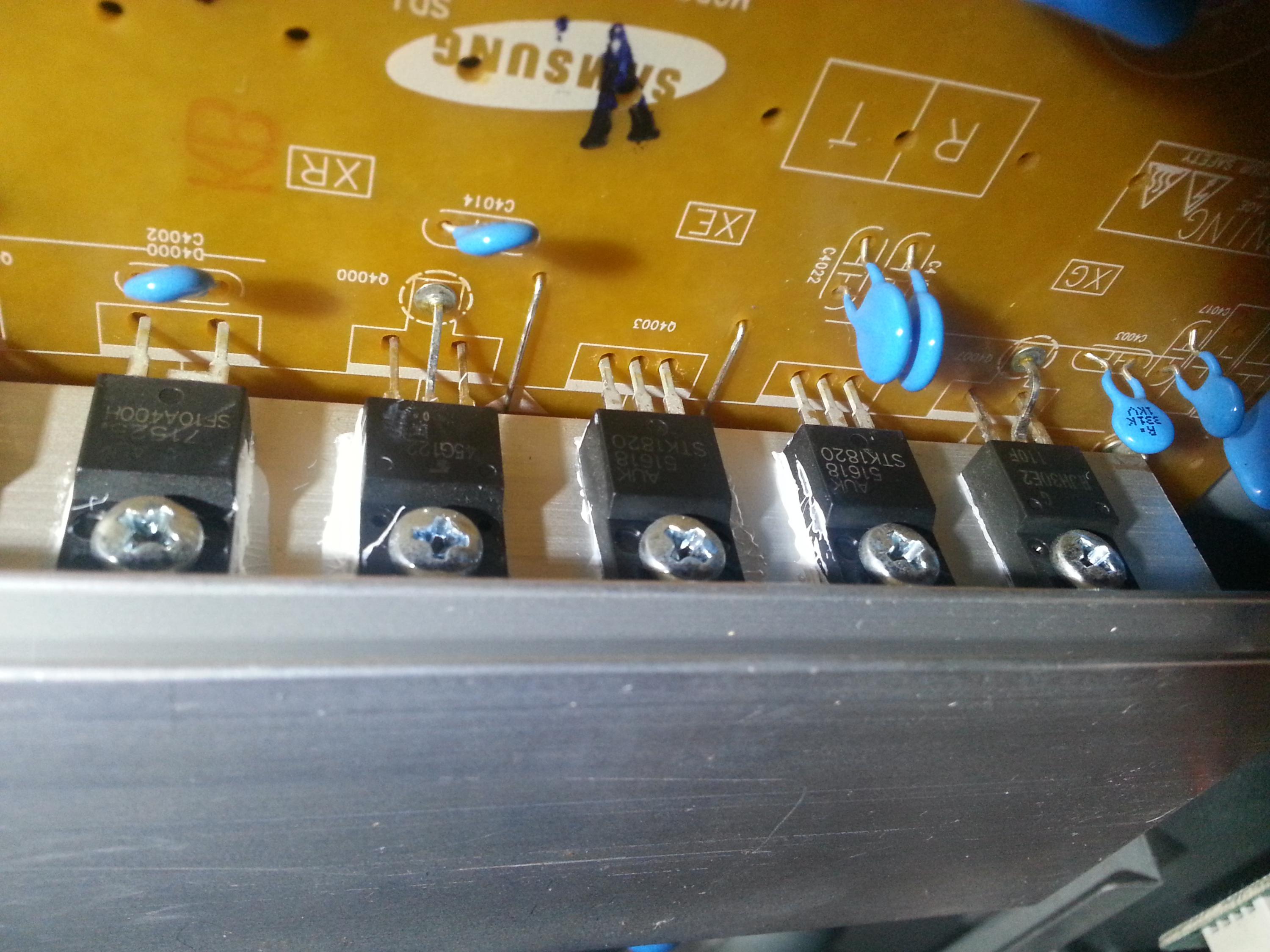

    Check each of the transistors on the heatsink - though the very fact the voltages drop out when it is connected is indicative of a fault and the board should be replaced.
    Note without the X-main you could get a little flicker from the screen when turned on with only Y-main - try in a dark room - the control board will quickly shut down though so it will only be quick.

      I tried I get power of 0.41v to the 2nd 4th and 5th and nothing to the rest top being the one by xs

                  You don't want to be checking for "power" (I presume you mean voltage; voltage is not the same as power though) you want to check each transistor or diode for shorts, using your multimeter on the ohms range.

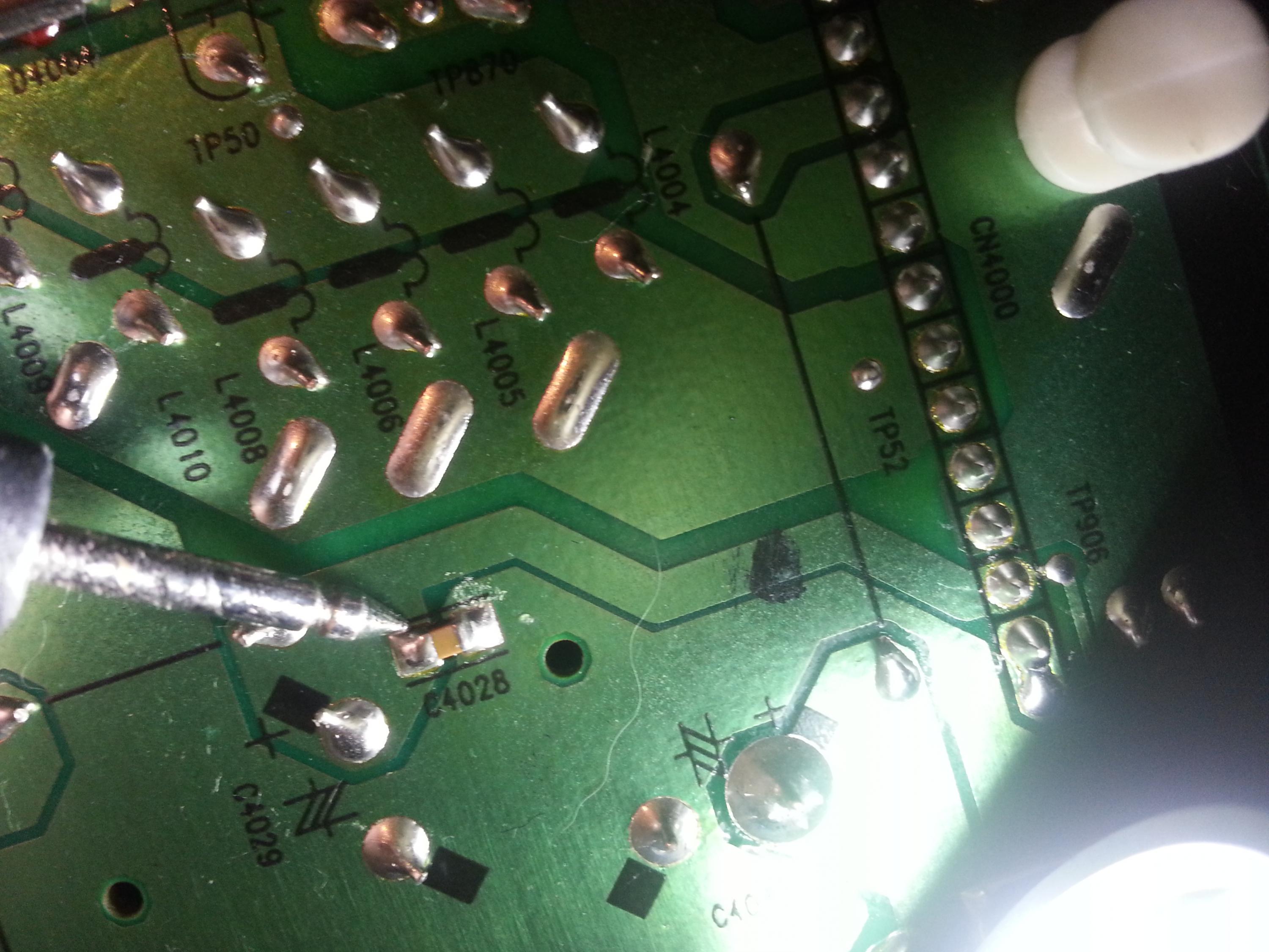

                    Is this a compasitor because I'm getting 15v from one side and nothing from the other but it goes to every circuit on the board and there is no volts after it could this go bad

                          That is a capacitor. Decoupling the 15V supply.
                          Now, if the 15V is present but Vs/Va are missing, it suggest a short on Vs, preventing it from reaching ~205V.
                          Have you checked the heatsinked transistors for shorts?

                            Where do I need to test on them ?
                              #34
                              Re: bush 42 3d tv well samsung
                              Just check across all three pins, both ways, on diode mode.

                                What black on one red on the other and mix it up it get the combinations

                                  The one with the pin sticking out is not going to 0 it's going to 0.98

                                    All combinations.
                                    Mentally number pins 1-2-3 in any order but be consistent over each device, for two pin devices just use 1-2.
                                    Then check red 1 black 2, red 1 black 3, red 2 black 1, etc...

                                      Ok right top one goes to 0 all combinations
                                      Second down stayed on 1
                                      3rd stays near enough one 1 all combinations
                                      4th 5.02 on pins 1 to 3 and stays on 1 on any other combination
                                      5th 5.02 all combos
                                      6th goes to 0
                                        #39
                                        So there's your fault, shorted sustain transistors. I'd take Alistair up on his offer of a board.
