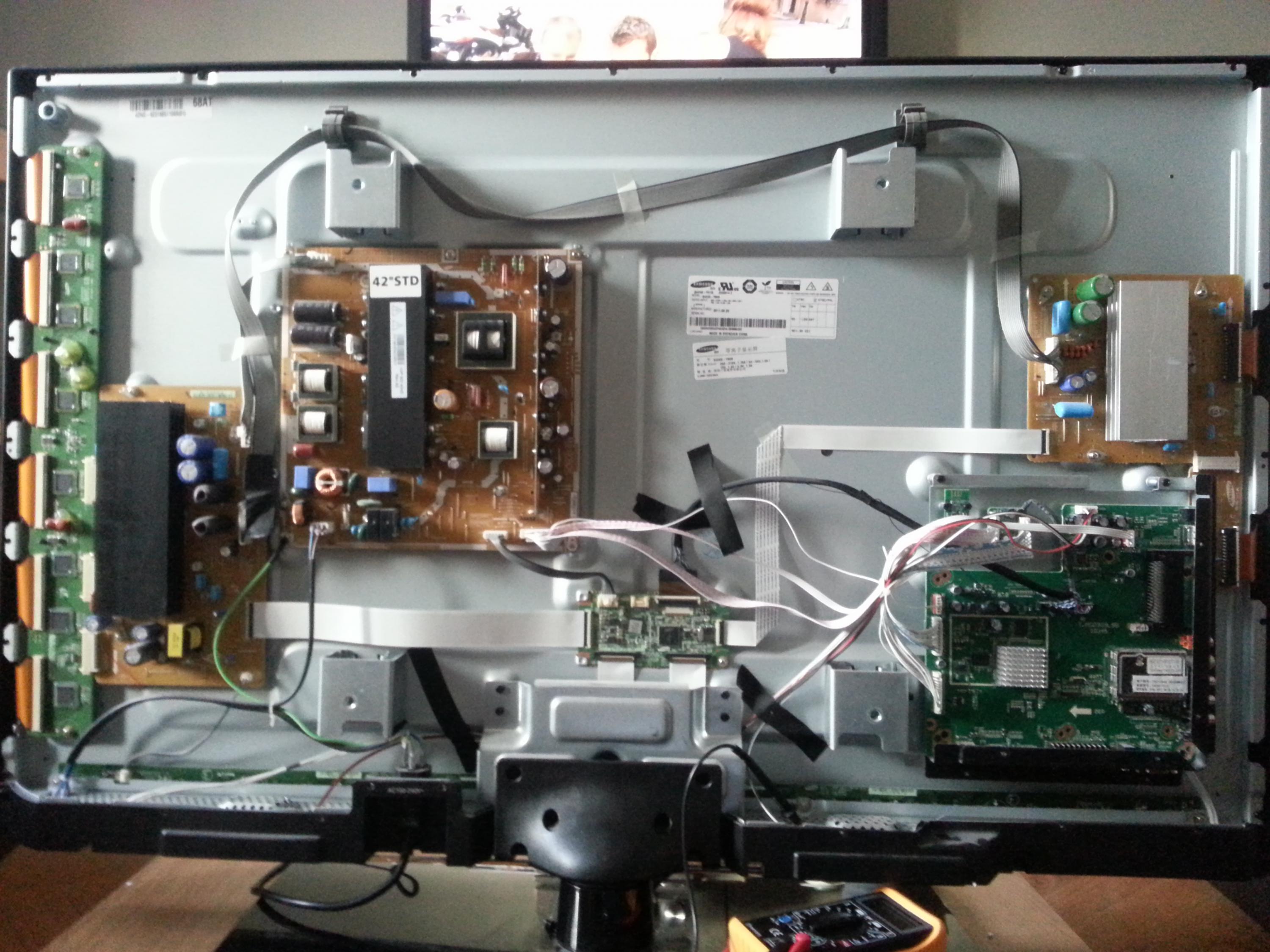

    I have just got a bush tv it clicks 3 times then the green light comes on but. No pic all boards are samsung in it it gets voltage to the power board for a few seconds then goes away

    Chassis looks like a Sams 42C450--but MB is different...

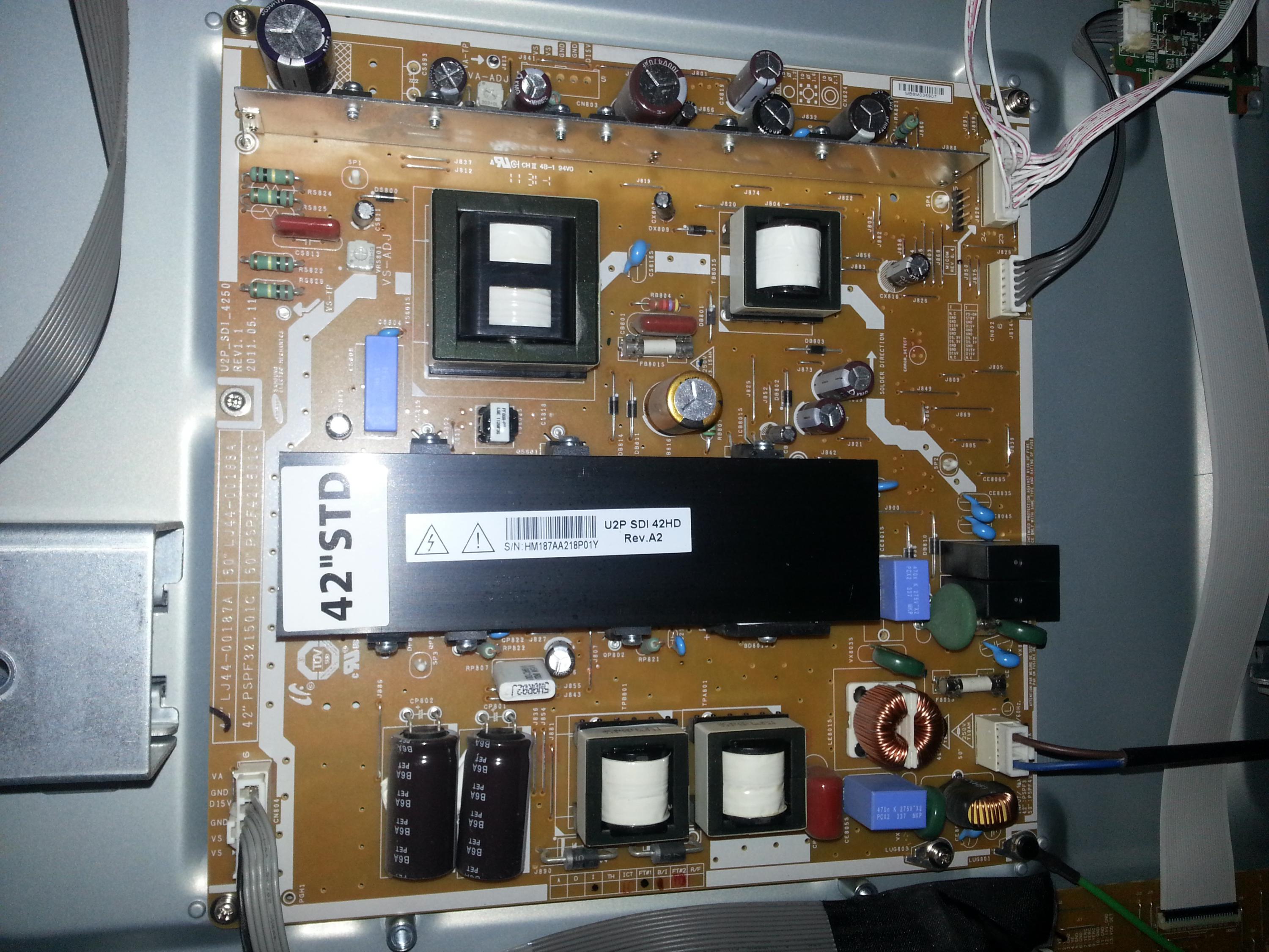

    PSU looks like a cheaper version than the original Sams one too....
    Start with the usual checks--report back.

        Hi you will find that you have a shorted YSus/XSus or Y buffer but could be all three.this set is same as PS42C450 Samsung just main board not the same, and have a habit of taking at least Y+X Sus boards together as are chained and when replacing them they should be done as a pair, i dont think anyone has had any luck repairing these boards as its hard to find the shorted parts but lots on eBay, plenty on here to read up on though Flocko
          Re: bush 42 3d tv well samsung
          How many TVs do you get? This is TCL China plasma TV with Samsung modified panel module. A lighter-weight version of B450/C450 series, different main board and case.
          3 clicks isn't necessarily abnormal but a lot of these newer Sammy's shut down when a board is pulled - so check if control board LED is flashing a 5-2 code (5 sec on, 2 sec off). Also see if you briefly get Vs and Va voltage from PSU board.
            Va 21v vs 11v also im getting 5 seconds on and 2 off and a lot of tvs at the mo I'm enjoying learning ha ha
              Check Vs/Va while it powers up, do they briefly go to ~200V (Vs) and ~55V (Va)?

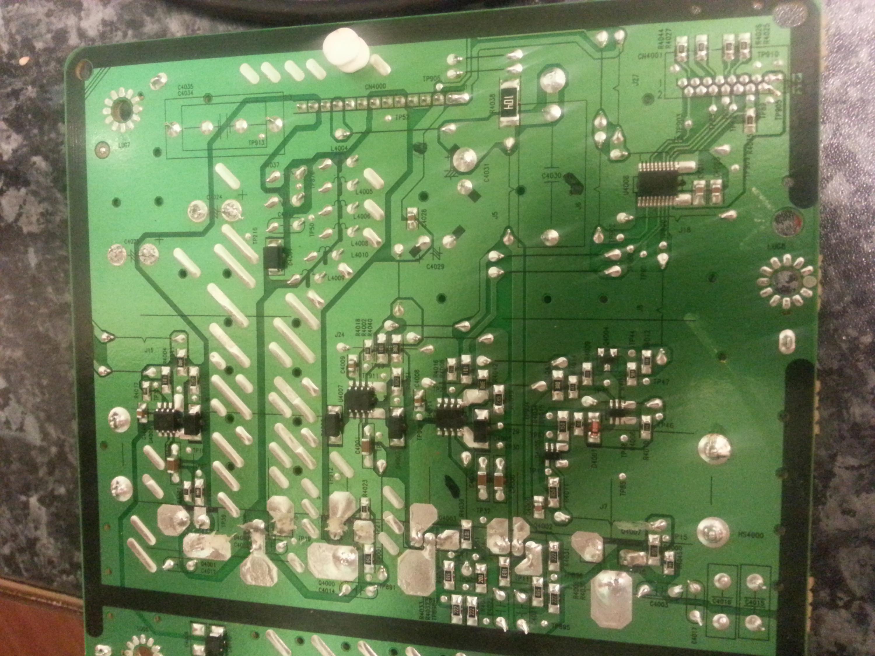

                              Check for any shorts of the IGBT's and diodes on the X-SUS, let us know.....

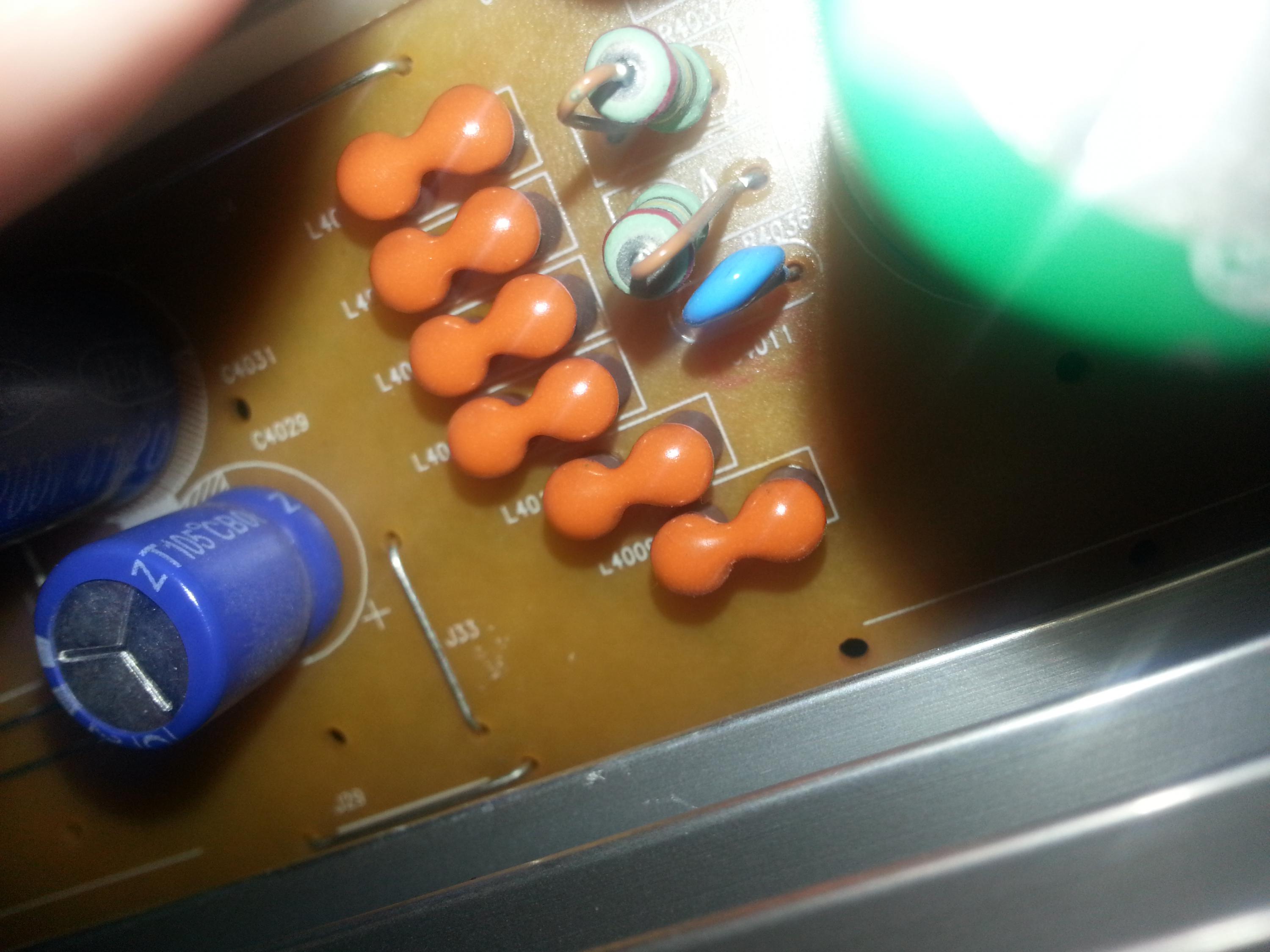

                                Hi been giving it a smell as you do and there was a mark on the closest to the silver plate had a mark on it the orange top things to these go ?
                                      The orange things are part of the ERC stage. Shame I sold an identical Xmain board a while back from a smashed B450.
                                        Any where I can test on it tom
