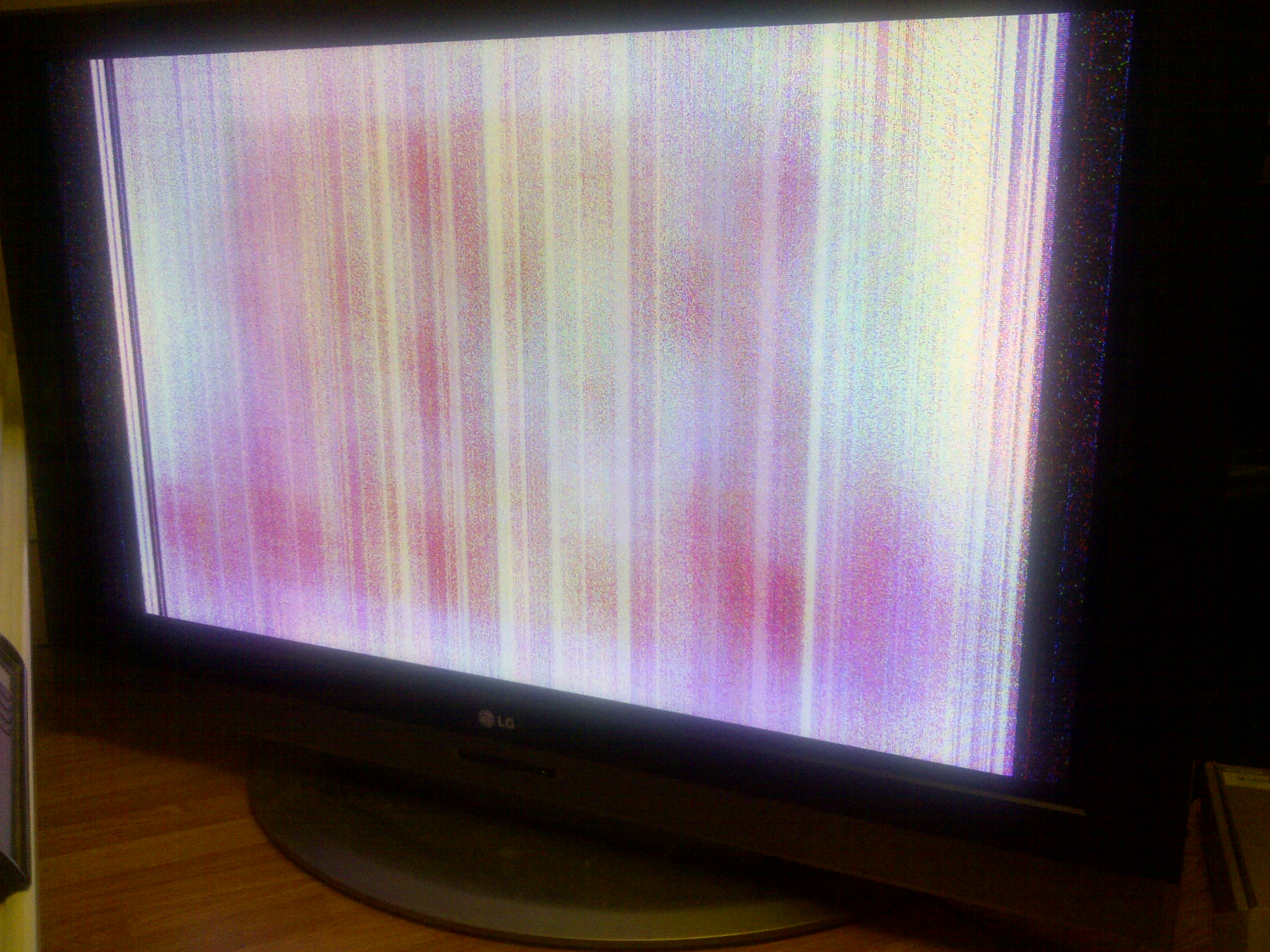

                            I replaced the Y-SUS today and this is the picture I'm getting. Of course I am getting sound. Both heatsinks on both sustain boards are getting warm. TV turns off after 20 seconds. But when I unplug the ZSUS power the tv stays on. I'm getting proper voltages out of the power supply into the YSUS and out of the YSUS to the ZSUS too. Any ideas on this?

                              Looks like you might also have a bad buffer board, but it is repairable. There are some surface mount FETs on them which can sometimes fail.
                              • dcapper
                                • Dec 2013
                                • 496
                                Re: Lg 50pc3d Clicking noice from IC201
                                Hi Tom,
                                Are the buffer boards beside the YSUS? In the service manual they call them drivers. I replaced the top ydrv. There is a bdrv, xrlt, xrct, and xrrt. Are those the boards I'm looking at? You are always so helpful.
                                EDIT: Also when I unlpug the bottom boards from the YSUS the tv still stays on.
                                  Yeah the buffers are also known as the YDRV boards.
                                  • dcapper
                                    • Dec 2013
                                    • 496
                                    Wow, I need to read more. I kept reading thinking it was the ZSUS. I pulled the bottom driver and its the top of the top is working.
                                    I just metered Q101, Q102, and Q103 on the blown board and they are all shorted.
                                    Also D111, D112, D113 are too.
                                    EDIT:
                                    Pulled up the pins on Q103. All the shorts went away except for Q103. Going to replace it and see what happens.
                                    Replaced Q103, still not working. I'm assuming IC104 is toast. Don't feel like replacing it, since I can buy a used board on ebay for $20.
