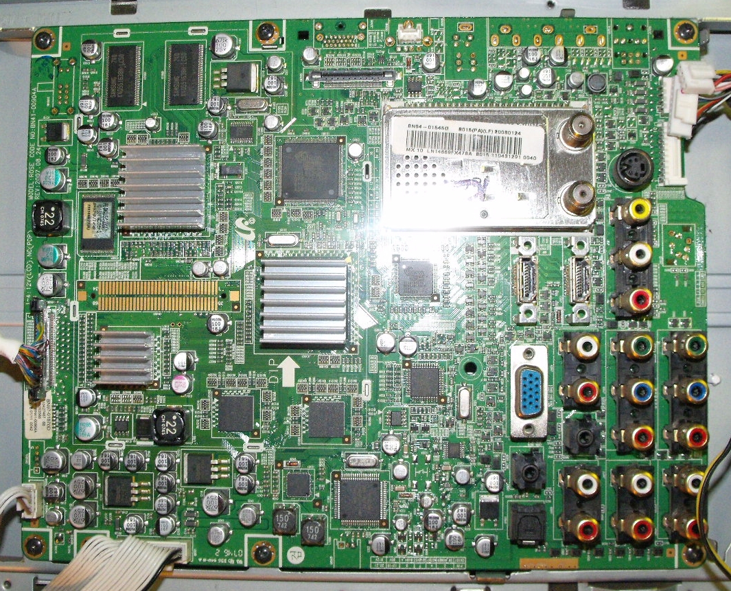

    Samsung LNT4669F that has a real bad flicker to it. It used to flicker until it warmed up like 20min then would be fine but now it's all the time. I don't see anything visually (bloated cap, burnt) So not sure what my next step is? Any help is appreciated!

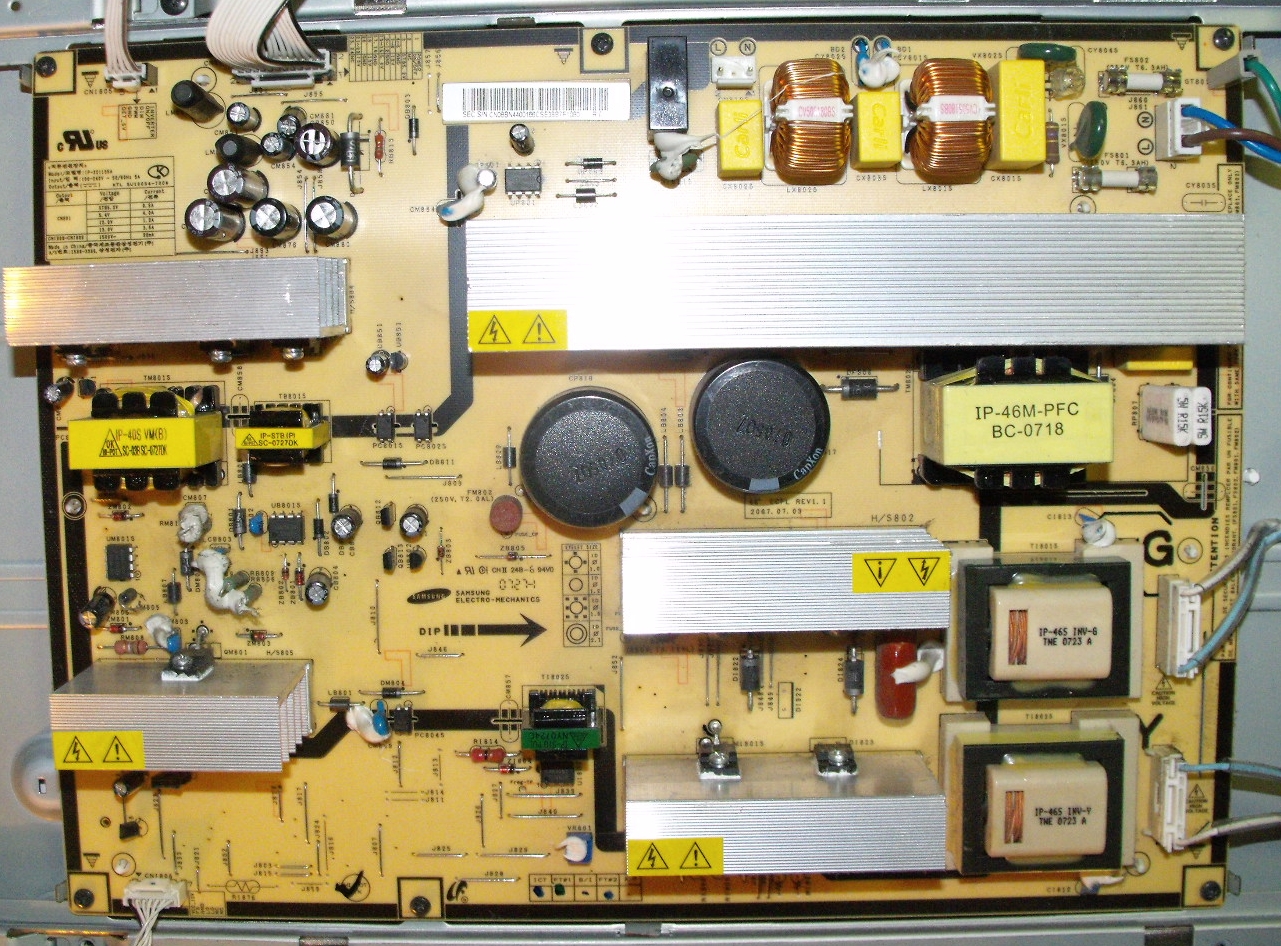

            OK, can you possibly get a video of this flicker, so we know what we're dealing with? For now, I would not focus on power supply, it is probably not causing the issue.

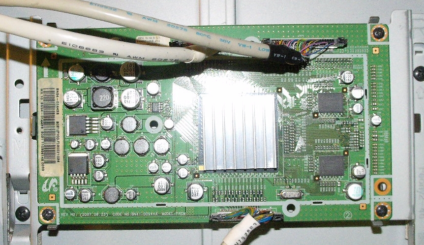

                  Looks like a panel tab bonds issue. Symptoms vary. It's sometimes fixable, though not always.
                  http://www.youtube.com/watch?v=purk_SyiT44
                    Re: SamSung LNT4669F Nasty flicker
                    Ya, I seen that video a while back. Just seems to me that it would not be the whole screen flickering if it was that.
                      Only half of your display is flickering, though.
                        Looks to me like the whole thing is but only those little bars are on the right. I will try the fix in the video and report back I guess.
                          Well poopie! It was in a ribbon cable. I tried a version of the fix in the youtube video and it fixed the flicker but now I have a bar down the far right side of the screen and even messing with that cable it won't go away.
