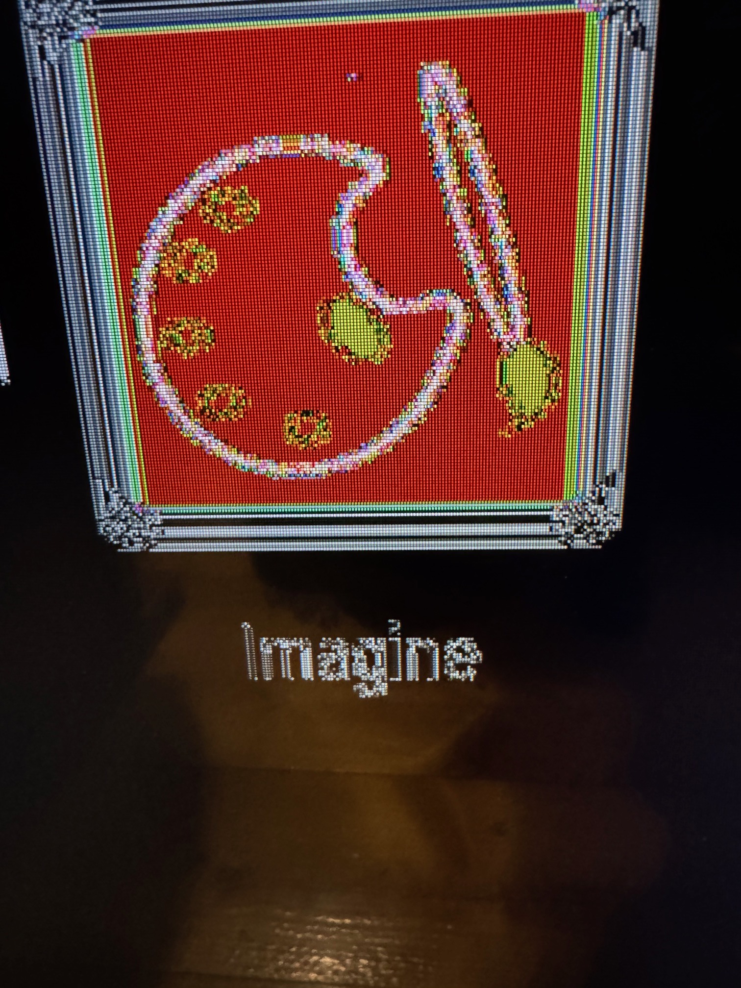

              Can you help me with Vestel 17MB82S with VES315WNDB-2D-N11 panel? I have the image reversed.

                  The panel has flipped, but the image is not correct.
                  Premium supporters get full download access and other benefits.
                    Theoretically the image should be correct. The profile is for what you have on TV. Try this.

                      I'll try this file. The original was 17MB97, but i replaced it with 17MB82S. I replaced it with what i had at home. The original mainboard get stuck on the HITACHI logo and restart after one minute.

                              I gave you the correct profile but it wasn't good. You said you rewrote it, the image came back but it's not correct. Then you say you didn't learn how to rewrite.
                              Something I don't understand.
                              Ti-am dat profilul corect dar nu a fost bun. Ai spus ca l-ai rescris, imaginea s-a intors dar nu este corecta. Apoi spui ca nu ai invatat cum se face rescrierea.
                              Ceva nu inteleg.

                                  #76
                                  it works!
